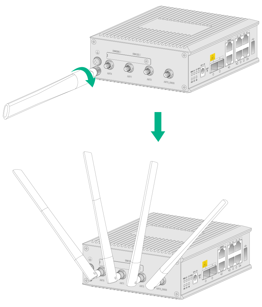

Installing a 4G/5G stick antenna

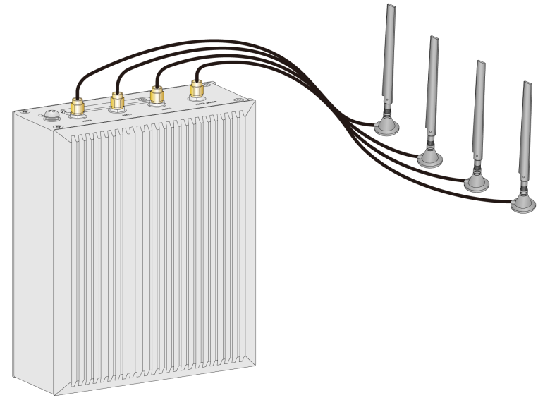

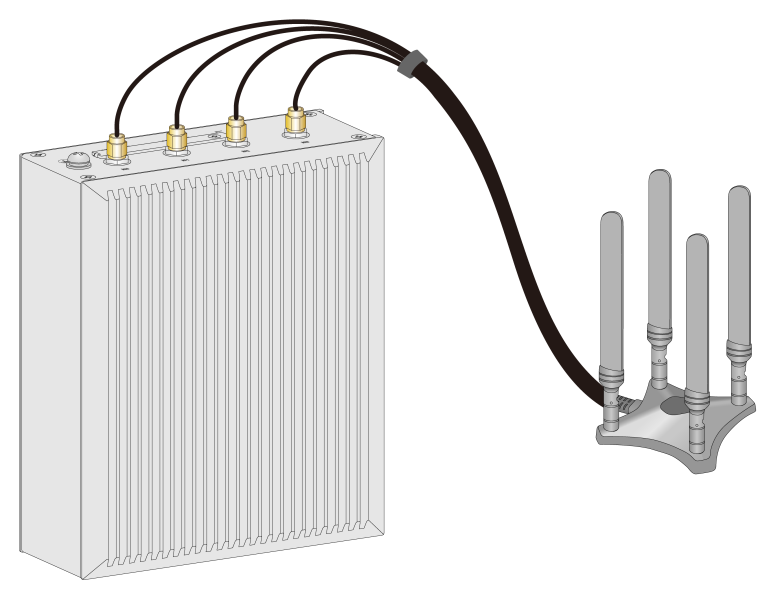

Installing a 4G/5G antenna extension cable (with a magnetic antenna mount base)

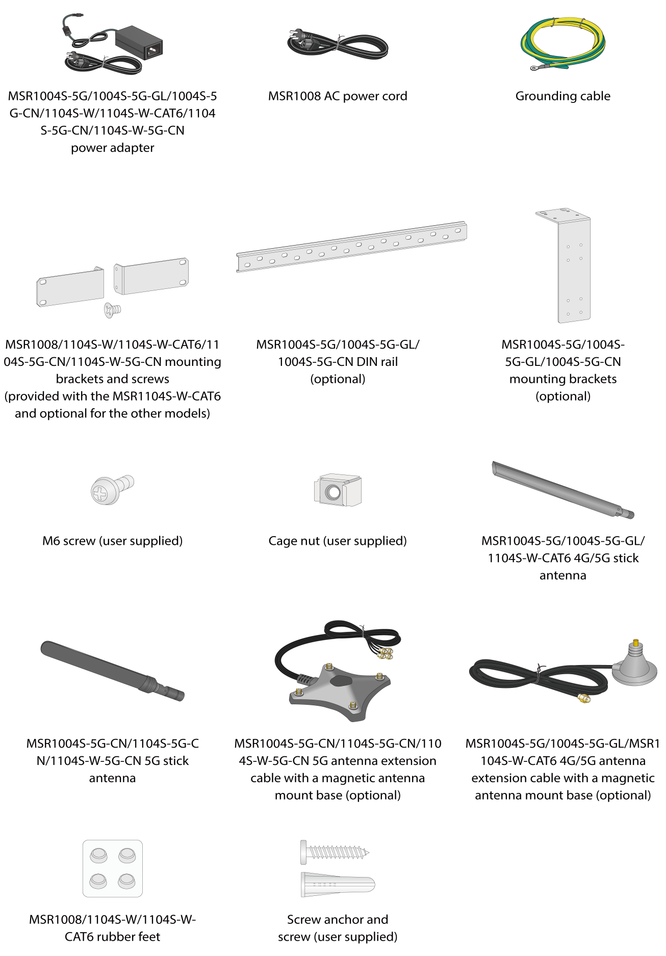

Installation accessories
Figure1-2 Installation accessories

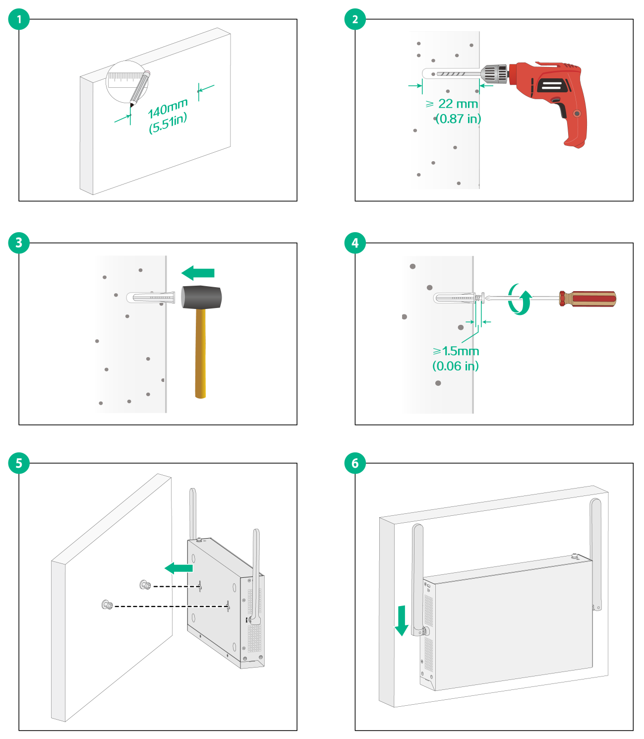

IMPORTANT: To wall-mount the router, you must prepare screw anchors and screws. Make sure the screw anchors and screws meet the following requirements: · The screw length is no less than 16 mm (0.63 in). · The screw thread diameter is between 3 mm and 3.5 mm (0.12 in to 0.14 in). · The screw head diameter is between 6 mm and 8 mm (0.24 in to 0.32 in). · The screw anchors are compatible with the screws. |

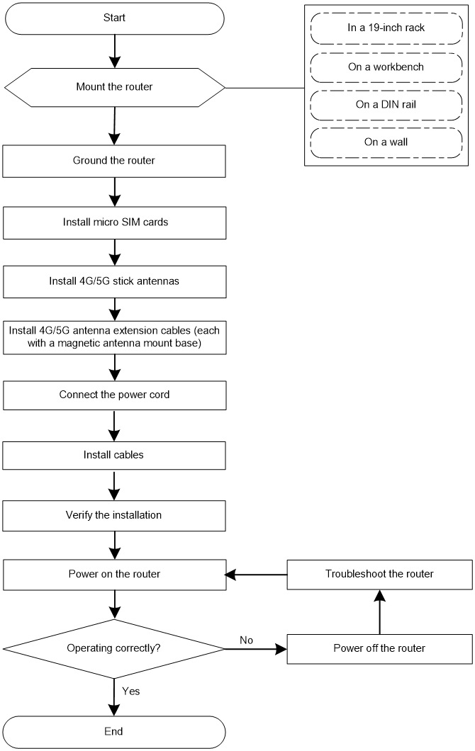

Installation flowchart
The following installation options are available for the router:
· 19-inch rack mounting
· Workbench mounting.
· DIN rail mounting.

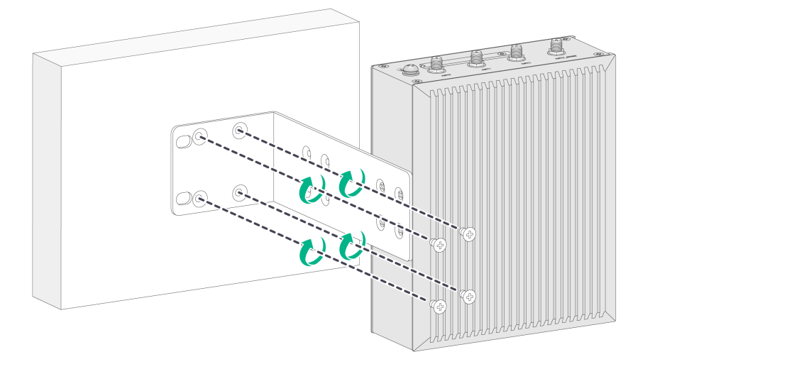

· Wall mounting.
Determine the installation method according to the installation environment. Follow the installation flowchart shown in Figure2-1 to install the router.
Figure2-1 Installation flowchart

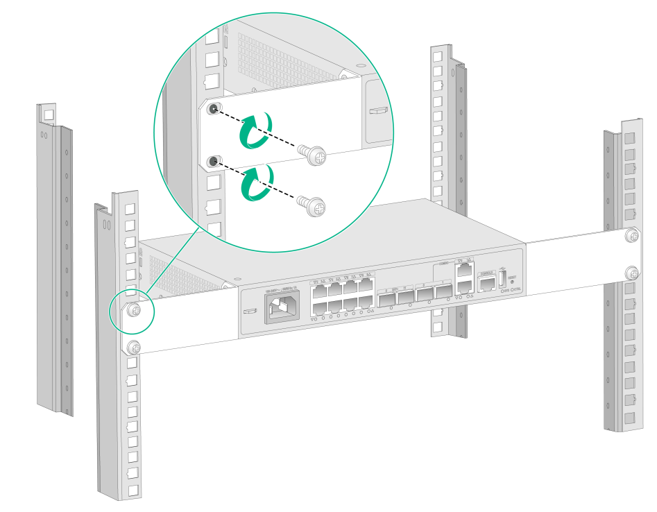

Mounting the router in a 19-inch rack
Only the MSR1008, MSR1104S-W, MSR1104S-W-CAT6, MSR1104S-5G-CN, and MSR1104S-W-5G-CN routers can be mounted in a 19-inch rack.
Only the MSR1104S-W-CAT6 router is provided with mounting brackets and screws. For other router models, prepare them yourself as required.
To install the router in a rack:

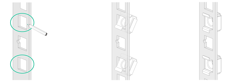

1. Use a front mounting bracket to mark the cage nut installation holes in the front rack posts and then install cage nuts into the marked square holes, as shown in Figure2-2.
Figure2-2 Installing cage nuts

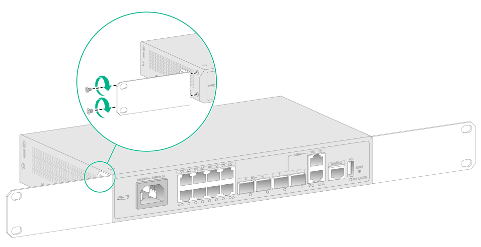

2. Attach mounting brackets to the two sides of the router, as shown in Figure2-3.
Figure2-3 Attaching mounting brackets to the router
3. Use M6 screws to attach the mounting brackets on the router to the rack, as shown in Figure2-4.
CAUTION: The mounting brackets can bear only the weight of the router. Do not place objects on the router. |
Figure2-4 Securing the router to the rack

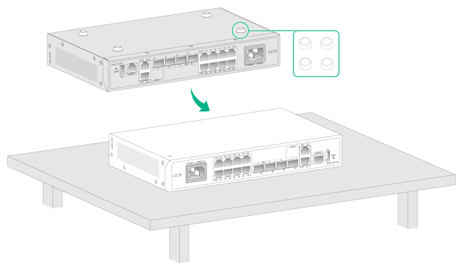

Mounting the router on a workbench
You can mount an MSR1004S-5G, MSR1004S-5G-GL, MSR1004S-5G-CN, MSR1104S-5G-CN, or MSR1104S-W-5G-CN router on a workbench without using rubber feet.
To mount the router on a workbench, follow these restrictions and guidelines:
· Make sure the workbench is clean, stable, and reliably grounded.
· Maintain a minimum clearance of 100 mm (3.94 in) around the router for heat dissipation.
· Do not place heavy objects on the router.
1. Place the router upside down on the workbench and attach the rubber feet to the four round holes in the chassis bottom.
2. Place the router upside up on the workbench.
Figure2-5 Mounting the router on a workbench

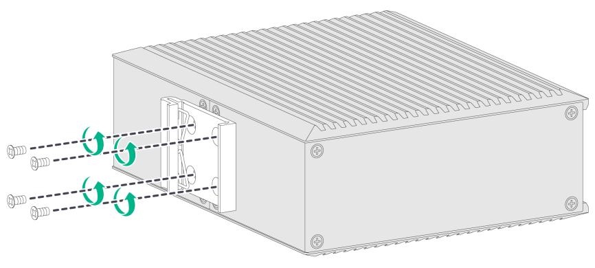

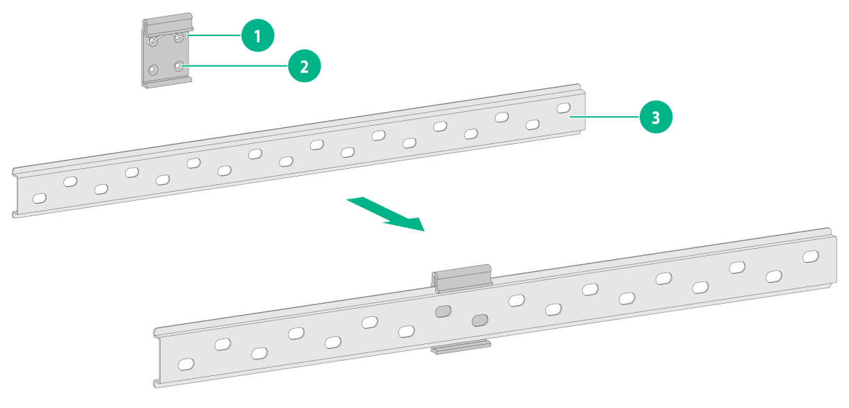

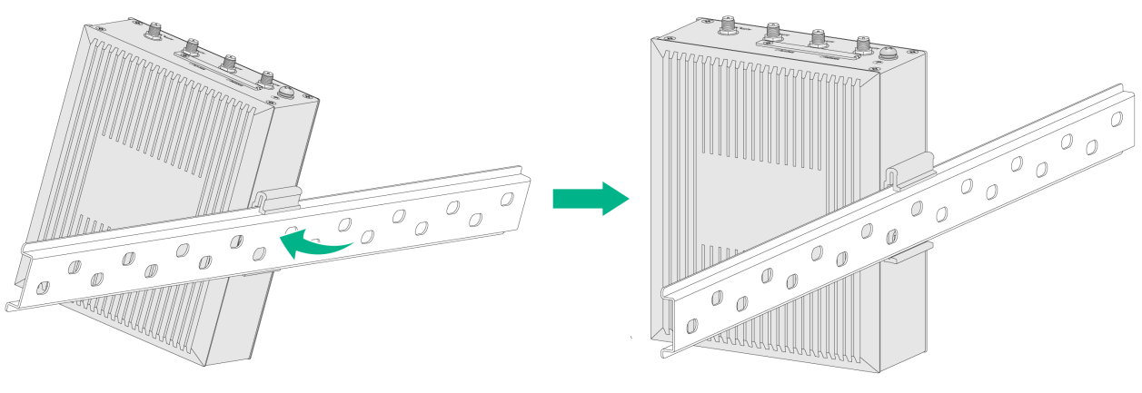

Mounting the router on a DIN rail
Only the MSR1004S-5G, MSR1004S-5G-GL, and MSR1004S-5G-CN routers can be mounted on a DIN rail.
The router is shipped with DIN rail mounting bracket installed on it.
Figure2-6 DIN rail mounting racket and DIN rail
(1) Metal spring |
(2) Screw hole |
(3) DIN rail |
To mount the router on a DIN rail:
1. Press the DIN rail against the spring on the DIN rail mounting bracket.
2. Press the DIN rail upward to for its bottom to fit onto the bottom flange of the DIN rail mounting bracket.
Figure2-7 Mounting the router on a DIN rail

4. Remove the DIN rail mounting bracket attached to the router real panel.
Keep the removed DIN rail mounting bracket and the four mounting screws secure.
Figure2-9 Removing the DIN rail mounting bracket from the router

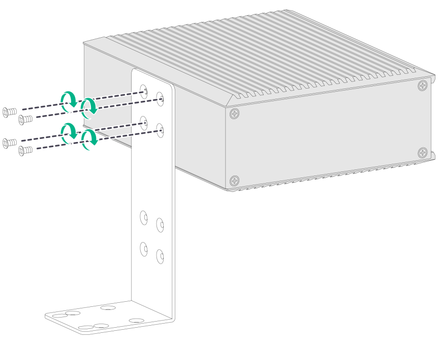

5. Use the four mounting screws used for the DIN rail mounting bracket to secure the router mounting bracket to the rear panel of the router.
Figure2-10 Installing the router mounting bracket
6. Use the wall-mount screws to attach the router mounting bracket to the wall.
Figure2-11 Securing the router to the wall
Mounting an MSR1104S-W/MSR1104S-W-CAT6/MSR1104S-5G-CN/MSR1104S-W-5G-CN on a wall
1. Mark two wall-mount screw hole locations on the wall.
2. Drill holes with a minimum depth of 22 mm (0.87 in) in the marked locations. Make sure the holes are 140 mm (5.51 in) horizontally apart.
3. Hammer a screw anchor into each hole until the anchor is flush with the wall.
4. Drive a screw into each anchor and make sure the screw protrudes a minimum of 1.5 mm (0.06 in) from the wall.
5. Hang the router on the screws.
Figure2-12 Mounting an MSR1104S-W/MSR1104S-W-CAT6/MSR1104S-5G-CN/MSR1104S-W-5G-CN on a wall

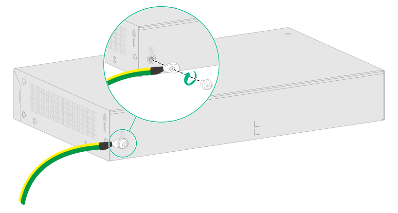

Grounding the router
CAUTION: · Correctly connecting the grounding cable is crucial to lightning protection and EMI protection. When you install and use the router, first ground the router reliably. · Ensure a minimum resistance of 5 ohms between the router and the ground. |
To connect the grounding cable to the router:
1. Remove the grounding screw from the grounding hole in the chassis.
2. Use the grounding screw to attach the ring terminal of the grounding cable to the grounding hole and fasten the screw.
3. Remove the nut from a grounding post on the grounding strip.
4. Use needle-nose pliers to bend a hook with the bear metal part of the grounding cable. Then attach the hook to the grounding post and fasten the nut.
Figure2-13 Connecting the grounding cable to the router

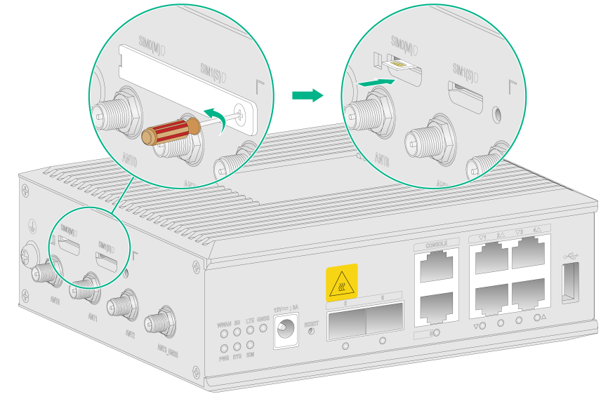

Installing a micro SIM card
Only the MSR1004S-5G, MSR1004S-5G-GL, MSR1004S-5G-CN, MSR1104S-W-CAT6, MSR1104S-5G-CN, and MSR1104S-W-5G-CN routers support micro SIM cards.
The micro SIM cards are hot swappable.
SIM0 (M) is the master slot and SIM1 (S) is the standby slot. Only one slot is active at a time. As a best practice, use the master slot if you are to install only one micro SIM card. You can use the sim switch-to command to specify the active slot. For more information about the command, see Layer 2—WAN Access Command Reference for the product.
The two micro SIM card slots on the MSR1004S-5G, MSR1004S-5G-CN, MSR1104S-5G-CN, or MSR1104S-W-5G-CN router support all types of 3G/4G/5G networks.
The two micro SIM card slots on the MSR1004S-5G-GL router support 3G/4G/5G networks.
The two micro SIM card slots on the MSR1104S-W-CAT6 router support 3G/4G networks.
To avoid damaging the micro SIM card slot, do not use excessive force when installing a micro SIM card.
CAUTION: The screw on the micro SIM card slot cover is M3 × 4 mm (0.16 in) countersunk screw. Use a Phillips screwdriver to loosen and fasten the screw on the cover. A mismatched screwdriver might damage the screw. |
1. Use a Phillips screwdriver to remove the screw on the micro SIM card slot cover and then take off the cover.
2. Insert the micro SIM card into the micro SIM card slot along the guide rails.
3. Reinstall the cover and then fasten the screw on the cover.
Figure2-14 Installing a micro SIM card
Only the MSR1004S-5G, MSR1004S-5G-GL, MSR1004S-5G-CN, MSR1104S-5G-CN, and MSR1104S-W-5G-CN routers support 5G stick antennas. Only the MSR1104S-W-CAT6 router supports 4G stick antennas.
A 5G antenna can also be used as a GNSS antenna. For high-precision positioning, use a GNSS antenna. To use GNSS, connect the antenna to the ANT3_GNSS port on an MSR1004S-5G or MSR1004S-5G-GL router.
To use GNSS, install the antenna at a position close to outdoors for stable signal receipt.
The installation procedure is the same for 4G stick antennas and 5G stick antennas. The following uses a 5G stick antenna as an example.
To install a 5G stick antenna:
1. Change the angle of the antenna orientation from vertical to horizontal.
2. Attach the antenna to the antenna port on the router. Do not over-tighten the antenna to avoid damage.
To reduce signal interferences between antennas, install antennas with an angle and separate installation of antennas.
Figure2-15 Installing a 5G stick antenna
Only the MSR1004S-5G, MSR1004S-5G-GL, MSR1004S-5G-CN, MSR1104S-5G-CN, and MSR1104S-W-5G-CN routers support 5G antenna extension cables (each with a magnetic antenna mount base).
Only the MSR1104S-W-CAT6 router supports 4G antenna extension cables (each with a magnetic antenna mount base).
No 4G/5G antenna extension cable (with a magnetic antenna mount base) is provided with the router. Purchase 4G/5G antenna extension cables (each with a magnetic antenna mount base) yourself as required.
A 5G antenna extension cable (with a magnetic antenna mount base) can be used only for connecting a stick antenna.
The installation procedure is the same for 4G and 5G antenna extension cables (each with a magnetic antenna mount base). The following uses a 5G antenna extension cable (with a magnetic antenna mount base) as an example.
To connect a 5G antenna extension cable (with a magnetic antenna mount base) to a stick antenna:
1. Connect the SMA male connector of the 5G antenna extension cable (with a magnetic antenna mount base) to the antenna port on the router and fasten the connector.
2. Connect the 5G stick antenna to the SMA female connector of the magnetic antenna mount base.
Figure2-16 Installing 5G antenna extension cables (each with a magnetic antenna mount base) for MSR1004S-5G/MSR1004S-5G-GL
Figure2-17 Installing 5G antenna extension cables (each with a magnetic antenna mount base) for MSR1004S-5G-CN/MSR1104S-5G-CN/MSR1104S-W-5G-CN

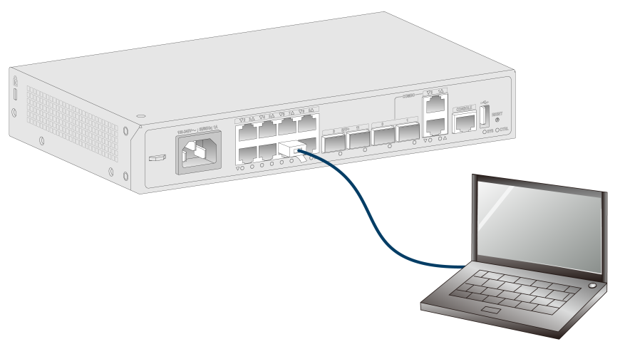

Connecting Ethernet interface cables
1. Connect one end of the cable to an Ethernet port on the router.
2. Connect the other end of the cable to the Ethernet port on a host.
3. Examine the port LEDs on the router. For more information about the LEDs, see H3C MSR1000 Routers Hardware Information and Specifications.
Figure2-20 Connecting an Ethernet cable

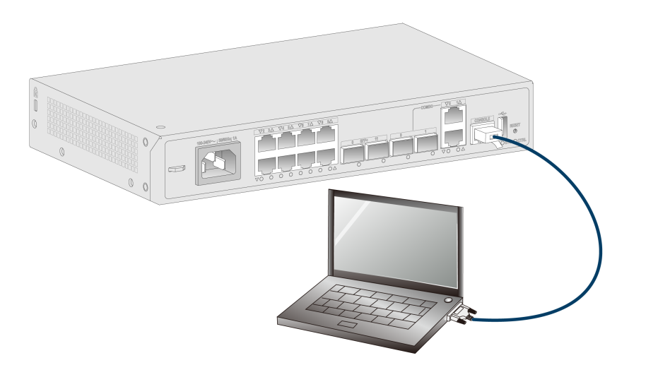

Connecting the console cable and setting terminal parameters
CAUTION: The serial ports on PCs do not support hot swapping. To connect a PC to an operating router, first connect the PC end. To disconnect a PC from an operating router, first disconnect the router end. |
To connect the console cable:
1. Select a configuration terminal, which can be an ASCII terminal with an RS-232 serial port or a PC. (A PC is more commonly used.)
2. Connect the DB-9 connector (female) of the console cable to the RS-232 serial port on the configuration terminal and the RJ-45 connector to the console port of the router.
Figure2-21 Connecting the console cable
