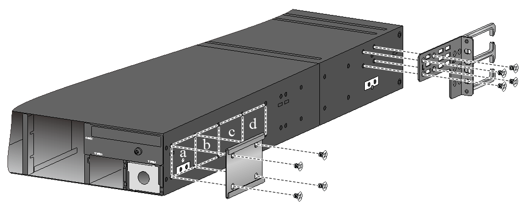

Attaching the mounting brackets and chassis rails to the chassis

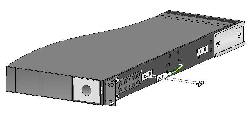

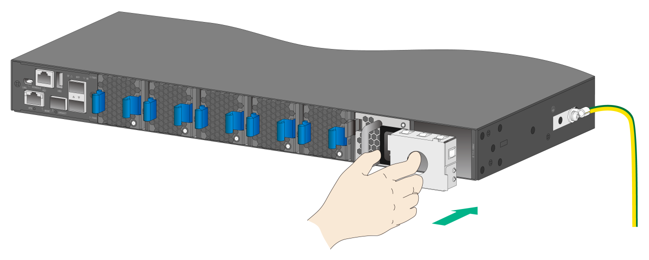

Connecting the grounding cable to the chassis

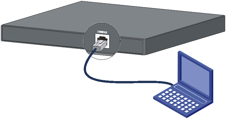

Connecting the switch to a configuration terminal
Connecting a DB9-to-RJ45 console cable
Connecting a USB-to-RJ45 console cable
Connecting the mini USB console cable

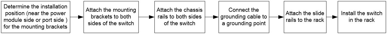

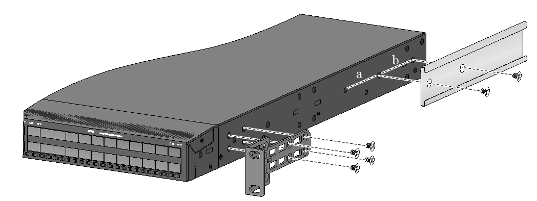

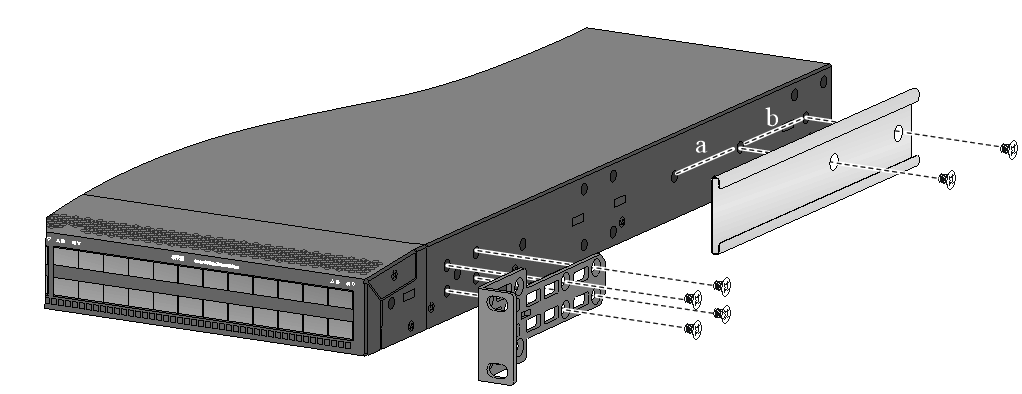

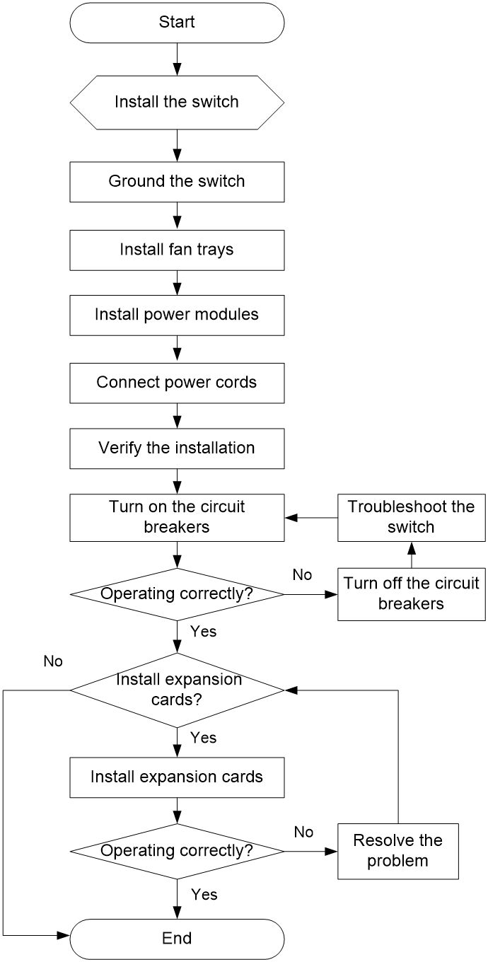

2 Installing the switch
CAUTION: Keep the tamper-proof seal on a mounting screw on the chassis cover intact, and if you want to open the chassis, contact H3C for permission. Otherwise, H3C shall not be liable for any consequence caused thereby. |

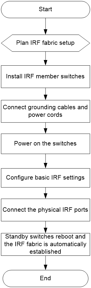

Figure2-1 Hardware installation flow

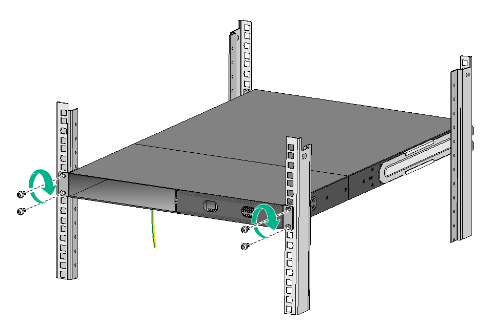

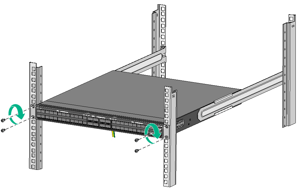

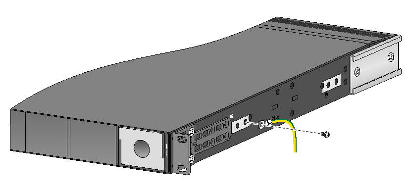

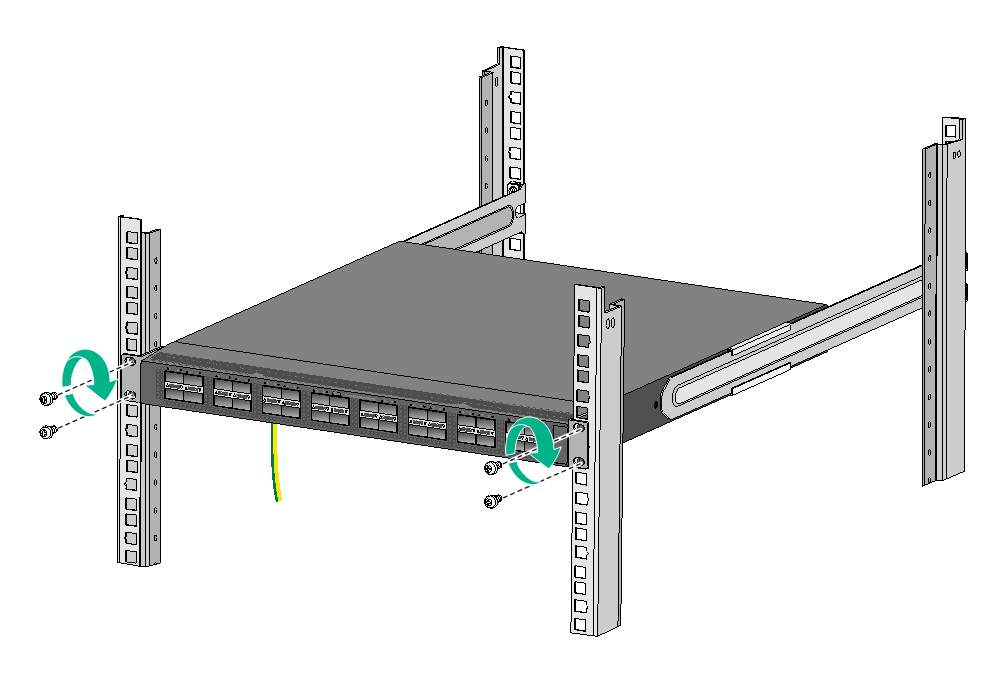

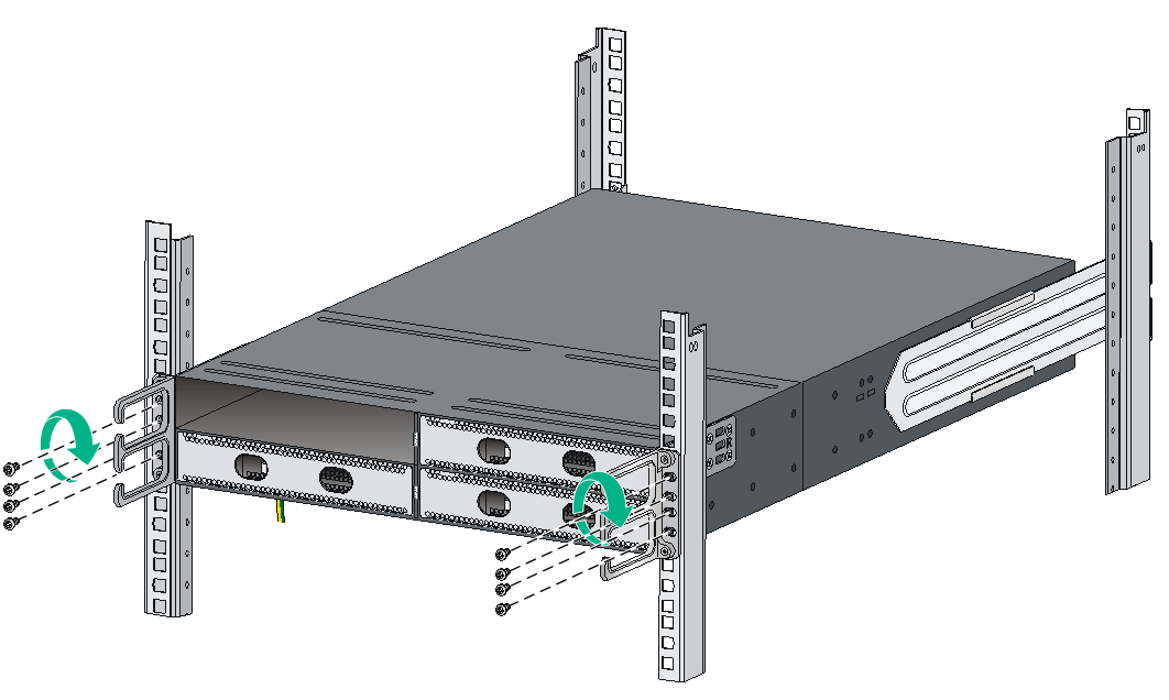

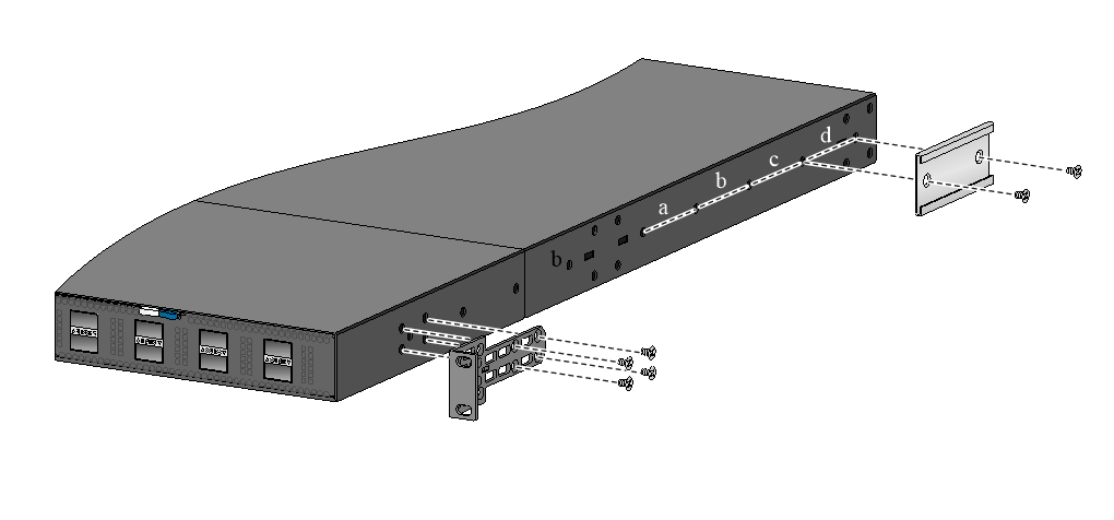

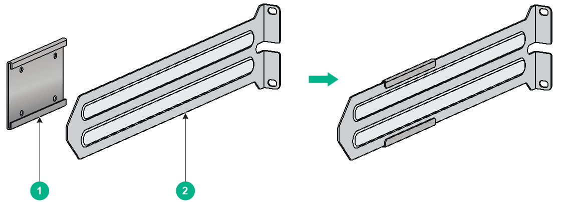

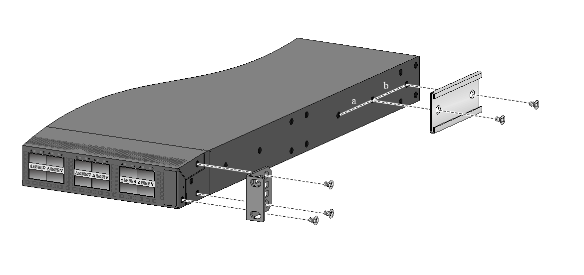

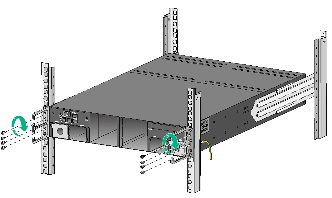

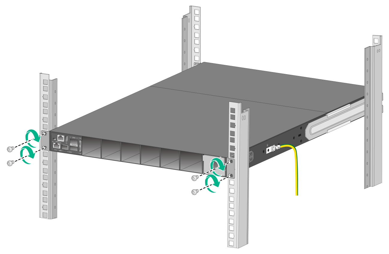

Installing the switch in a 19-inch rack
Rack-mounting procedures at a glance
Figure2-2 Rack-mounting procedure
NOTE: If a rack shelf is available, you can put the switch on the rack shelf and slide the switch to a position so that the mounting brackets make close contact with the front rack posts. Then use screws to secure the mounting brackets to the rack. |
Rack-mounting requirements

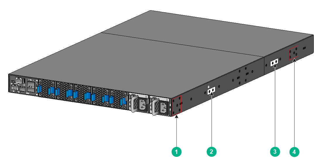

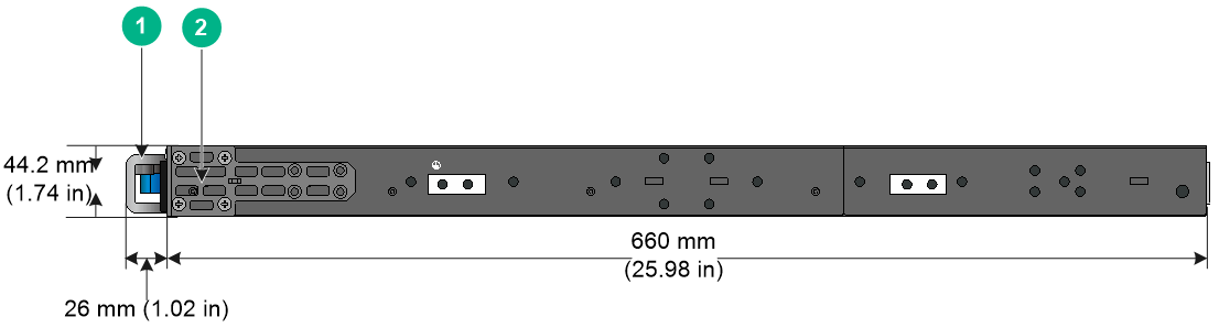

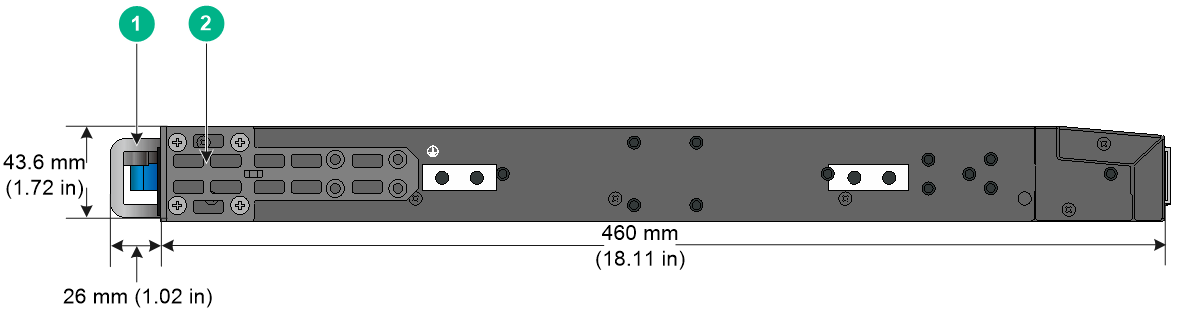

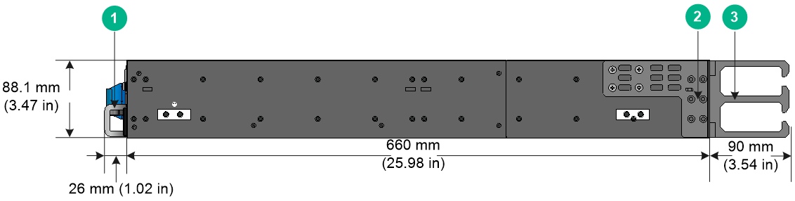

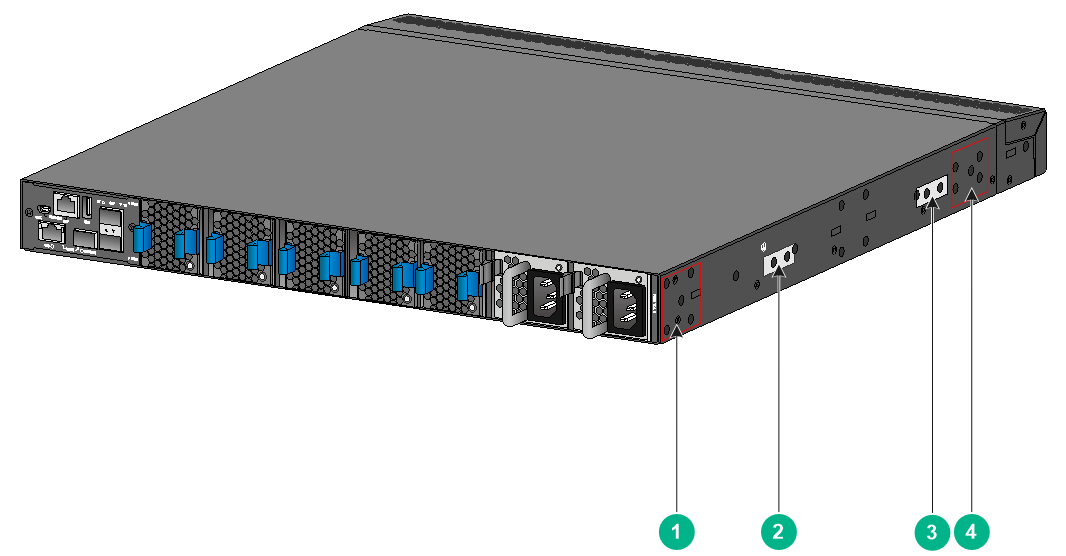

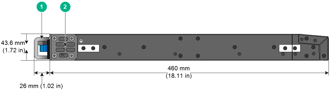

Figure2-3 S6850-56HF chassis dimensions (mounting brackets installed at the port side, left-side view)
(1) Power module handle |
(2) Mounting bracket |

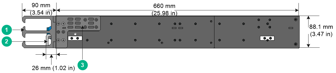

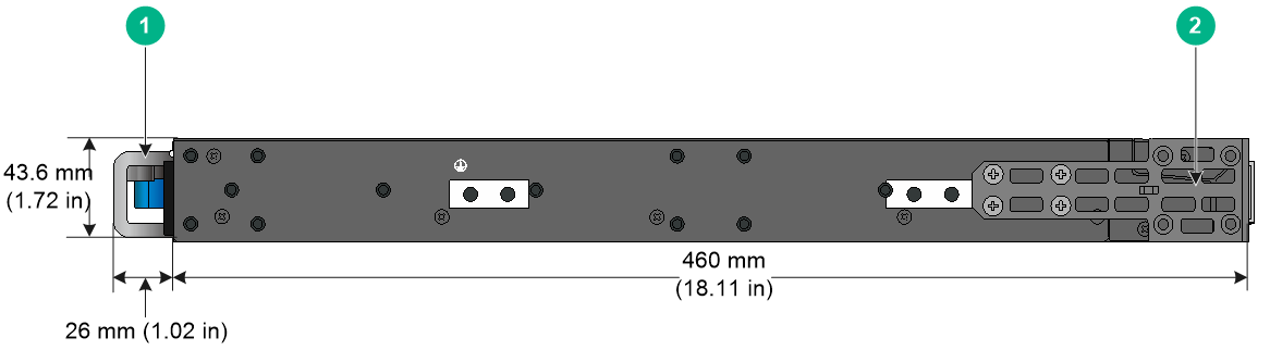

Figure2-4 S6850-56HF chassis dimensions (mounting brackets installed at the power module side, left-side view)

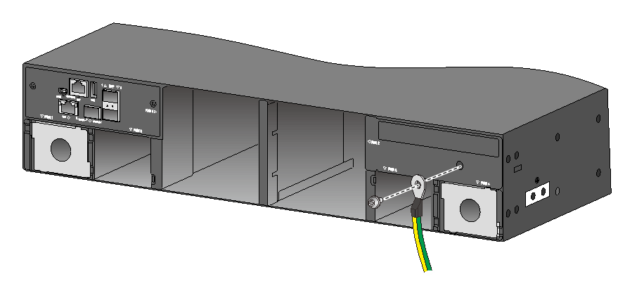

Figure2-6 S6850-2C chassis dimensions (mounting brackets installed at the power module side, left-side view)

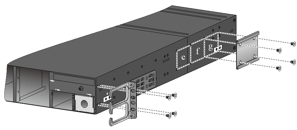

Figure2-7 S9850-4C chassis dimensions (mounting brackets installed at the port side, left-side view)

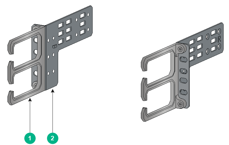

(3) Cable management bracket |
Figure2-8 S9850-4C chassis dimensions (mounting brackets installed at the power module side, left-side view)
(1) Cable management bracket |
(2) Power module handle |
(3) Mounting bracket |

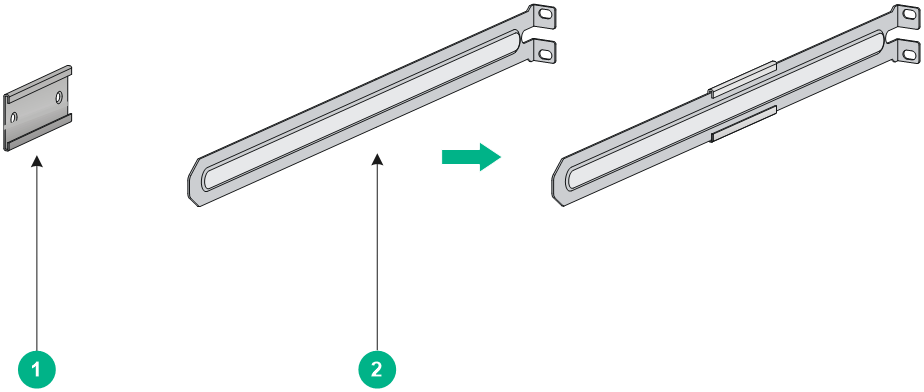

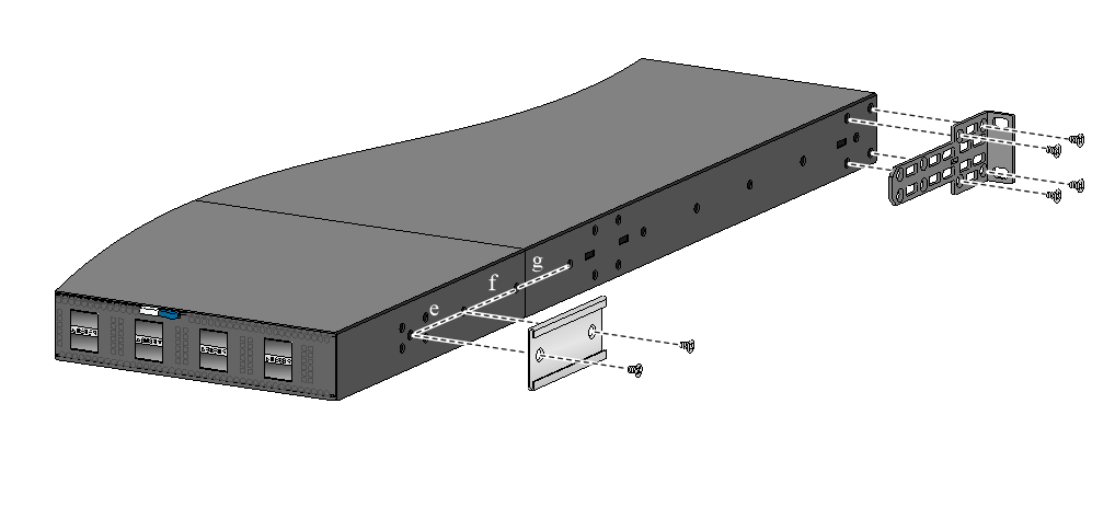

Installation accessories
Table2-3 Installation accessories
Switch model |
Mounting brackets (provided) |
Cable management brackets |
Rack mounting rail kit |

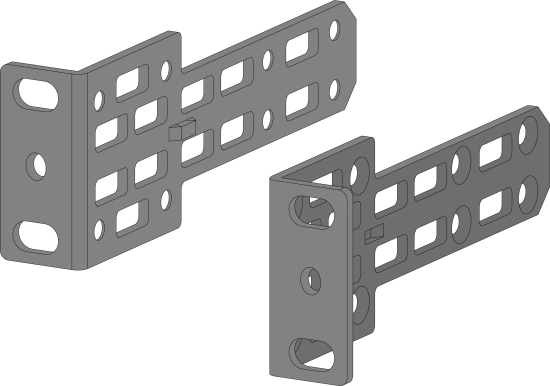

S6850-56HF |
1U high, one pair. See Figure2-11. The mounting bracket with a round hole in the narrow flange supports hanging a fixed asset tag. |
N/A |
1U high, including one pair of long slide rails and one pair of chassis rails (provided). See Figure2-14. |
1U high, including one pair of super-short slide rails and one pair of chassis rails (optional). See Figure2-16. |
N/A |
1U high, including one pair of short slide rails and one pair of chassis rails (provided). See Figure2-15. |
S9850-4C |
2U high, one pair. See Figure2-12. |
One pair (provided). See Figure2-12. |
2U high, including one pair of slide rails and one pair of chassis rails (provided). See Figure2-17. |
S9850-32H |
1U high, one pair. See Figure2-13. The mounting bracket with a round hole in the narrow flange supports hanging a fixed asset tag. |
N/A |
1U high, including one pair of short slide rails and one pair of chassis rails (optional). See Figure2-15. |
Figure2-11 Mounting brackets provided with the S6850-56HF and S6850-2C switches
Figure2-12 Mounting brackets provided with the S9850-4C switch
Figure2-13 Mounting brackets provided with the S9850-32H switch

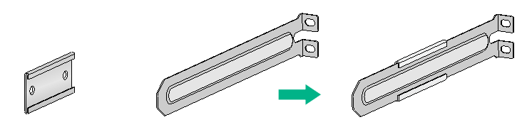

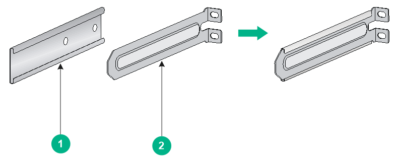

Figure2-14 1U long slide rail and chassis rail
(1) Chassis rail |
(2) Long slide rail |
Figure2-15 1U short slide rail and chassis rail
Figure2-16 1U super-short slide rail and chassis rail
(1) Chassis rail |
(2) Super-short slide rail |
Figure2-17 2U slide rail and chassis rail
(1) Chassis rail |
(2) Slide rail |

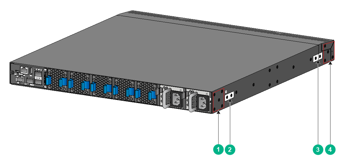

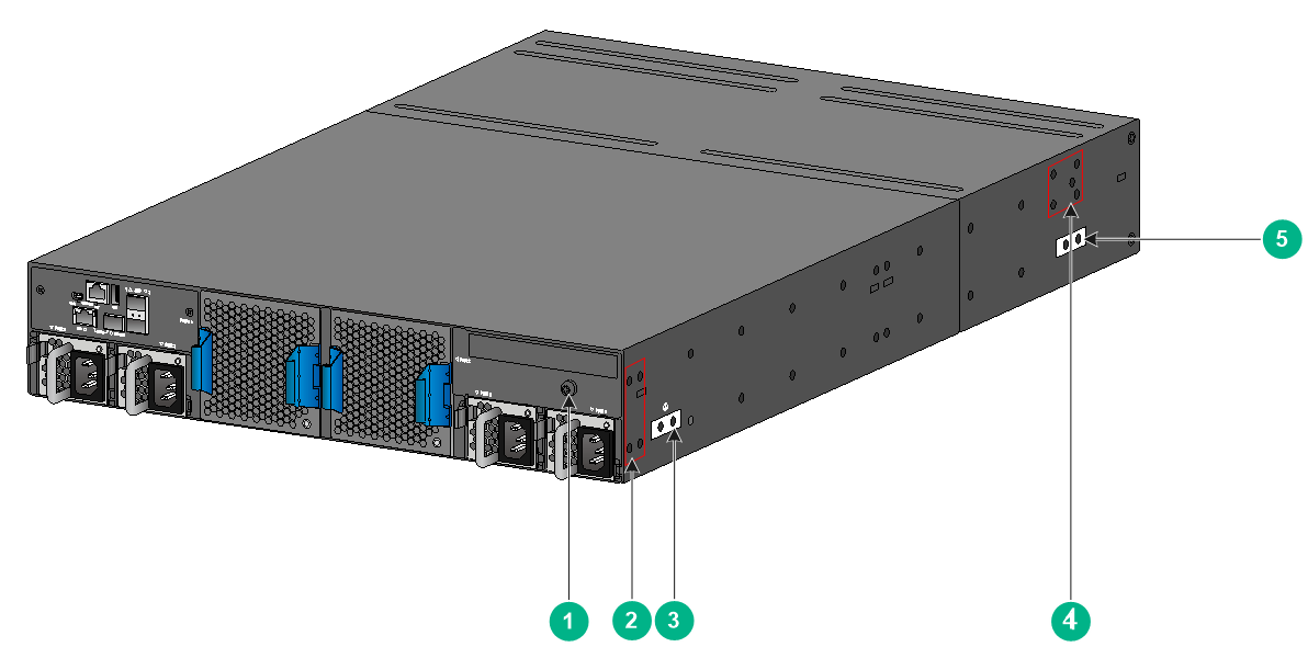

Mounting brackets, chassis rails, and grounding cable installation positions
The switch has one mounting position near the network ports and one mounting position near the power modules for mounting brackets.
The S6850-56HF switch provides two grounding points: primary grounding point (with a grounding sign) and auxiliary grounding point, as shown in Figure2-18. The S6850-2C switch provides two grounding points: primary grounding point (with a grounding sign) and auxiliary grounding point, as shown in Figure2-19. The S9850-4C switch provides three grounding points: primary grounding point (with a grounding sign), auxiliary grounding point 1, and auxiliary grounding point 2, as shown in Figure2-20. The S9850-32H switch provides two grounding points: primary grounding point (with a grounding sign) and auxiliary grounding point, as shown in Figure2-21.
Select installation positions for the mounting brackets, chassis rails, and grounding cable as required.
Figure2-18 Mounting brackets and grounding cable installation positions on the S6850-56HF switch
(1) Power module-side installation position for the mounting bracket |
(2) Primary grounding point |
(3) Auxiliary grounding point |
(4) Port-side installation position for the mounting bracket |
Figure2-19 Mounting brackets and grounding cable installation positions on the S6850-2C switch
Figure2-20 Mounting brackets and grounding cable installation positions on the S9850-4C switch
(1) Auxiliary grounding point 2 |
(2) Power module-side installation position for the mounting bracket |
(3) Primary grounding point |
(5) Auxiliary grounding point 1 |
Figure2-21 Mounting brackets and grounding cable installation positions on the S9850-32H switch

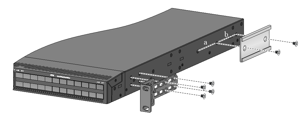

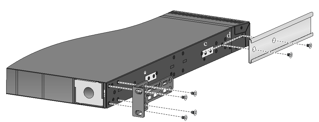

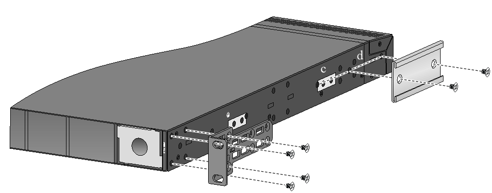

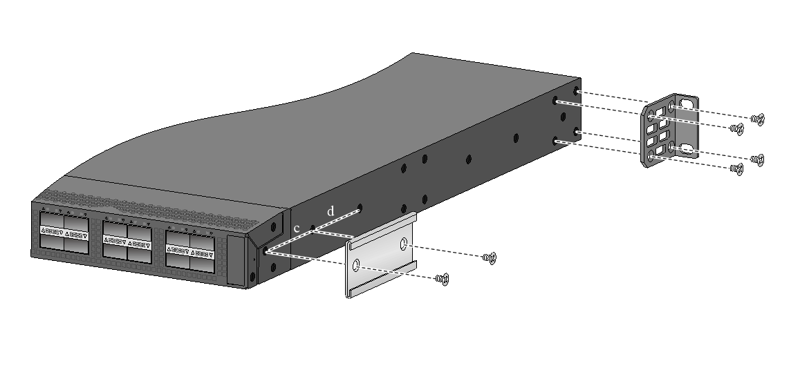

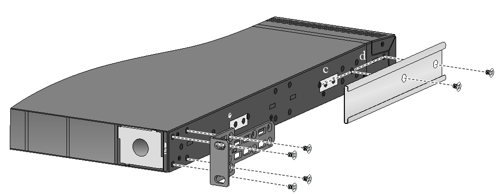

1. Place the wide flange of the mounting bracket against the chassis side panel. Align the mounting bracket installation holes with the appropriate screw holes in the chassis. Use the provided M4 screws to attach the mounting bracket to the chassis. As a best practice, use a torque of 12 kgf-cm (1.18 Nm) to fasten the M4 screws.
¡ To install the mounting brackets at the port-side mounting position, see Figure2-22, Figure2-23, Figure2-24, Figure2-28, Figure2-30, and Figure2-32.
Use four installation holes to secure the mounting brackets to the S6850-56HF, S6850-2C, and S9850-4C switches. Use three installation holes to secure the mounting brackets to the S9850-32H switch.
¡ To install the mounting brackets at the power module-side mounting position, see Figure2-25, Figure2-26, Figure2-27, Figure2-29, Figure2-31, and Figure2-33.
Use four installation holes to secure the mounting brackets to the switch.
2. Determine the installation position of the chassis rails based on the position of mounting brackets and the distance between the front and rear rack posts.
Table2-4 Chassis rail installation position
Switch model |
Mounting bracket position |
Distance between the front and rear rack posts |
Chassis rail installation position |
S6850-56HF (long slide rails) |
Port-side mounting position, as shown in Figure2-22 |
692 to 788 mm (27.24 to 31.02 in) |
Position a |
692 to 853 mm (27.24 to 33.58 in) |
Position b |
Power module-side mounting position, as shown in Figure2-25 |
Position c |
Position d |
S6850-56HF (super-short slide rails, chassis rails not reaching out of the chassis) |
Port-side mounting position, as shown in Figure2-23 |
401 to 500 mm (15.79 to 19.69 in) |
Position a |
457 to 565 mm (17.99 to 22.24 in) |
Position b |
Power module-side mounting position, as shown in Figure2-26 |
Position c |
Position d |
S6850-56HF (super-short slide rails, chassis rails reaching out of the chassis) |
Port-side mounting position, as shown in Figure2-24 |
499 to 627 mm (19.65 to 24.69 in) |
Position a |
564 to 692 mm (22.20 to 27.24 in) |
Position b |
Power module-side mounting position, as shown in Figure2-27 |
Position c |
Position d |
S6850-2C |
Port-side mounting position, as shown in Figure2-28 |
519 to 638 mm (20.43 to 25.12 in) |
Position a |
524 to 703 mm (20.63 to 27.68 in) |
Position b |
589 to 768 mm (23.19 to 30.24 in) |
Position c |
654 to 833 mm (25.75 to 32.80 in) |
Position d |
Power module-side mounting position, as shown in Figure2-29 |
Position e |
Position f |
520 to 638 mm (20.47 to 25.12 in) |
Position g |
S9850-4C |
Port-side mounting position, as shown in Figure2-30 |
675 to 923 mm (26.57 to 36.34 in) |
Position a |
611 to 858 mm (24.06 to 33.78 in) |
Position b |
546 to 793 mm (21.50 to 31.22 in) |
Position c |
518 to 728 mm (20.39 to 28.66 in) |
Position d |
Power module-side mounting position, as shown in Figure2-31 |
Position e |
Position f |
Position g |
S9850-32H (long slide rails) |
Port-side mounting position, as shown Figure2-32 |
621 to 788 mm (24.45 to 31.02 in) |
Position a |
621 to 853 mm (24.45 to 33.58 in) |
Position b |
Power module-side mounting position, as shown in Figure2-33 |
Position c |
Position d |
S9850-32H (short slide rails) |
Port-side mounting position, as shown in Figure2-32 |
401 to 588 mm (15.79 to 23.15 in) |
Position a |
454 to 633 mm (17.87 to 24.92 in) |
Position b |
Position c |
401 to 568 mm (15.79 to 22.36 in) |
Position d |
3. Place the chassis rail against the chassis side panel. Align the chassis rail installation holes with the screw holes. Use the provided M4 screws to attach the chassis rail to the chassis. See Figure2-22 to Figure2-31.
You can use super-short slide rails and long chassis rails to rack-mount the S6850-56HF switch. Based on the rack depth, install the long chassis rails with the chassis rails not reaching out of the chassis, as shown in Figure2-23 and Figure2-26 or with the chassis rails reaching out of the chassis, as shown in Figure2-24 and Figure2-27.
Figure2-22 Attaching the mounting brackets and chassis rails to the S6850-56HF switch (port-side mounting position for the mounting brackets, long slide rails)
Figure2-27 Attaching the mounting brackets and chassis rails to the S6850-56HF switch (power module-side mounting position for the mounting brackets, super-short slide rails, chassis rails reaching out of the chassis)
NOTE: Secure the mounting brackets and chassis rails to both sides of the chassis in the same way. |
IMPORTANT: · If the grounding cable length or terminal type cannot meet your requirement, make an applicable grounding cable or contact H3C Support. · If you use a grounding point on the side panel to ground the switch, connect the grounding cable to the grounding point before installing the switch in the rack. |
For an S6850-56HF, S6850-2C, or S9850-32H switch, the primary grounding point and auxiliary grounding point are on the left side panel. Both grounding points support a grounding cable that has a single-hole lug or dual-hole lug. Use M5 grounding screws to attach the grounding cable to the switch. Choose the grounding point according to the mounting bracket installation positions.
· If you install the mounting bracket at the port side, connect the grounding cable to the grounding point at the port side.
· If you install the mounting bracket at the power module side, connect the grounding cable to the grounding point at the power module side.
For an S9850-4C switch, the primary grounding point and auxiliary grounding point 1 are on the left side panel, and auxiliary grounding point 2 is on the rear panel. If you use a grounding cable that has a dual-hole lug, connect it to the primary grounding point or auxiliary grounding point 1. If you use a grounding cable that has a single-hole lug, connect it to auxiliary grounding point 2. Use M5 grounding screws to attach the grounding cable to the switch. Choose the grounding point according to the mounting bracket installation positions.
To connect the grounding cable:
1. Choose a grounding point as required.
2. Unpack the grounding cable and grounding screws.
3. Use the grounding screws to attach the grounding lug of the grounding cable to the grounding holes at the grounding point. Use a screwdriver to tighten the screws. See Figure2-34, Figure2-35, and Figure2-36.
As a best practice, use a torque of 30 kgf-cm (2.94 Nm) to fasten the grounding screws.
Figure2-35 Attaching a grounding cable that has a dual-hole lug to the grounding point (S6850-56HF)
Figure2-36 Attaching a grounding cable to auxiliary grounding point 2 on the S9850-4C switch

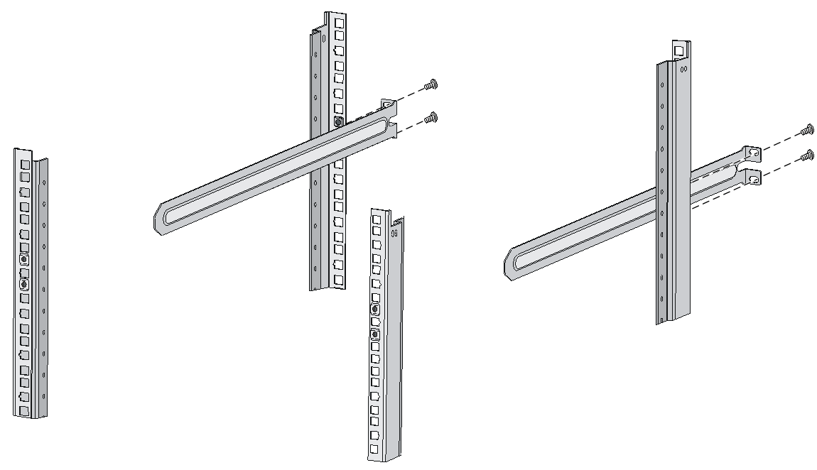

Attaching the slide rails to the rack
The procedure is the same for attaching 1U and 2U slide rails to the rack. This section uses the 1U slide rails as an example.
To attach the slide rails to the rack:
1. Identify the slide rail installation position in the rack.
2. Install cage nuts (user-supplied) in the mounting holes in the rack posts.
3. Align the screw holes in one slide rail with the cage nuts in a rear rack post. Use user-supplied M6 screws to attach the slide rail to the post. See Figure2-37.
As a best practice, use a torque of 30 kgf-cm (2.94 Nm) to fasten the M6 screws.
4. Repeat the preceding steps to attach the other slide rail to the other rear rack post.
Keep the two slide rails at the same height so the slide rails can attach into the chassis rails.
Figure2-37 Installing the 1U slide rails

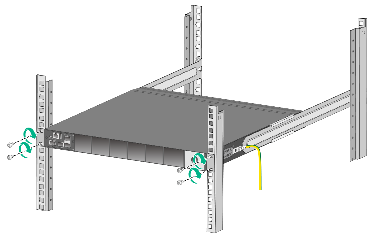

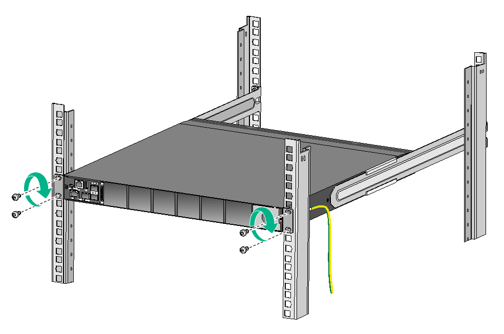

Mounting the switch in the rack
This task requires two people.
To mount the switch in the rack:
1. Wear an ESD wrist strap and make sure it makes good skin contact and is reliably grounded.
2. Verify that the mounting brackets and chassis rails have been securely attached to the switch chassis.
3. Verify that the slide rails have been correctly attached to the rear rack posts.
4. Attach cage nuts (user-supplied) to the front rack posts and make sure they are at the same level as the slide rails.
CAUTION: To rack-mount the S9850-4C switch by using 2U high mounting brackets and slide rails, use four M6 screws and four cage nuts to attach each mounting bracket to the rack, as shown in Figure2-42 and Figure2-43. |
5. One person performs the following operations:
a. Supporting the bottom of the switch, aligns the chassis rails with the slide rails on the rack posts.
b. Pushes the switch slowly to slide the chassis rails along the slide rails until the mounting brackets are flush with the rack posts.
IMPORTANT: · If you use long slide rails to rack-mount the S6850-56HF, make sure the front ends of the long slide rails reach out of the chassis rails for a maximum of 20 mm (0.79 in). If you use super-short slide rails to rack-mount the S6850-56HF, make sure the front ends of the super-short slide rails reach inside the chassis rails for a minimum of 90 mm (3.54 in) after installation. · To rack-mount the S6850-2C and S9850-32H, make sure the front ends of the slide rails reach out of the chassis rails for a minimum of 20 mm (0.79 in) after installation. · To rack-mount the S9850-4C, make sure the front ends of the slide rails reach out of the chassis rails for a minimum of 30 mm (1.18 in) after installation. |
6. Another person uses user-supplied M6 screws to attach the mounting brackets to the rack.
Figure2-39 Mounting the S6850-56HF switch in the rack (power module-side mounting position for the mounting brackets)
Figure2-40 Mounting the S6850-2C switch in the rack (port-side mounting position for the mounting brackets)
Figure2-41 Mounting the S6850-2C switch in the rack (power module-side mounting position for the mounting brackets)
Figure2-44 Mounting the S9850-32H switch in the rack (port-side mounting position for the mounting brackets)
Figure2-45 Mounting the S9850-32H switch in the rack (power module-side mounting position for the mounting brackets)

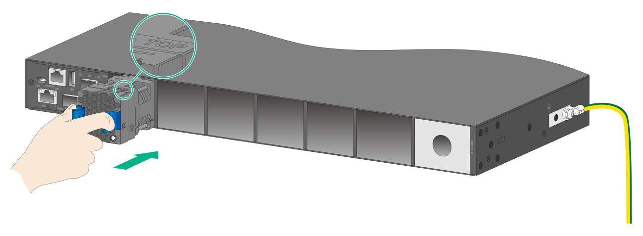

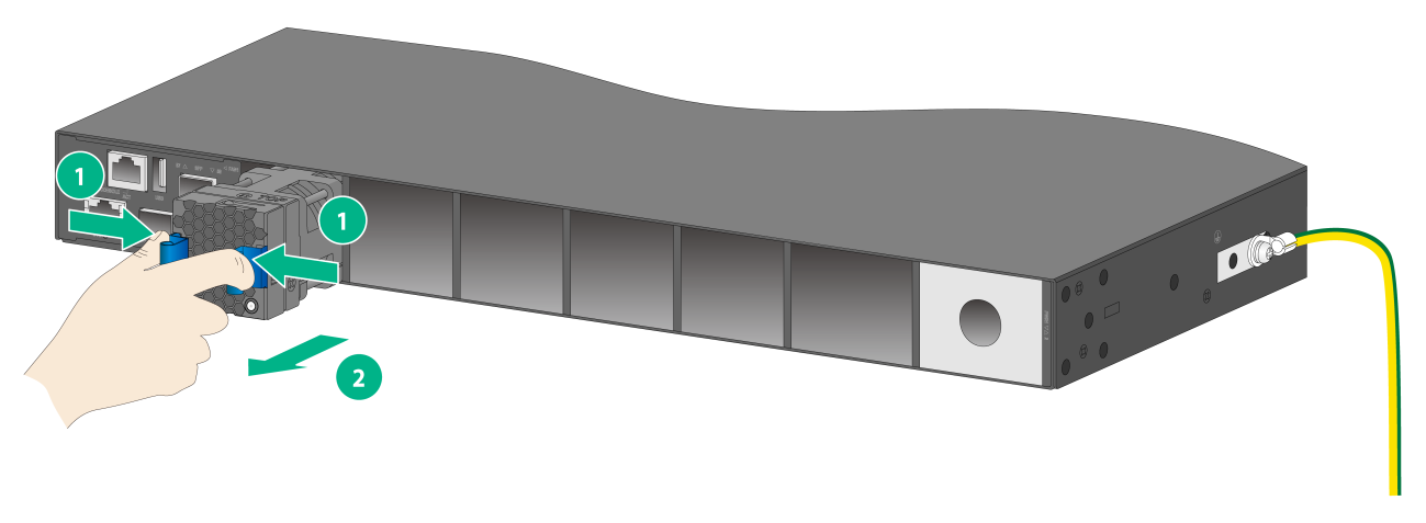

Installing/removing fan trays
CAUTION: The switch has multiple fan tray slots. To ensure good ventilation of the switch, follow these guidelines to install and remove fan trays: · The switch is provided with the fan tray slots empty. Before powering on the switch, make sure all fan tray slots have fan trays installed and the fan trays are the same model. · Make sure all slots have a module or filler panel installed when the switch is operating. · If multiple fan trays fail on an operating S6850-56HF, S6850-2C, or S9850-32H switch, do not remove the fan trays at the same time. Replace the fan trays one after another and finish replacing a fan tray within 3 minutes. · If a fan tray fails on an operating S9850-4C switch, replace the fan tray immediately and keep the failed fan tray in position before replacement. If two fan trays fail, finish replacing the fan trays within 1 minute. |
The installation and removal procedures are the same for fan trays of different models. The following installation and removal procedures use the LSWM1FANSA fan tray as an example.
Installing a fan tray
CAUTION: To prevent damage to the fan tray or the connectors on the backplane, insert the fan tray gently. If you encounter a hard resistance while inserting the fan tray, pull out the fan tray and insert it again. |
IMPORTANT: Before powering on the switch, make sure the fan tray airflow direction and the preferred airflow direction of the switch are the same. If they are not the same, the system generates traps and logs. You can use the fan prefer-direction command to configure the preferred airflow direction for the switch. By default, the preferred airflow direction of the switch is from the port side to the power module side. For more information about the fan prefer-direction command, see H3C S6805 & S6825 & S6850 & S9850 Switch Series Fundamentals Command Reference. |
Select fan trays for the switch as needed. For the available fan trays and their specifications, see H3C S6850 & S9850 Switch Series Hardware Information and Specifications.
The switch supports shipping with fan trays and power modules installed. If your switch came with fan trays preinstalled, skip this section.
To install a fan tray:
2. Unpack the fan tray and verify that the fan tray model is correct.
3. Orient the fan tray with the "TOP" mark on top. Grasp the handle of the fan tray with one hand and support the fan tray bottom with the other, and slide the fan tray along the guide rails into the slot until the fan tray is fully seated in the slot and has a firm contact with the backplane. See Figure2-47.
Figure2-47 Installing an LSWM1FANSA fan tray in the S6850-56HF switch
Removing a fan tray
WARNING! · Ensure electricity safety and never touch the rotating fans when you hot-swap a fan tray. · To prevent a fan from causing loud noise, do not touch the fan blades and rotation axis, even if the fan is not rotating. |
To remove a fan tray:
2. Grasp the handle of the fan tray with one hand and pull the fan tray part way out of the slot. Support the fan tray bottom with the other and pull the fan tray completely out of the slot.
3. Put the removed fan tray in an antistatic bag.
Figure2-48 Removing an LSWM1FANSA fan tray

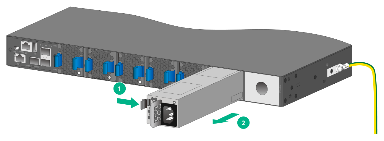

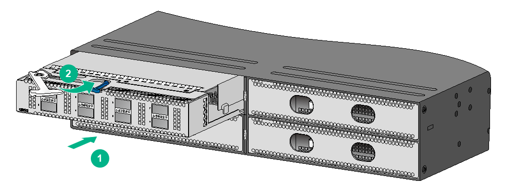

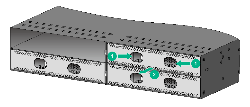

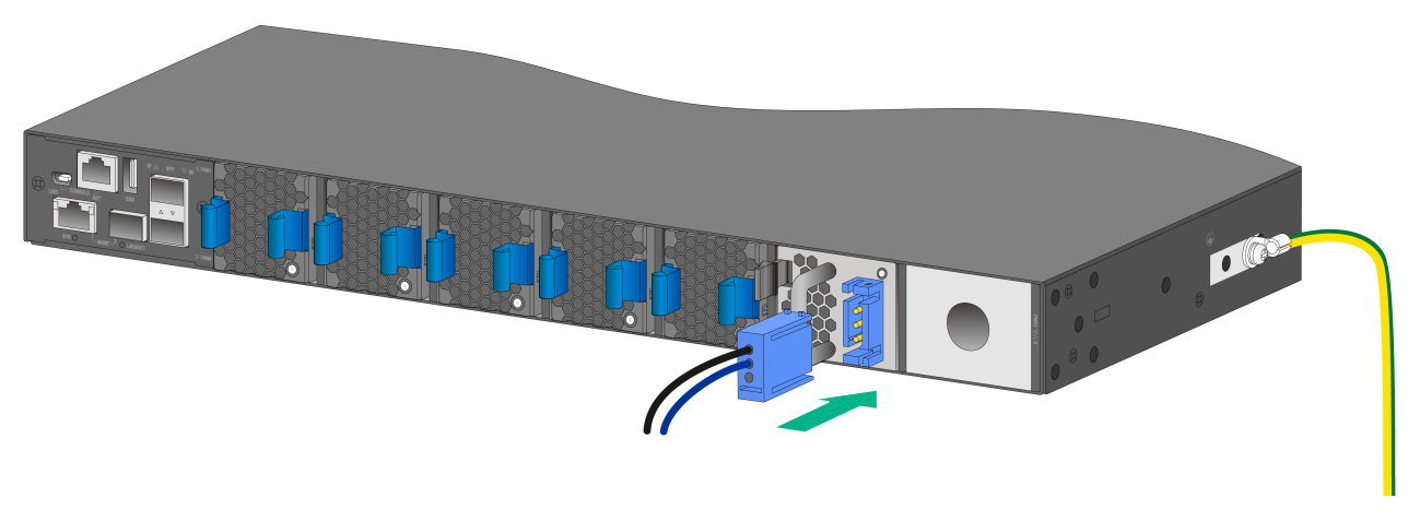

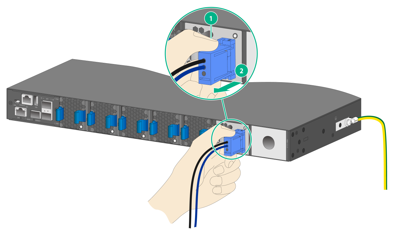

Installing/removing power modules
WARNING! · To avoid bodily injury and device damage, strictly follow the procedures in Figure2-49 and Figure2-50 to install and remove a power module. · Provide a separate circuit breaker for each power module. |
The S6850-56HF, S6850-2C, and S9850-32H switches each have two power module slots. The S9850-4C switch has four power module slots. The S6850-56HF, S6850-2C, and S9850-32H switches each come with one power module slot empty and one installed with a filler panel. The S9850-4C switch comes with two power module slots empty and two installed with filler panels. You can install power modules for the switch as required.
For information about the available power modules, see H3C S6850 & S9850 Switch Series Hardware Information and Specifications.
Figure2-49 Installation procedure
Installing a power module
CAUTION: · Follow the forward inertia of the power module when inserting it into the chassis, and make sure the power module has firm contact with the connectors on the backplane. · To prevent damage to the connectors inside the switch chassis, insert the power module gently. If you encounter a hard resistance while inserting the power module, pull out the power module and insert it again. |
The switch supports shipping with fan trays and power modules installed. If your switch came with power modules preinstalled, skip this section.
The LSVM1AC650 and LSVM1DC650 installation procedure is the same on the S6850 and S9850 series switches. The figures in this section use the S6850-56HF switch as an example.
To install a power module:
2. Remove the filler panel, if any, from the target power module slot, as shown in Figure2-51.
Figure2-51 Removing a filler panel
3. Unpack the power module and verify that the power module model is correct.
4. Correctly orient the power module with the words on the power module upward. Grasp the handle of the power module with one hand and support its bottom with the other, and slide the power module slowly along the guide rails into the slot.
The slot is foolproof. If you cannot insert the power module into the slot, re-orient the power module rather than use excessive force to push it in.
Figure2-52 Installing a power module (LSVM1AC650)
Removing a power module
CAUTION: · When an S6850-56HF, S6850-2C, or S9850-32H switch has two power modules in 1+1 redundancy mode, removing one power module does not affect the operation of the switch. When the switch has only one power module installed, removing the power module powers off the switch. · When an S9850-4C switch has power modules in 2+1 or 2+2 redundancy mode, removing one or two power modules does not affect the operation of the switch. When the switch has only two power modules installed, removing power modules powers off the switch or causes power insufficiency. |
The LSVM1AC650 and LSVM1DC650 removal procedure is the same on the S6850 and S9850 series switches. The figures in this section use the S6850-56HF switch as an example.
To remove a power module:
2. Remove the power cord from the power module. To remove a DC power cord, squeeze the tabs on the power cord connector with your thumb and forefinger, and then pull the connector out, as shown in Figure2-53.
3. Hold the handle on the power module with one hand, pivot the latch on the power module to the right with your thumb, and pull the power module part way out of the slot, as shown in Figure2-54.
4. Supporting the power module bottom with one hand, slowly pull the power module out with the other hand.
5. Put the removed power module in an antistatic bag for future use.
6. If you are not to install a new power module, install a filler panel in the slot to ensure good ventilation in the switch, as shown in Figure2-55.
Figure2-53 Removing the DC power cord
(1) Press the tabs on the power cord connector with your thumb and forefinger |
(2) Pull the power cord connector out |
Figure2-54 Removing the power module
(1) Pivot the latch to the right with your thumb |
(2) Pull the power module out |
Figure2-55 Installing a filler panel

Connecting a DC power cord
1. Align the power cord plug with the power receptacle on the power module, and insert the plug into the receptacle (see Figure2-57).
The plug and receptacle are foolproof. If you cannot insert the plug into the receptacle, re-orient the plug rather than use excessive force to push it in.
2. Use a cable tie to secure the power cord to the handle of the power module, as shown in Figure2-56.
3. Connect the other end of the power cord to the DC power source.
Figure2-57 Connecting a DC power cord to the LSVM1DC650 power module
If the provided DC power cord cannot meet your connection requirements, use the following table to prepare a suitable copper cable as the DC power cord.
Table2-5 Requirements for a suitable DC power cord
Power module model |
Power cord connector |
Minimum cross sectional area of the conductor |
Cross sectional area of the provided power cord |
Maximum cross sectional area of the conductor |
LSVM1DC650 |
Use the connector of the provided power cord |
3.3 mm2 or 12 AWG |
3.3 mm2 or 12 AWG |
5.3 mm2 or 10 AWG |

Installing an expansion module
1. Wear an ESD wrist strap and make sure the wrist strap makes good skin contact and is reliably grounded.
2. (Optional.) If the target expansion slot has a filler panel installed, remove the filler panel, as shown in Figure2-58.
a. Use your thumb and forefinger to hold the filler panel through the two holes.
b. Push right the metal tab in the left hole and pull out the filler panel along the guide rails.
Figure2-58 Removing the filler panel from the expansion slot
Keep the removed filler panel secure for future use.
3. Unpack the expansion module.

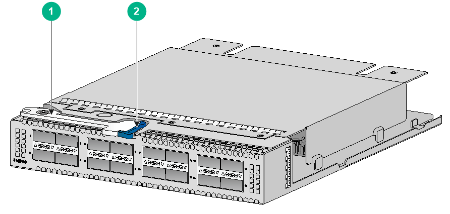

4. Press the latch on the expansion module to release the ejector lever.
Figure2-59 LSWM18CQ interface module
(1) Ejector lever |
(2) Latch |
5. Insert the expansion module slowly into the slot along the guide rails, as shown by callout 1 in Figure2-60.
6. Rotate inward the ejector lever as shown by callout 2 in Figure2-60 until the latch locks the ejector lever in place.
Figure2-60 Installing the LSWM18CQ interface module

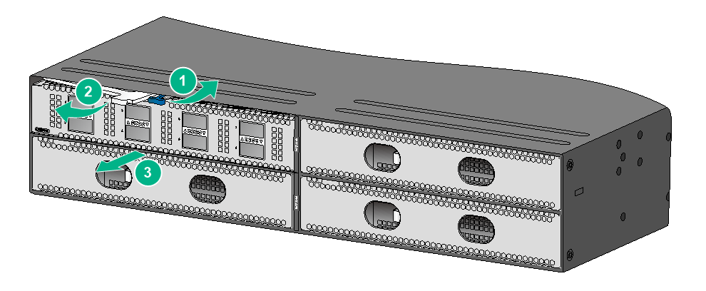

Removing an expansion module
CAUTION: · Before you remove an expansion module, remove the cable from it to avoid cable damage. · If you are not to install a new expansion module after removing the original one, install a filler panel in the slot to prevent dust and ensure good ventilation. |
To remove an expansion module:
1. Prepare an anti-static bag.
2. Wear an ESD wrist strap and make sure the wrist strap makes good skin contact and is reliably grounded.
3. Press the latch to release the ejector lever as shown by callout 1 in Figure2-61.
4. Rotate outward the ejector lever as shown by callout 2 in Figure2-61.
5. Pull out the expansion module slowly out of the expansion slot, as shown by callout 3 in Figure2-61.
6. Place the removed expansion module in the anti-static bag.
Figure2-61 Removing an LSWM18CQ interface module

The example uses a serial console cable to connect a console terminal (PC) to the serial console port on the switch.
Figure3-1 Connecting the serial console port to a terminal

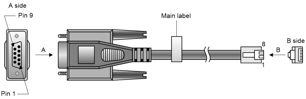

Connecting the console cable
A serial console cable is an 8-core cable, with a crimped RJ-45 connector at one end for connecting to the serial console port of the switch, and a DB-9 female connector at the other end for connecting to the serial port on the console terminal.
Figure3-2 Serial console cable
Table3-3 Console port signaling and pinout
RJ-45 |
Signal |
DB-9 |
Signal |
1 |
RTS |
8 |
CTS |
2 |
DTR |
6 |
DSR |
3 |
TXD |
2 |
RXD |
4 |
SG |
5 |
SG |
5 |
SG |
5 |
SG |
6 |
RXD |
3 |
TXD |
7 |
DSR |
4 |
DTR |
8 |
CTS |
7 |
RTS |
To connect a configuration terminal (for example, a PC) to the switch through a DB9-to-RJ45 console cable:
1. Plug the DB-9 female connector of the DB9-to-RJ45 console cable to the serial port on the PC.
2. Connect the RJ-45 connector to the serial console port on the switch.

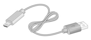

A mini USB console cable has a USB mini-Type B connector at one end to connect to the mini USB console port of the switch, and a standard USB Type A connector at the other end to connect to the USB port on the configuration terminal.
To connect to the configuration terminal through the USB mini console cable:
1. Connect the standard USB Type A connector to the USB port of the configuration terminal.
2. Click the following link, or copy it to the address bar on the browser to log in to download page of the USB console driver, and download the driver.
http://www.h3c.com/en/home/USB_Console/,
3. Run Installer to preinstall the driver. After the preinstallation finishes, the system pops up a dialog box to indicate a successful preinstallation.
4. Connect the USB mini-Type B connector to the Mini USB console port on the switch. The system installs the driver automatically.

4 Setting up an IRF fabric
You can use H3C IRF technology to connect and virtualize multiple S6850/S9850 switches into a large virtual switch called an "IRF fabric" for flattened network topology, and high availability, scalability, and manageability.
IRF fabric setup flowchart
Figure4-1 IRF fabric setup flowchart
To set up an IRF fabric:
Step |
Description |
1. Plan IRF fabric setup. |
Plan the installation site and IRF fabric setup parameters: · Planning IRF fabric size and the installation site · Identifying the master switch and planning IRF member IDs · Planning IRF topology and connections |
2. Install IRF member switches. |
3. Connect ground wires and power cords. |
See "Grounding the switch" and "Connecting the power cords." |
4. Power on the switches. |
N/A |
5. Configure basic IRF settings. |
See H3C S6805 & S6825 & S6850 & S9850 Switch Series Virtual Technologies Configuration Guide. |
6. Connect the physical IRF ports. |
Connect the physical IRF ports on switches. Use QSFP28/QSFP+ transceiver modules and fibers for connections over long distances. Use QSFP28/QSFP+ cables for connections over short distances. All switches except the master switch automatically reboot, and the IRF fabric is established. |

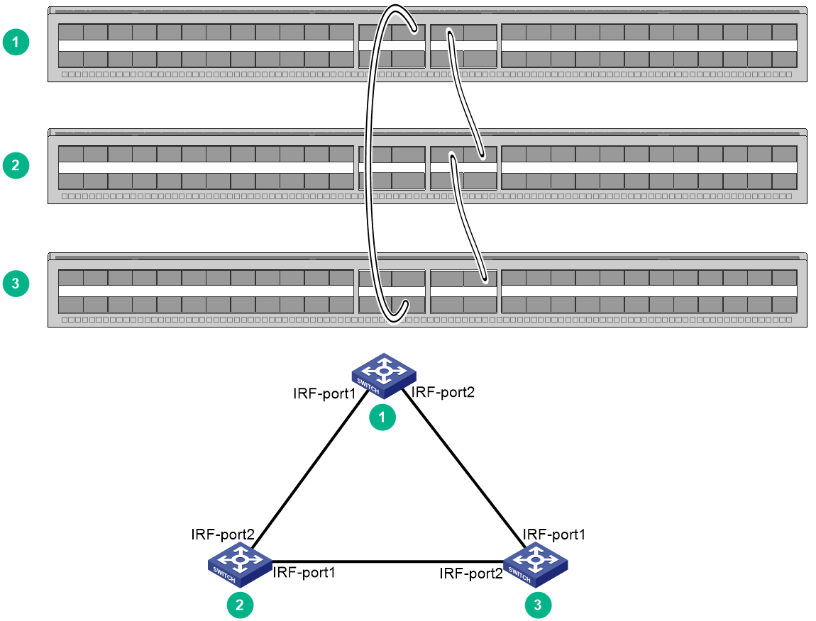

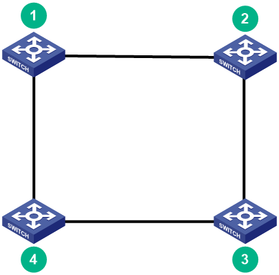

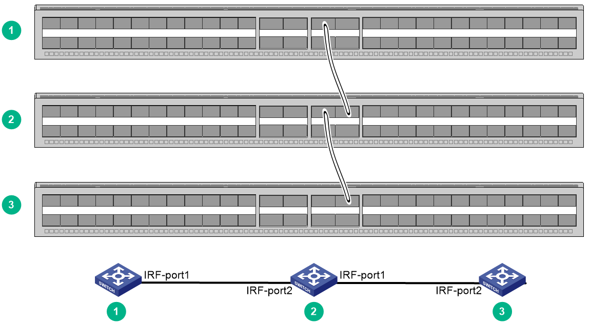

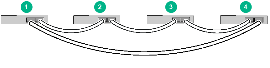

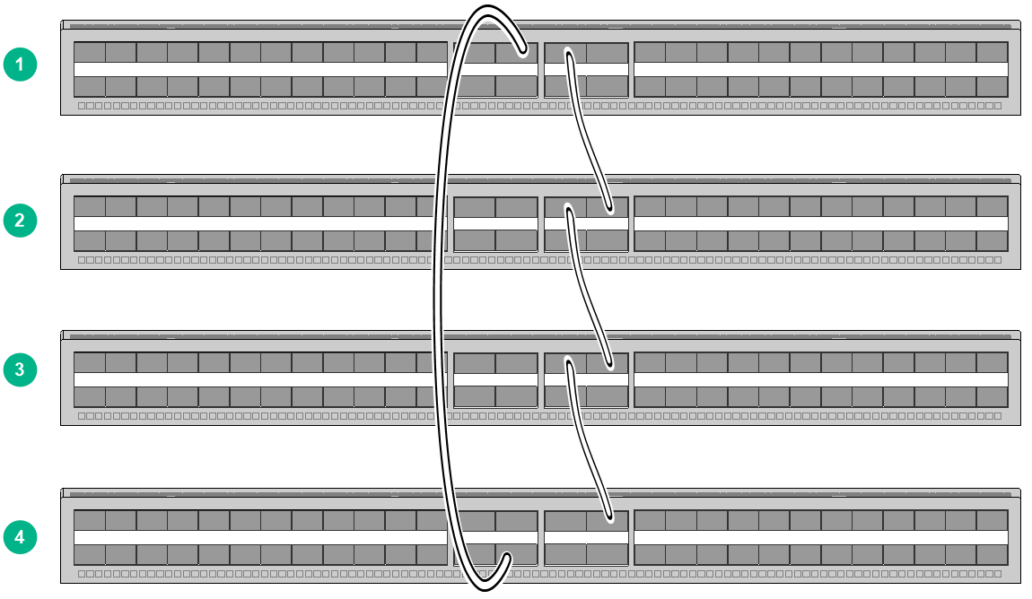

You can create an IRF fabric in daisy chain topology, or more reliably, ring topology. In ring topology, the failure of one IRF link does not cause the IRF fabric to split as in daisy chain topology. Rather, the IRF fabric changes to a daisy chain topology without interrupting network services.
You connect the IRF member switches through IRF ports, the logical interfaces for the connections between IRF member switches. Each IRF member switch has two IRF ports: IRF-port 1 and IRF-port 2. To use an IRF port, you must bind a minimum of one physical port to it.
When connecting two neighboring IRF member switches, you must connect the physical ports of IRF-port 1 on one switch to the physical ports of IRF-port 2 on the other switch.
The IRF port connections in the two figures are for illustration only, and more connection methods are available.
Figure4-2 IRF fabric in daisy chain topology
Figure4-3 IRF fabric in ring topology

Connecting the IRF member switches in one rack
Figure4-4 shows an example for connecting four IRF member switches in a rack. The switches in the ring topology (see Figure4-5) are in the same order as connected in the rack.
Figure4-4 Connecting the switches in one rack
Connecting the IRF member switches in a ToR solution
You can install IRF member switches in different racks side by side to deploy a top of rack (ToR) solution.
Figure4-6 shows an example for connecting four top of rack IRF member switches. The topology is the same as Figure4-5.
Configuring basic IRF settings
After you install the IRF member switches, power on the switches, and log in to each IRF member switch (see H3C S6805 & S6825 & S6850 & S9850 Switch Series Fundamentals Configuration Guide) to configure their member IDs, member priorities, and IRF port bindings.
Follow these guidelines when you configure the switches:
· Assign the master switch higher member priority than any other switch.
· Bind physical ports to IRF port 1 on one switch and to IRF port 2 on the other switch. You perform IRF port binding before or after connecting IRF physical ports depending on the software release.
· Execute the display irf configuration command to verify the basic IRF settings.
For more information about configuring basic IRF settings, see H3C S6805 & S6825 & S6850 & S9850 Switch Series Virtual Technologies Configuration Guide.

Power module failure
Symptom
The power module status LED on a power module is not steady green.
For more information about the LEDs on a power module, see H3C LSVM1AC650 & LSVM1DC650 Power Modules User Manual.
Solution
To resolve the issue:
1. Verify that the power cord is connected correctly.
2. Verify that the power source is as required by the switch.
3. Verify that the operating temperature of the switch is in the acceptable range and the power module has good ventilation.
4. If the issue persists, contact H3C Support.
To replace a power module, see "Installing/removing power modules."
