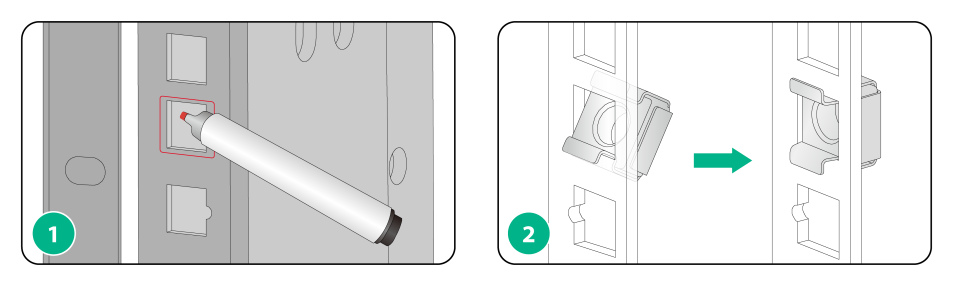

Before mounting the chassis in the rack, attach cage nuts to the front rack posts.
1.     Determine the installation holes for cage nuts based on the mounting holes in the mounting brackets and the installation position of the slide rails.
You can use a reference (such as a tape measure) to record the installation holes of the mounting brackets and mark the cage nut holes on the rack posts accordingly.
2.     Install cage nuts into the marked square holes on the front rack posts.
Figure3-1 Installing cage nuts

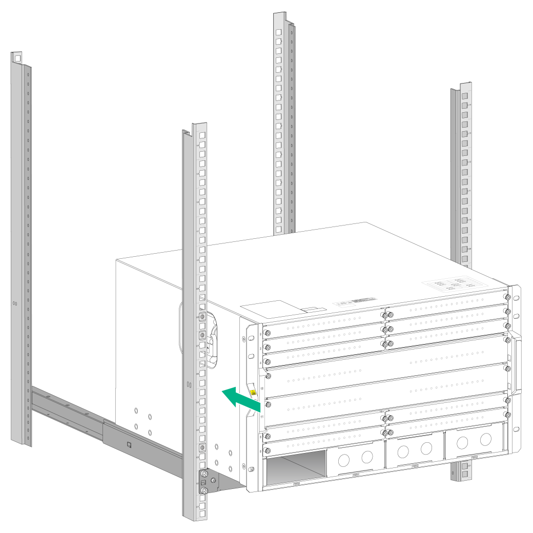

1.     Orient the chassis with its rear facing the front of the rack.
2.     Use a minimum of four people to lift the router by using the handles or supporting the bottom of the chassis until the bottom of the router is a little higher than the slide rails on the rack.
3.     Place the router on the slide rails and slide the router along the slide rails until the mounting brackets on the router are flush against the front rack posts.
Figure3-2 Mounting the chassis on the slide rails

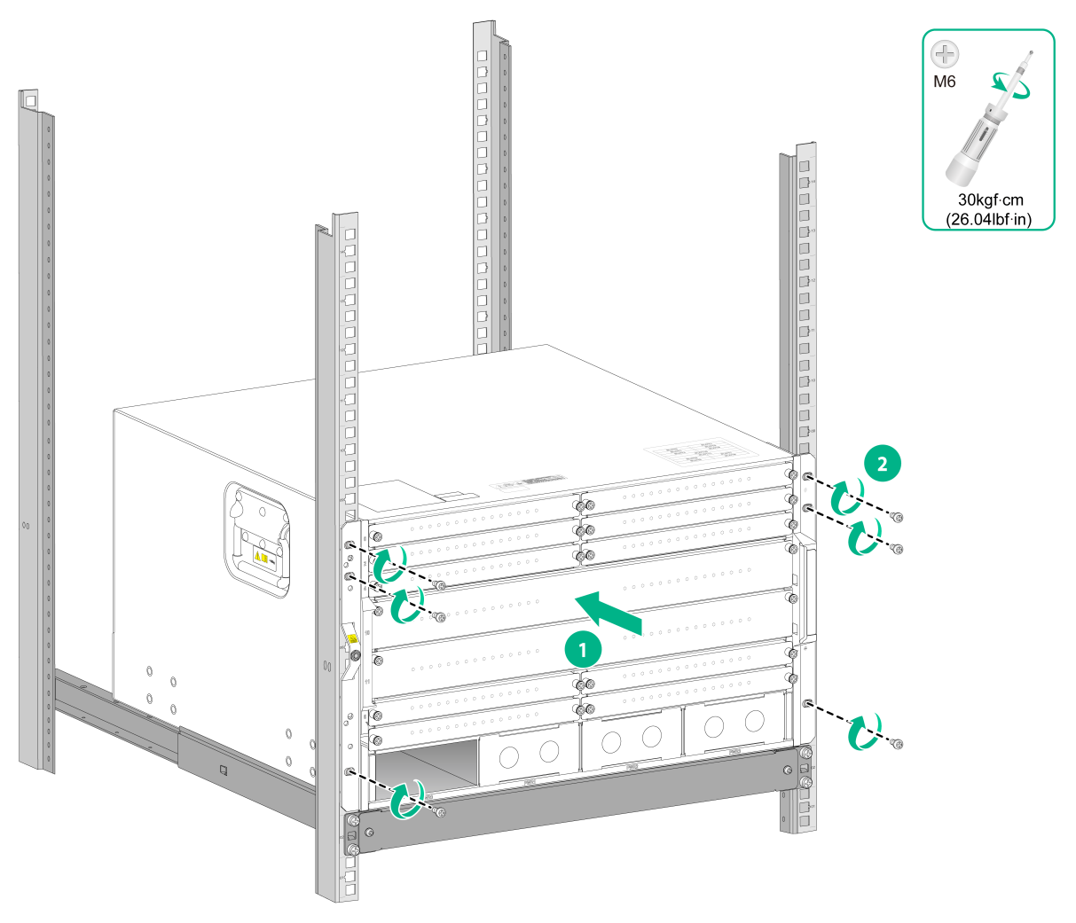

4.     Attach the chassis to the rack with mounting screws.
Figure3-3 Mounting the chassis in the rack
If the mounting holes in the mounting brackets cannot align with the cage nuts on the rack, verify that the bottom edge of the slide rail aligns with the middle of the narrower metal area between holes and that the cage nuts are installed in the correct holes.

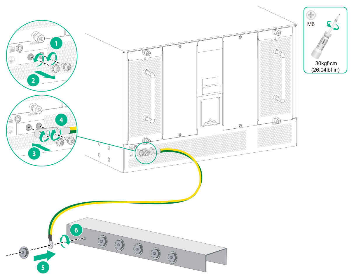

If a grounding strip is available at the installation site, ground the router by connecting the grounding cable to the grounding strip.
1.     Unpack the grounding cable.
The grounding cable provided with the router is compliant with the NEBS standards, with a dual-hole grounding lug at one end for connecting to the chassis and a ring terminal at the other end for connecting the grounding strip.
2.     As shown by callouts 1 and 2 in Figure3-4, remove the grounding screws from the grounding holes at the rear of the chassis.
3.     As shown by callouts 3 and 4 in Figure3-4, use the grounding screws to attach the dual-hole grounding lug of the grounding cable into the grounding holes of the chassis.
4.     As shown by callouts 5 and 6 in Figure3-4, connect the ring terminal of the grounding cable to a grounding post on the grounding strip, and fasten the grounding cable to the grounding post with the hex nut.
Figure3-4 Connecting the grounding cable to a grounding strip
