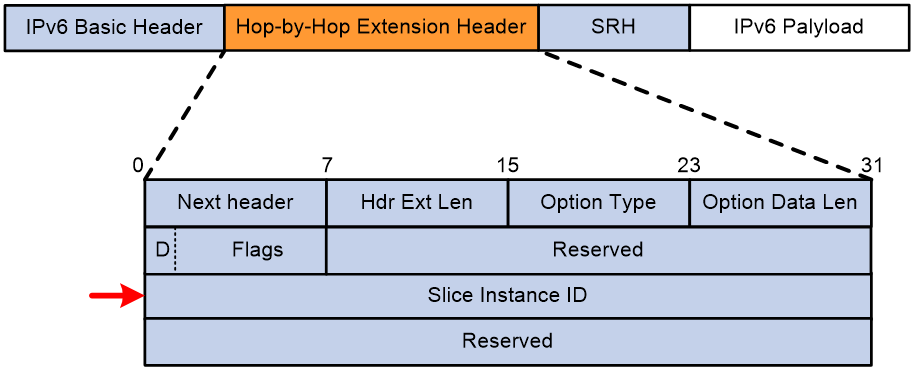

Network slice packet format
When forwarding a packet, an SRv6 source node adds an IPv6 hop-by-hop extension header to the packet. The IPv6 hop-by-hop extension header contains an NSI ID. As shown in Figure 1, an IPv6 hop-by-hop extension header contains the following key fields:
·     Option TypeOption type. The value for this field is 0x12, indicating that the option is an NSI ID option.
·     Flags—This field is 8 bits long. The first bit of it is D flag (drop flag). The D flag determines how the device processes a packet that fails to match any network slice channel on the output interface.
¡     If the D flag is set to 0, the device ignores the NSI ID in the packet and forwards the packet out of the output interface.
¡     If the D flag is set to 1, the device cannot ignore the NSI ID in the packet. The packet is dropped.
·     Slice Instance ID—ID of the NSI to which the packet belongs. This field is 32 bits long.
Figure 1 IPv6 hop-by-hop extension header that contains an NSI ID

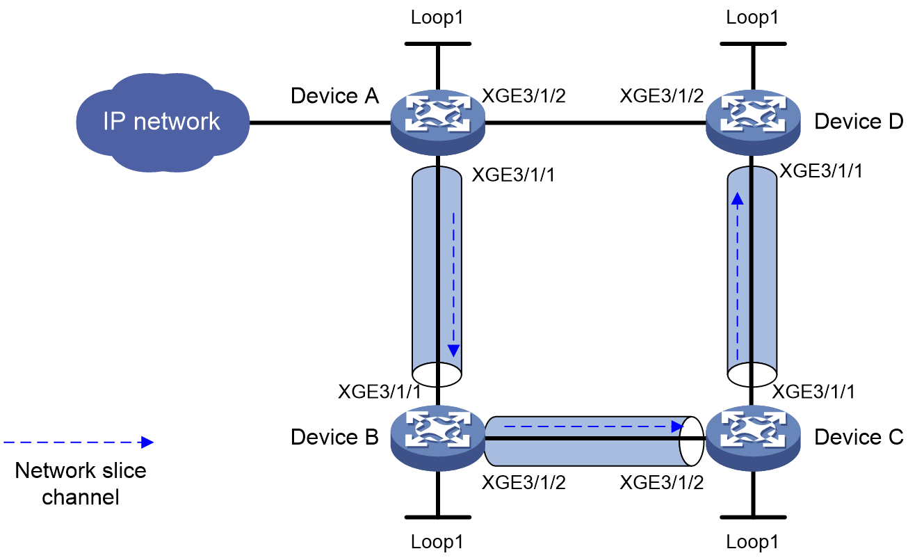

Network slice packet forwarding
The NSI ID is a key identifier for SRv6 network slicing. A network slice packet always carries an NSI ID. You must associate an SRv6 TE policy with an NSI ID as follows:
·     Manually specify the NSI ID for the SRv6 TE policy.
·     The device learns the NSI ID from the BGP IPv6 SR policy route advertised by the peer.

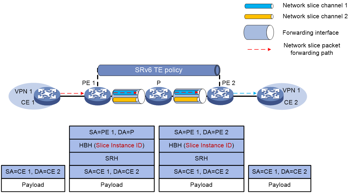

The following describes how SRv6 network slice packets are forwarded in an L3VPNv4 over SRv6 TE network.
The SRv6 network contains NSI 1 and NSI 2. The interfaces on PE 1, P, and PE 2 contain network slice channel 1 and network slice channel 2 that correspond to NSI 1 and NSI 2, respectively. In VPN 1, an SRv6 TE policy carries traffic between CE 1 and CE 2, and is associated with NSI 1. A packet from CE 1 to CE 2 is forwarded as follows:
1.     CE 1 sends an IPv4 unicast packet to PE 1. After receiving the packet from CE 1, PE 1 looks up the VPN instance routing table, and finds the route that uses an SRv6 TE policy as the output interface. PE 1 encapsulates the following information into the packet:
¡     The SRH header that carries the SID list of the SRv6 TE policy.
¡     The HBH extension header that carries the NSI ID associated with the SRv6 TE policy. The NSI ID is 1.
¡     IPv6 basic header.
2.     PE 1 forwards the packet to P through the network slice channel that matches the NSI ID.
3.     P forwards the packet based on the SRH header through the network slice channel that matches the NSI ID.
4.     After receiving the packet, PE 2 looks up the local SID list based on the destination IPv6 address of the packet, and finds the End SID. PE 2 reduces the SL of the packet by 1, and updates the destination IPv6 address to the End.DT4 SID. PE 2 looks up the local SID list, and performs the forwarding action corresponding to the End.DT4 SID. PE 2 decapsulates the IPv6 header, and finds VPN 1 that matches the End.DT4 SID. It then looks up the routing table of VPN 1, and forwards the packet to CE 2.
Figure 2 SRv6 network slice packet forwarding
