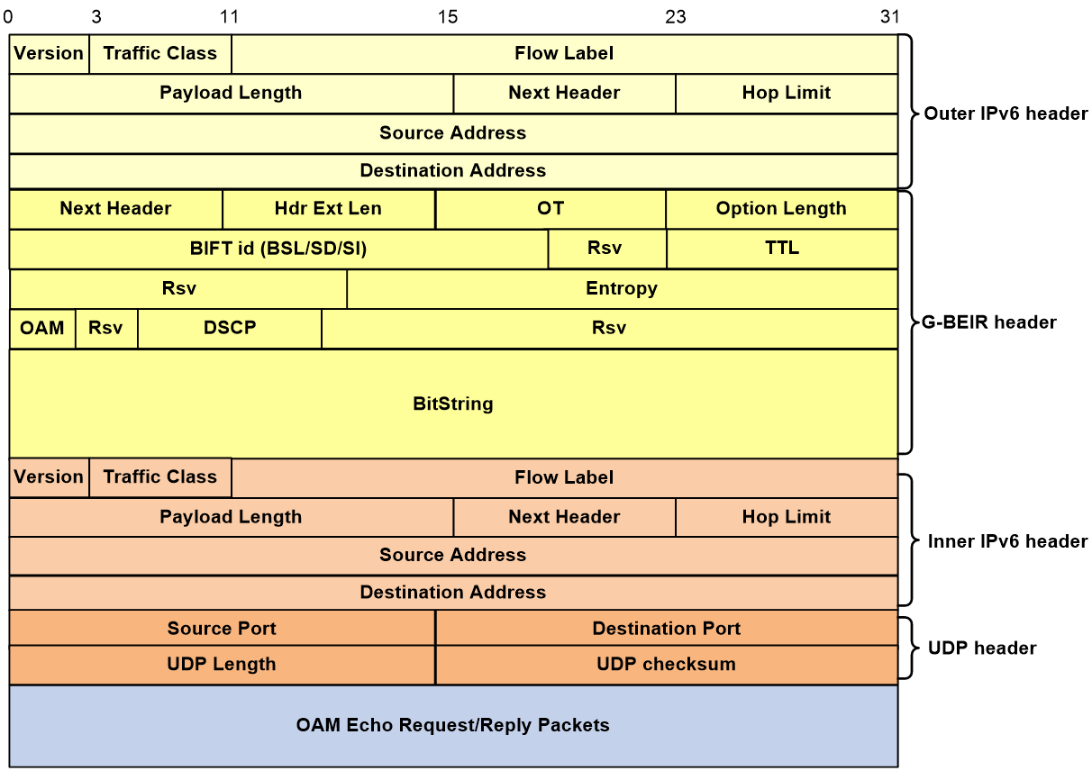

G-BIER ping and tracert add three headers: a UDP header, an IPv6 header, and an IPv6 G-BIER header in sequence to an OAM echo request or reply and transmit it over a BIER tunnel.
G-BIER OAM uses a UDP port number (default 49100) to listen and receive request packets. Upon receipt of a request, the destination responses with a UDP packet.
G-BIER OAM packet format
G-BIER ping and tracert use G-BIER echo requests and replies for network diagnosis. Figure 1 shows the format of a G-BIER echo request or reply packet.
Figure 1 G-BIER OAM echo request/reply packet format
·     G-BIER header: For detailed information about the fields in the G-BIER header, see BIER Configuration Guide.
·     IPv6 header:
¡     Source Address—IPv6 source address, 32 bits in length. In a request packet, the value of this field is consistent with that in the G-BIER header. In  a reply packet, the value of this field is the prefix of the destination BRF.
¡     Destination Address—IPv6 destination address, 32 bits in length. In a request packet, the value of this field is fixed at 0:0:0:0:0:FFFF:7F00:1. In a reply packet, the value of this field is the source IPv6 address of the request.
·     UDP header:
¡     Source Port—UDP source port number, 16 bits in length.
¡     Destination Port—UDP destination port number, 16 bits in length.
¡     UDP Length—UDP datagram length, 16 bits in length.
¡     UDP Checksum—UDP checksum, 16 bits in length. It is used to verify the integrity of the transmitted data.

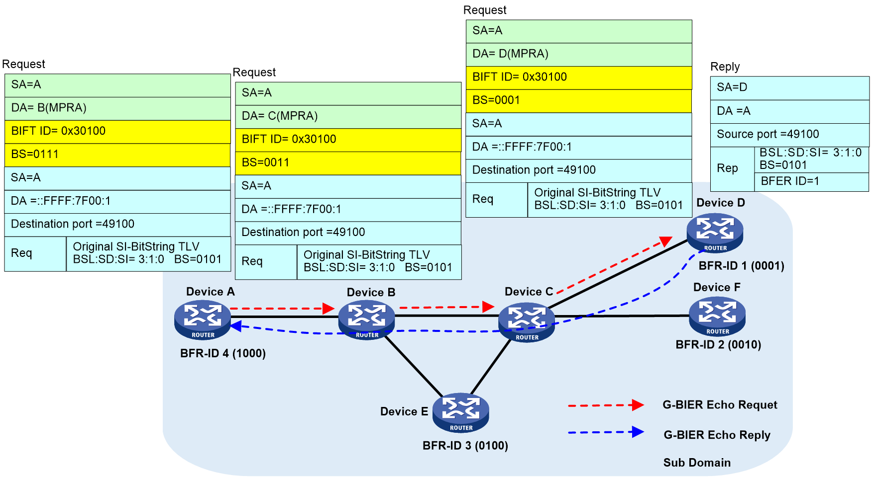

Figure 2 shows a G-BIER ping procedure. In this example, the packet is transmitted over the Device A→Device B→Device C→Device D path.
Figure 2 G-BIER ping
1.     Device A determines the BIER triplet information (BSL, sub-domain, and SI) based on the ping command and identifies the BIFT ID, 0x30100 in this example.
2.     Device A looks up BIFT 0x30100 and determines Device B as the next-hop adjacency. Then, it encapsulates the G-BIER echo request in a G-BIER header and transmits the packet to Device B. Within the G-BIER header, the destination IPv6 address is set to Device B’s MPRA, and BS is set to 0111.
3.     Device B looks up the local BIER forwarding table and then forwards the packet to Device C.
4.     Device C looks up the local BIER forwarding table and then forwards the packet to Device D.
5.     Upon receipt of the echo request, Device D which is the destination node returns an echo reply packet to Device A.
6.     Upon receiving the echo reply, Device A compares the key fields of the reply packet with those of the request packet it sent. If the fields match, Device A outputs reply information. If the fields do not match, Device A ignores the packet.
7.     If Device A does not receive a response from the specified destination node within the specified waiting time, it outputs a timeout message.

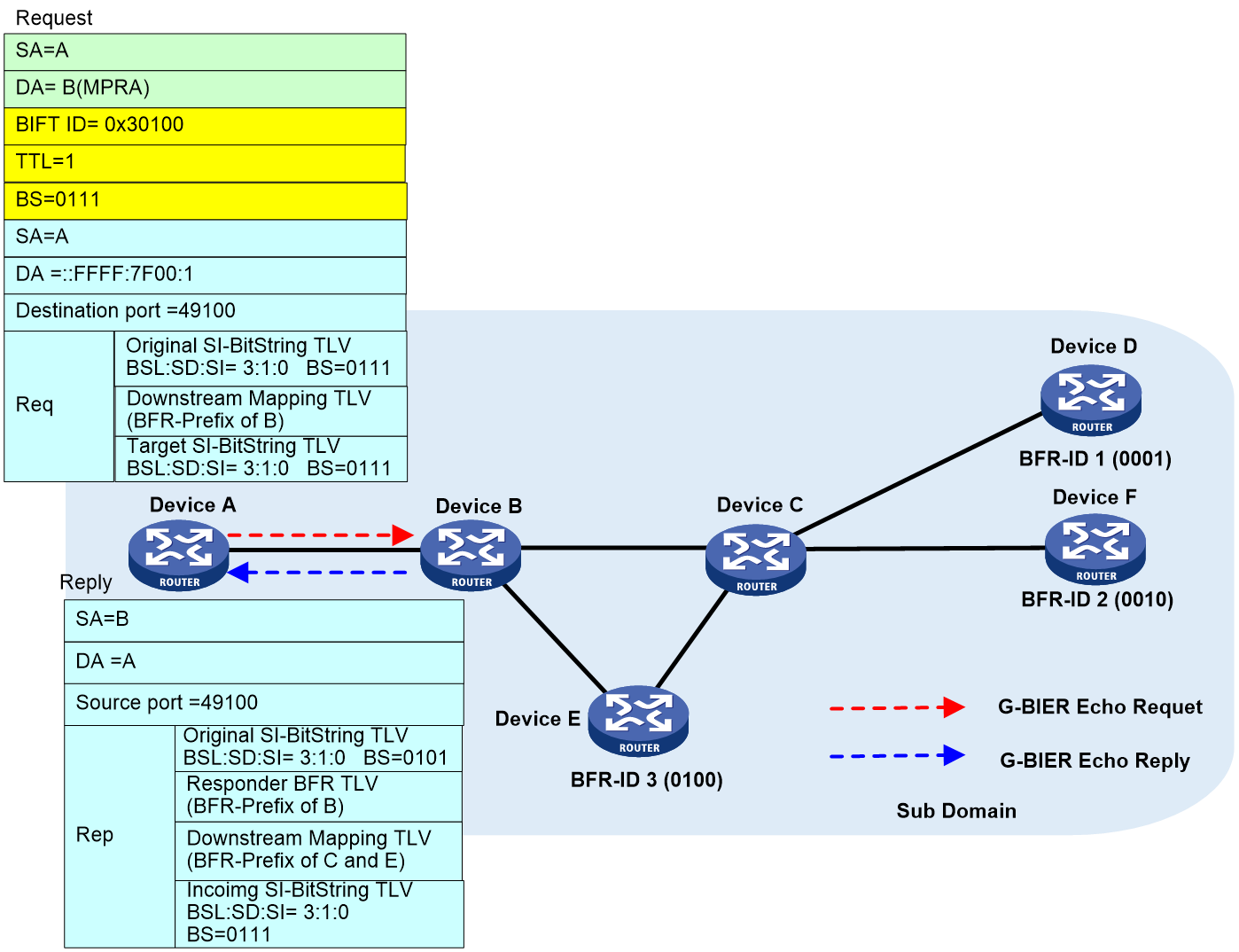

First tracert round trip
Figure 3 First tracert round trip
1.     Device A determines the BIER triplet information (BSL, sub-domain, and SI) based on the tracert command and identifies the BIFT ID, 0x30100 in this example.
2.     Device A looks up BIFT 0x30100 and determines Device B as the next-hop adjacency. Then, it encapsulates the echo request in a G-BIER header and transmits the packet to Device B. Within the G-BIER header, the destination IPv6 address is set to Device B’s MPRA, TTL is set to 1, and the BFR prefix of Device B is carried in the Downstream Mapping TLV field.
3.     After the request arrives at Device B, its TTL is decremented to 0, and Device B returns an echo reply packet to Device A. Because Device B is a transit node, the echo reply packet carries the BFR prefixes of downstream Device D and Device E in the Downstream Mapping TLV and the BFR prefix of Device B in the Responder BFR TLV.
4.     Upon receipt of the echo reply, Device A compares key fields in the reply with those in the request it sent. If the fields do not match, Device A ignores the reply. If the fields match, Device A displays reply information.

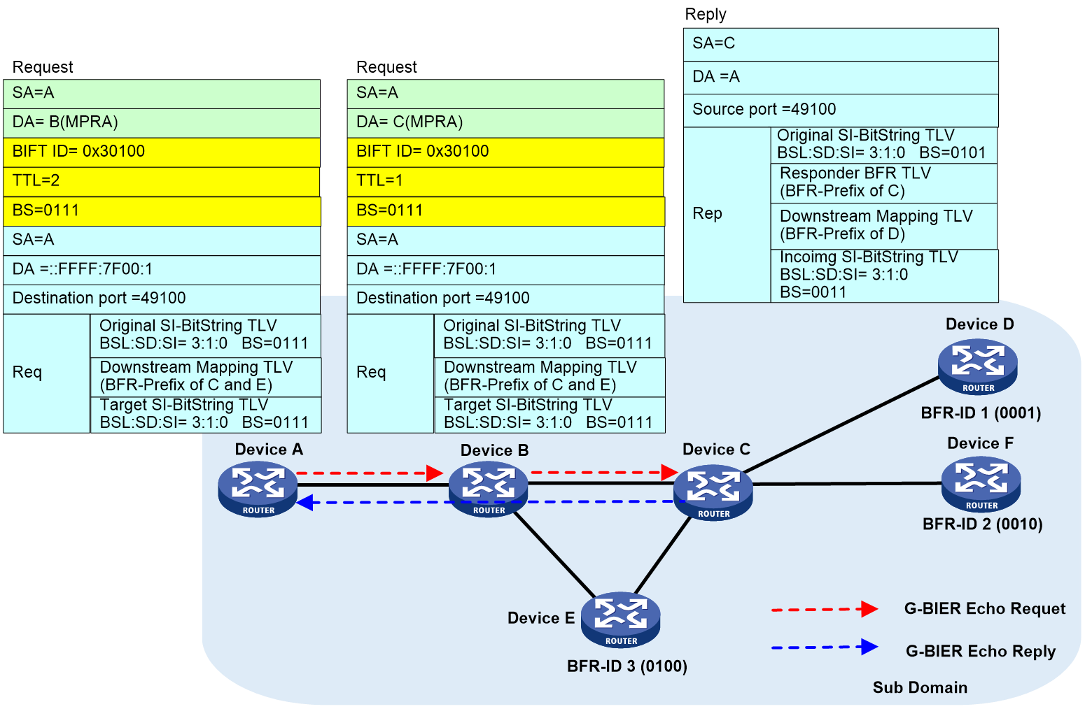

Second tracert round trip
Figure 4 Second tracert round trip
1.     Device A looks up BIFT 0x30100 and determines Device B as the next-hop adjacency. Then, it encapsulates the echo request in a G-BIER header and transmits the packet to Device B. Within the G-BIER header, the destination IPv6 address is set to Device B’s MPRA, TTL is set to 2, and the BFR prefixes (copied from the received echo reply) of Device C and Device E are carried in the Downstream Mappling TLV field.
2.     Device B looks up the local BIFT and forwards the packet to Device C.
3.     After the request arrives at Device B, its TTL is decremented to 0, and Device C returns an echo reply packet to Device A. Because Device C is a transit node, the echo reply packet carries the BFR prefix of downstream Device D in the Downstream Mappling TLV, and the BFR prefix of Device C in the Responder BFR TLV.
4.     Upon receipt of the echo reply, Device A compares key fields in the reply with those in the sent request. If the fields do not match, Device A ignores the reply. If the fields match, Device A displays reply information.
