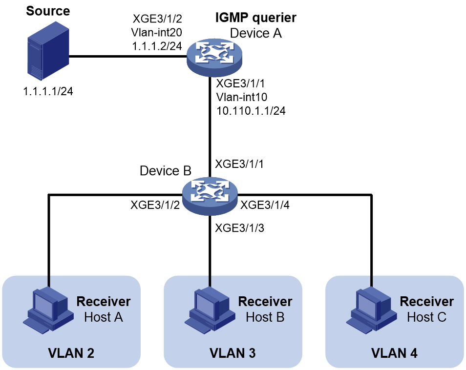

As shown in Figure 1, Host A, Host B, and Host C are in three different VLANs and the same multicast group. When Device A (Layer 3 device) receives multicast data for that group, it sends three copies of the multicast data to Device B (Layer 2 device). This occupies a large amount of bandwidth and increases the burden on the Layer 3 device.
Figure 1 Multicast transmission without the multicast VLAN feature
After a multicast VLAN is configured on Device B, Device A sends only one copy of the multicast data to the multicast VLAN on Switch B. This method saves network bandwidth and lessens the burden on the Layer 3 device.

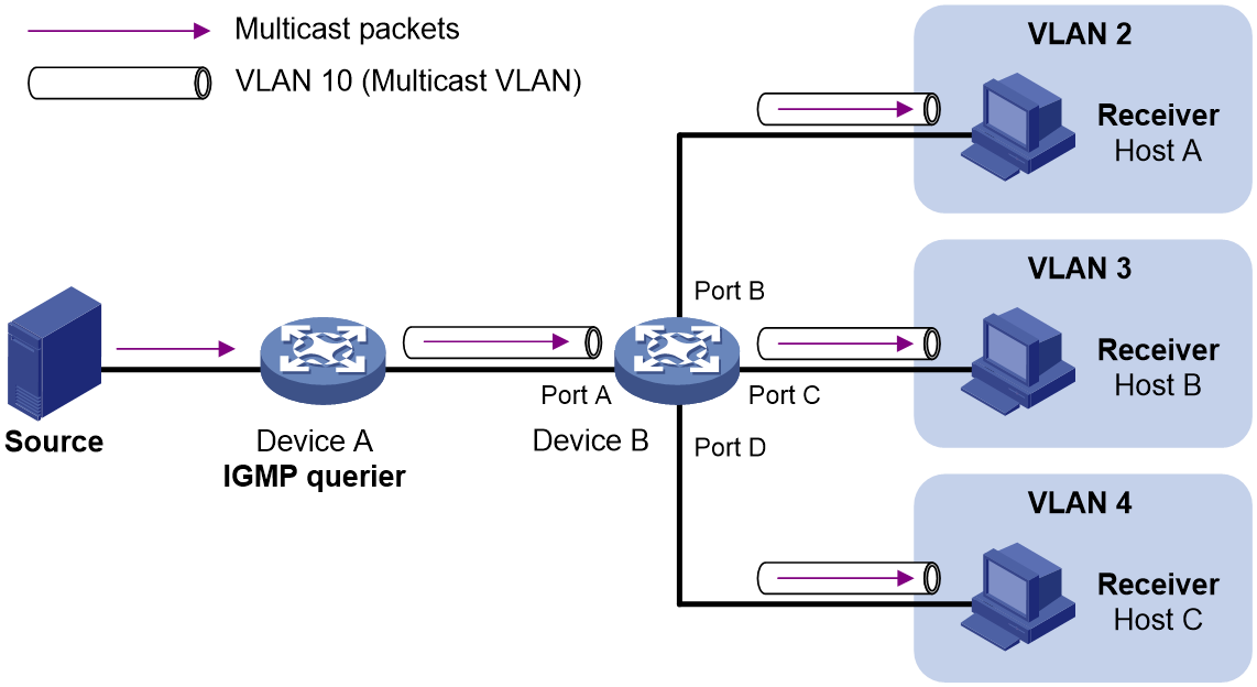

Sub-VLAN-based multicast VLAN
As shown in Figure 2:
·     Host A, Host B, and Host C are in VLAN 2 through VLAN 4, respectively.
·     On Device B, VLAN 10 is a multicast VLAN. VLAN 2 through VLAN 4 are sub-VLANs of VLAN 10.
·     IGMP snooping is enabled for the multicast VLAN and its sub-VLANs.
Figure 2 Sub-VLAN-based multicast VLAN
IGMP snooping manages router ports in the multicast VLAN and member ports in each sub-VLAN. When Switch A receives multicast data from the multicast source, it sends only one copy of the multicast data to the multicast VLAN on Device B. Then, Device B sends a separate copy to each sub-VLAN in the multicast VLAN.

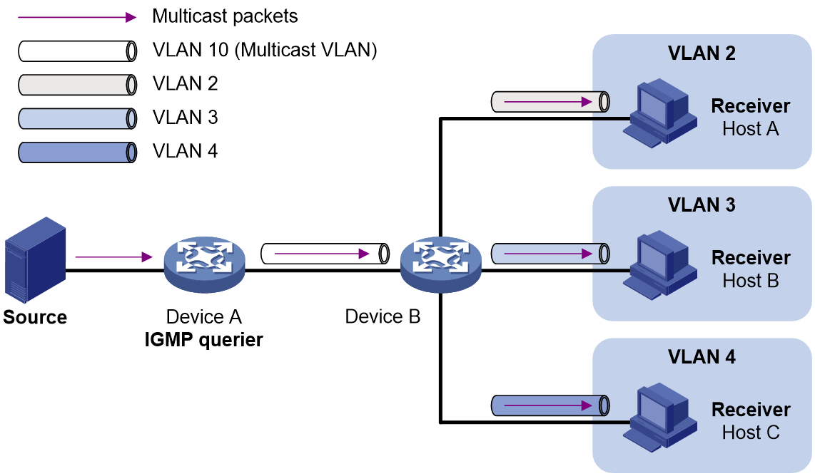

Port-based multicast VLAN
As shown in Figure 3:
·     On Device B, VLAN 10 is a multicast VLAN. All the user ports are hybrid ports and are assigned to VLAN 10.
·     IGMP snooping is enabled for the multicast VLAN and VLAN 2 through VLAN 4.
Figure 3 Port-based multicast VLAN
IGMP snooping manages the router ports and member ports in the multicast VLAN. When Device A receives multicast data from the multicast source, it sends only one copy of the multicast data to the multicast VLAN on Device B. Device B sends a separate copy to each user port in the multicast VLAN.
