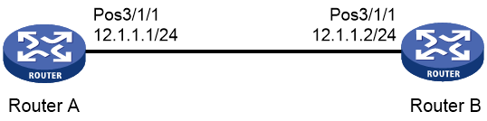

Example: Configuring HDLC
As shown in Figure 1, Router A and Router B are connected by POS interfaces.
Run HDLC on the link between them.
1. Configure Router A:
# Configure the clock mode of POS 2/2/1 as master.
<RouterA> system-view
[RouterA] interface pos 3/1/1
[RouterA-Pos3/1/1] clock master
# Enable HDLC encapsulation on POS 2/2/1.
[RouterA-Pos3/1/1] link-protocol hdlc
# Assign an IP address to POS 2/2/1.
[RouterA-Pos3/1/1] ip address 12.1.1.1 24
[RouterA-Pos3/1/1] quit
2. Configure Router B:
<RouterB> system-view
[RouterB] interface pos 3/1/1
[RouterB-Pos3/1/1] link-protocol hdlc
[RouterB-Pos3/1/1] ip address 12.1.1.2 24
# Ping a router from the other router, for example, ping Router B from Router A.
[RouterA] ping 12.1.1.2
Ping 12.1.1.2 (12.1.1.2): 56 data bytes, press CTRL+C to break
56 bytes from 12.1.1.2: icmp_seq=0 ttl=254 time=2.137 ms
56 bytes from 12.1.1.2: icmp_seq=1 ttl=254 time=2.051 ms
56 bytes from 12.1.1.2: icmp_seq=2 ttl=254 time=1.996 ms
56 bytes from 12.1.1.2: icmp_seq=3 ttl=254 time=1.963 ms
56 bytes from 12.1.1.2: icmp_seq=4 ttl=254 time=1.991 ms
--- Ping statistics for 12.1.1.2 ---
round-trip min/avg/max/std-dev = 1.963/2.028/2.137/0.062 ms
The output shows that Router A can successfully ping Router B.

As shown in Figure 2, to increase bandwidth and enhance connection reliability between Router A and Router B, create an HDLC link bundle.
# Create HDLC link bundle interface 1 and assign an IP address to it.
[RouterA] interface hdlc-bundle 1
[RouterA-HDLC-bundle1] ip address 1.1.1.1 24
[RouterA-HDLC-bundle1] quit
# Assign Pos 3/1/1 to HDLC link bundle 1, and configure the interface to use the master clock mode.
[RouterA-Pos3/1/1] bundle id 1
# Assign Pos 3/1/2 to HDLC link bundle 1, and configure the interface to use the master clock mode.
[RouterA] interface pos 3/1/2
[RouterA-Pos3/1/2] clock master
[RouterA-Pos3/1/2] link-protocol hdlc
[RouterA-Pos3/1/2] bundle id 1
[RouterA-Pos3/1/2] quit
[RouterB] interface hdlc-bundle 1
[RouterB-HDLC-bundle1] ip address 1.1.1.2 24
[RouterB-HDLC-bundle1] quit
# Assign Pos 3/1/1 to HDLC link bundle 1.
[RouterB-Pos3/1/1] bundle id 1
[RouterB-Pos3/1/1] quit
# Assign Pos 3/1/2 to HDLC link bundle 1.
[RouterB] interface pos 3/1/2
[RouterB-Pos3/1/2] link-protocol hdlc
[RouterB-Pos3/1/2] bundle id 1
[RouterB-Pos3/1/2] quit
# Verify that the HDLC link bundle interfaces on Router A and Router B can ping each other.
[RouterA] ping –a 1.1.1.1 1.1.1.2
Ping 1.1.1.2 (1.1.1.2) from 1.1.1.1: 56 data bytes, press CTRL+C to break
56 bytes from 1.1.1.2: icmp_seq=0 ttl=255 time=0.000 ms
56 bytes from 1.1.1.2: icmp_seq=1 ttl=255 time=0.000 ms
56 bytes from 1.1.1.2: icmp_seq=2 ttl=255 time=0.000 ms
56 bytes from 1.1.1.2: icmp_seq=3 ttl=255 time=0.000 ms
56 bytes from 1.1.1.2: icmp_seq=4 ttl=255 time=0.000 ms
--- Ping statistics for 1.1.1.2 ---
round-trip min/avg/max/std-dev = 0.000/0.000/0.000/0.000 ms
# Verify that:
· Pos 3/1/1 and Pos 3/1/2 are in Selected state and can perform load balancing.
· The bandwidth of the HDLC link bundle is 1244160 kbps, the total bandwidth of two POS interfaces.
· When one POS interface fails, the traffic can be forwarded through the other POS interface. This improves the link reliability.
Use Router A as an example.
[RouterA] display bundle hdlc-bundle 1
Bundle: HDLC-bundle1
Selected members: 2, Total bandwidth: 1244160 kbps
Member State Bandwidth(kbps) Priority
Pos3/1/1 Selected 622080 32768
Pos3/1/2 Selected 622080 32768
