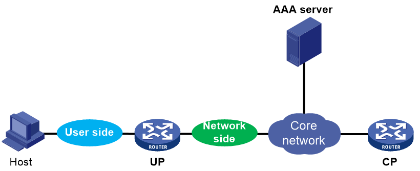

In a vBRAS CP and UP separation (CUPS) architecture as shown in Figure 1, a card on the UP connected to user-side interfaces is called a user-side card. A card connected to network-side interfaces is called a network-side card.
Figure 1 User side and network side in a CUPS architecture
By default, when a UP receives user session information from the CP, the UP maintains the session on all cards because it cannot identify network-side cards. Although this behavior ensures successful user communication, it occupies a large amount of memory resources on the UP.
To save memory resources, you can specify a card connected to network-side interfaces as a network-side card. Then, when the UP receives user session information from the CP, it maintains the session only on the card where the access interface of the user resides and on the network-side card.
You can repeat this command to specify multiple cards as network-side cards.
You can specify an interface card but not an MPU as a network-side card.
