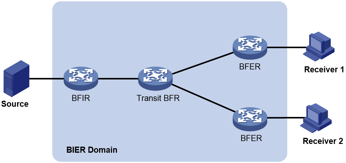

BIER network structure
A router that supports BIER is known as a Bit-Forwarding Router (BFR). As shown in Figure 1, a BIER network consists of the following BFRs:
·     Bit Forwarding Ingress Router (BFIR)—A multicast data packet enters a BIER domain at a BFIR. A BFIR encapsulates the multicast data packet as a BFIR packet.
·     Transit BFR—A transit BFR receives a multicast data packet from one BFR to another BFR in the same BIER domain.
·     Bit Forwarding Egress Router (BFER)—A multicast data packet leaves a BIER domain at a BFER. A BFER decapsulates the multicast data packet and sends it to multicast receivers.
Figure 1 BIER network structure

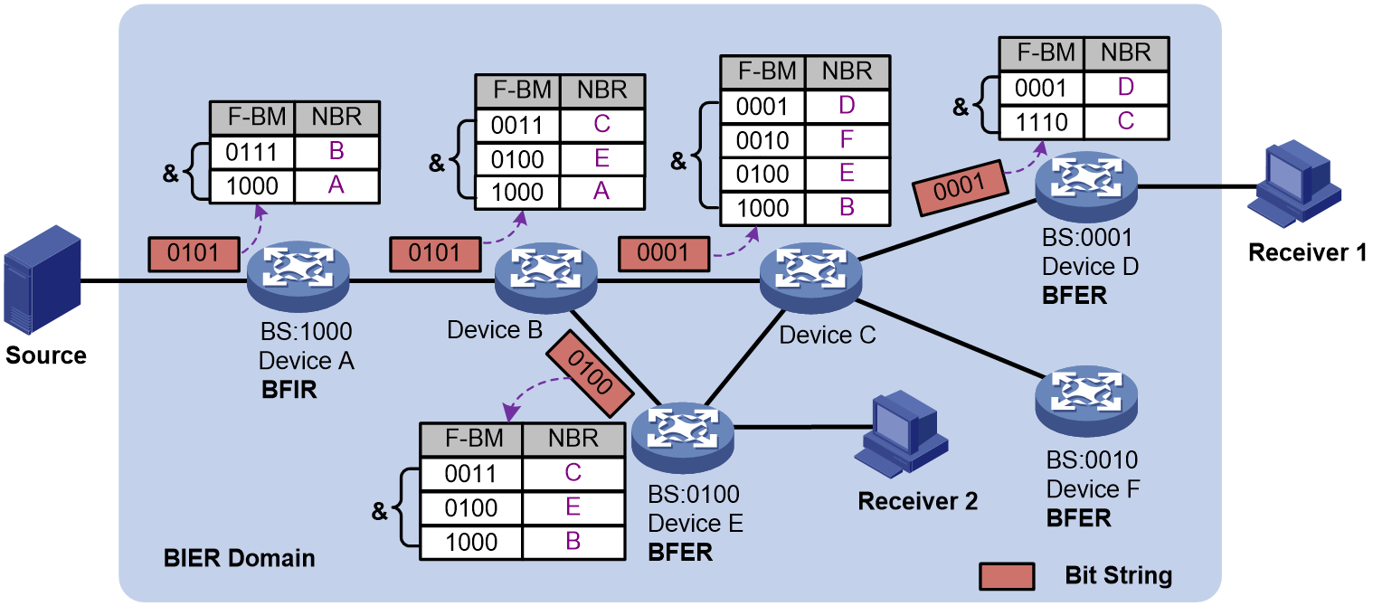

BIER forwarding process
As shown in Figure 3, Receiver 1 is a multicast receiver. Device A learned the BFR IDs and BFR prefixes of Device D and Device E through MVPN routes. Device A is in the same sub-domain as Device D and Device E. Each device in the sub-domain calculated a BIFT entry to another device.
When Device A receives a packet from outside the domain:
1.     Device A learns the BFR IDs and BFR prefixes of Device D and Device E through MVPN routes. Device A translates the BFR IDs of Device D and Device E to bit strings according to the BSL and SI configured in the sub-domain and obtains bit string 0101 by taking a logical OR operation of the two bit strings. Device A performs a logical AND operation on bit string 0101 and each F-BM in the BIFT derived from the triple (BSL, sub-domain, and SI) and encapsulates bit string 0101 in the BIER header. Then, Device A makes a copy of the packet and sends the copy to the corresponding neighbor (Device B in this example). If the result of the logical AND operation is 0, the packet is not copied to the corresponding neighbor (Device A in this example).
2.     After receiving the BIER packet, Device B reads BS 0101 and performs a logical AND operation on bit string 0101 and each F-BM in the BIFT. If the result is not 0, Device B copies the packet, and modifies the BS value in the copy as 0001, and sends the copy to Device C. Similarly, Device B modifies the BS value in the copy as 0101 and sends the copy to Device E.
3.     After receiving the BIER packet, Device C performs the same logical AND operation as Device B in step 2. Then, Device C copies the packet, modifies the BS value in the copy as 0001, and sends the copy to Device D.
4.     After receiving the BIER packet, Device E determines that the result of the logical AND operation on its F-BM and BS value 0100 in the packet is not 0. Device E decapsulates the BIER packet and sends the multicast packet to downstream receivers according to the multicast routing table.
5.     After receiving the BIER packet, Device D determines that the result of the logical AND operation on its F-BM and BS value 0100 in the packet is not 0. Device D decapsulates the BIER packet and sends the multicast packet to downstream receivers according to the multicast routing table.
Figure 3 BIER forwarding process

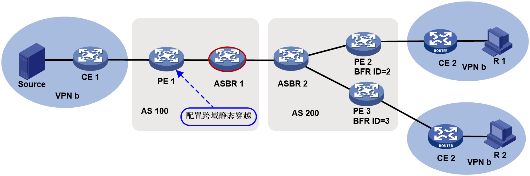

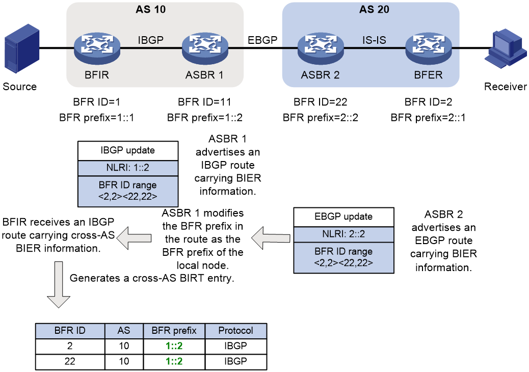

Cross-AS BIER
Cross-AS BIER indicates that a BIER network spans multiple ASs and multicast traffic passes through multiple ASs during BIER forwarding. An IGP can flood BIER information within an AS and cannot generate cross-AS BIER forwarding entries. Cross-AS BIER requires that a BIER node can obtain the BIER information (such as BFR ID) of BIER nodes in another AS. The device supports implementing cross-AS BIER through static configuration and BGP advertisement.
Static cross-AS BIER
You implement cross-AS BIER by manually specifying the BFR neighbor in another domain and the BFR ID range of BIER edge devices that can be reached through the BFR neighbor.

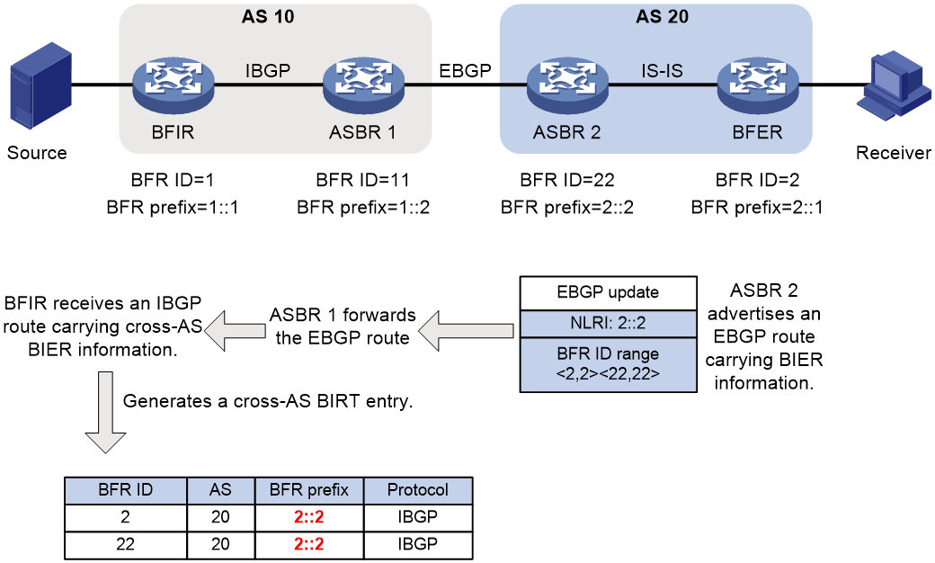

BGP-based cross-AS BIER
BGP can transfer BIER information between ASs. The BIER information can guide the forwarding of BIER packets. BGP encapsulates the following BIER information in UPDATE messages:
·     BFR prefix—Encapsulated in the NLRI field.
·     BIER Path Attribute—A new attribute that contains information such as BIER sub-domain, BFR ID, BSL, and MPRA.
As shown in Figure 4, the BIER network spans AS 10 and AS 20. IS-IS is used to transfer BIER information in AS 20, and IBGP is used to transfer BIER information in AS 10. On ASBR 2, BIER information collected by IS-IS in AS 20 can be imported to BGP and then sent to ASBR 1 through an EBGP session. ASBR 1 forwards an EBGP route to the BFIR. The BFIR generates a cross-AS BIRT entry based on the BIER information carried in the received IBGP route. The BFR prefix of the BFR ID of the BFER is the BFR prefix of ASBR 2 (2::2). The BFIR uses ASBR 2 as the next hop when forwarding multicast packets.
Carried in a BGP route, the BFR ID range is used by the BIER to learn BFR IDs in another BIER domain.
Figure 4 BGP-based cross-AS BIER
To successfully forward BIER packets, the BFIR must obtain the route information of ASBR 2. The BGP BFR prefix proxy function enables the BFIR successfully forward BIER packets without the route information of ASBR 2. A node enabled with BGP BFR prefix proxying is called a BFR proxy node. A BFR proxy node advertises cross-AS BFR ID range information. The nodes in BIER domain use the BFR proxy node as the next hop when forwarding BIER packets across ASs.
A BFR proxy node does not directly forward routes carrying BIER information learned from a BGP peer to other BGP peers and advertises them as follows:
1.     Advertises the BIER information (including BFR ID range information) in learned routes to the BIER module.
2.     The BIER module modifies the BFR prefix in the BIER information as the BFR prefix of the local node and summarizes received BFR ID range information.
Modifying the BFR prefix can prevent BFR prefix information from being leaked out of a BIER domain. For example, an ISP deploys a BIER network that spans the provincial headquarters and the MANs. If BGP BFR prefix proxying is enabled on the edge devices at the provincial headquarters, devices in the MANs can obtain only the BFR prefix information of the BFR proxy nodes. This prevents the BFR prefix information of other nodes at the provincial headquarters from being leaked out to the MANs.
3.     The BIER module advertises the modified BIER information to the BGP module. The BGP module generates a BGP route that carries the modified BIER information (including BFR ID range information) and sends it to BGP peers.
4.     After receiving the BGP route, an IBGP or EBPG peer generates cross-AS BIRT entry. The BRF prefix of the edge node is the BRF prefix of the BFR proxy node.
When a device forwards a cross-AS packet, it will encapsulate the MPRA of the BFR proxy node and sends the packet to the BFR proxy node. The BFR proxy node forwards the received packet according to the BIFT.
As shown in Figure 5, after being enabled with BGP BFR prefix proxying, ASBR 1 generates an IBGP route based on the BGP route received from ASBR 2 and send the IBGP route to the BFIR. The IBGP route retains the BFR ID range information in the received BGP route and encapsulates the BFR prefix of the local node (in place of the BFR prefix in the received BGP route) in the NLRI field. In the cross-AS BIRT entry generated by the BFIR, the BFR prefix of the BFR ID of the BFER is the BFR prefix of ASBR 1 (2::2). The BFIR uses ASBR 1 as the next hop when forwarding multicast packets.
Figure 5 BGP BFR prefix proxying

Configuring static cross-AS BIER
In a cross-AS BIER deployment, if the ASBR in an AS does not support BIER forwarding, BIER packets cannot be forwarded among ASs. To solve this problem, you can specify the BFR neighbor on the BFR directly connected to the ASBR and the BFR ID range of BIER edge devices that can be reached through the BFR neighbor.
Figure 6 Static cross-AS BIER
In the same BIER sub-domain, the BFR ID ranges for different BFR neighbors cannot be overlapping. The configuration performed later does not take effect.
The configuration takes effect only on the BIRT of the local node and will not be advertised to other nodes.
The total number of BFR neighbors in all BIER sub-domains on the device cannot exceed 2000. The number of BFR IDs reachable through one BFR neighbor cannot exceed 256.
You can specify a maximum number of four BFR neighbors with the same link priority for reaching a BFR ID.

The redistributed BIER information includes the BFR ID range information. The following rules apply to the inclusion of BFR ID range information when BGP routes generated based on the BIER information are advertised:
·     If BGP BFR prefix proxying is not enabled:
¡     The BFR ID range information is not included when BGP routes are advertised to an IBGP peer.
¡     The BFR ID range information is included when BGP routes are advertised to an EBGP peer.
·     If BGP BFR prefix proxying is enabled, the BFR ID range information is included when BGP routes are advertised to either an EBGP peer or an  IBGP peer.

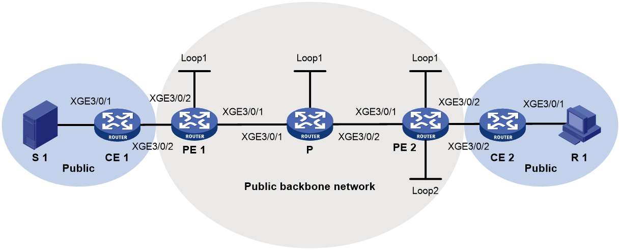

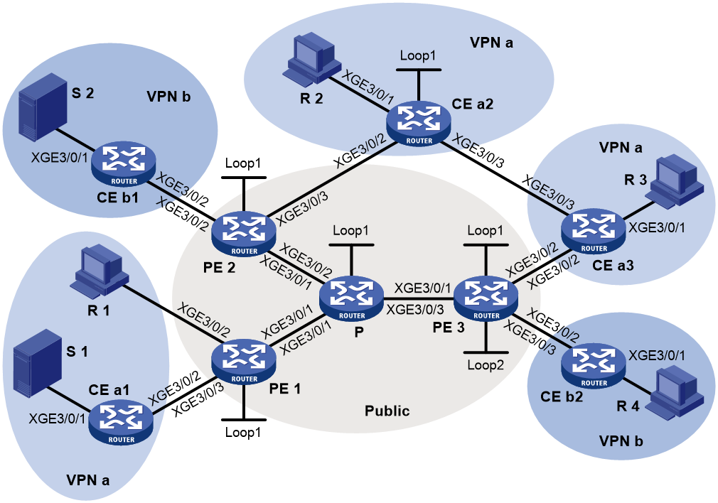

Example: Configuring intra-AS BIER-based MVPN
As shown in Figure 7, configure intra-AS BIER-based MVPN to meet the following requirements:
Item
Multicast sources and receivers
·     In VPN instance a, S 1 is a multicast source, and R 1, R 2, and R 3 are receivers.
·     In VPN instance b, S 2 is a multicast source, and R 4 is a receiver.
VPN instances to which PE interfaces belong
·     PE 1: Ten-GigabitEthernet 3/0/2 and Ten-GigabitEthernet 3/0/3 belong to VPN instance a. Ten-GigabitEthernet 3/0/1 and Loopback 1 belong to the public network.
·     PE 2: Ten-GigabitEthernet 3/0/2 belongs to VPN instance b. Ten-GigabitEthernet 3/0/3 belongs to VPN instance a. Ten-GigabitEthernet 3/0/1 and Loopback 1 belong to the public network.
·     PE 3: Ten-GigabitEthernet 3/0/2 belongs to VPN instance a. Ten-GigabitEthernet 3/0/3 and Loopback 2 belong to VPN instance b. Ten-GigabitEthernet 3/0/1 and Loopback 1 belong to the public network.
Unicast routing protocols and BIER
·     Configure IS-IS on the public network, and configure RIP between the PEs and the CEs.
·     Establish BGP peer connections between PE 1, PE 2, and PE 3 on their respective Loopback 1.
·     Configure BIER on the public network.
IP multicast routing
·     Enable IP multicast routing for VPN instance a on PE 1, PE 2, and PE 3.
·     Enable IP multicast routing for VPN instance b on PE 2 and PE 3.
·     Enable IP multicast routing on CE a1, CE a2, CE a3, CE b1, and CE b2.
IGMP
·     Enable IGMPv2 on Ten-GigabitEthernet 3/0/2 of PE 1.
·     Enable IGMPv2 on Ten-GigabitEthernet 3/0/1 of CE a2, CE a3, and CE b2.
PIM
·     Enable PIM-SM on all interfaces that do not have attached receiver hosts on PE 1, PE 2, and PE 3.
·     Enable PIM-SM on all interfaces that do not have attached receiver hosts on CE a1, CE a2, CE a3, CE b1, and CE b2.
·     Configure Loopback 1 of CE a2 as a C-BSR and a C-RP for VPN instance a to provide services for all multicast groups.
·     Configure Loopback 2 of PE 3 as a C-BSR and a C-RP for VPN instance b to provide services for all multicast groups.
MSDP
·     Enable MSDP on CE a2, and specify Ten-GigabitEthernet 3/0/2 as the local MSDP connection interface.
·     Enable MSDP on PE 2 for VPN instance a, and specify Ten-GigabitEthernet 3/0/3 as the local MSDP connection interface.
Figure 7 Network diagram
Device
Interface
IP address
Device
Interface
IP address
S 1
10.110.7.2/24
PE 3
XGE3/0/1
192.168.8.1/24
S 2
10.110.8.2/24
PE 3
XGE3/0/2
10.110.5.1/24
R 1
10.110.1.2/24
PE 3
XGE3/0/3
10.110.6.1/24
R 2
10.110.9.2/24
PE 3
Loop1
1.1.1.3/32
R 3
10.110.10.2/24
PE 3
Loop2
33.33.33.33/32
R 4
10.110.11.2/24
CE a1
XGE3/0/1
10.110.7.1/24
P
XGE3/0/1
192.168.6.2/24
CE a1
XGE3/0/2
10.110.2.2/24
P
XGE3/0/2
192.168.7.2/24
CE a2
XGE3/0/1
10.110.9.1/24
P
XGE3/0/3
192.168.8.2/24
CE a2
XGE3/0/2
10.110.4.2/24
P
Loop1
2.2.2.2/32
CE a2
XGE3/0/3
10.110.12.1/24
PE 1
XGE3/0/1
192.168.6.1/24
CE a2
Loop1
22.22.22.22/32
PE 1
XGE3/0/2
10.110.1.1/24
CE a3
XGE3/0/1
10.110.10.1/24
PE 1
XGE3/0/3
10.110.2.1/24
CE a3
XGE3/0/2
10.110.5.2/24
PE 1
Loop1
1.1.1.1/32
CE a3
XGE3/0/3
10.110.12.2/24
PE 2
XGE3/0/1
192.168.7.1/24
CE b1
XGE3/0/1
10.110.8.1/24
PE 2
XGE3/0/2
10.110.3.1/24
CE b1
XGE3/0/2
10.110.3.2/24
PE 2
XGE3/0/3
10.110.4.1/24
CE b2
XGE3/0/1
10.110.11.1/24
PE 2
Loop1
1.1.1.2/32
CE b2
XGE3/0/2
10.110.6.2/24

2.     Configure PE 2:
# Configure a global router ID.
<PE2> system-view
[PE2] router id 1.1.1.2
# Configure BIER.
[PE2] bier
[PE2-bier] sub-domain 0 ipv6
[PE2-bier-sub-domain-0-ipv6] bfr-id 2
[PE2-bier-sub-domain-0-ipv6] bfr-prefix interface LoopBack1
[PE2-bier-sub-domain-0-ipv6] encapsulation-type g-bier bsl 128 max-si 32
[PE2-bier-sub-domain-0-ipv6] g-bier mpra 5002::1
# Configure SRv6.
[PE2] segment-routing ipv6
[PE2-segment-routing-ipv6] encapsulation source-address 22::22
[PE2-segment-routing-ipv6] locator aaa ipv6-prefix 2:2:: 96 static 8
# Configure a multicast service prefix.
[PE2] multicast-service-prefix ms1 ipv6-prefix 1234:2:: 64 service-id-length 10
# Create a VPN instance named b, and configure an RD and route targets for the VPN instance.
[PE2] ip vpn-instance b
[PE2-vpn-instance-b] route-distinguisher 200:1
[PE2-vpn-instance-b] vpn-target 200:1 export-extcommunity
[PE2-vpn-instance-b] vpn-target 200:1 import-extcommunity
[PE2-vpn-instance-b] quit
# Enable IP multicast routing for VPN instance b.
[PE2] multicast routing vpn-instance b
[PE2-mrib-b] quit
# Create a BIER-based MVPN for VPN instance b.
[PE2] multicast-vpn vpn-instance b mode bier
# Create an MVPN IPv4 address family for VPN instance b.
[PE2-mvpn-b] address-family ipv4
# Specify the MVPN source interface for VPN instance b.
[PE2-mvpn-b-ipv4] source loopback 1
# Enable dynamic inclusive tunnel creation and dynamic selective tunnel creation for VPN instance b.
[PE2-mvpn-b-ipv4] inclusive-tunnel dynamic  sub-domain 0 bsl 128
[PE2-mvpn-b-ipv4] selective-tunnel dynamic  sub-domain 0 bsl 128
[PE2-mvpn-b-ipv4] tunnel-source multicast-service-prefix ms1 service-id 12
[PE2-mvpn-b-ipv4] quit
[PE2-mvpn-b] quit
# Create a VPN instance named a, and configure an RD and route targets for the VPN instance.
[PE2] ip vpn-instance a
[PE2-vpn-instance-a] route-distinguisher 100:1
[PE2-vpn-instance-a] vpn-target 100:1 export-extcommunity
[PE2-vpn-instance-a] vpn-target 100:1 import-extcommunity
[PE2-vpn-instance-a] quit
# Enable IP multicast routing for VPN instance a.
[PE2] multicast routing vpn-instance a
[PE2-mrib-a] quit
# Create a BIER-based MVPN for VPN instance a.
[PE2] multicast-vpn vpn-instance a mode bier
# Create an MVPN IPv4 address family for VPN instance a.
[PE2-mvpn-a] address-family ipv4
# Specify the MVPN source interface for VPN instance a.
[PE2-mvpn-a-ipv4] source loopback 1
[PE2-mvpn-a-ipv4] quit
[PE2-mvpn-a] quit
# Assign an IP address to Ten-GigabitEthernet 3/0/1, and enable IS-IS on the interface.
[PE2] interface ten-gigabitethernet 3/0/1
[PE2-Ten-GigabitEthernet3/0/1] ipv6 address 9000:7::1 64
[PE2-Ten-GigabitEthernet3/0/1] isis ipv6 enable 1
[PE2-Ten-GigabitEthernet3/0/1] quit
# Associate Ten-GigabitEthernet 3/0/2 with VPN instance b, assign an IP address to the interface, and enable PIM-SM on the interface.
[PE2] interface ten-gigabitethernet 3/0/2
[PE2-Ten-GigabitEthernet3/0/2] ip binding vpn-instance b
[PE2-Ten-GigabitEthernet3/0/2] ip address 10.110.3.1 24
[PE2-Ten-GigabitEthernet3/0/2] pim sm
[PE2-Ten-GigabitEthernet3/0/2] quit
# Associate Ten-GigabitEthernet 3/0/3 with VPN instance a, assign an IP address to the interface, and enable PIM-SM on the interface.
[PE2] interface ten-gigabitethernet 3/0/3
[PE2-Ten-GigabitEthernet3/0/3] ip binding vpn-instance a
[PE2-Ten-GigabitEthernet3/0/3] ip address 10.110.4.1 24
[PE2-Ten-GigabitEthernet3/0/3] pim sm
[PE2-Ten-GigabitEthernet3/0/3] quit
# Assign an IP address to Loopback 1 and enable IS-IS on the interface.
[PE2] interface loopback 1
[PE2-LoopBack1] ip address 1.1.1.2 32
[PE2-LoopBack1] ipv6 address 1112::1112 128
[PE2-LoopBack1] isis ipv6 enable 1
[PE2-LoopBack1] quit
# Configure BGP.
[PE2] bgp 100
[PE2-bgp-default] peer 1111::1111 as-number 100
[PE2-bgp-default] peer 1111::1111 connect-interface loopback 1
[PE2-bgp-default] peer 1113::1113 as-number 100
[PE2-bgp-default] peer 1113::1113 connect-interface loopback 1
[PE2-bgp-default] address-family ipv4 mvpn
[PE2-bgp-default-mvpn] peer 1111::1111 enable
[PE2-bgp-default-mvpn] peer 1113::1113 enable
[PE2-bgp-default-mvpn] quit
[PE2-bgp-default] address-family vpnv4
[PE2-bgp-default-vpnv4] mvpn-advertise-rt-import
[PE2-bgp-default-vpnv4] peer 1111::1111 enable
[PE2-bgp-default-vpnv4] peer 1113::1113 enable
[PE2-bgp-default-vpnv4] peer 1111::1111 prefix-sid
[PE2-bgp-default-vpnv4] peer 1113::1113 prefix-sid
[PE2-bgp-default-vpnv4] quit
[PE2–bgp-default] ip vpn-instance a
[PE2-bgp-default-a] address-family ipv4 unicast
[PE2-bgp-default-ipv4-a] import-route rip 2
[PE2-bgp-default-ipv4-a] import-route direct
[PE2-bgp-default-ipv4-a] segment-routing ipv6 best-effort
[PE2-bgp-default-ipv4-a] segment-routing ipv6 locator aaa
[PE2-bgp-default-ipv4-a] quit
[PE2-bgp-default-a] quit
[PE2–bgp-default] ip vpn-instance b
[PE2-bgp-default-b] address-family ipv4 unicast
[PE2-bgp-default-ipv4-b] import-route rip 3
[PE2-bgp-default-ipv4-b] import-route direct
[PE2-bgp-default-ipv4-b] segment-routing ipv6 best-effort
[PE2-bgp-default-ipv4-b] segment-routing ipv6 locator aaa
[PE2-bgp-default-ipv4-b] quit
[PE2-bgp-default-b] quit
[PE2–bgp-default] quit
# Configure IS-IS.
[PE2] isis 1
[PE2-isis-1] is-level level-1
[PE2-isis-1] cost-style wide
[PE2-isis-1] bier enable
[PE2-isis-1] network-entity 10.0000.0000.0002.00
[PE2-isis-1] address-family ipv6 unicast
[PE2-isis-1-ipv6] segment-routing ipv6 locator aaa
# Configure RIP.
[PE2] rip 2 vpn-instance a
[PE2-rip-2] network 10.110.4.0 0.0.0.255
[PE2-rip-2] import-route bgp
[PE2-rip-2] quit
[PE2] rip 3 vpn-instance b
[PE2-rip-3] network 10.110.3.0 0.0.0.255
[PE2-rip-3] import-route bgp
[PE2-rip-3] quit
3.     Configure PE 3:
<PE3> system-view
[PE3] router id 1.1.1.3
# Configure BIER.
[PE3] bier
[PE3-bier] sub-domain 0 ipv6
[PE3-bier-sub-domain-0-ipv6] bfr-id 1
[PE3-bier-sub-domain-0-ipv6] bfr-prefix interface LoopBack1
[PE3-bier-sub-domain-0-ipv6] encapsulation-type g-bier bsl 128 max-si 32
[PE3-bier-sub-domain-0-ipv6] g-bier mpra 5003::1
# Configure SRv6.
[PE3] segment-routing ipv6
[PE3-segment-routing-ipv6] encapsulation source-address 33::33
[PE3-segment-routing-ipv6] locator aaa ipv6-prefix 3:2:: 96 static 8
[PE3] multicast-service-prefix ms1 ipv6-prefix 1234:3:: 64 service-id-length 10
[PE3] ip vpn-instance a
[PE3-vpn-instance-a] route-distinguisher 100:1
[PE3-vpn-instance-a] vpn-target 100:1 export-extcommunity
[PE3-vpn-instance-a] vpn-target 100:1 import-extcommunity
[PE3-vpn-instance-a] quit
[PE3] multicast routing vpn-instance a
[PE3-mrib-a] quit
[PE3] multicast-vpn vpn-instance a mode bier
[PE3-mvpn-a] address-family ipv4
[PE3-mvpn-a-ipv4] source loopback 1
[PE3-mvpn-a-ipv4] quit
[PE3-mvpn-a] quit
[PE3] ip vpn-instance b
[PE3-vpn-instance-b] route-distinguisher 200:1
[PE3-vpn-instance-b] vpn-target 200:1 export-extcommunity
[PE3-vpn-instance-b] vpn-target 200:1 import-extcommunity
[PE3-vpn-instance-b] quit
[PE3] multicast routing vpn-instance b
[PE3-mrib-b] quit
[PE3] multicast-vpn vpn-instance b mode bier
[PE3-mvpn-b] address-family ipv4
[PE3-mvpn-b-ipv4] source loopback 1
[PE3-mvpn-b-ipv4] quit
[PE3-mvpn-b] quit
[PE3] interface ten-gigabitethernet 3/0/1
[PE3-Ten-GigabitEthernet3/0/1] ipv6 address 9000:8::1 64
[PE3-Ten-GigabitEthernet3/0/1] isis ipv6 enable 1
[PE3-Ten-GigabitEthernet3/0/1] quit
# Associate Ten-GigabitEthernet 3/0/2 with VPN instance a, assign an IP address to the interface, and enable PIM-SM on the interface.
[PE3] interface ten-gigabitethernet 3/0/2
[PE3-Ten-GigabitEthernet3/0/2] ip binding vpn-instance a
[PE3-Ten-GigabitEthernet3/0/2] ip address 10.110.5.1 24
[PE3-Ten-GigabitEthernet3/0/2] pim sm
[PE3-Ten-GigabitEthernet3/0/2] quit
# Associate Ten-GigabitEthernet 3/0/3 with VPN instance b, assign an IP address to the interface, and enable PIM-SM on the interface.
[PE3] interface ten-gigabitethernet 3/0/3
[PE3-Ten-GigabitEthernet3/0/3] ip binding vpn-instance b
[PE3-Ten-GigabitEthernet3/0/3] ip address 10.110.6.1 24
[PE3-Ten-GigabitEthernet3/0/3] pim sm
[PE3-Ten-GigabitEthernet3/0/3] quit
[PE3] interface loopback 1
[PE3-LoopBack1] ip address 1.1.1.3 32
[PE3-LoopBack1] ipv6 address 1113::1113 128
[PE3-LoopBack1] isis ipv6 enable 1
[PE3-LoopBack1] quit
# Associate Loopback 2 with VPN instance b, assign an IP address to the interface, and enable PIM-SM on the interface.
[PE3] interface loopback 2
[PE3-LoopBack2] ip binding vpn-instance b
[PE3-LoopBack2] ip address 33.33.33.33 32
[PE3-LoopBack2] pim sm
[PE3-LoopBack2] quit
# Configure Loopback 2 as a C-BSR and a C-RP.
[PE3] pim vpn-instance b
[PE3-pim-b] c-bsr 33.33.33.33
[PE3-pim-b] c-rp 33.33.33.33
[PE3-pim-b] quit
# Configure BGP.
[PE3] bgp 100
[PE3-bgp-default] peer 1111::1111 as-number 100
[PE3-bgp-default] peer 1111::1111 connect-interface loopback 1
[PE3-bgp-default] peer 1112::1112 as-number 100
[PE3-bgp-default] peer 1112::1112 connect-interface loopback 1
[PE3-bgp-default] address-family ipv4 mvpn
[PE3-bgp-default-mvpn] peer 1111::1111 enable
[PE3-bgp-default-mvpn] peer 1112::1112 enable
[PE3-bgp-default-mvpn]quit
[PE3-bgp-default] address-family vpnv4
[PE3-bgp-default-vpnv4] mvpn-advertise-rt-import
[PE3-bgp-default-vpnv4] peer 1111::1111 enable
[PE3-bgp-default-vpnv4] peer 1112::1112 enable
[PE3-bgp-default-vpnv4] peer 1111::1111 prefix-sid
[PE3-bgp-default-vpnv4] peer 1112::1112 prefix-sid
[PE3-bgp-default-vpnv4] quit
[PE3–bgp-default] ip vpn-instance a
[PE3-bgp-default-a] address-family ipv4 unicast
[PE3-bgp-default-ipv4-a] import-route rip 2
[PE3-bgp-default-ipv4-a] import-route direct
[PE3-bgp-default-ipv4-a] segment-routing ipv6 best-effort
[PE3-bgp-default-ipv4-a] segment-routing ipv6 locator aaa
[PE3-bgp-default-ipv4-a] quit
[PE3-bgp-default-a] quit
[PE3–bgp-default] ip vpn-instance b
[PE3-bgp-default-b] address-family ipv4 unicast
[PE3-bgp-default-ipv4-b] import-route rip 3
[PE3-bgp-default-ipv4-b] import-route direct
[PE3-bgp-default-ipv4-b] segment-routing ipv6 best-effort
[PE3-bgp-default-ipv4-b] segment-routing ipv6 locator aaa
[PE3-bgp-default-ipv4-b] quit
[PE3-bgp-default-b] quit
[PE3–bgp-default] quit
# Configure IS-IS.
[PE3] isis 1
[PE3-isis-1] is-level level-1
[PE3-isis-1] cost-style wide
[PE3-isis-1] bier enable
[PE3-isis-1] network-entity 10.0000.0000.0003.00
[PE3-isis-1] address-family ipv6 unicast
[PE3-isis-1-ipv6] segment-routing ipv6 locator aaa
# Configure RIP.
[PE3] rip 2 vpn-instance a
[PE3-rip-2] network 10.110.5.0 0.0.0.255
[PE3-rip-2] import-route bgp
[PE3-rip-2] quit
[PE3] rip 3 vpn-instance b
[PE3-rip-3] network 10.110.6.0 0.0.0.255
[PE3-rip-3] network 33.33.33.33 0.0.0.0
[PE3-rip-3] import-route bgp
[PE3-rip-3] quit
4.     Configure P:
# Configure BIER.
[P] bier
[P-bier] sub-domain 0 ipv6
[P-bier-sub-domain-0-ipv6] bfr-id 4
[P-bier-sub-domain-0-ipv6] bfr-prefix interface LoopBack1
[P-bier-sub-domain-0-ipv6] encapsulation-type g-bier bsl 128 max-si 32
[P-bier-sub-domain-0-ipv6] g-bier mpra 5004::1
# Configure SRv6.
[P] segment-routing ipv6
[P-segment-routing-ipv6] encapsulation source-address 44::44
[P-segment-routing-ipv6] locator aaa ipv6-prefix 4:2:: 96 static 8
[P] interface ten-gigabitethernet 3/0/1
[P-Ten-GigabitEthernet3/0/1] ipv6 address 9000:6::2 64
[P-Ten-GigabitEthernet3/0/1] isis ipv6 enable 1
[P-Ten-GigabitEthernet3/0/1] quit
# Assign an IP address to Ten-GigabitEthernet 3/0/2, and enable IS-IS on the interface.
[P] interface ten-gigabitethernet 3/0/2
[P-Ten-GigabitEthernet3/0/2] ipv6 address 9000:7::2 64
[P-Ten-GigabitEthernet3/0/2] isis ipv6 enable 1
[P-Ten-GigabitEthernet3/0/2] quit
# Assign an IP address to Ten-GigabitEthernet3/0/3, and enable IS-IS on the interface.
[P] interface ten-gigabitethernet 3/0/3
[P-Ten-GigabitEthernet3/0/3] ipv6 address 9000:8::2 64
[P-Ten-GigabitEthernet3/0/3] quit
[P] interface loopback 1
[P-LoopBack1] ip address 2.2.2.2 32
[P-LoopBack1] ipv6 address 2222::2222 64
[P-LoopBack1] isis ipv6 enable 1
[P-LoopBack1] quit
# Configure IS-IS.
[P] isis 1
[P-isis-1] is-level level-1
[P-isis-1] cost-style wide
[P-isis-1] bier enable

5.     Configure CE a1:
# Enable IP multicast routing.
<CEa1> system-view
[CEa1] multicast routing
[CEa1-mrib] quit
# Assign an IP address to Ten-GigabitEthernet 3/0/1, and enable PIM-SM on the interface.
[CEa1] interface ten-gigabitethernet 3/0/1
[CEa1-Ten-GigabitEthernet3/0/1] ip address 10.110.7.1 24
[CEa1-Ten-GigabitEthernet3/0/1] pim sm
[CEa1-Ten-GigabitEthernet3/0/1] quit
# Assign an IP address to Ten-GigabitEthernet 3/0/2, and enable PIM-SM on the interface.
[CEa1] interface ten-gigabitethernet 3/0/2
[CEa1-Ten-GigabitEthernet3/0/2] ip address 10.110.2.2 24
[CEa1-Ten-GigabitEthernet3/0/2] pim sm
[CEa1-Ten-GigabitEthernet3/0/2] quit
# Configure RIP.
[CEa1] rip 2
[CEa1-rip-2] network 10.110.2.0 0.0.0.255
[CEa1-rip-2] network 10.110.7.0 0.0.0.255
[CEa1-rip-2] quit
6.     Configure CE b1:
<CEb1> system-view
[CEb1] multicast routing
[CEb1-mrib] quit
[CEb1] interface ten-gigabitethernet 3/0/1
[CEb1-Ten-GigabitEthernet3/0/1] ip address 10.110.8.1 24
[CEb1-Ten-GigabitEthernet3/0/1] pim sm
[CEb1-Ten-GigabitEthernet3/0/1] quit
[CEb1] interface ten-gigabitethernet 3/0/2
[CEb1-Ten-GigabitEthernet3/0/2] ip address 10.110.3.2 24
[CEb1-Ten-GigabitEthernet3/0/2] pim sm
[CEb1-Ten-GigabitEthernet3/0/2] quit
# Configure RIP.
[CEb1] rip 3
[CEb1-rip-3] network 10.110.3.0 0.0.0.255
[CEb1-rip-3] network 10.110.8.0 0.0.0.255
[CEb1-rip-2] quit
7.     Configure CE a2:
<CEa2> system-view
[CEa2] multicast routing
[CEa2-mrib] quit
# Assign an IP address to Ten-GigabitEthernet 3/0/1, and enable IGMP on the interface.
[CEa2] interface ten-gigabitethernet 3/0/1
[CEa2-Ten-GigabitEthernet3/0/1] ip address 10.110.9.1 24
[CEa2-Ten-GigabitEthernet3/0/1] igmp enable
[CEa2-Ten-GigabitEthernet3/0/1] quit
[CEa2] interface ten-gigabitethernet 3/0/2
[CEa2-Ten-GigabitEthernet3/0/2] ip address 10.110.4.2 24
[CEa2-Ten-GigabitEthernet3/0/2] pim sm
[CEa2-Ten-GigabitEthernet3/0/2] quit
# Assign an IP address to Ten-GigabitEthernet 3/0/3, and enable PIM-SM on the interface.
[CEa2] interface ten-gigabitethernet 3/0/3
[CEa2-Ten-GigabitEthernet3/0/3] ip address 10.110.12.1 24
[CEa2-Ten-GigabitEthernet3/0/3] pim sm
[CEa2-Ten-GigabitEthernet3/0/3] quit
# Assign an IP address to Loopback 1, and enable PIM-SM on the interface.
[CEa2] interface loopback 1
[CEa2-LoopBack1] ip address 22.22.22.22 32
[CEa2-LoopBack1] pim sm
[CEa2-LoopBack1] quit
# Configure Loopback 1 as a C-BSR and a C-RP.
[CEa2] pim vpn-instance a
[CEa2-pim] c-bsr 22.22.22.22
[CEa2-pim] c-rp 22.22.22.22
[CEa2-pim] quit
# Configure MSDP.
[CEa2] msdp
[CEa2-msdp] peer 10.110.4.1 connect-interface ten-gigabitethernet 3/0/2
[CEa2-msdp] quit
# Configure RIP.
[CEa2] rip 2
[CEa2-rip-2] network 10.110.4.0 0.0.0.255
[CEa2-rip-2] network 10.110.9.0 0.0.0.255
[CEa2-rip-2] network 10.110.12.0 0.0.0.255
[CEa2-rip-2] network 22.22.22.22 0.0.0.0
[CEa2-rip-2] quit
8.     Configure CE a3:
<CEa3> system-view
[CEa3] multicast routing
[CEa3-mrib] quit
[CEa3] interface ten-gigabitethernet 3/0/1
[CEa3-Ten-GigabitEthernet3/0/1] ip address 10.110.10.1 24
[CEa3-Ten-GigabitEthernet3/0/1] igmp enable
[CEa3-Ten-GigabitEthernet3/0/1] quit
[CEa3] interface ten-gigabitethernet 3/0/2
[CEa3-Ten-GigabitEthernet3/0/2] ip address 10.110.5.2 24
[CEa3-Ten-GigabitEthernet3/0/2] pim sm
[CEa3-Ten-GigabitEthernet3/0/2] quit
[CEa3] interface ten-gigabitethernet 3/0/3
[CEa3-Ten-GigabitEthernet3/0/3] ip address 10.110.12.2 24
[CEa3-Ten-GigabitEthernet3/0/3] pim sm
[CEa3-Ten-GigabitEthernet3/0/3] quit
# Configure RIP.
[CEa3] rip 2
[CEa3-rip-2] network 10.110.5.0 0.0.0.255
[CEa3-rip-2] network 10.110.10.0 0.0.0.255
[CEa3-rip-2] network 10.110.12.0 0.0.0.255
[CEa3-rip-2] quit
9.     Configure CE b2:
<CEb2> system-view
[CEb2] multicast routing
[CEb2-mrib] quit
[CEb2] interface ten-gigabitethernet 3/0/1
[CEb2-Ten-GigabitEthernet3/0/1] ip address 10.110.11.1 24
[CEb2-Ten-GigabitEthernet3/0/1] igmp enable
[CEb2-Ten-GigabitEthernet3/0/1] quit
[CEb2] interface ten-gigabitethernet 3/0/2
[CEb2-Ten-GigabitEthernet3/0/2] ip address 10.110.6.2 24
[CEb2-Ten-GigabitEthernet3/0/2] pim sm
[CEb2-Ten-GigabitEthernet3/0/2] quit
# Configure RIP.
[CEb2] rip 3
[CEb2-rip-3] network 10.110.6.0 0.0.0.255
[CEb2-rip-3] network 10.110.11.0 0.0.0.255
[CEb2-rip-2] quit

Example: Configuring BIER-based MVPN for the public instance
As shown in Figure 8, configure BIER-based MVPN for the public instance to meet the following requirements:
Item
In the public instance, S 1 is a multicast source, and R 1 is a receiver.
Instances to which PE interfaces belong
All interfaces belong to the public instance.
·     Establish BGP peer connections between PE 1 and PE 2 by using Loopback 1.
·     Enable IP multicast routing for the public instance on PE 1 and PE 2.
·     Enable IP multicast routing on CE 1 and CE 2.
IGMP
Enable IGMPv2 on Ten-GigabitEthernet 3/0/1 of CE 2.
PIM
·     Enable PIM-SM on Ten-GigabitEthernet 3/0/1 on PE 1 and Ten-GigabitEthernet 3/0/1 on PE 2.
·     Enable PIM-SM on all interfaces that do not have attached receiver hosts on CE 1 and CE 2.
·     Configure Loopback 2 of PE 2 as a C-BSR and a C-RP for the public instance to provide services for all multicast groups.
Figure 8 Network diagram
Device
Interface
IP address
Device
Interface
IP address
S 1
10.110.7.2/24
R 1
10.110.1.2/24
PE 1
XGE3/0/1
9000:6::1/64
P
XGE3/0/1
9000:6::2/64
PE 1
XGE3/0/2
10.110.2.1/24
P
XGE3/0/3
9000:8::2/64
PE 1
Loop1
1.1.1.1/32
1111::1111/128
P
Loop1
2.2.2.2/32
2222::2222/128
PE 2
XGE3/0/1
9000:8::1/64
CE 1
XGE3/0/1
10.110.7.1/24
PE 2
XGE3/0/2
10.110.5.1/24
CE 1
XGE3/0/2
10.110.2.2/24
PE 2
Loop1
1.1.1.3/32
1113::1113/128
CE 2
XGE3/0/1
10.110.10.1/24
PE 2
Loop2
33.33.33.33/32
CE 2
XGE3/0/2
10.110.5.2/24
1.     Configure PE 1:
<PE1> system-view
[PE1] router id 1.1.1.1
# Configure BIER.
[PE1] bier
[PE1-bier] sub-domain 0 ipv6
[PE1-bier-sub-domain-0-ipv6] bfr-id 1
[PE1-bier-sub-domain-0-ipv6] bfr-prefix interface LoopBack1
[PE1-bier-sub-domain-0-ipv6] encapsulation-type g-bier bsl 128 max-si 32
[PE1-bier-sub-domain-0-ipv6] g-bier mpra 5001::1
[PE1-bier-sub-domain-0-ipv6] quit
[PE1-bier] quit
[PE1] multicast-service-prefix ms1 ipv6-prefix 1234:1:: 64 service-id-length 10
# Create the public instance, and configure route targets for the public instance.
[PE1] ip public-instance
[PE1-public-instance] vpn-target 100:1 export-extcommunity
[PE1-public-instance] vpn-target 100:1 import-extcommunity
[PE1-public-instance] quit
# Enable IP multicast routing for the public instance.
[PE1] multicast routing
[PE1-mrib] quit
# Create a BIER-based MVPN for the public instance.
[PE1] multicast-vpn public-instance mode bier
# Create an MVPN IPv4 address family for the public instance.
[PE1-mvpn-public-instance] address-family ipv4
# Specify the MVPN source interface for the public instance.
[PE1-mvpn-public-instance-ipv4] source loopback 1
# Enable dynamic inclusive tunnel creation and dynamic selective tunnel creation for the public instance.
[PE1-mvpn-public-instance-ipv4] inclusive-tunnel dynamic sub-domain 0 bsl 128
[PE1-mvpn-public-instance-ipv4] selective-tunnel dynamic sub-domain 0 bsl 128
[PE1-mvpn-public-instance-ipv4] tunnel-source multicast-service-prefix ms1 service-id 12
[PE1-mvpn-public-instance-ipv4] quit
[PE1-mvpn-public-instance] quit
# Configure IS-IS.
[PE1] isis 1
[PE1-isis-1] is-level level-1
[PE1-isis-1] cost-style wide
[PE1-isis-1] bier enable
[PE1-isis-1] network-entity 10.0000.0000.0001.00
[PE1-isis-1] address-family ipv6 unicast
[PE1-isis-1-ipv6] quit
[PE1-isis-1] quit
# Assign an IP address to Ten-GigabitEthernet 3/0/1  on the public network, and enable IS-IS on it.
[PE1] interface ten-gigabitethernet 3/0/1
[PE1-Ten-GigabitEthernet3/0/1] ipv6 address 9000:6::1 64
[PE1-Ten-GigabitEthernet3/0/1 isis ipv6 enable 1
[PE1-Ten-GigabitEthernet3/0/1] quit
# Assign an IP address to Ten-GigabitEthernet 3/0/3 on the public network, and enable PIM-SM on it.
[PE1] interface ten-gigabitethernet 3/0/3
[PE1-Ten-GigabitEthernet3/0/3] ip address 10.110.2.1 24
[PE1-Ten-GigabitEthernet3/0/3] pim sm
[PE1-Ten-GigabitEthernet3/0/3] quit
# Assign an IP address to Loopback 1, and enable IS-IS on the interface.
[PE1] interface loopback 1
[PE1-LoopBack1] ip address 1.1.1.1 32
[PE1-LoopBack1] ipv6 address 1111::1111 128
[PE1-LoopBack1] isis ipv6 enable 1
[PE1-LoopBack1] quit
# Configure BGP.
[PE1] bgp 100
[PE1-bgp-default] peer 1113::1113 as-number 100
[PE1-bgp-default] peer 1113::1113 connect-interface loopback 1
[PE1-bgp-default] address-family ipv4 mvpn
[PE1-bgp-default-mvpn] peer 1113::1113 enable
[PE1-bgp-default-mvpn] quit
[PE1-bgp-default] address-family ipv4 unicast
[PE1-bgp-default-ipv4] mvpn-advertise-rt-import
[PE1-bgp-default-ipv4] peer 1113::1113 enable
[PE1-bgp-default-ipv4] peer 1113::1113 advertise-ext-community
[PE1-bgp-default-ipv4] import-route rip 2
[PE1-bgp-default-ipv4] import-route direct
[PE1-bgp-default-ipv4] quit
[PE1-bgp-default] quit
# Configure RIP.
[PE1] rip 2
[PE1-rip-2] network 10.110.2.0 0.0.0.255
[PE1-rip-2] import-route bgp
[PE1-rip-2] quit
2.     Configure PE 2:
<PE2> system-view
[PE2] router id 1.1.1.3
# Configure BIER.
[PE2] bier
[PE2-bier-sub-domain-0-ipv6] bfr-id 3
[PE2-bier-sub-domain-0-ipv6] g-bier mpra 5003::1
[PE2-bier-sub-domain-0-ipv6] quit
[PE2-bier] quit
[PE2] ip public-instance
[PE2-public-instance] vpn-target 100:1 export-extcommunity
[PE2-public-instance] vpn-target 100:1 import-extcommunity
[PE2-public-instance] quit
[PE2-mrib] quit
[PE2] multicast-vpn public-instance mode bier
[PE2-mvpn-public-instance] address-family ipv4
[PE2-mvpn-public-instance-ipv4] source loopback 1
[PE2-mvpn-public-instance-ipv4] quit
[PE2-mvpn-public-instance] quit
# Configure IS-IS.
[PE2] isis 1
[PE2-isis-1] network-entity 10.0000.0000.0003.00
[PE2-isis-1-ipv6] quit
[PE2-isis-1] quit
[PE2-Ten-GigabitEthernet3/0/1] ipv6 address 9000:8::1 64
[PE2-Ten-GigabitEthernet3/0/3] ip address 10.110.5.1 24
[PE2-LoopBack1] ip address 1.1.1.3 32
[PE2-LoopBack1] ipv6 address 1113::1113 128
# Assign an IP address to Loopback 2, and enable PIM-SM on the interface.
[PE2] interface loopback 2
[PE2-LoopBack2] ip address 33.33.33.33 32
[PE2-LoopBack2] pim sm
[PE2-LoopBack2] quit
# Configure Loopback 2 as a C-BSR and a C-RP of the public network.
[PE2] pim
[PE2-pim] c-bsr 33.33.33.33
[PE2-pim] c-rp 33.33.33.33
[PE2-pim] quit
# Configure BGP.
[PE2] bgp 100
[PE2-bgp-default-mvpn]quit
[PE2-bgp-default] address-family ipv4 unicast
[PE2-bgp-default-ipv4] mvpn-advertise-rt-import
[PE2-bgp-default-ipv4] peer 1111::1111 enable
[PE2-bgp-default-ipv4] peer 1111::1111 advertise-ext-community
[PE2-bgp-default-ipv4] import-route rip 2
[PE2-bgp-default-ipv4] import-route direct
[PE2-bgp-default-ipv4] quit
[PE2-bgp-default] quit
# Configure RIP.
[PE2] rip 2
[PE2-rip-2] network 10.110.5.0 0.0.0.255
[PE2-rip-2] quit
3.     Configure P:
# Configure BIER.
[P] bier
# Configure IS-IS.
[P] isis 1
[P-isis-1] network-entity 10.0000.0000.0004.00
[P-isis-1] address-family ipv6 unicast
[P-isis-1-ipv6] quit
[P-isis-1] quit
# Assign an IP address to Ten-GigabitEthernet 3/0/3 on the public network, and enable IS-IS on it.
[P-Ten-GigabitEthernet3/0/3] isis ipv6 enable 1
[P-LoopBack1] quit
4.     Configure CE 1:
<CE1> system-view
[CE1] multicast routing
[CE1-mrib] quit
# Assign an IP address to Ten-GigabitEthernet 3/0/1 on the public network, and enable PIM-SM on it.
[CE1] interface ten-gigabitethernet 3/0/1
[CE1-Ten-GigabitEthernet3/0/1] ip address 10.110.7.1 24
[CE1-Ten-GigabitEthernet3/0/1] pim sm
[CE1-Ten-GigabitEthernet3/0/1] quit
[CE1] interface ten-gigabitethernet 3/0/3
[CE1-Ten-GigabitEthernet3/0/3] ip address 10.110.2.2 24
[CE1-Ten-GigabitEthernet3/0/3] pim sm
[CE1-Ten-GigabitEthernet3/0/3] quit
# Configure RIP.
[CE1] rip 2
[CE1-rip-2] network 10.110.2.0 0.0.0.255
[CE1-rip-2] network 10.110.7.0 0.0.0.255
[CE1-rip-2] quit
5.     Configure CE 2:
<CE2> system-view
[CE2] multicast routing
[CE2-mrib] quit
# Assign an IP address to Ten-GigabitEthernet 3/0/1 on the public network, and enable IGMP on it.
[CE2] interface ten-gigabitethernet 3/0/1
[CE2-Ten-GigabitEthernet3/0/1] ip address 10.110.10.1 24
[CE2-Ten-GigabitEthernet3/0/1] igmp enable
[CE2-Ten-GigabitEthernet3/0/1] quit
[CE2] interface ten-gigabitethernet 3/0/3
[CE2-Ten-GigabitEthernet3/0/3] ip address 10.110.5.2 24
[CE2-Ten-GigabitEthernet3/0/3] pim sm
[CE2-Ten-GigabitEthernet3/0/3] quit
# Configure RIP.
[CE2] rip 2
[CE2-rip-2] network 10.110.5.0 0.0.0.255
[CE2-rip-2] network 10.110.10.0 0.0.0.255
[CE2-rip-2] quit
# Display information about the BIER inclusive tunnel for the public instance on PE 1.
[PE1] display multicast-vpn public-instance inclusive-tunnel local
Tunnel type: BIER
Tunnel interface: BIERVOif0
Tunnel state: Up
Flags: 0x30
Sub-domain ID/BSL: 0/128
BFR-ID: 1
BFR prefix: 1111::
Multicast service prefix:
  Prefix length    ID length   ID offset   MS Flags
  64                 10            0            0
Root: 1.1.1.1 (local)
Leafs:
  1: BFR-ID: 3           BFR prefix: 1113::
     Uptime: 00:09:50   Originating router: 1.1.1.3
# Display information about BIER selective tunnels for the public instance on PE 1.
[PE1] display multicast-vpn public-instance selective-tunnel local
Total 1 selective tunnel in using
Total 0 selective tunnel in creating
Tunnel type: BIER
Tunnel interface: BIERVOif1
Tunnel state: Up
Flags: 0x10
BFR-ID: 1
BFR prefix: 1111::
  64                 10            0            0
Leafs:
     Uptime: 00:00:23    Originating router: 1.1.1.3
# Display C-multicast A-D route information for the public instance on PE 1.
[PE1] display multicast-vpn vpn-instance a c-multicast routing-table
 Total 0 (*, G) entry; 1 (S, G) entry
 (10.110.7.2, 225.0.0.1)
     CreateTime: 00:02:20
     Tunnel Information: BIERVOif1
# Display information about the BIER inclusive tunnel for the public instance on PE 2.
[PE3] display multicast-vpn public-instance inclusive-tunnel remote
Total 1 inclusive tunnel
Tunnel type: BIER
Tunnel state: --
Flags: 0x0
BFR-ID: 1
BFR prefix: 1111::
Root: 1.1.1.1
Leaf:
     Uptime: --            Originating router: 1.1.1.3
Troubleshooting BIER
BFR ID conflict
Symptom
The following log message is generated:
BIER/5/BIER_BFRID_CONFLICT_ACTIVE: -MDC=1; A BFR ID conflict exists. Address family=IPv6, Sub-domain=1, BFR ID=4, BFR prefixes=B::1,C::1.
Solution
To resolve the issue:
1.     Identify the conflicting BFR edge devices through the BFR prefixes.
2.     Modify the BFR ID for one of the two edge devices.
After the conflict is removed, the following log message is generated:
BIERRIB/5/BIER_BFRID_CONFLICT_CLEAR: -MDC=1; The BFR ID conflict was removed. Address family=IPv6, Sub-domain=1, BFR ID=4, BFR prefix=B::1.
