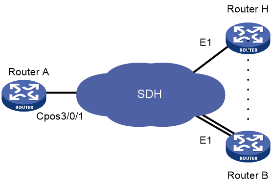

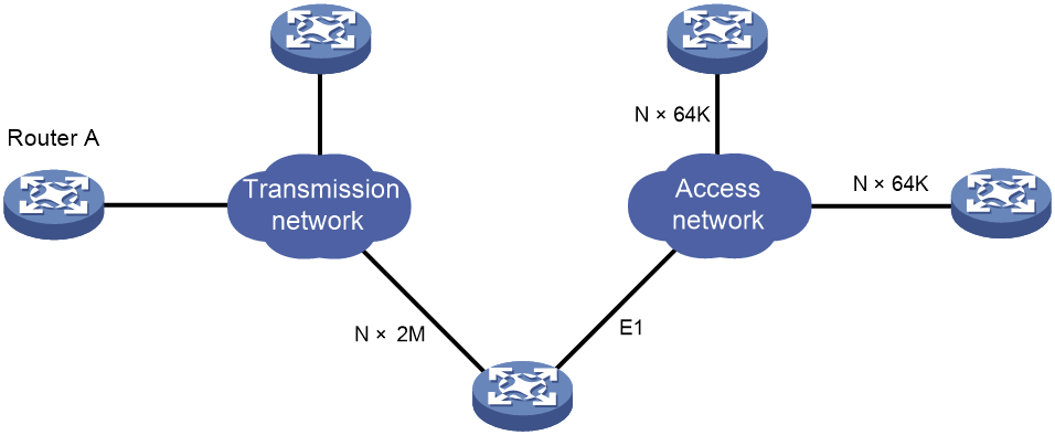

CPOS E1 interfaces are typically used to aggregate E1 lines, as shown in Figure 1.
In actual applications, the connection between low-end devices and the CPOS interfaces might span more than one transmission network and might require relay.
Figure 1 CPOS E1 interface application scenario

Add one additional E1 link on Router B to expand its capacity, and use an MP-group interface to bind the two E1 links.
Figure 2 Network diagram
For correct network synchronization, make sure the master clock mode is configured on the SONET/SDH devices connected to the routers.
1.     Configure Router A:
# Configure E1 channels 1 and 2 of CPOS 2/2/1 to operate in unframed mode.
<RouterA> system-view
[RouterA] controller cpos 3/0/1
[RouterA-Cpos 3/0/1] e1 1 unframed
[RouterA-Cpos 3/0/1] e1 2 unframed
# Create MP-group 3/0/1 and assign an IP address to it.
[RouterA] interface mp-group 3/0/1
[RouterA-Mp-group3/0/1] ip address 10.1.1.1 24
[RouterA-Mp-group3/0/1] quit
# Assign Serial 3/0/1/1:0 to MP-group 3/0/1.
[RouterA] interface serial3/0/1/1:0
[RouterA-Serial3/0/1/1:0] ppp mp mp-group 3/0/1
[RouterA-Serial3/0/1/1:0] quit
# Assign Serial 3/0/1/2:0 to MP-group 3/0/1.
[RouterA] interface serial3/0/1/2:0
[RouterA-Serial3/0/1/2:0] ppp mp mp-group 3/0/1
[RouterA-Serial3/0/1/2:0] quit
2.     Configure Router B:
# Configure E1 3/0/1 to operate in E1 mode.
<RouterB> system-view
[RouterB] controller e1 3/0/1
[RouterB-E1 3/0/1] using e1
[RouterB-E1 3/0/1] quit
# Configure E1 3/0/2 to operate in E1 mode.
[RouterB] controller e1 3/0/2
[RouterB-E1 3/0/2] using e1
[RouterB-E1 3/0/2] quit
[RouterB] interface mp-group 3/0/1
[RouterB-Mp-group3/0/1] ip address 10.1.1.2 24
[RouterB-Mp-group3/0/1] quit
# Assign Serial 3/0/1:0 to MP-group 3/0/1.
[RouterB] interface serial3/0/1:0
[RouterB-Serial3/0/1:0] ppp mp mp-group 3/0/1
[RouterB-Serial3/0/1:0] quit
# Assign Serial 3/0/2:0 to MP-group 3/0/1.
[RouterB] interface serial3/0/2:0
[RouterB-Serial3/0/2:0] ppp mp mp-group 3/0/1
[RouterB-Serial3/0/2:0] quit
# Execute the display interface serial 3/0/1:0, display interface mp-group 3/0/1, and display ppp mp commands to view the connectivity state.
# Verify that the routers can ping one another. (Details not shown.)
