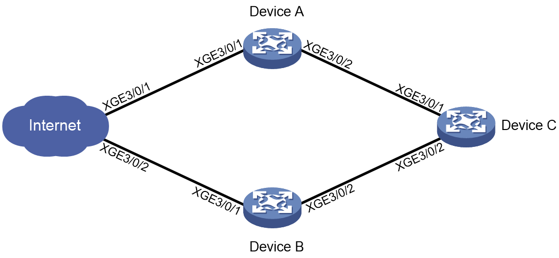

Example: Configuring GIR in an ECMP-based node redundancy environment
As shown in Figure 1, Device A and Device B have ECMP routes for traffic between Internet and Device C. Before upgrading Device A, use GIR to place it in maintenance mode to prevent packet losses during upgrade. Then, change Device A back to normal mode after its software is upgraded.
1. Configure IP addresses and a unicast routing protocol (for example, OSPF). Make sure ECMP routes are available for traffic between the Internet and Device C to traverse Device A or Device B to reach the destination. (Details not shown.)
2. Isolate Device A from the network before you upgrade it.
# Change Device A from the normal mode to the maintenance mode.
<Device A> display system stable state summary
System state : Stable
Redundancy state : No redundance
NSR state : No standby
<Device A> system-view
[Device A] gir system-mode maintenance
Collecting commands... Please wait.
Configuration to be applied:
ospf 1
isolate enable
Do you want to continue? [Y/N]: y
Generated a snapshot: before_maintenance.
Applying: ospf 1
Applying: isolate enable
Waiting 120 seconds to release the CLI.
Changed to maintenance mode successfully.
# Verify that the mode switching is successful on Device A.
[Device A] display gir system-mode
System Mode: Maintenance
Revert-delay time: 0min
Maintenance-delay time: 120s
Snapshot-delay time: 120s
# Verify that traffic switching has completed on Device A.
[Device A] display counters rate inbound interface
Usage: Bandwidth utilization in percentage
Interface Usage (%) Total (pps) Broadcast (pps) Multicast (pps)
XGE3/0/1 0 0 -- --
XGE3/0/2 0 0 -- --
Overflow: More than 14 digits.
--: Not supported.
3. Upgrade Device A. (Details not shown.)
4. Restore forwarding services on Device A:
# Change Device A from the maintenance mode back to the normal mode after it is upgraded and rebooted.
[Device A] undo gir system-mode maintenance
ospf 1
undo isolate enable
Applying: ospf 1
Applying: undo isolate enable
Waiting 120 seconds to generate a snapshot.
Generated a snapshot: after_maintenance.
Changed to normal mode successfully.
System Mode: Normal
XGE3/0/1 100 100 -- --
XGE3/0/2 100 100 -- --
--: Not supported.
