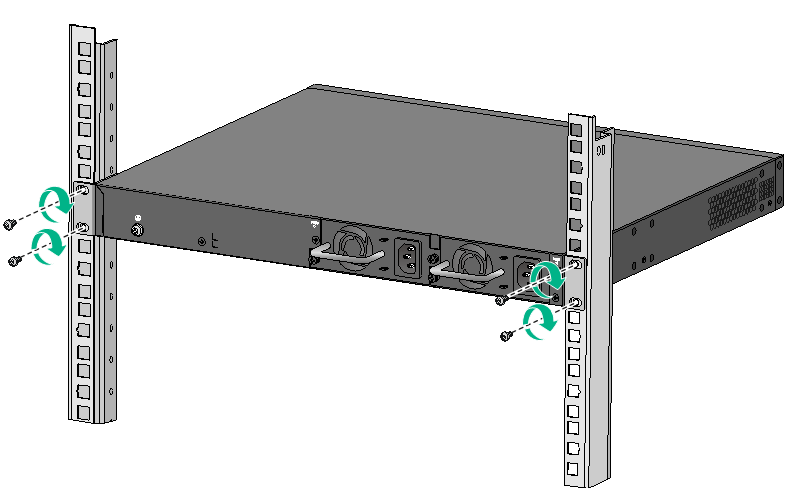

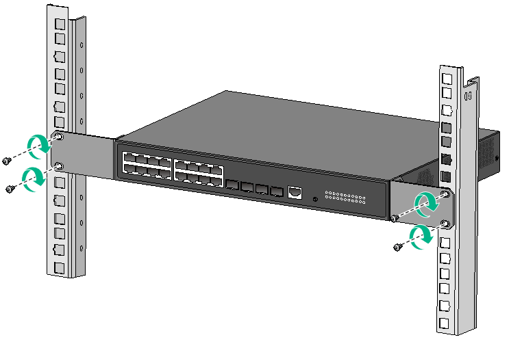

Installing the switch in a 19-inch rack

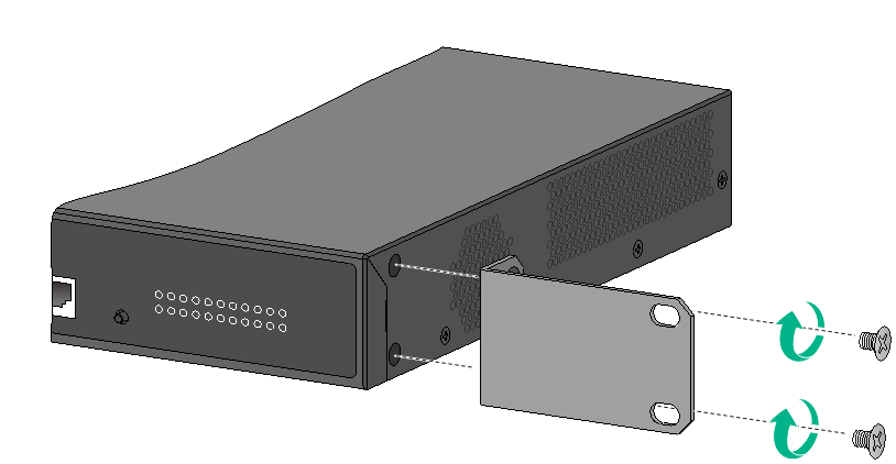

Attaching the mounting brackets to the switch

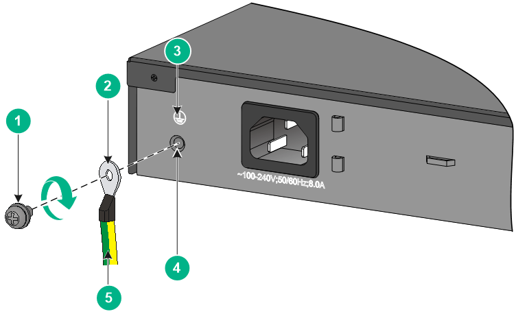

Grounding the switch with a grounding strip
Grounding the switch with a grounding conductor buried in the earth ground
Verifying the connection after grounding the switch

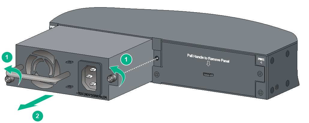

Installing and removing power supplies

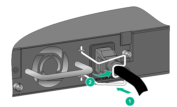

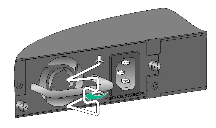

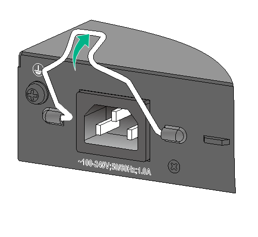

Connecting the AC power cord for the fixed AC power supply (method 1)
Connecting the AC power cord for the fixed AC power supply (method 2)

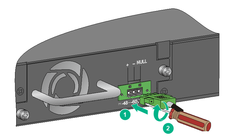

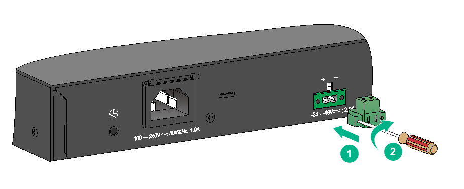

Connecting the DC power cord for the fixed DC power supply (method 1)
Connecting the DC power cord for the fixed DC power supply (method 2)

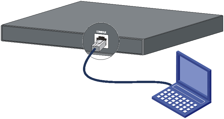

Connecting the switch to a configuration terminal
Connecting a DB9-to-RJ45 console cable
Connecting a USB-to-RJ45 console cable
Connecting a micro USB console cable

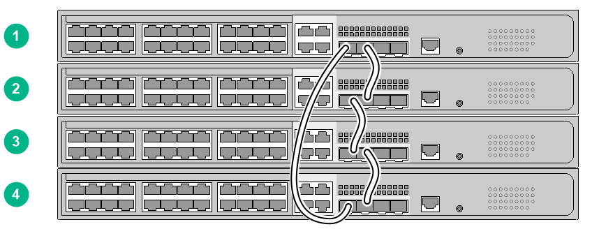

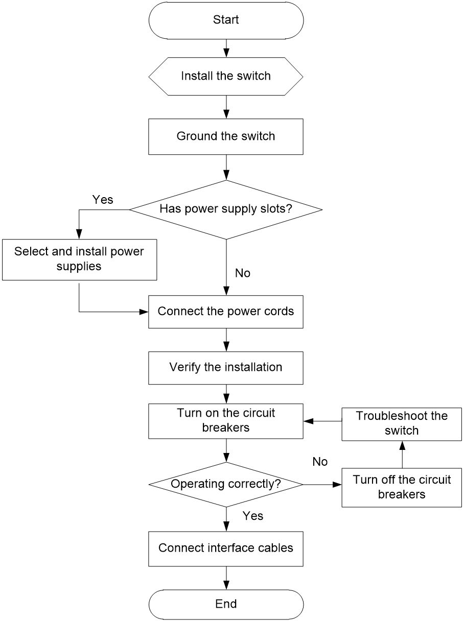

Planning IRF fabric size and the installation site
Identifying the master switch and planning IRF member IDs

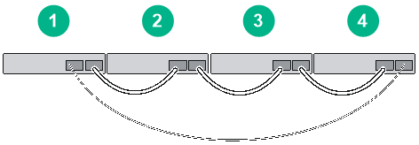

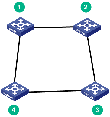

Planning IRF topology and connections
Identifying IRF physical ports on the member switches
Configuring basic IRF settings
Connecting the IRF physical ports
Verifying the IRF fabric setup

2 Installing the switch
CAUTION: Keep the tamper-proof seal on a mounting screw on the chassis cover intact, and if you want to open the chassis, contact H3C for permission. Otherwise, H3C shall not be liable for any consequence. |
Figure2-1 Hardware installation flow

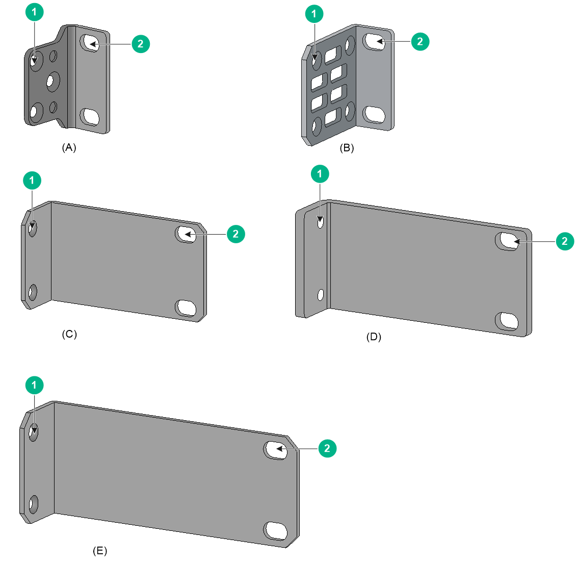

Mounting brackets
Table2-2 describes the mounting brackets applicable to the switch.
Table2-2 Mounting brackets applicable to the switch
Switch model |
Mounting brackets |
Views |
S5130S-28P-EI S5130S-28P-EI-M S5130S-28TP-EI S5130S-52P-EI S5130S-52P-EI-M S5130S-52TP-EI S5130S-28S-EI S5130S-28S-EI-M S5130S-28S-EI-DP S5130S-52S-EI S5130S-52S-EI-M S5130S-28P-PWR-EI S5130S-28P-HPWR-EI S5130S-28P-HPWR-EI-AC S5130S-52P-PWR-EI S5130S-52P-PWR-EI-AC S5130S-28S-PWR-EI S5130S-28S-HPWR-EI S5130S-28S-HPWR-EI-Q S5130S-28S-HPWR-EI-AC S5130S-28S-UPWR-EI-Q S5130S-52S-PWR-EI S5130S-52S-PWR-EI-AC S5130S-28MP-EI S5130S-28MP-HPWR-EI S5130S-52MP-EI |
Mounting brackets A (provided) |
See A in Figure2-2. |
S5130S-28F-EI S5130S-52F-EI S5130S-28PS-EI S5130S-28ST-EI S5130S-52ST-EI S5130S-28ST-PWR-EI S5130S-52ST-PWR-EI |
Mounting brackets B (provided) |
See B in Figure2-2. |
S5130S-20P-EI S5130S-10P-HPWR-EI S5130S-12TP-HPWR-EI S5130S-20P-PWR-EI |
Mounting brackets C with product code SOHO-SWITCH-FL-02 (optional) |
See C in Figure2-2. |
S5130S-16S-PWR-EI S5130S-16S-UPWR-EI-Q S5130S-10MS-UPWR-EI |
Mounting brackets D with product code LS5-FL-D (optional) |
See D in Figure2-2. |
S5130S-10P-EI S5130S-12TP-EI |
Mounting brackets E with product code SOHO-SWITCH-FL-01 (optional) |
See E in Figure2-2. |
(1) Screw hole for attaching the bracket to the switch |
(2 ) Screw hole for attaching the bracket to the rack post |

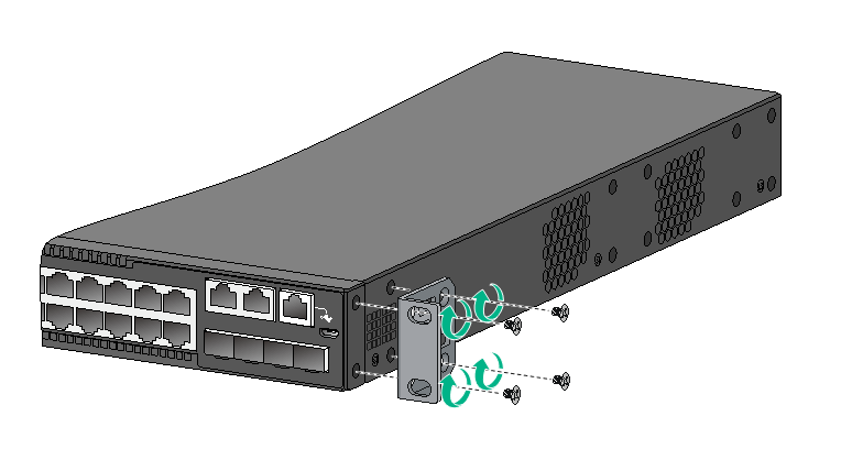

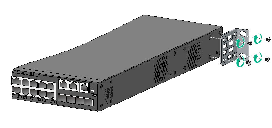

1. Determine the installation position for the mounting brackets.
¡ The S5130S-28F-EI, S5130S-52F-EI, S5130S-28PS-EI, S5130S-28ST-PWR-EI, and S5130S-52ST-PWR-EI switches provide two installation positions for the mounting brackets: port side mounting position and power supply side mounting position.
¡ The other S5130S-EI switches provide only the port side mounting position for the mounting brackets.
2. Align one mounting bracket with the screw holes at the mounting position. Use M4 screws to attach the mounting bracket to the chassis. See Figure2-3 for installing mounting bracket A, Figure2-4 and Figure2-5 for installing mounting bracket B, and Figure2-6 for installing mounting bracket C, D, and E (C as an example).
3. Repeat step 2 to attach the other mounting bracket to the chassis.
Figure2-3 Attaching mounting bracket A (S5130S-28P-HPWR-EI switch)
Figure2-4 Attaching mounting bracket B to the port side mounting position (S5130S-52F-EI switch)
Figure2-6 Attaching mounting bracket C (S5130S-20P-PWR-EI switch)

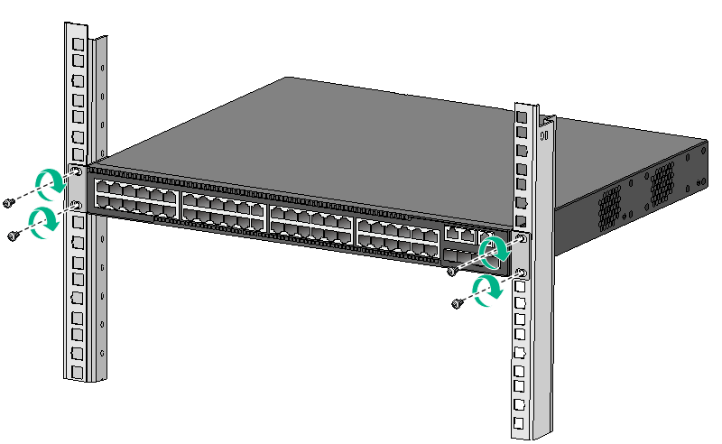

Rack-mounting the switch
This task requires two people. To mount the switch in the rack:
1. Wear an ESD wrist strap and make sure it makes good skin contact and is reliably grounded.
2. Verify that the mounting brackets have been securely attached to the switch chassis.
3. Install cage nuts in the mounting holes in the rack posts.
No cage nuts are provided with the switch. Prepare them yourself.
4. One person holds the switch chassis and aligns the mounting brackets with the mounting holes in the rack posts, and the other person attaches the mounting brackets to the rack with M6 screws.
M6 screws are provided only for switches shipped with mounting brackets. For switches not shipped with mounting brackets, prepare M6 screws yourself.
5. Verify that the switch chassis is horizontal and secure.
Figure2-8 Mounting an S5130S-52F-EI switch in the rack (power supply side mounting position for the mounting brackets)
Figure2-9 Mounting an S5130S-20P-PWR-EI switch in the rack

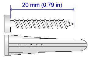

20 mm (0.79 in) long screws and screw anchors as shown in Figure2-10 are provided with these switches for wall-mounting.
Figure2-10 Screw anchor and screw

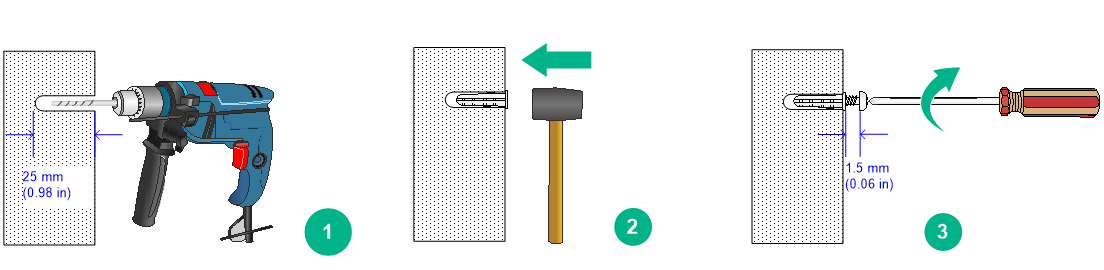

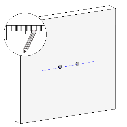

To mount the switch on a wall:
1. Mark two installation holes on the wall. Make sure the two holes are on the same horizontal line.
See Table2-2 for the distance requirement between the two holes.
Figure2-11 Installing the switch on a wall (1)
2. Drill two holes with a diameter of 6 mm (0.24 in) (7 mm/0.28 in for an S5130S-16S-PWR-EI switch) and a depth of 25 mm (0.98 in) at the marked locations. Hammer the screw anchors into the wall and use a Phillips screwdriver to fasten the screw into the screw anchor. Leave 1.5 mm (0.06 in) between the screw head and the wall for hanging the switch.
Figure2-12 Installing the switch on a wall (2)
3. Align the installation holes in the switch rear with the screws on the wall and hang the switch on the screws. Make sure the port side faces down and the left and right sides are perpendicular to the ground.
Figure2-13 Installing the switch on a wall (3)
WARNING! Connect the grounding cable to the grounding system in the equipment room. Do not connect it to a fire main or lightning rod. |
The grounding screw and grounding hole (with a grounding sign) are located at the rear panel of the switch.
To ground the switch by using a grounding strip:
1. Attach the ring terminal end of the grounding cable to the grounding hole in the switch.
a. Remove the grounding screw from the grounding hole in the rear panel of the switch.
b. Attach the grounding screw to the ring terminal of the grounding cable.
c. Use a screwdriver to fasten the grounding screw into the grounding hole.
Figure2-14 Attaching the grounding cable to the grounding hole of the switch (S5130S-28P-HPWR-EI switch)
(1) Grounding screw |
(2) Ring terminal |
(3) Grounding sign |
(4) Grounding hole |
(5) Grounding cable |

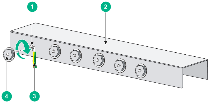

2. Connect the other end of the grounding cable to the grounding strip.
a. Cut the grounding cable to a length according to the distance between the switch and the grounding strip.
b. Peel 20 mm (0.79 in) of insulation sheath by using a wire stripper.
c. Use the needle-nose pliers to bend the bare wire.
d. Hook the grounding cable to the post on the grounding strip, and use the hex nut to secure the cable to the post.
Figure2-15 Connecting the grounding cable to a grounding strip
(1) Grounding post |
(2) Grounding strip |
(3) Grounding cable |
(4) Hex nut |

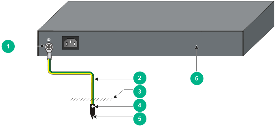

If the installation site does not have grounding strips, but earth ground is available, hammer a 2.5 m (8.20 ft) or longer angle iron or steel tube into the earth ground to act as a grounding conductor. Make sure a minimum of 0.7 m (2.30 ft) is left between the top of the grounding conductor and the ground. In cold areas, bury the grounding conductor below the frozen soil layer. In areas with thin soil or rocky gravel, determine the depth for burying the grounding conductor based on the actual condition.
If zinc-coated steel is used, the following dimensions requirements must be met:
· Angle iron—A minimum of 50 × 50 × 5 mm (1.97 × 1.97 × 0.20 in).
· Steel tube—A minimum of 3.5 mm (0.14 in) in thickness.
· Flat steel—A minimum of 40 × 4 mm (1.57 × 0.16 in).
· Round steel—A minimum of 10 mm (0.39 in).
Weld the yellow-green grounding cable to the angel iron or steel tube and treat the joint for corrosion protection.
Figure2-16 Grounding the switch by burying the grounding conductor into the earth ground
(2) Grounding cable |
(3) Earth |
(4) Joint |
(5) Grounding conductor |
(6) Chassis rear panel |

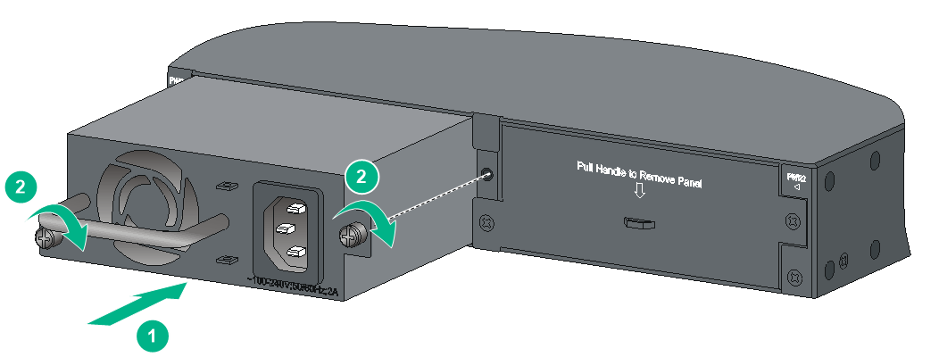

Installing a power supply
2. Unpack the power supply and verify that the power supply model is as required.
3. Remove the filler panel (if any) from the target slot.
If you require only one power supply, install it in power supply slot 1 and make sure a filler panel is installed in power supply slot 2.
4. Orient the power supply with the upside up. Grasp the handle of the power supply with one hand and support its bottom with the other, and slide the power supply slowly along the guide rails into the slot. See callout 1 in Figure2-19.
To prevent damage to the power supply and the connector on the switch backplane, insert the power supply gently. If you encounter a hard resistance or the power supply tilts while inserting the power supply, pull out the power supply, realign it with the slot, and then insert it again.
5. Fasten the captive screws on the power supply with a Phillips screwdriver to secure the power supply in the chassis. See callout 2 in Figure2-19.
If the captive screw cannot be tightly fastened, examine the installation of the power supply.
Figure2-19 Installing a power supply
Removing a power supply
2. Power off the power supply and remove the power cord.
3. Loosen the captive screws on the power supply with a Phillips screwdriver until they are completely disengaged from the chassis.
4. Grasp the handle of the power supply with one hand and pull the module part way out. Support the module bottom with the other hand, and pull the power supply slowly along the guide rails out of the slot.
5. Place the removed power supply in an antistatic bag.
Figure2-20 Removing a power supply

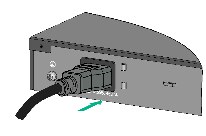

1. Connect the plug of the AC power cord to the AC-input power receptacle on the switch. See Figure2-21.
2. Use a cable tie to secure the power cord to the handle near the AC power receptacle. See Figure2-22.
3. Connect the other end of the power cord to an AC power source.
Figure2-21 Connecting the AC power cord for the fixed AC power supply
Figure2-22 Securing the AC power cord for the fixed AC power supply through a cable tie
1. Insert the two ends of the bail latch through the two holes at both sides of the AC-input power receptacle.
2. Pivot up the bail latch, as shown in Figure2-23.
3. Connect the plug of the AC power cord to the AC-input power receptacle on the switch, as shown by callout 1 in Figure2-24.
4. Pivot down the bail latch to secure the plug to the power receptacle, as shown by callout 2 in Figure2-24.
5. Connect the other end of the power cord to the power source.
Figure2-23 Connecting the AC power cord for the fixed AC power supply
Figure2-24 Securing the AC power cord for the fixed AC power supply through a bail latch
CAUTION: · To connect the switch to a –48 VDC power source, use the DC power cord provided by H3C. To avoid connection mistakes, identify the positive (+) and negative (-) marks on the two wires of the DC power cord before connection. · To connect the switch to an H3C RPS, use a power cord compatible with the RPS. |
To connect the DC power cord for the fixed DC power supply:
1. Correctly orient the DC power cord plug and insert the plug into the power receptacle on the power supply.
If you orient the DC power cord plug upside down, you cannot insert the plug into the power receptacle.
2. Use a flat-head screwdriver to fasten the screws on the power cord connector, as shown in Figure2-25.
3. Connect the other end of the power cord to a –48 VDC power source or an RPS.
Figure2-25 Connecting the DC power cord for the fixed DC power supply

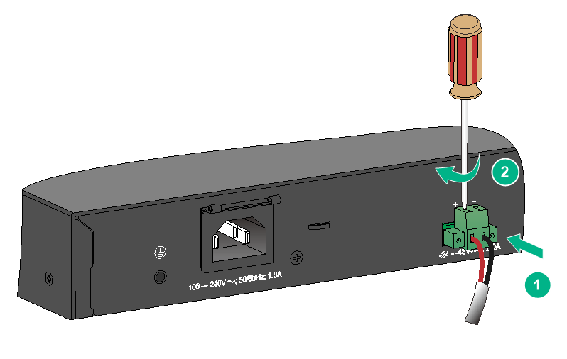

CAUTION: To avoid connection mistakes, identify the positive (+) and negative (-) marks above the DC power receptacle before connecting the switch to a –48 VDC power source. |
IMPORTANT: No DC power cord is provided with the switch. Make sure the current carrying capacity of the DC power cord is consistent with the rated current defined in the port identifier. |
1. Correctly orient the terminal block and attach the terminal block to the power receptacle on the power supply, as shown by callout 1 in Figure2-26.
If you orient the terminal block upside down, you cannot attach it to the power receptacle.
2. Use a flat-head screwdriver to fasten the screws on the terminal block to secure the terminal block to the power receptacle. See callout 2 in Figure2-26.
3. Insert the two DC power wires into the terminal block, as shown by callout 1 in Figure2-27.
4. Use a flat-head screwdriver to fasten the screw at the top of the terminal block to secure the DC power cord to the power receptacle. See callout 2 in Figure2-27.
5. Connect the other end of the power cord to a –48 VDC power source.
Figure2-26 Attaching the terminal block to the fixed DC power supply
Figure2-27 Securing the DC power cord to the terminal block
Connecting the power cord for a CA-70A12/PSR75-12A/PSR150-A1 power supply
1. Pull the bail latch leftward, as shown in Figure2-28.
2. Connect the plug of the power cord to the power receptacle on the switch. See Figure2-29.
3. Pull the bail latch rightward to secure the plug to the power receptacle. See Figure2-29.
4. Connect the other end of the power cord to a power source.
5. For a CA-70A12 or PSR150-A1 power supply, connect the power cord to an AC power source. For a PSR75-12A power supply, connect the power cord to an AC power source or a 240V high-voltage DC power source.
Figure2-28 Connecting the power cord for a CA-70A12/PSR75-12A/PSR150-A1 power supply (1)
Figure2-29 Connecting the power cord for a CA-70A12/PSR75-12A/PSR150-A1 power supply (2)

In Figure3-1, the switch is connected to a configuration terminal (PC as an example) from the serial console port.
Figure3-1 Connecting the switch to a configuration terminal
As shown in Figure3-1, three types of console cables can be used for connecting the switch to a configuration terminal. The switch is not provided with a serial console cable or a micro USB console cable.

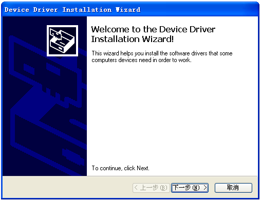

3. If the Windows system supports the driver, install PL23XX-M_LogoDriver_Setup_v200_20190815.exe.
4. Click Next on the welcome page of the driver installation wizard.
Figure3-3 Driver installation wizard
5. Click Finish after the drive installation is completed.
Figure3-4 Finishing the driver installation

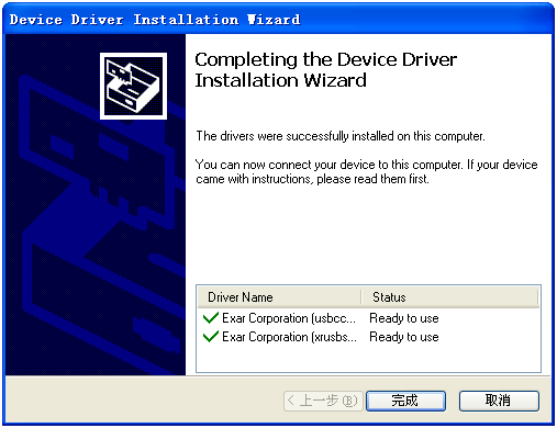

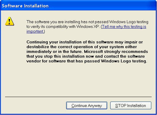

3. Click the following link, or copy it to the address bar on the browser to log in to download and install the USB console driver on the configuration terminal.
http://www.h3c.com/en/home/USB_Console/
4. Select a driver program according to the operating system you use:
¡ XR21V1410_XR21B1411_Windows_Ver1840_x86_Installer.EXE—32-bit operating system.
¡ XR21V1410_XR21B1411_Windows_Ver1840_x64_Installer.EXE—64-bit operating system.
5. Click Next on the installation wizard.
Figure3-5 Device Driver Installation Wizard
6. Click Continue Anyway.
Figure3-6 Software Installation
7. Click Finish.
Figure3-7 Completing the device driver installation wizard

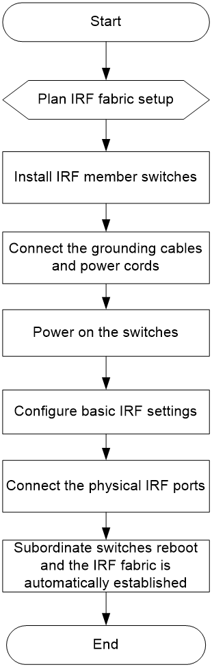

IRF fabric setup flowchart
Figure4-1 IRF fabric setup flowchart
To set up an IRF fabric:
Step |
Description |
1. Plan IRF fabric setup. |
Plan the installation site and IRF fabric setup parameters: · Planning IRF fabric size and the installation site · Identifying the master switch and planning IRF member IDs · Planning IRF topology and connections |
2. Install IRF member switches. |
See "Installing the switch in a 19-inch rack" or "Mounting the switch on a workbench." |
3. Connect grounding cables and power cords. |
See "Grounding the switch" and "Connecting the power cord." |
4. Power on the switches. |
N/A |
5. Configure basic IRF settings. |
See the IRF configuration guide or virtual technologies configuration guide for the switch series, depending on the software version. |
6. Connect the IRF physical ports. |
Connect IRF physical ports on switches. All switches except the master switch automatically reboot, and the IRF fabric is established. |

As a best practice, use ring topology to connect the switches. The following describes cabling schemes in ring topology.

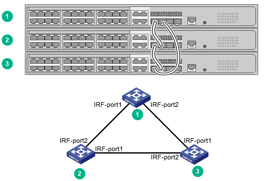

Connecting the IRF member switches in one rack
Use SFP cables to connect the IRF member switches in a rack as shown in Figure4-4. The switches in the ring topology (see Figure4-5) are in the same order as connected in the rack.
Figure4-4 Connecting the switches in one rack
Connecting the IRF member switches in a ToR solution
You can install IRF member switches in different racks side by side to deploy a top of rack (ToR) solution.
Figure4-6 shows an example for connecting four top of rack IRF member switches. The topology is the same as Figure4-5.
To verify the basic functionality of the IRF fabric after you finish configuring basic IRF settings and connecting IRF ports:
1. Log in to the IRF fabric through the console port of any member switch.
2. Create a Layer 3 interface, assign it an IP address, and make sure the IRF fabric and the remote network management station can reach each other.
3. Use Telnet or SNMP to access the IRF fabric from the network management station. (See the fundamentals configuration guide for the switch series.)
4. Verify that you can manage all member switches as if they were one node.
5. Display the running status of the IRF fabric by using the commands in Table4-2.
Table4-2 Displaying and maintaining IRF configuration and running status
Task |
Command |
Display IRF fabric information. |
display irf |
Display basic IRF settings for each member device. |
display irf configuration |
Display IRF fabric topology information. |
display irf topology |
NOTE: To avoid IP address collision and network problems, configure a minimum of one multi-active detection (MAD) mechanism to detect the presence of multiple identical IRF fabrics and handle collisions. For more information about MAD detection, see the IRF configuration guide or virtual technologies configuration guide for the switch series, depending on the software version. |

Removable power supply failure
The S5130S-28F-EI and S5130S-52F-EI switches use removable power supplies. You can determine the power supply operating status by examining the power supply LEDs PWR1 and PWR2 on the switch front panel. For descriptions about the PWR1 and PWR2 LEDs, see LEDs in S5130S-EI Switch Series Hardware Information and Specifications.
Symptom
A power supply LED on the front panel of the switch is not steady green.
Solution
To resolve the issue:
1. Verify that the AC or DC power cord is correctly connected to the switch.
2. Verify that the power supply model is as required.
3. Verify that the power supply is installed correctly in the switch.
4. Verify that the switch is operating in the acceptable temperature range.
5. If the power supply needs to be replaced, see "Installing and removing power supplies" to replace the power supply.
6. If the issue persists, contact H3C Support.

Configuration terminal issues
No display on the configuration terminal
Symptom
The configuration terminal does not have display when the switch is powered on.
Solution
1. Verify that the power system is operating correctly.
2. Verify that the switch is operating correctly.
3. Verify that the console cable has been connected correctly.
4. Verify that the following settings are configured for the terminal:
¡ Baud rate—9600.
¡ Data bits—8.
¡ Parity—None.
¡ Stop bits—1.
¡ Flow control—None.
5. Verify that the console cable is not faulty.
