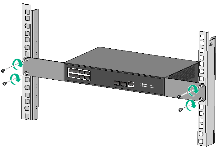

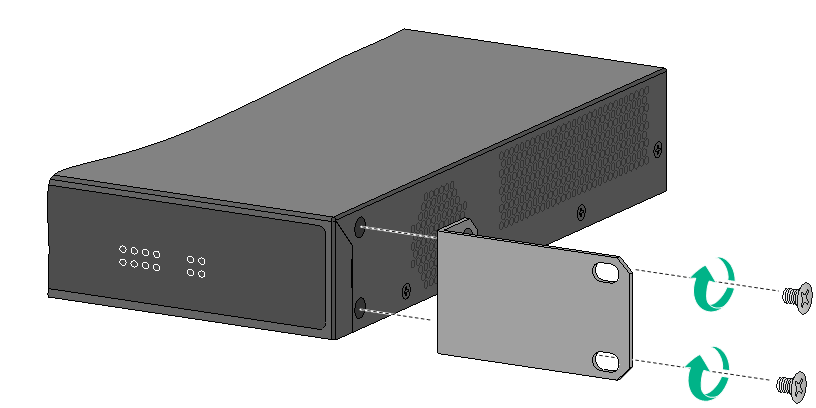

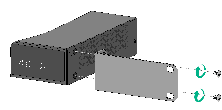

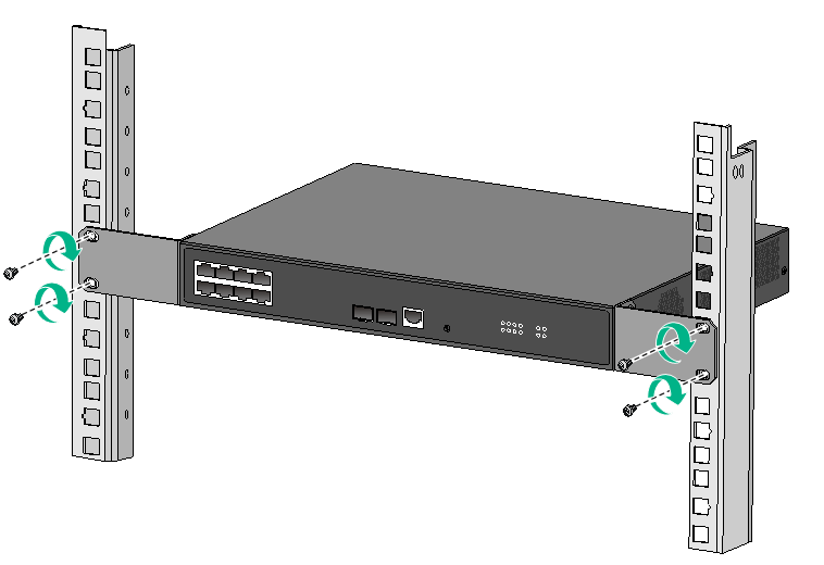

Installing the switch in a 19-inch rack
Mounting brackets

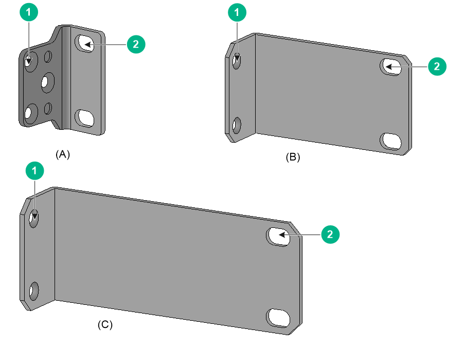

Table2-2 describes the mounting brackets applicable to the switch.
Table2-2 Mounting brackets applicable to the switch
Switch model
Mounting brackets
Views
S1850V2-52P-EI
S1850V2-28P-EI
S1850V2-28P-HPWR-EI
Mounting brackets A (provided)
See A in Figure2-2.
S1850V2-10P-PWR-EI
Mounting brackets B with product code SOHO-SWITCH-FL-02 (optional)
See B in Figure2-2.
S1850V2-9P-EI
S1850V2-10P-EI
Mounting brackets C with product code SOHO-SWITCH-FL-01 (optional)
See C in Figure2-2.
Figure2-2 Mounting brackets
 (1) Screw hole for attaching the bracket to the switch
(2 ) Screw hole for attaching the bracket to the rack post

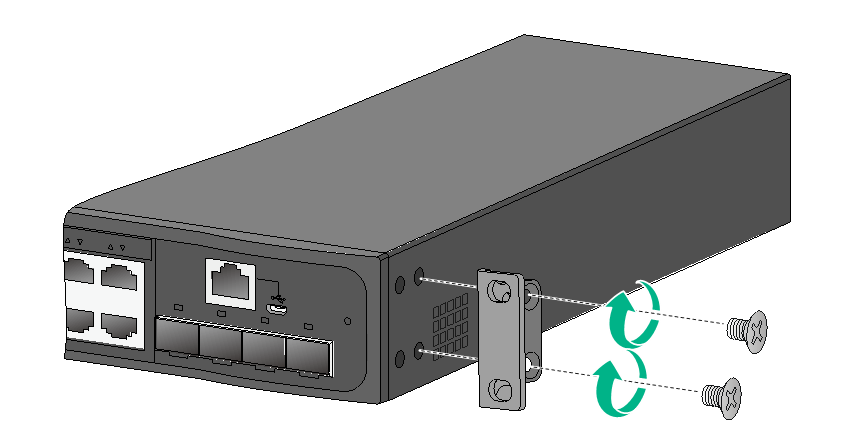

Attaching the mounting brackets to the switch
1.     Align one mounting bracket with the screw holes at the mounting position. Use M4 screws to attach the mounting bracket to the chassis. See Figure2-3 for installing mounting bracket A, Figure2-4 for installing mounting bracket B, and Figure2-5 for installing mounting bracket C.
2.     Repeat step 1 to attach the other mounting bracket to the chassis.
Figure2-3 Attaching mounting bracket A (S1850V2-52P-EI switch)
Figure2-4 Attaching mounting bracket B (S1850V2-10P-PWR-EI switch)
Figure2-5 Attaching mounting bracket C (S1850V2-10P-EI switch)
Rack-mounting the switch
This task requires two people. To mount the switch in the rack:
1.     Wear an ESD wrist strap and make sure it makes good skin contact and is reliably grounded.
2.     Verify that the mounting brackets have been securely attached to the switch chassis.
3.     Install cage nuts in the mounting holes in the rack posts.
No cage nuts are provided with the switch. Prepare them yourself.
4.     One person holds the switch chassis and aligns the mounting brackets with the mounting holes in the rack posts, and the other person attaches the mounting brackets to the rack with M6 screws.
M6 screws are provided only for switches shipped with mounting brackets. For switches not shipped with mounting brackets, prepare M6 screws yourself.
5.     Verify that the switch chassis is horizontal and secure.
Figure2-6 Mounting an S1850V2-10P-PWR-EI switch in the rack
Figure2-7 Mounting an S1850V2-10P-EI switch in the rack

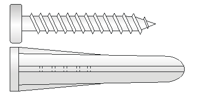

Use the provided screw anchors and screws to wall-mount the switch.
Figure2-8 Screw anchor and screw

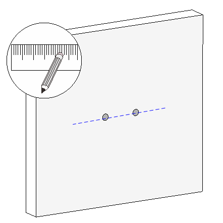

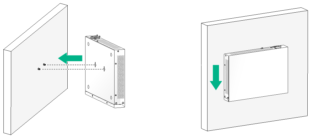

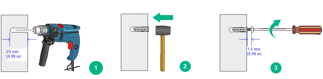

To mount the switch on a wall:
1.     Mark two installation holes on the wall. Make sure the two holes are on the same horizontal line.
See Table2-2 for the distance requirement between the two holes.
Figure2-9 Installing the switch on a wall (1)
2.     Drill two holes with a diameter of 6 mm (0.24 in) and a depth of 25 mm (0.98 in) at the marked locations. Hammer the screw anchors into the wall and use a Phillips screwdriver to fasten the screw into the screw anchor. Leave 1.5 mm (0.06 in) between the screw head and the wall for hanging the switch.
Figure2-10 Installing the switch on a wall (2)
3.     Align the installation holes in the switch rear with the screws on the wall and hang the switch on the screws. Make sure the port side faces down and the left and right sides are perpendicular to the ground.
Figure2-11 Installing the switch on a wall (3)

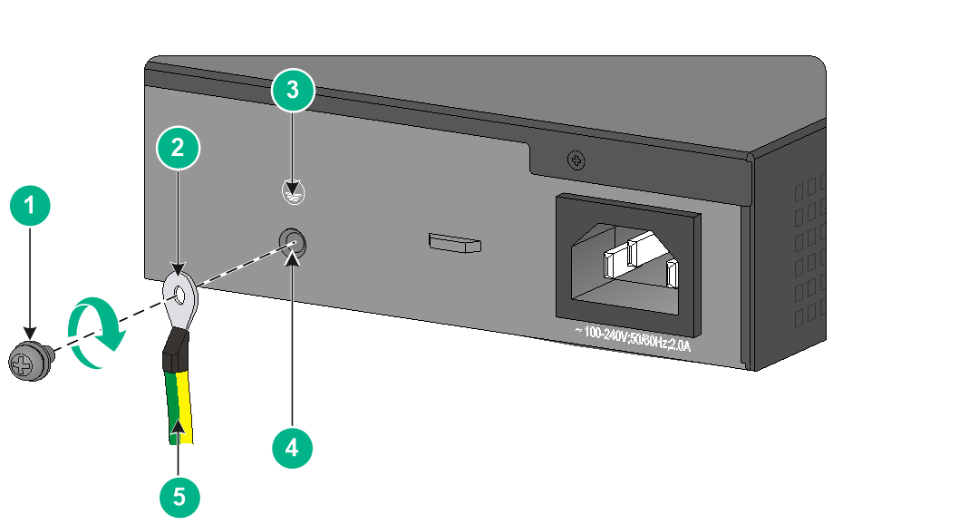

1.     Attach the ring terminal end of the grounding cable to the grounding hole in the switch.
a.     Remove the grounding screw from the grounding hole in the rear panel of the switch.
b.     Attach the grounding screw to the ring terminal of the grounding cable.
c.     Use a screwdriver to fasten the grounding screw into the grounding screw hole.
Figure2-12 Attaching the grounding cable to the grounding hole of the switch (S1850V2-52P-EI switch)
(1) Grounding screw
(2) Ring terminal
(3) Grounding sign
(4) Grounding hole
(5) Grounding cable

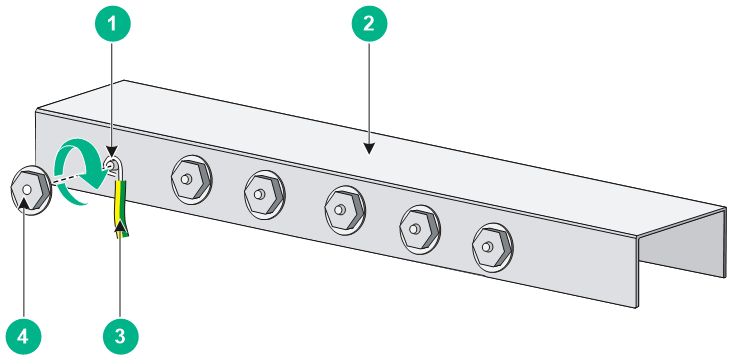

2.     Connect the other end of the grounding cable to the grounding strip.
a.     Cut the grounding cable to a length according to the distance between the switch and the grounding strip.
b.     Peel 20 mm (0.79 in) of insulation sheath by using a wire stripper.
c.     Use the needle-nose pliers to bend the bare wire.
d.     Hook the grounding cable to the post on the grounding strip, and use the hex nut to secure the cable to the post.
Figure2-13 Connecting the grounding cable to a grounding strip
(1) Grounding post
(2) Grounding strip
(3) Grounding cable
(4) Hex nut

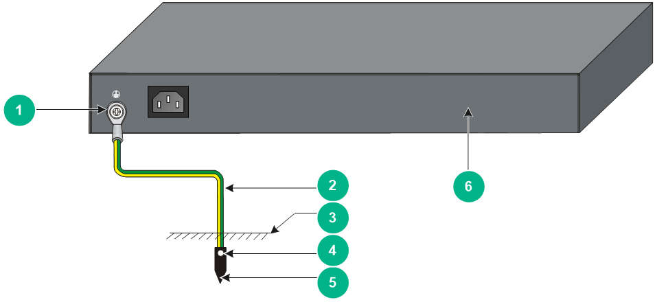

Grounding the switch with a grounding conductor buried in the earth ground
If the installation site does not have grounding strips, but earth ground is available, hammer a 2.5 m (8.20 ft) or longer angle iron or steel tube into the earth ground to act as a grounding conductor. Make sure a minimum of 0.7 m (2.30 ft) is left between the top of the grounding conductor and the ground. In cold areas, bury the grounding conductor below the frozen soil layer. In areas with thin soil or rocky gravel, determine the depth for burying the grounding conductor based on the actual condition.
If zinc-coated steel is used, the following dimensions requirements must be met:
·     Angle iron—A minimum of 50 × 50 × 5 mm (1.97 × 1.97 × 0.20 in).
·     Steel tube—A minimum of 3.5 mm (0.14 in) in thickness.
·     Flat steel—A minimum of 40 × 4 mm (1.57 × 0.16 in).
·     Round steel—A minimum of 10 mm (0.39 in).
Weld the yellow-green grounding cable to the angel iron or steel tube and treat the joint for corrosion protection.
Figure2-14 Grounding the switch by burying the grounding conductor into the earth ground
(1) Grounding screw
(2) Grounding cable
(3) Earth
(4) Joint
(5) Grounding conductor
(6) Chassis rear panel

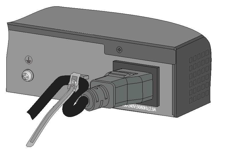

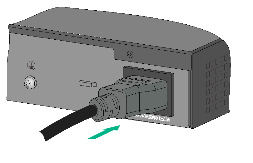

1.     Connect the plug of the AC power cord to the AC-input power receptacle on the switch. See Figure2-15.
2.     Use a cable tie to secure the power cord to the handle near the AC power receptacle. See Figure2-16.
3.     Connect the other end of the power cord to an AC power source.
Figure2-15 Connecting the AC power cord for the fixed AC power supply
Figure2-16 Securing the AC power cord for the fixed AC power supply through a cable tie
