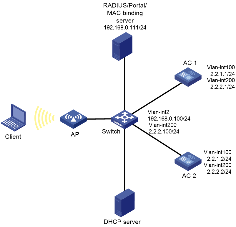

As shown in Figure 1, the AP and the client obtain IP addresses from the DHCP server. The IMC server acts as the portal authentication server, portal Web server, and RADIUS server.
Configure the devices to meet the following requirements:
· The AP associates with both ACs and the two ACs to back up each other. When the master AC fails, the backup AC takes over, and the AP can provide services correctly through the backup AC.
· Before passing portal authentication, the client can access only the portal Web server. After passing the authentication, the client can access other network resources.
· The client can access network resources through any Layer 2 ports in its access VLAN without re-authentication.
· The IMC server can dynamically modify user authorization information and log off clients.

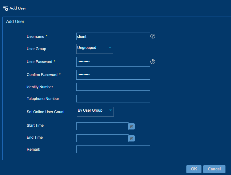

1. Add an access user:
a. Log in to IMC and click the Service tab.
b. From the navigation tree, select Intelligent Portal Management > User Management > Users.
c. Click Add to open the Add User page.
d. Enter username Client and password admin@123.
e. Use the default settings for other parameters.
f. Click OK.
Figure 2 Adding an access user

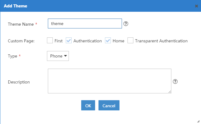

2. Add an authentication page template:
a. From the navigation tree, select Intelligent Portal Management > Page Template List.
b. Click Add to open the Add Theme page.
c. Enter template name theme in the Theme Name field.
d. Use the default settings for other parameters.
e. Click OK to open the page for editing the template.

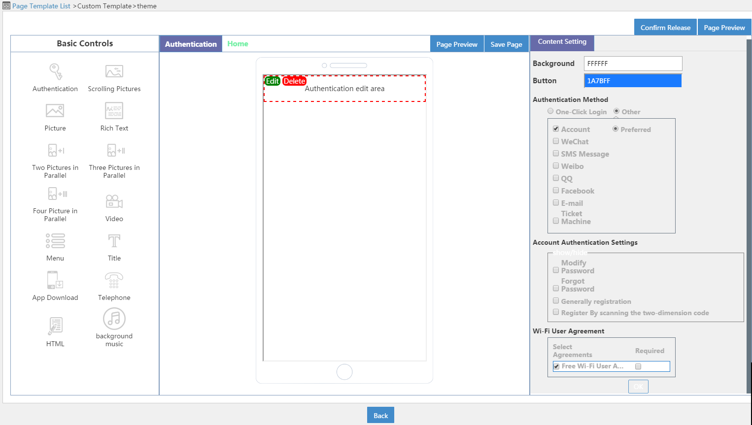

Figure 3 Adding an authentication page template
f. On the theme page, click
the Authentication icon
in
the Basic Controls area.
g. Click Edit in authentication edit area, select Other and Account in the Authentication Method area, click OK, and then click Save Page.
h. Use the default settings for other configuration.
i. Click Confirm Release.

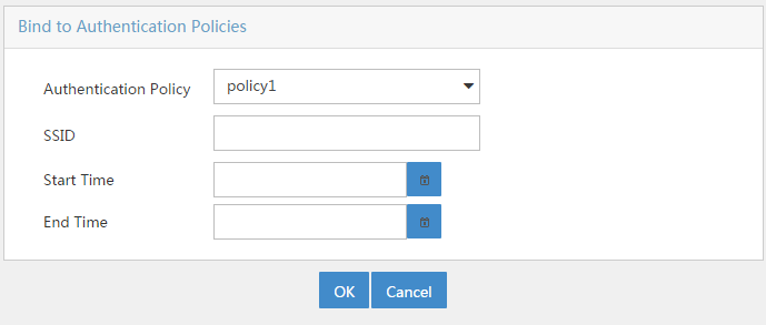

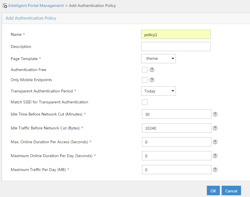

3. Add an authentication policy:
a. From the navigation tree, select Intelligent Portal Management > Authentication Policies.
b. Click Add to open the Add Authentication Policy page.
c. Enter authentication policy name policy1, and select theme from the Page Template list.
e. Click OK.
Figure 5 Adding an authentication policy

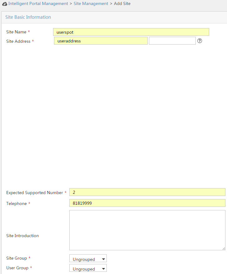

4. Add a site:
a. From the navigation tree, select Intelligent Portal Management > Site Management.
b. Click Add to open the Add Site page.
c. Enter the site name, the site address, the expected number of clients to be supported, and the telephone number.
d. Click OK.
Figure 6 Adding a site

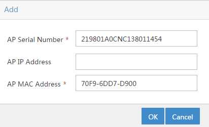

f. Enter the serial number and MAC address of the AP.
g. Click OK.
Figure 7 Adding an AP
i. In the Bind Authentication Policy area, click Add to bind the AP to an authentication policy.
j. Select authentication policy policy1.
k. Use the default settings for other parameters.
l. Click OK.
Figure 8 Binding the AP to an authentication policy
