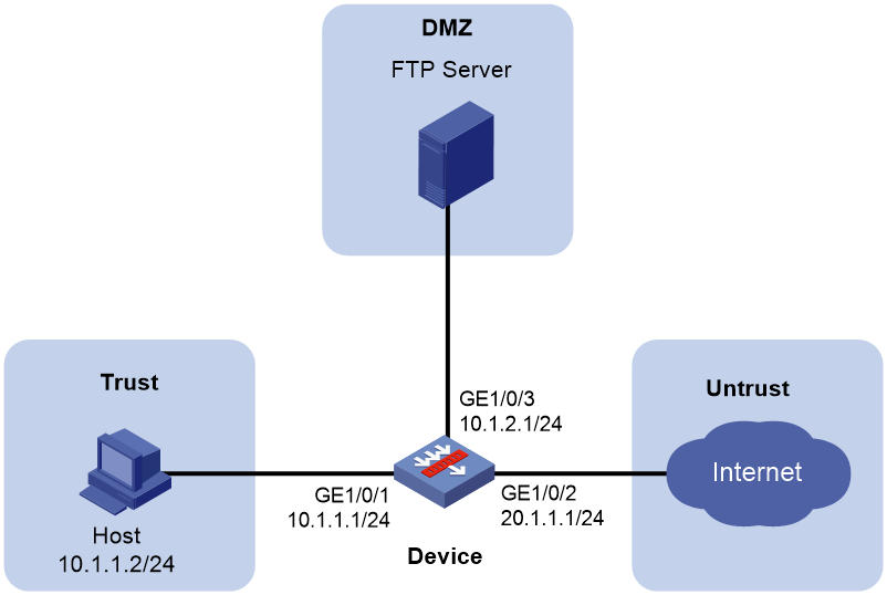

Example: Configuring packet capture (in standalone mode)
As shown in Figure 1, capture packets between 10.1.1.0/24 and 20.1.1.0/24 on GigabitEthernet 1/0/1. Set the maximum packet size for a packet capture record to 3000 bytes. Use a remote file server to save the .cap files.

5. Configure packet capture:
# Set the storage directory for the .cap files to ftp://ftp.remote.com/pcap/. Specify the username and password for accessing the FTP server.
[Device] packet-capture storage remote ftp://ftp.remote.com/pcap/ user zhangsan password simple 123456TESTplat&!
# Set the maximum packet size for a packet capture record to 3000 bytes.
[Device] packet-capture max-bytes 3000
# Start packet capture to capture packets identified by ACL 3001.
[Device] packet-capture start acl 3001
# Display packet capture settings and status information.
[Device] display packet-capture status
Capture status: Started
Filter: ACL 3001
# Use a packet analyzer to display captured packets. (Details not shown.)
