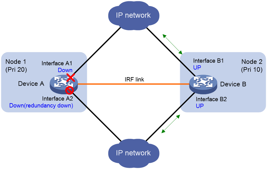

·     When the active member interface goes down physically, the inactive interface automatically becomes active to forward packets.
If the Reth interface is added to a redundancy group, the member interface states are determined by the redundancy group. For more information, see "Configuring redundancy groups."

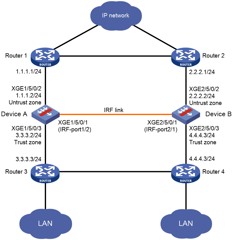

The Reth interface feature is typically used with the redundancy group feature. For more information, see "Configuring redundancy groups."

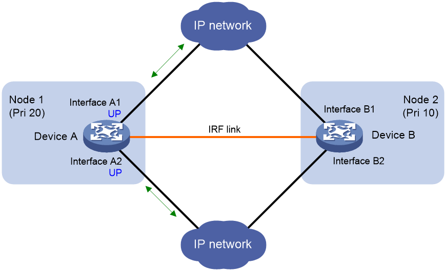

A redundancy group works on IRF fabrics. It allows traffic to enter and leave an IRF fabric through the same member device.
Operating mechanism of a redundancy group
As shown in Figure 1, a redundancy group has two redundancy group nodes. Each node is bound to an IRF member device.

In a redundancy group, one node is in primary state, and the other node is in secondary state. Only the primary node forwards traffic. When the primary node fails, the redundancy group switches over to the secondary node. This mechanism ensures path symmetry for traffic.
As shown in Figure 1, a redundancy group performs a switchover as follows:
1.     When both IRF member devices are operating correctly, the redundancy group forwards traffic through Node 1 (Device A) and backs up services and data (such as NAT) to Node 2 (Device B).
2.     When the upstream interface on Device A fails, the redundancy group shuts down the downstream interface on Device A and switches traffic over to Device B.
Figure 1 Redundancy group operating mechanism

Using physical Ethernet interfaces in a redundancy group
You assign physical Ethernet interfaces to a redundancy group by binding them to their respective redundancy group nodes.
For symmetric traffic switchover, you must bind a minimum of one downlink interface and a minimum of one uplink interface with each node of the redundancy group.
The state of the member physical Ethernet interfaces changes with the state of the redundancy group nodes. Only the member interfaces on the primary node can forward traffic.
As shown in Figure 2, Interface A1 and Interface A2 are on Node 1, and Interface B1 and Interface B2 are on Node 2. When Node 1 is in primary state, Interface A1 and Interface A2 are up to forward traffic, while Interface B1 and Interface B2 do not forward traffic.
When Interface A1 goes down, the Reth module places Node 1 in secondary state. Node 2 changes to the primary state, and Interface B1 and Interface B2 take over to forward traffic, as shown in Figure 3.
Figure 2 States of the member interfaces when both nodes are operating correctly
Figure 3 States of the member interfaces after a switchover

# Shut down Ten-GigabitEthernet 1/5/0/3.
[DeviceA] interface ten-gigabitethernet 1/5/0/3
[DeviceA-Ten-GigabitEthernet1/5/0/3] shutdown
[DeviceA-Ten-GigabitEthernet1/5/0/3] quit
# Verify that node 2 has become the primary node in redundancy group aaa. Ten-GigabitEthernet 1/5/0/2 has been shut down by the Reth module. The member interfaces on node 2 are up.
[DeviceA] display redundancy group aaa
Redundancy group aaa (ID 1):
  Node ID      Chassis       Priority   Status        Track weight
  1            Chassis1      100        Secondary     -255
  2            Chassis4      50         Primary       255
Preempt delay time remained     : 0    min
Preempt delay timer setting     : 1    min
Remaining hold-down time        : 0    sec
Hold-down timer setting         : 1    sec
Manual switchover request       : No
Member interfaces:
Member failover groups:
    group1
Node 1:
  Node member     Physical status
      XGE1/5/0/2       DOWN(redundancy down)
      XGE1/5/0/3       DOWN
  Track info:
    Track    Status       Reduced weight     Interface
    1         Negative     255                XGE1/5/0/2
    2         Negative     255                XGE1/5/0/3 (Fault)
    5         Positive     255                Blade1/4/0/1
Node 2:
      XGE2/5/0/2   UP
      XGE2/5/0/3   UP
  Track info:
    3         Positive       255              XGE2/5/0/2
    4         Positive       255              XGE2/5/0/3
    6         Positive       255              Blade2/4/0/1
# Verify that the secondary CPU of failover group group1 is processing services.
[DeviceA] display failover group group1
Stateful failover group information:
ID   Name                      Primary         Secondary       Active Status
255  group1                    1/4.1           2/4.1           Secondary
  Node1     chassis1    100       Secondary    -255
  Node2     chassis2    50        Primary      255
Hold-down timer setting       : 300  sec
Member interfaces:
    Reth1          Reth2
    group1
Node 1:
  Track info:
    2         Negative     255                XGE1/5/0/3(Fault)
Node 2:
  Track info:
# Verify that Ten-GigabitEthernet 1/5/0/2 has been shut down by the Reth module, and Ten-GigabitEthernet 2/5/0/2 and Ten-GigabitEthernet 2/5/0/3 are active.
[DeviceA] display reth interface reth 1
Reth1 :
Redundancy group  : aaa
  Member                 Physical status         Forwarding status    Presence status
  XGE1/5/0/2              DOWN(redundancy down)   Inactive         Normal
  XGE2/5/0/2              UP                      Active           Normal
[DeviceA] display reth interface reth 2
Reth2 :
  XGE1/5/0/3              DOWN                    Inactive         Normal
  XGE2/5/0/3              UP                      Active           Normal
