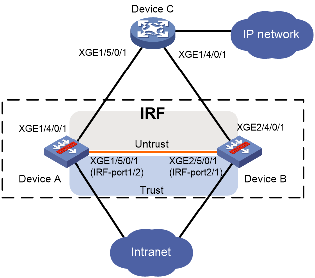

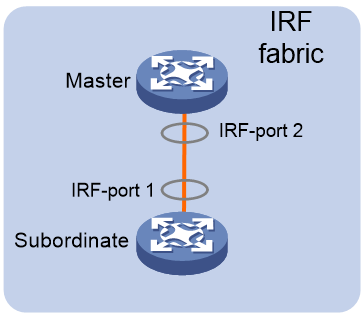

Figure 1 shows an IRF fabric that has two devices, which appear as a single node to the upper-layer and lower-layer devices.
Figure 1 IRF application scenario

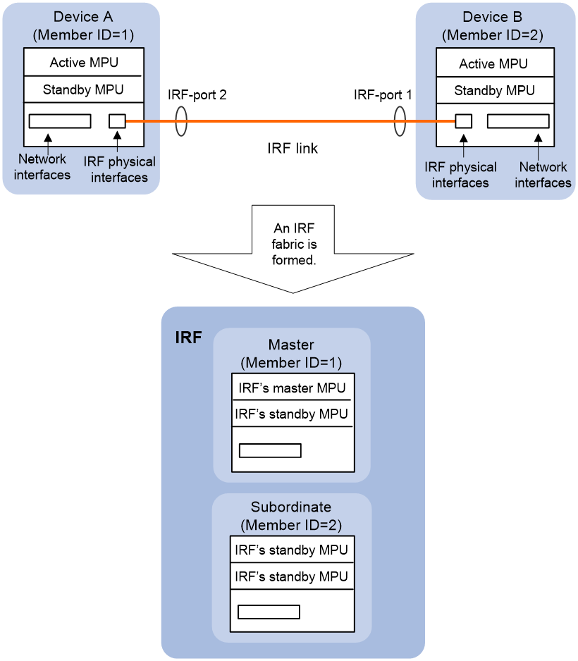

As shown in Figure 2, Device A and Device B form a two-chassis IRF fabric. The fabric has four MPUs (one active and three standbys), and two times the number of interface cards that a single device provides. The IRF fabric manages the physical and software resources of Device A and Device B in a centralized manner.
Figure 2 Two-chassis IRF fabric implementation schematic diagram

Operating mode
The device operates in one of the following modes:
·     Standalone mode—The device cannot form an IRF fabric with other devices.
·     IRF mode—The device can form an IRF fabric with other devices.
IRF member roles
IRF uses two member roles: master and standby (called subordinate throughout the documentation).
When devices form an IRF fabric, they elect a master to manage and control the IRF fabric, and all the other devices back up the master. When the master device fails, the other devices automatically elect a new master. For more information about master election, see "Master election."
IRF member ID
An IRF fabric uses member IDs to uniquely identify and manage its members. This member ID information is included as the first part of interface numbers and file paths to uniquely identify interfaces and files in an IRF fabric. Two devices cannot form an IRF fabric if they use the same member ID. A device cannot join an IRF fabric if its member ID has been used in the fabric.
MPU roles
Each IRF member device has one or two MPUs. The following are MPU roles:

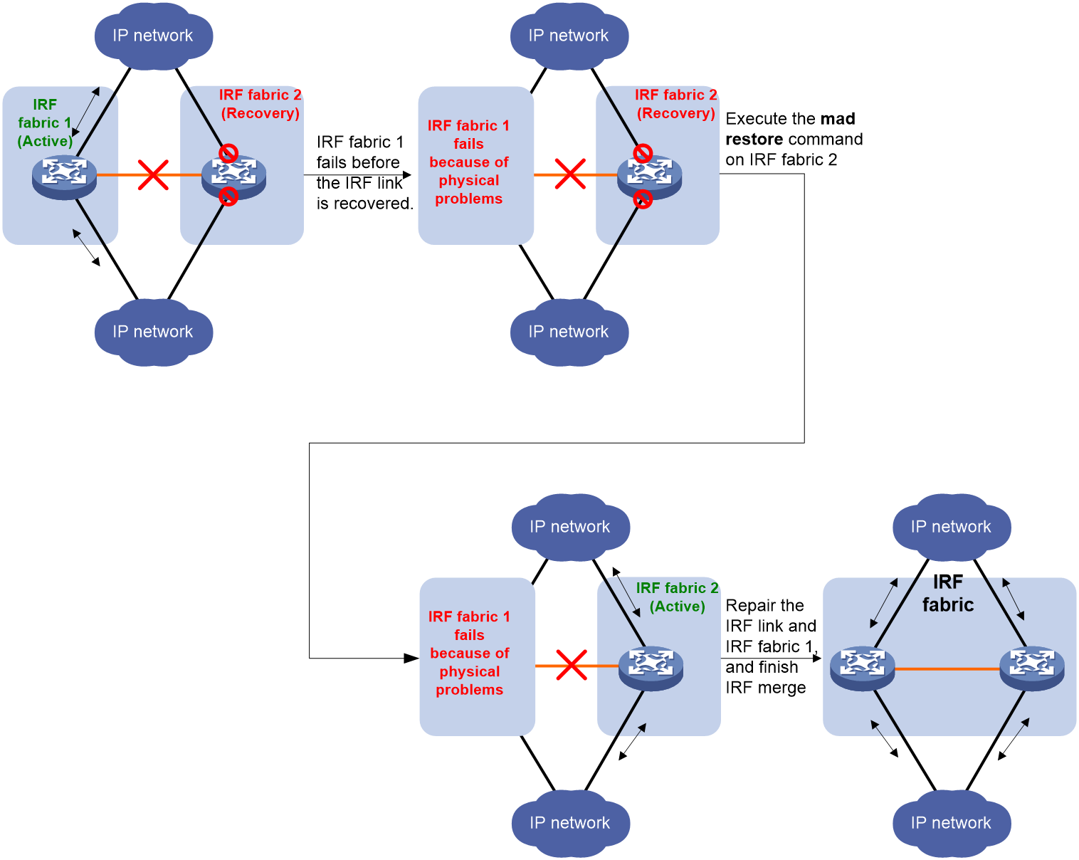

IRF split occurs when an IRF fabric breaks up into multiple IRF fabrics because of IRF link failures, as shown in Figure 3. The split IRF fabrics operate with the same IP address. IRF split causes routing and forwarding problems on the network. To quickly detect a multi-active collision, configure a minimum of one MAD mechanism (see "Configuring MAD").
Figure 3 IRF split
IRF merge
IRF merge occurs when two split IRF fabrics reunite or when two independent IRF fabrics are united, as shown in Figure 4.
Figure 4 IRF merge
MAD
An IRF link failure causes an IRF fabric to split in two IRF fabrics operating with the same Layer 3 settings, including the same IP address. To avoid IP address collision and network problems, IRF uses multi-active detection (MAD) mechanisms to detect the presence of multiple identical IRF fabrics, handle collisions, and recover from faults.

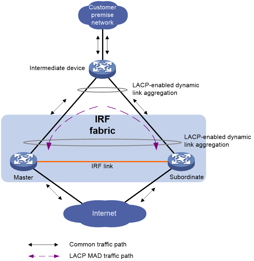

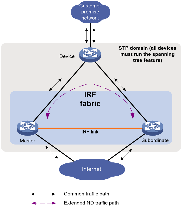

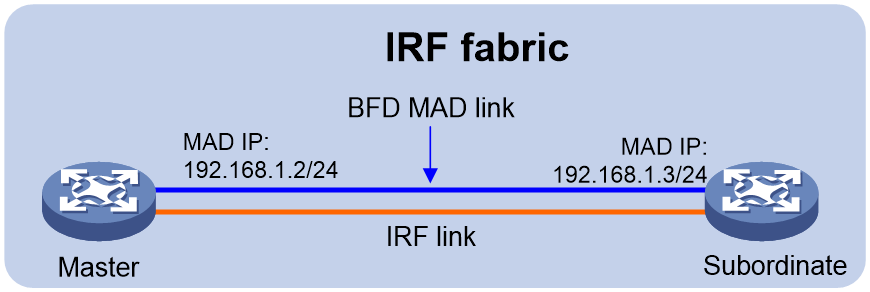

IRF provides MAD mechanisms by extending LACP, BFD, ARP, and IPv6 ND to detect multi-active collisions. As a best practice, configure a minimum of one MAD mechanism on an IRF fabric. For more information about the MAD mechanisms and their application scenarios, see "MAD mechanisms."
For information about LACP, see Ethernet link aggregation in Layer 2—LAN Switching Configuration Guide. For information about BFD, see Network Management and Monitoring Configuration Guide. For information about ARP, see Layer 3—IP Services Configuration Guide. For information about ND, see IPv6 basics in Layer 3—IP Services Configuration Guide.

When MAD detects a multi-active collision, it sets all IRF fabrics except one to the Recovery state. The fabric that is not placed in Recovery state can continue to forward traffic. The Recovery-state IRF fabrics are inactive and cannot forward traffic.
LACP MAD and BFD MAD use the following process to handle a multi-active collision:
1.     Compare the number of members in each fabric.
2.     Set all fabrics to the Recovery state except the one that has the most members.
3.     Compare the member IDs of the masters if all IRF fabrics have the same number of members.
4.     Set all fabrics to the Recovery state except the one that has the lowest numbered master.
5.     Shut down all common network interfaces in the Recovery-state fabrics except for the following interfaces:
¡     Interfaces automatically excluded from being shut down by the system.
¡     Interfaces specified by using the mad exclude interface command.

Failure recovery
To merge two split IRF fabrics, first repair the failed IRF link and remove the IRF link failure.
After the failed IRF link between two split IRF fabrics is recovered, log in to the inactive IRF fabric to reboot its member devices if the system requires you to do so. After these member devices join the active IRF fabric as subordinate devices, the IRF merge is complete, as shown in Figure 7. The network interfaces that have been shut down by MAD automatically restore their original state.
CAUTION
CAUTION:
If you inadvertently reboot the active IRF fabric after the failed IRF link recovers, its member devices will join the inactive IRF fabric with their network interfaces being shut down by MAD. To restore the original states of the network interfaces in the merged IRF fabric, use the mad restore command.
If the IRF auto-merge feature is enabled, the inactive IRF member devices will automatically reboot after the failed IRF link recovers and a manual reboot is typically not required.
Figure 7 Recovering the IRF fabric
If the active IRF fabric fails before the IRF link is recovered (see Figure 8), use the mad restore command on the inactive IRF fabric to recover the inactive IRF fabric. This command brings up all network interfaces that were shut down by MAD. After the IRF link is repaired, merge the two parts into a unified IRF fabric.
Figure 8 Active IRF fabric fails before the IRF link is recovered

LACP MAD
As shown in Figure 9, LACP MAD has the following requirements:
·     Every IRF member must have a link with an intermediate device.
·     All the links form a dynamic link aggregation group.
·     The intermediate device must be a device that supports extended LACP for MAD.
The IRF member devices send extended LACPDUs that convey a domain ID and an active ID (the member ID of the master). The intermediate device transparently forwards the extended LACPDUs received from one member device to all the other member devices.
·     If the domain IDs and active IDs sent by all the member devices are the same, the IRF fabric is integrated.
·     If the extended LACPDUs convey the same domain ID but different active IDs, a split has occurred. LACP MAD handles this situation as described in "Collision handling."
Figure 9 LACP MAD scenario
BFD MAD
BFD MAD detects multi-active collisions by using BFD.
You can use common or management Ethernet ports for BFD MAD.
If management Ethernet ports are used, BFD MAD has the following requirements:
·     An intermediate device is required and each IRF member device must have a BFD MAD link to the intermediate device.
·     Each member device is assigned a MAD IP address on the master's management Ethernet port.
If common Ethernet ports are used, BFD MAD has the following requirements:
·     If an intermediate device is used, each member device must have a BFD MAD link to the intermediate device. If no intermediate device is used, all member devices must have a BFD MAD link to each other. As a best practice, use an intermediate device to connect IRF member devices if the IRF fabric has more than two member devices. A full mesh of IRF members might cause broadcast loops.
The BFD MAD links and the Layer 3 aggregate interface for BFD MAD must be dedicated. Do not use them for any other purposes.
When you use a Layer 3 aggregate interface for BFD MAD, make sure its member ports do not exceed the maximum number of Selected ports allowed for an aggregation group. If the number of member ports exceeds the maximum number of Selected ports, some member ports cannot become Selected. BFD MAD will be unable to work correctly and its state will change to Faulty. For more information about setting the maximum number of Selected ports for an aggregation group, see Ethernet link aggregation in Layer 2—LAN Switching Configuration Guide.
·     The MAD addresses identify the member devices and must belong to the same subnet.
·     Of all management Ethernet ports on an IRF fabric, only the master's management Ethernet port is accessible.
Figure 10 shows a typical BFD MAD scenario that uses an intermediate device. On the intermediate device, assign the ports on the BFD MAD links to the same VLAN.
Figure 11 shows a typical BFD MAD scenario that does not use an intermediate device.
With BFD MAD, the master attempts to establish BFD sessions with other member devices by using its MAD IP address as the source IP address.
·     If the IRF fabric is integrated, only the MAD IP address of the master takes effect. The master cannot establish a BFD session with any other member. If you execute the display bfd session command, the state of the BFD sessions is Down.
·     When the IRF fabric splits, the IP addresses of the masters in the split IRF fabrics take effect. The masters can establish a BFD session. If you execute the display bfd session command, the state of the BFD session between the two devices is Up.
Figure 10 BFD MAD scenario with an intermediate device
Figure 11 BFD MAD scenario without an intermediate device
ARP MAD
ARP MAD detects multi-active collisions by using extended ARP packets that convey the IRF domain ID and the active ID.
ARP MAD can work with or without an intermediate device. Make sure the following requirements are met:
·     If an intermediate device is used, connect each IRF member device to the intermediate device, as shown in Figure 12. Run the spanning tree feature between the IRF fabric and the intermediate device. In this situation, data links can be used.
·     If no intermediate device is used, connect each IRF member device to all other member devices. In this situation, IRF links cannot be used for ARP MAD.
Each IRF member compares the domain ID and the active ID (the member ID of the master) in incoming extended ARP packets with its domain ID and active ID.
·     If the domain IDs are different, the extended ARP packet is from a different IRF fabric. The device does not continue to process the packet with the MAD mechanism.
·     If the domain IDs are the same, the device compares the active IDs.
¡     If the active IDs are different, the IRF fabric has split.
¡     If the active IDs are the same, the IRF fabric is integrated.
Figure 12 ARP MAD scenario

When you connect two neighboring IRF members, follow these restrictions and guidelines:
·     You must connect the physical interfaces of IRF-port 1 on one member to the physical interfaces of IRF-port 2 on the other.
·     For high availability, bind multiple physical interfaces to an IRF port.
·     No relay devices are allowed between neighboring members.
Figure 14 Connecting IRF physical interfaces

Configuring LACP MAD
2.     Assign a domain ID to the IRF fabric.
irf domain domain-id
The default IRF domain ID is 0.
CAUTION
CAUTION:
Changing the IRF domain ID of an IRF member device will remove that member device from the IRF fabric. This member device will be unable to exchange IRF protocol packets with the remaining member devices in the IRF fabric.
3.     Create an aggregate interface and enter aggregate interface view.
¡     Enter Layer 2 aggregate interface view.
¡     Enter Layer 3 aggregate interface view.
interface route-aggregation interface-number
Perform this step also on the intermediate device.
4.     Configure the aggregation group to operate in dynamic aggregation mode.
link-aggregation mode dynamic
By default, an aggregation group operates in static aggregation mode.
LACP MAD takes effect only on dynamic aggregate interfaces.
5.     Enable LACP MAD.
mad enable
By default, LACP MAD is disabled.
6.     Return to system view.
7.     Enter Ethernet interface view or interface range view.
¡     Enter Ethernet interface view.
¡     Enter interface range view. Choose one of the following commands:
interface range { interface-type interface-number [ to interface-type interface-number ] } &<1-24>
interface range name name [ interface { interface-type interface-number [ to interface-type interface-number ] } &<1-24> ]
To assign a range of ports to the aggregation group, enter interface range view.
To assign one port to the aggregation group, enter Ethernet interface view.
8.     Assign the Ethernet port or the range of Ethernet ports to the specified aggregation group.
port link-aggregation group group-id
Multichassis link aggregation is allowed.
Configuring BFD MAD
Restrictions and guidelines for configuring BFD MAD
As a best practice, use the following procedure to set up BFD MAD:
1.     Choose a BFD MAD link scheme as described in "BFD MAD."
2.     Configure BFD MAD.
3.     Connect the BFD MAD links.
When you configure BFD MAD on a Layer 3 aggregate interface, follow these restrictions and guidelines:
Category
BFD MAD-enabled Layer 3 aggregate interface
·     Make sure the Layer 3 aggregate interface operates in static aggregation mode.
·     Make sure the member ports in the aggregation group do not exceed the maximum number of Selected ports allowed for an aggregation group. If the number of member ports exceeds the maximum number of Selected ports, some member ports cannot become Selected. BFD MAD will be unable to work correctly and its state will change to Faulty.
BFD MAD VLAN
·     On the intermediate device (if any), assign the ports on the BFD MAD links to the same VLAN. Do not assign the ports to an aggregate interface. If the ports are hybrid ports, make sure these ports are untagged members of their PVIDs.
·     If the intermediate device acts as a BFD MAD intermediate device for multiple IRF fabrics, assign different BFD MAD VLANs to the IRF fabrics.
·     Do not use the BFD MAD VLAN on the intermediate device for any purposes other than BFD MAD.
·     Make sure the BFD MAD VLAN on the intermediate device contains only ports on the BFD MAD links. Exclude a port from the BFD MAD VLAN if that port is not on a BFD MAD link. If you have assigned that port to all VLANs by using the port trunk permit vlan all command, use the undo port trunk permit command to exclude that port from the BFD MAD VLAN.
BFD MAD-enabled Layer 3 aggregate interface and feature compatibility
Use only the mad bfd enable and mad ip address commands on the BFD MAD-enabled interface. If you configure other features, both BFD MAD and other features on the interface might run incorrectly.
MAD IP address
·     To avoid network issues, only use the mad ip address command to configure IP addresses on the BFD MAD-enabled interface. Do not configure an IP address by using the ip address command or configure a VRRP virtual address on the BFD MAD-enabled interface.
·     Make sure all the MAD IP addresses are on the same subnet.
When you configure BFD MAD on a management Ethernet port, follow these restrictions and guidelines:
Category
Management Ethernet ports for BFD MAD
Connect a management Ethernet port on each IRF member device to the common Ethernet ports on the intermediate device. To avoid BFD MAD failure caused by an active/standby MPU switchover, connect the management Ethernet ports on each MPU to the intermediate device.
BFD MAD VLAN
·     On the intermediate device, create a VLAN for BFD MAD, and assign the ports used for BFD MAD to the VLAN. On the IRF fabric, you do not need to assign the management Ethernet ports to the VLAN.
·     Make sure the IRF fabrics on the network use different BFD MAD VLANs.
MAD IP address
·     Use the mad ip address command instead of the ip address command to configure MAD IP addresses on the BFD MAD-enabled management Ethernet ports.
Configuring BFD MAD on a Layer 3 aggregate interface
2.     (Optional.) Assign a domain ID to the IRF fabric.
By default, the domain ID of an IRF fabric is 0.
CAUTION
CAUTION:
3.     Create a Layer 3 aggregate interface for BFD MAD.
4.     Return to system view.
5.     Enter interface view or interface range view.
To assign a range of ports to the aggregation group for the aggregate interface, enter interface range view.
To assign one port to the aggregation group for the aggregate interface, enter Ethernet interface view.
6.     Assign the port or the range of ports to the aggregation group for the aggregate interface.
port link-aggregation group number
7.     Return to system view.
8.     Enter Layer 3 aggregate interface view.
9.     Enable BFD MAD.
mad bfd enable
By default, BFD MAD is disabled.
10.     Assign a MAD IP address to a member device on the Layer 3 aggregate interface.
mad ip address ip-address { mask | mask-length } member member-id
By default, no MAD IP addresses are configured on aggregate interfaces.
Repeat this step to assign a MAD IP address to each member device on the aggregate interface.
Configuring BFD MAD on a management Ethernet port
CAUTION
CAUTION:
3.     Enter management Ethernet interface view.
interface m-gigabitethernet interface-number
4.     Enable BFD MAD.
mad bfd enable
5.     Assign a MAD IP address to each member device.
By default, no MAD IP addresses are configured.
Configuring ARP MAD
As a best practice, use the following procedure to set up ARP MAD:
1.     Choose an ARP MAD link scheme as described in "ARP MAD."
2.     Configure ARP MAD.
3.     Connect the ARP MAD links if you are not using existing data links as ARP MAD links.
When you configure ARP MAD, follow these restrictions and guidelines:
Category
ARP MAD VLAN
·     Do not enable ARP MAD on VLAN-interface 1.
·     If you are using an intermediate device, perform the following tasks:
¡     On the IRF fabric and the intermediate device, create a VLAN for ARP MAD.
¡     On the IRF fabric and the intermediate device, assign the ports of ARP MAD links to the ARP MAD VLAN.
¡     On the IRF fabric, create a VLAN interface for the ARP MAD VLAN.
·     Do not use the ARP MAD VLAN for any other purposes.
ARP MAD and feature configuration
If an intermediate device is used, make sure the following requirements are met:
·     Run the spanning tree feature between the IRF fabric and the intermediate device to ensure that there is only one ARP MAD link in forwarding state. For more information about the spanning tree feature and its configuration, see Layer 2—LAN Switching Configuration Guide.
·     Enable the IRF fabric to change its bridge MAC address as soon as the address owner leaves.
·     If the intermediate device is also an IRF fabric, assign the two IRF fabrics different domain IDs for correct split detection.
CAUTION
CAUTION:
3.     Configure the IRF bridge MAC address to change as soon as the address owner leaves.
undo irf mac-address persistent
By default, the IRF bridge MAC address does not change after the address owner leaves.
4.     Create a VLAN dedicated to ARP MAD.
vlan vlan-id
By default, only VLAN 1 exists.
5.     Return to system view.
6.     Enter Ethernet interface view or interface range view.
To assign a range of ports to the ARP MAD VLAN, enter interface range view.
To assign one port to the ARP MAD VLAN, enter Ethernet interface view.
7.     Assign the port or the range of ports to the ARP MAD VLAN.
¡     Assign the ports to the VLAN as access ports.
port access vlan vlan-id
¡     Assign the ports to the VLAN as trunk ports.
port trunk permit vlan vlan-id
¡     Assign the ports to the VLAN as hybrid ports.
port hybrid vlan vlan-id { tagged | untagged }
The link type of ARP MAD ports can be access, trunk, or hybrid.
The default link type of a port is access.
8.     Return to system view.
9.     Enter VLAN interface view.
interface vlan-interface vlan-interface-id
10.     Assign the interface an IP address.
By default, no IP addresses are assigned to any VLAN interfaces.
11.     Enable ARP MAD.
mad arp enable
By default, ARP MAD is disabled.

Recovering an IRF fabric
For split IRF fabrics, if the active IRF fabric fails before the IRF link is recovered, perform this task on the inactive IRF fabric to recover the inactive IRF fabric. The manual recovery operation brings up all interfaces that were shut down by MAD on the inactive IRF fabric.
2.     Recover the inactive IRF fabric.
mad restore

Example: Configuring an LACP MAD-enabled IRF fabric
As shown in Figure 15, set up a two-member IRF fabric at the access layer of the network.
Configure LACP MAD on the multimember aggregation to Device C, which supports extended LACP.
Figure 15 Network diagram
1.     Configure settings for IRF setup on Device A:
# Enable IRF mode. The device automatically reboots for the mode change to take effect. Save the running configuration to the next-startup configuration file at the prompt. If IRF mode has been enabled, the device only displays that the device is already in IRF mode when you execute the chassis convert mode irf command.
<DeviceA> system-view
[DeviceA] chassis convert mode irf
You are recommended to save the current running configuration and specify the configuration file for the next startup. Continue? [Y/N]:y
Do you want to convert the content of the next startup configuration file flash:/startup.cfg to make it available in IRF mode? [Y/N]:y
Now rebooting, please wait...
# Change the member priority of the device to 32.
[DeviceA] irf member 1 priority 32
# Bind Ten-GigabitEthernet 1/5/0/1 to IRF port 1/2, and save the configuration.
[DeviceA] interface ten-gigabitethernet 1/5/0/1
[DeviceA-Ten-GigabitEthernet1/5/0/1] shutdown
[DeviceA-Ten-GigabitEthernet1/5/0/1] quit
[DeviceA] irf-port 1/2
[DeviceA-irf-port1/2] port group interface ten-gigabitethernet 1/5/0/1
[DeviceA-irf-port1/2] quit
[DeviceA-Ten-GigabitEthernet1/5/0/1] undo shutdown
[DeviceA] save
# Activate the IRF port configuration.
[DeviceA] irf-port-configuration active
2.     Configure settings for IRF setup on Device B:
<DeviceB> system-view
[DeviceB] chassis convert mode irf
# Change the member ID of Device B to 2, and reboot the device to have the change take effect.
[DeviceB] irf member 1 renumber 2
Warning: Renumbering the device number may result in configuration change or loss. Continue? [Y/N]:y
[DeviceB] quit
<DeviceB> reboot
# Connect Device B to Device A, as shown in Figure 15.
# Log in to Device B. (Details not shown.)
# Bind Ten-GigabitEthernet 2/5/0/1 to IRF port 2/1, and save the configuration.
[DeviceB] interface ten-gigabitethernet 2/5/0/1
[DeviceB-Ten-GigabitEthernet2/5/0/1] shutdown
[DeviceB-Ten-GigabitEthernet2/5/0/1] quit
[DeviceB] irf-port 2/1
[DeviceB-irf-port2/1] port group interface ten-gigabitethernet 2/5/0/1
[DeviceB-irf-port2/1] quit
[DeviceB-Ten-GigabitEthernet2/5/0/1] undo shutdown
[DeviceB] save
[DeviceB] irf-port-configuration active
The two devices perform master election, and the one that has lost the election reboots to form an IRF fabric with the master. In this example, Device B reboots.
3.     Re-log in to the IRF fabric. (Details not shown.)
4.     Configure LACP MAD on the IRF fabric:
# Set the domain ID of the IRF fabric to 1.
[DeviceA] irf domain 1
# Create a dynamic aggregate interface, assign it an IP address, and enable LACP MAD.
[DeviceA] interface route-aggregation 2
[DeviceA-Route-Aggregation2] ip address 192.168.1.1 24
[DeviceA-Route-Aggregation2] link-aggregation mode dynamic
[DeviceA-Route-Aggregation2] mad enable
You need to assign a domain ID (range: 0-4294967295)
[Current domain is: 1]:
The assigned domain ID is: 1
MAD LACP only enable on dynamic aggregation interface.
[DeviceA-Route-Aggregation2] quit
# Assign Ten-GigabitEthernet 1/4/0/1 and Ten-GigabitEthernet 2/4/0/1 to the aggregate interface.
[DeviceA] interface ten-gigabitethernet 1/4/0/1
[DeviceA-Ten-GigabitEthernet1/4/0/1] port link-aggregation group 2
[DeviceA-Ten-GigabitEthernet1/4/0/1] quit
[DeviceA] interface ten-gigabitethernet 2/4/0/1
[DeviceA-Ten-GigabitEthernet2/4/0/1] port link-aggregation group 2
[DeviceA-Ten-GigabitEthernet2/4/0/1] quit
5.     Configure security zones and security policies to secure packets exchanged between the Intranet and IP network, as shown in Figure 15. (Details not shown.)
6.     Configure Device C as the intermediate device for LACP MAD:
CAUTION
CAUTION:
If the intermediate device is also an IRF fabric, assign the two IRF fabrics different domain IDs for correct split detection. False detection causes IRF split.
# Create a dynamic aggregate interface and assign an IP address to it.
<DeviceC> system-view
[DeviceC] interface route-aggregation 2
[DeviceC-Route-Aggregation2] link-aggregation mode dynamic
[DeviceC-Route-Aggregation2] ip address 192.168.1.2 24
[DeviceC-Route-Aggregation2] quit
# Assign Ten-GigabitEthernet 1/5/0/1 and Ten-GigabitEthernet 1/4/0/1 to the aggregate interface.
[DeviceC] interface ten-gigabitethernet 1/5/0/1
[DeviceC-Ten-GigabitEthernet1/5/0/1] port link-aggregation group 2
[DeviceC-Ten-GigabitEthernet1/5/0/1] quit
[DeviceC] interface ten-gigabitethernet 1/4/0/1
[DeviceC-Ten-GigabitEthernet1/4/0/1] port link-aggregation group 2
[DeviceC-Ten-GigabitEthernet1/4/0/1] quit
# Display IRF fabric information to verify that the IRF fabric has been set up and Device A is the master.
[DeviceA] display irf
MemberID    Role    Priority  CPU-Mac         Description
 *+1        Master  32        487a-da95-93b5  ---
   2        Standby 1         3897-d6a8-1b1a  ---
 * indicates the device is the master.
 + indicates the device through which the user logs in.
 The bridge MAC of the IRF is: 487a-da95-93b3
 Auto upgrade                : yes
 Mac persistent              : no
 Domain ID                   : 1
 Auto merge                  : yes
# Display detailed MAD information to verify that LACP MAD is operating correctly.
[DeviceA] display mad verbose
Multi-active recovery state: No
Excluded ports (user-configured):
Excluded ports (system-configured):
MAD ARP disabled.
MAD ND disabled.
MAD LACP enabled interface: Route-Aggregation2
  MAD status              : Normal
  Member ID   Port                                    MAD status
  1           Ten-GigabitEthernet1/4/0/1                Normal
  2           Ten-GigabitEthernet2/4/0/1                Normal
MAD BFD disabled.
# Split the IRF fabric and verify that LACP MAD state changes to Faulty.
MAD ARP disabled.
MAD ND disabled.
  MAD status              : Faulty
  1           Ten-GigabitEthernet1/4/0/1                Faulty
MAD BFD disabled.
# Verify that all network interfaces on Device B except for the IRF physical interface are shut down. (Details not shown.)
Example: Configuring a BFD MAD-enabled IRF fabric
As shown in Figure 16, set up an IRF fabric at the distribution layer of the enterprise network. Configure BFD MAD in the IRF fabric and set up BFD MAD links between the member devices.
Figure 16 Network diagram
[DeviceA] save
[DeviceB] quit
<DeviceB> reboot
# Connect Device B to Device A, as shown in Figure 16.
# Bind Ten-GigabitEthernet 2/5/0/1 to IRF port 2/1 and save the configuration.
[DeviceB] save
3.     Configure BFD MAD on the IRF fabric:
# Create Layer 3 aggregate interface 3.
[DeviceA] interface route-aggregation 3
[DeviceA-Route-Aggregation3] quit
# Assign Ten-GigabitEthernet 1/4/0/1 on Device A and Ten-GigabitEthernet 2/4/0/1 on Device B to aggregation group 3.
[DeviceA-Ten-GigabitEthernet1/4/0/1] port link-aggregation group 3
[DeviceA-Ten-GigabitEthernet2/4/0/1] port link-aggregation group 3
# Enable BFD MAD on Layer 3 aggregate interface 3 and assign a MAD IP address to each member device on the aggregate interface.
[DeviceA-Route-Aggregation3] mad bfd enable
[DeviceA-Route-Aggregation3] mad ip address 192.168.2.1 24 member 1
[DeviceA-Route-Aggregation3] mad ip address 192.168.2.2 24 member 2
4.     Configure security zones and security policies to secure packets exchanged between the Intranet and IP network, as shown in Figure 16. (Details not shown.)
 Auto upgrade                : yes
 Mac persistent              : no
 Domain ID                   : 0
 Auto merge                  : yes
# Display detailed MAD information to verify that BFD MAD is operating correctly.
MAD ARP disabled.
MAD ND disabled.
MAD LACP disabled.
MAD BFD enabled interface: Route-Aggregation3
  MAD status                 : Normal
  Member ID   MAD IP address       Neighbor   MAD status
  1           192.168.2.1/24       2          Normal
  2           192.168.2.2/24       1          Normal
# Split the IRF fabric and verify that BFD MAD state changes to Faulty.
MAD ARP disabled.
MAD ND disabled.
MAD LACP disabled.
  MAD status                 : Faulty
  1           192.168.2.1/24       2          Faulty

·     Configure ARP MAD in the IRF fabric and use the links connected to Device C to transmit ARP MAD packets.
·     To prevent loops, run the spanning tree feature between Device C and the IRF fabric.
Figure 17 Network diagram
