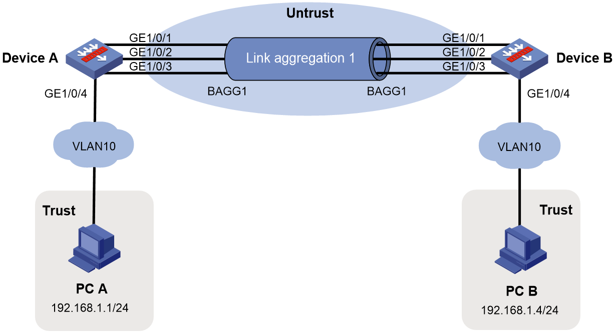

As shown in Figure 5, configure a Layer 2 static aggregation group on both Device A and Device B to aggregate the links between them.
Figure 5 Network diagram
1.     Configure interfaces GigabitEthernet 1/0/1 through GigabitEthernet 1/0/4 to operate in Layer 2 mode.
<DeviceA> system-view
[DeviceA] interface range gigabitethernet 1/0/1 to gigabitethernet 1/0/4
[DeviceA-if-range] port link-mode bridge
[DeviceA-if-range] quit
2.     Create VLAN 10, and assign interface GigabitEthernet 1/0/4 to VLAN 10.
[DeviceA] vlan 10
[DeviceA-vlan10] port gigabitethernet 1/0/4
[DeviceA-vlan10] quit
3.     Configure a Layer 2 static aggregation group:
# Configure Layer 2 aggregate interface Bridge-Aggregation 1 as a trunk port and assign it to VLANs 1 and 10.
[DeviceA] interface bridge-aggregation 1
[DeviceA-Bridge-Aggregation1] port link-type trunk
[DeviceA-Bridge-Aggregation1] port trunk permit vlan 1 10
[DeviceA-Bridge-Aggregation1] quit
# Assign interfaces GigabitEthernet 1/0/1 through GigabitEthernet 1/0/3 to link aggregation group 1.
[DeviceA] interface range gigabitethernet 1/0/1 to gigabitethernet 1/0/3
[DeviceA-if-range] port link-aggregation group 1
4.     Configure interfaces GigabitEthernet 1/0/1 through GigabitEthernet 1/0/3 as trunk ports and assign them to VLANs 1 and 10.
[DeviceA-if-range] port link-type trunk
[DeviceA-if-range] port trunk permit vlan 1 10
5.     Add interfaces to security zones.
[DeviceA] security-zone name trust
[Device-security-zone-Trust] import interface gigabitethernet 1/0/4 vlan 10
[Device-security-zone-Trust] quit
[DeviceA] security-zone name untrust
[Device-security-zone-Untrust] import interface bridge-aggregation 1 vlan 1 10
[Device-security-zone-Untrust] quit
6.     Configure a security policy:
Configure rules to permit traffic between the Trust and Untrust security zones, so the devices can communicate with each other:
# Configure a rule named trust-untrust to permit the packets sent from the Trust security zone to the Untrust security zone.
[DeviceA] security-policy ip
[DeviceA-security-policy-ip] rule name trust-untrust
[DeviceA-security-policy-ip-0-trust-untrust] action pass
[DeviceA-security-policy-ip-0-trust-untrust] source-zone trust
[DeviceA-security-policy-ip-0-trust-untrust] destination-zone untrust
[DeviceA-security-policy-ip-0-trust-untrust] quit
[DeviceA-security-policy-ip] quit
# Configure a rule named untrust-trust to permit the packets sent from the Untrust security zone to the Trust security zone.
[DeviceA-security-policy-ip] rule name untrust-trust
[DeviceA-security-policy-ip-1-untrust-trust] action pass
[DeviceA-security-policy-ip-1-untrust-trust] source-zone untrust
[DeviceA-security-policy-ip-1-untrust-trust] destination-zone trust
[DeviceA-security-policy-ip-1-untrust-trust] quit
7.     Configure Device B in the same way Device A is configured. (Details not shown.)

Example: Configuring a Layer 2 dynamic aggregation group
As shown in Figure 6, configure a Layer 2 dynamic aggregation group on both Device A and Device B to aggregate the links between them.
Figure 6 Network diagram
[DeviceA] vlan 10
3.     Configure a Layer 2 dynamic aggregation group:
# Configure Layer 2 aggregate interface Bridge-Aggregation 1 as a trunk port, assign it to VLANs 1 and 10, and set the link aggregation mode to dynamic.
[DeviceA-Bridge-Aggregation1] link-aggregation mode dynamic
# Display detailed information about all aggregation groups on Device A.
Loadsharing Type: Shar -- Loadsharing, NonS -- Non-Loadsharing
Port Status: S -- Selected, U -- Unselected, I -- Individual
Port: A -- Auto port
Flags:  A -- LACP_Activity, B -- LACP_Timeout, C -- Aggregation,
        G -- Defaulted, H -- Expired
Aggregate Interface: Bridge-Aggregation1
Creation Mode: Manual
Aggregation Mode: Dynamic
System ID: 0x8000, 000f-e267-6c6a
Local:
  Port             Status  Priority Oper-Key  Flag
  GE1/0/1          S       32768    1         {ACDEF}
  GE1/0/2          S       32768    1         {ACDEF}
  GE1/0/3          S       32768    1         {ACDEF}
Remote:
  Actor            Partner Priority Oper-Key  SystemID               Flag
  GE1/0/1          1       32768    1         0x8000, 000f-e267-57ad {ACDEF}
  GE1/0/2          2       32768    1         0x8000, 000f-e267-57ad {ACDEF}
  GE1/0/3          3       32768    1         0x8000, 000f-e267-57ad {ACDEF}
The output shows that link aggregation group 1 is a Layer 2 dynamic aggregation group that contains three Selected ports.

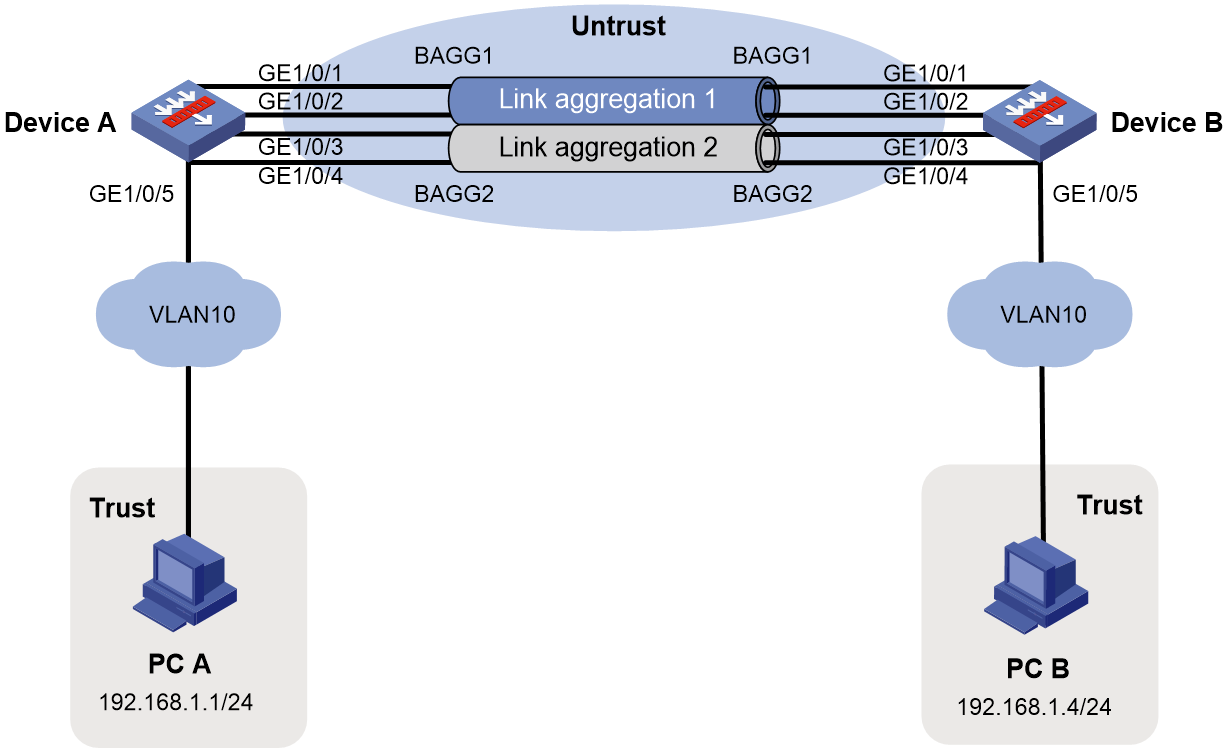

Example: Configuring Layer 2 aggregation load sharing
As shown in Figure 7, perform the following tasks:
·     Configure Layer 2 static aggregation groups 1 and 2 on Device A and Device B, respectively.
·     Configure link aggregation groups 1 and 2 to load share traffic across aggregation group member ports.
¡     Configure link aggregation group 1 to load share packets based on source MAC addresses.
¡     Configure link aggregation group 2 to load share packets based on destination MAC addresses.
Figure 7 Network diagram
1.     Configure interfaces GigabitEthernet 1/0/1 through GigabitEthernet 1/0/5 to operate in Layer 2 mode.
[DeviceA] interface range gigabitethernet 1/0/1 to gigabitethernet 1/0/5
2.     Create VLAN 10, and assign interface GigabitEthernet 1/0/5 to VLAN 10.
[DeviceA] vlan 10
[DeviceA-vlan10] port gigabitethernet 1/0/5
3.     Configure Layer 2 aggregation groups:
# Configure Layer 2 aggregate interface Bridge-Aggregation 1 as a trunk port and assign it to VLANs 1 and 10, and configure it to load share packets based on source MAC addresses..
[DeviceA-Bridge-Aggregation1] link-aggregation load-sharing mode source-mac
# Assign interfaces GigabitEthernet 1/0/1 and GigabitEthernet 1/0/2 to link aggregation group 1.
[DeviceA] interface range GigabitEthernet1/0/1 to GigabitEthernet1/0/2
# Configure Layer 2 aggregate interface Bridge-Aggregation 2 as a trunk port and assign it to VLANs 1 and 10, and configure it to load share packets based on destination MAC addresses..
[DeviceA] interface bridge-aggregation 2
[DeviceA-Bridge-Aggregation1] link-aggregation load-sharing mode destination-mac
# Assign interfaces GigabitEthernet 1/0/3 and GigabitEthernet 1/0/4 to link aggregation group 2.
[DeviceA] interface range gigabitethernet 1/0/3 to gigabitethernet 1/0/4
[DeviceA-if-range] port link-aggregation group 2
4.     Configure interfaces GigabitEthernet 1/0/1 through GigabitEthernet 1/0/4 as trunk ports and assign them to VLANs 1 and 10.
[Device-security-zone-Trust] import interface gigabitethernet 1/0/5 vlan 10
[Device-security-zone-Untrust] import interface bridge-aggregation 2 vlan 1 10
[DeviceA] display link-aggregation verbose
Aggregation Mode: Static
  GE1/0/1          S       32768    1
  GE1/0/2          S       32768    1
Aggregate Interface: Bridge-Aggregation2
  GE1/0/3          S       32768    2
  GE1/0/4          S       32768    2
The output shows that:
·     Link aggregation groups 1 and 2 are both load-shared Layer 2 static aggregation groups.
·     Each aggregation group contains two Selected ports.
# Display all the group-specific load sharing modes on Device A.
[DeviceA] display link-aggregation load-sharing mode interface
Bridge-Aggregation1 Load-Sharing Mode:
source-mac address
Bridge-Aggregation2 Load-Sharing Mode:
destination-mac address
·     Link aggregation group 1 distributes packets based on source MAC addresses.
·     Link aggregation group 2 distributes packets based on destination MAC addresses.

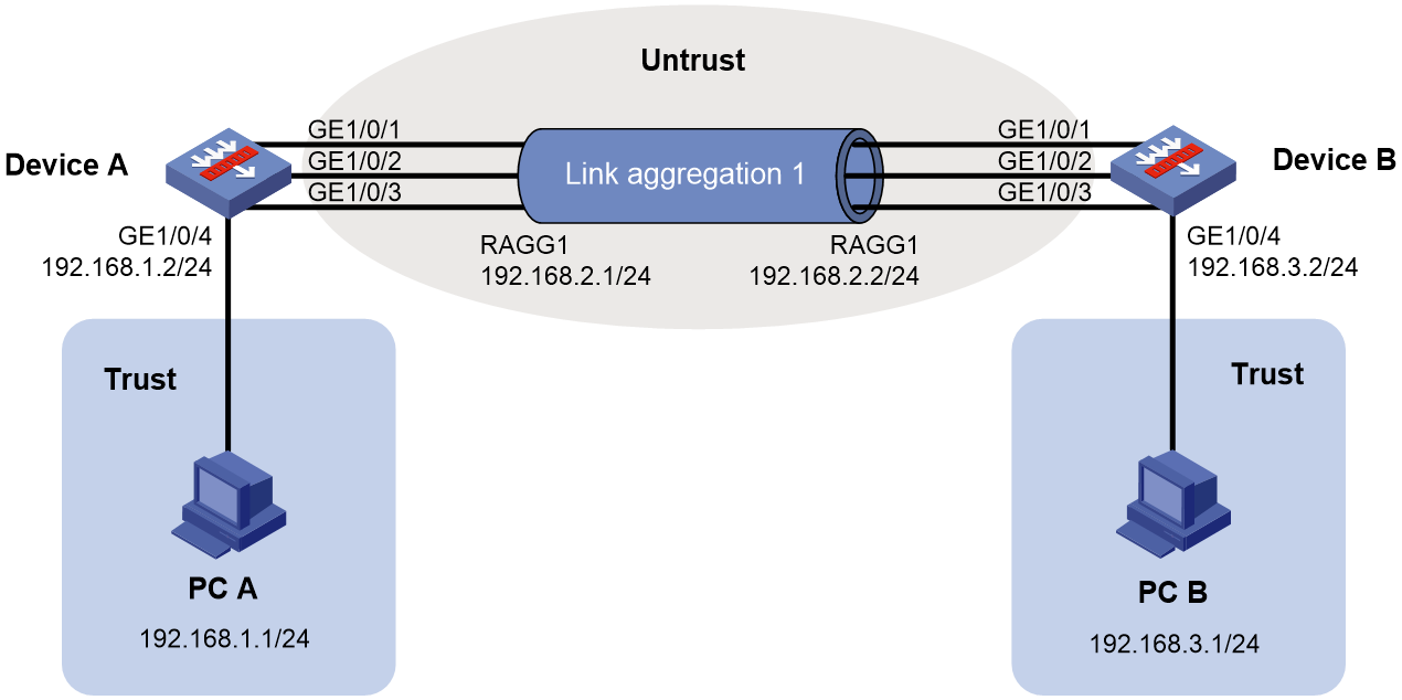

Example: Configuring a Layer 3 static aggregation group
As shown in Figure 8, configure a Layer 3 static aggregation group on both Device A and Device B to aggregate the links between them.
Figure 8 Network diagram
1.     Configure a Layer 3 static aggregation group:
# Create Layer 3 aggregate interface Route-Aggregation 1, and assign an IP address to the aggregate interface.
[DeviceA] interface route-aggregation 1
[DeviceA-Route-Aggregation1] ip address 192.168.2.1 24
[DeviceA-Route-Aggregation1] quit
# Assign Layer 3 Ethernet interfaces GigabitEthernet 1/0/1 through GigabitEthernet 1/0/3 to aggregation group 1.
2.     Assign an IP address to interface GigabitEthernet 1/0/4.
[DeviceA] interface GigabitEthernet 1/0/4
[DeviceA-GigabitEthernet1/0/4] ip address 192.168.1.2 24
[DeviceA-GigabitEthernet1/0/4] quit
3.     Configure settings for routing.
This example configure a static route for PC B, and the next hop is 192.168.2.2.
[DeviceA] ip route-static 192.168.3.1 24 192.168.2.2
4.     Add interfaces to security zones.
[Device-security-zone-Untrust] import interface route-aggregation 1
5.     Configure a security policy:
Configure rules to permit traffic between PC A and PC B:
[DeviceA-security-policy-ip-0-trust-untrust] source-ip-subnet 192.168.1.0 24
[DeviceA-security-policy-ip-0-trust-untrust] destination-ip-subnet 192.168.3.0 24
[DeviceA-security-policy-ip-1-untrust-trust] source-ip-subnet 192.168.3.0 24
[DeviceA-security-policy-ip-1-untrust-trust] destination-ip-subnet 192.168.1.0 24
6.     Configure Device B in the same way Device A is configured. (Details not shown.)
Aggregate Interface: Route-Aggregation1
  GE1/0/1          S       32768    1
  GE1/0/2          S       32768    1
  GE1/0/3          S       32768    1
The output shows that link aggregation group 1 is a Layer 3 static aggregation group that contains three Selected ports.
Example: Configuring a Layer 3 dynamic aggregation group
As shown in Figure 9, configure a Layer 3 dynamic aggregation group on both Device A and Device B to aggregate the links between them.
Figure 9 Network diagram
1.     Configure a dynamic aggregation group:
# Create Layer 3 aggregate interface Route-Aggregation 1.
# Assign an IP address to Route-Aggregation 1.
# Set the link aggregation mode to dynamic.
[DeviceA-Route-Aggregation1] link-aggregation mode dynamic
This example configure a static route for PC B, and the next hop in the routes is 192.168.2.2.
Local:
Remote:
The output shows that link aggregation group 1 is a Layer 3 dynamic aggregation group that contains three Selected ports.

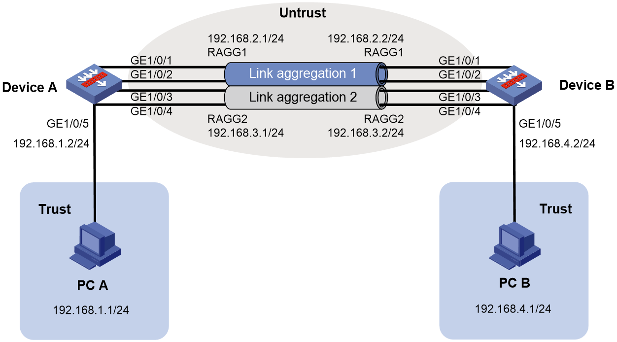

Example: Configuring Layer 3 aggregation load sharing
As shown in Figure 10, perform the following tasks:
·     Configure Layer 3 static aggregation groups 1 and 2 on Device A and Device B, respectively.
¡     Configure link aggregation group 1 to load share packets based on source IP addresses.
¡     Configure link aggregation group 2 to load share packets based on destination IP addresses.
Figure 10 Network diagram
1.     Configure Layer 3 aggregation groups:
# Configure Layer 3 aggregation group 1 to load share packets based on source IP addresses.
[DeviceA-Route-Aggregation1] link-aggregation load-sharing mode source-ip
# Assign an IP address to Layer 3 aggregate interface Route-Aggregation 1.
# Assign Layer 3 Ethernet interfaces GigabitEthernet 1/0/1 and GigabitEthernet 1/0/2 to aggregation group 1.
[DeviceA] interface range gigabitethernet 1/0/1 to gigabitethernet 1/0/2
# Create Layer 3 aggregate interface Route-Aggregation 2.
[DeviceA] interface route-aggregation 2
# Configure Layer 3 aggregation group 2 to load share packets based on destination IP addresses.
[DeviceA-Route-Aggregation2] link-aggregation load-sharing mode destination-ip
# Assign an IP address to Layer 3 aggregate interface Route-Aggregation 2.
[DeviceA-Route-Aggregation2] ip address 192.168.3.1 24
[DeviceA-Route-Aggregation2] quit
# Assign Layer 3 Ethernet interfaces GigabitEthernet 1/0/3 and GigabitEthernet 1/0/4 to aggregation group 2.
2.     Assign an IP address to interface GigabitEthernet 1/0/5.
[DeviceA] interface gigabitethernet 1/0/5
[DeviceA-GigabitEthernet1/0/5] ip address 192.168.1.2 24
[DeviceA-GigabitEthernet1/0/5] quit
This example configure static routes for PC B, and the next hops in the routes are 192.168.2.2 and 192.168.3.2.
[DeviceA] ip route-static 192.168.4.1 24 192.168.2.2
[DeviceA] ip route-static 192.168.4.1 24 192.168.3.2
[Device-security-zone-Untrust] import interface route-aggregation 2
[DeviceA-security-policy-ip-0-trust-untrust] destination-ip-subnet 192.168.4.0 24
[DeviceA-security-policy-ip-1-untrust-trust] source-ip-subnet 192.168.4.0 24
  GE1/0/1          S       32768    1
  GE1/0/2          S       32768    1
Aggregate Interface: Route-Aggregation2
  GE1/0/3          S       32768    2
  GE1/0/4          S       32768    2
·     Link aggregation groups 1 and 2 are both load-shared Layer 3 static aggregation groups.
Route-Aggregation1 Load-Sharing Mode:
source-ip address
Route-Aggregation2 Load-Sharing Mode:
destination-ip address
·     Link aggregation group 1 distributes packets based on source IP addresses.
·     Link aggregation group 2 distributes packets based on destination IP addresses.
