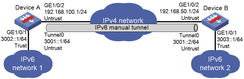

IPv6 over IPv4 manual tunneling
An IPv6 over IPv4 manual tunnel is a point-to-point link. To establish a manual tunnel, you must manually configure the source and destination addresses of the tunnel at both ends of the tunnel.
Manual tunneling provides the following solutions:
·     Connects isolated IPv6 networks over an IPv4 network.
·     Connects an IPv6 network and an IPv4/IPv6 dual-stack host over an IPv4 network.

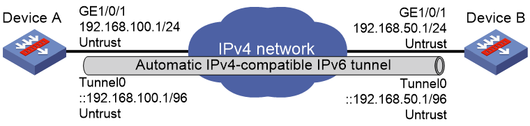

Automatic IPv4-compatible IPv6 tunneling
An automatic IPv4-compatible IPv6 tunnel is a point-to-multipoint link. The ends of an automatic IPv4-compatible IPv6 tunnel are IPv4-compatible IPv6 addresses. The address format is 0:0:0:0:0:0:a.b.c.d/96, where a.b.c.d is an IPv4 address. The destination IPv4 address of an automatic IPv4-compatible IPv6 tunnel is embedded in the destination IPv4-compatible IPv6 address. This mechanism enables the device to automatically obtain the tunnel destination address.
Automatic IPv4-compatible IPv6 tunnels have limitations because IPv4-compatible IPv6 addresses must use globally unique IPv4 addresses.

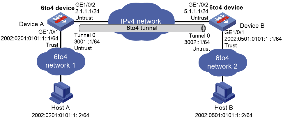

6to4 tunneling
·     Ordinary 6to4 tunneling
A 6to4 tunnel is a point-to-multipoint automatic tunnel. It is used to connect multiple isolated IPv6 networks over an IPv4 network.
The ends of a 6to4 tunnel are 6to4 addresses. The address format is 2002:abcd:efgh:subnet number::interface ID/48.
¡     2002 is the fixed IPv6 address prefix.
¡     abcd:efgh represents a 32-bit globally unique IPv4 address in hexadecimal notation.
For example, 1.1.1.1 can be represented by 0101:0101. The IPv4 address identifies a 6to4 network (an IPv6 network where all hosts use 6to4 addresses). The border router of a 6to4 network must have the IPv4 address abcd:efgh configured on the interface connected to the IPv4 network.
¡     The subnet number identifies a subnet in the 6to4 network.
¡     The subnet number::interface ID uniquely identifies a host in the 6to4 network.
The destination IPv4 address of a 6to4 tunnel is embedded in the destination 6to4 address. This mechanism enables the device to automatically obtain the tunnel destination address.
6to4 tunneling uses an IPv4 address to identify a 6to4 network. This method overcomes the limitations of automatic IPv4-compatible IPv6 tunneling.

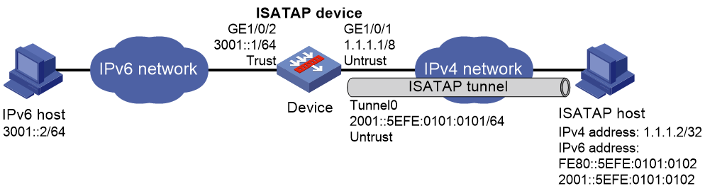

ISATAP tunneling
An ISATAP tunnel is a point-to-multipoint automatic tunnel. It provides a solution to connect an IPv6 host and an IPv6 network over an IPv4 network.
The destination address of an ISATAP tunnel is an ISATAP address. The address format is prefix:0:5EFE:abcd:efgh/64.
·     The 64-bit prefix is a valid IPv6 unicast address prefix.
·     The abcd:efgh/64 segments represent a 32-bit IPv4 address in hexadecimal notation, which identifies the tunnel destination but does not require global uniqueness.
ISATAP tunnels are mainly used for communication between IPv6 routers or between an IPv6 host and an IPv6 router over an IPv4 network.
Figure 3 Principle of ISATAP tunneling

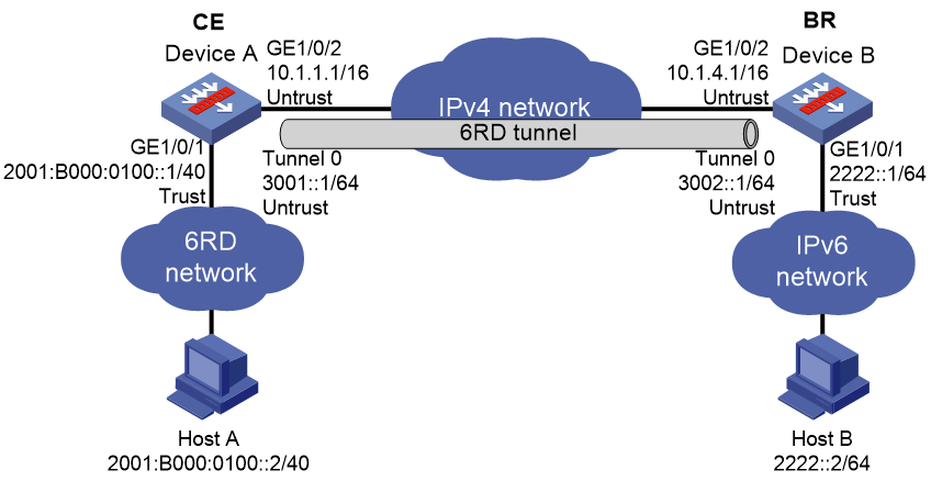

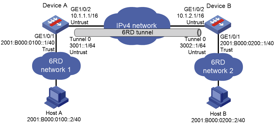

6RD tunneling
·     Ordinary 6RD tunneling
A 6RD tunnel is a point-to-multipoint automatic tunnel. It is an extension of 6to4 tunneling. The IPv6 prefix of a 6RD network is assigned by the service provider and is not limited to the prefix 2002::/16. 6RD does not require embedding all 32 bits of an IPv4 address in a 6RD address.
Figure 4 shows the format of 6RD address—an IPv6 address with a 6RD prefix and an embedded IPv4 address.
¡     6RD prefix—IPv6 prefix assigned by the service provider to a 6RD network.
¡     IPv4 address—All or part of the IPv4 tunnel source address in hexadecimal notation. For example, assume that the IPv4 tunnel source address is 1.2.3.4 and both the IPv4 prefix length and suffix length are specified as 8 bits. Then, the prefix of the IPv4 address 1.2.3.4 is 01, the suffix is 04, and the embedded IPv4 address is 0203.
¡     6RD delegated prefix—The 6RD prefix and the embedded IPv4 address together form a 6RD delegated prefix. It uniquely identifies a 6RD network (an IPv6 network where all hosts use 6RD addresses).
¡     Subnet ID—Identifies a subnet in the 6RD network.
¡     Interface ID—The subnet ID and the interface ID together identify a host in the 6RD network.
The device automatically identifies the tunnel destination IPv4 address according to the IPv4 address embedded in the 6RD address, the 6RD prefix, and the IPv4 prefix and suffix.
Figure 4 6RD address format
·     6RD relay
6 RD relay connects a 6RD network and an IPv6 network that uses a prefix other than a 6RD delegated prefix. A 6RD border relay (BR) router is a gateway that forwards packets from a 6RD network to an IPv6 network. The border router connected to the 6RD network is called 6RD CE.
As shown in Figure 5, for the 6RD network site 1 to communicate with the IPv6 network site 3 over a 6RD tunnel, you must configure 6RD relay. Configure a static route on the border router (Device A) in the 6RD network. The next hop address must be the 6RD address of the 6RD BR router (Device C). Device A forwards all packets destined for the IPv6 network over the 6RD tunnel, and Device C then forwards them to the IPv6 network.
Figure 5 Principle of 6RD tunneling and 6RD relay

Configuring an automatic IPv4-compatible IPv6 tunnel
Follow these guidelines when you configure an automatic IPv4-compatible IPv6 tunnel:
·     You do not need to configure a destination address for an automatic IPv4-compatible IPv6 tunnel. The destination address of the tunnel is embedded in the destination IPv4-compatible IPv6 address.
·     Do not specify the same tunnel source addresses for tunnels of the same tunnel mode.
2.     Enter automatic IPv4-compatible IPv6 tunnel interface view.
interface tunnel number [ mode ipv6-ipv4 auto-tunnel ]
3.     Specify an IPv6 address for the tunnel interface.
See "Configuring basic IPv6 settings."
4.     Configure a source address or source interface for the tunnel.
source { ipv4-address | interface-type interface-number }
By default, no source address or source interface is configured for a tunnel.
If you specify a source address, it is used as the source IP address of tunneled packets.
If you specify a source interface, the primary IP address of this interface is used as the source IP address of tunneled packets.
5.     (Optional.) Set the DF bit for tunneled packets.
tunnel dfbit enable
By default, the DF bit is not set for tunneled packets.
Example: Configuring an automatic IPv4-compatible IPv6 tunnel
As shown in Figure 7, dual-stack devices Device A and Device B communicate over an IPv4 network. Configure an automatic IPv4-compatible IPv6 tunnel between the two devices to enable IPv6 communications over the IPv4 network.
Figure 7 Network diagram
1.     Configure Device A:
# Assign an IP address to interface GigabitEthernet 1/0/1.
<DeviceA> system-view
[DeviceA-GigabitEthernet1/0/1] ip address 192.168.100.1 255.255.255.0
[DeviceA-GigabitEthernet1/0/1] quit
# Create an automatic IPv4-compatible IPv6 tunnel interface.
[DeviceA] interface tunnel 0 mode ipv6-ipv4 auto-tunnel
[DeviceA-Tunnel0] ipv6 address ::192.168.100.1/96
[DeviceA-Tunnel0] source gigabitethernet 1/0/1
# Configure settings for routing. This example configures a static route, and the next hop in the route is 192.168.100.2.
[DeviceA] ip route-static 192.168.50.1 24 192.168.100.2
# Add interfaces to security zone Untrust.
[DeviceA] security-zone name Untrust
[DeviceA-security-zone-Untrust] import interface Tunnel 0
[DeviceA-security-zone-Untrust] import interface gigabitethernet 1/0/1
[DeviceA-security-zone-Untrust] quit
# Configure a rule named tunnellocalout in the IPv4 security policy to allow Device A to send packets to Device B.
[DeviceA] security-policy ip
[DeviceA-security-policy-ip] rule name tunnellocalout
[DeviceA-security-policy-ip-1-tunnellocalout] source-zone local
[DeviceA-security-policy-ip-1-tunnellocalout] destination-zone untrust
[DeviceA-security-policy-ip-1-tunnellocalout] source-ip-host 192.168.100.1
[DeviceA-security-policy-ip-1-tunnellocalout] destination-ip-host 192.168.50.1
[DeviceA-security-policy-ip-1-tunnellocalout] action pass
[DeviceA-security-policy-ip-1-tunnellocalout] quit
[DeviceA-security-policy-ip] quit
# Configure a rule named tunnellocalout in the IPv6 security policy to allow Device A to send packets to Device B.
[DeviceA] security-policy ipv6
[DeviceA-security-policy-ipv6] rule name tunnellocalout
[DeviceA-security-policy-ipv6-1-tunnellocalout] source-zone local
[DeviceA-security-policy-ipv6-1-tunnellocalout] destination-zone untrust
[DeviceA-security-policy-ipv6-1-tunnellocalout] source-ip-host ::192.168.100.1
[DeviceA-security-policy-ipv6-1-tunnellocalout] destination-ip-host ::192.168.50.1
[DeviceA-security-policy-ipv6-1-tunnellocalout] action pass
[DeviceA-security-policy-ipv6-1-tunnellocalout] quit
[DeviceA-security-policy-ipv6] quit
# Configure a rule named tunnellocalin in the IPv4 security policy to allow Device A to receive the packets sent from Device B.
[DeviceA-security-policy-ip] rule name tunnellocalin
[DeviceA-security-policy-ip-2-tunnellocalin] source-zone untrust
[DeviceA-security-policy-ip-2-tunnellocalin] destination-zone local
[DeviceA-security-policy-ip-2-tunnellocalin] source-ip-host 192.168.50.1
[DeviceA-security-policy-ip-2-tunnellocalin] destination-ip-host 192.168.100.1
[DeviceA-security-policy-ip-2-tunnellocalin] action pass
[DeviceA-security-policy-ip-2-tunnellocalin] quit
# Configure a rule named tunnellocalin in the IPv6 security policy to allow Device A to receive the packets sent from Device B.
[DeviceA-security-policy-ipv6] rule name tunnellocalin
[DeviceA-security-policy-ipv6-2-tunnellocalin] source-zone untrust
[DeviceA-security-policy-ipv6-2-tunnellocalin] destination-zone local
[DeviceA-security-policy-ipv6-2-tunnellocalin] source-ip-host ::192.168.50.1
[DeviceA-security-policy-ipv6-2-tunnellocalin] destination-ip-host ::192.168.100.1
[DeviceA-security-policy-ipv6-2-tunnellocalin] action pass
[DeviceA-security-policy-ipv6-2-tunnellocalint] quit
2.     Configure Device B:
<DeviceB> system-view
[DeviceB-GigabitEthernet1/0/1] ip address 192.168.50.1 255.255.255.0
[DeviceB-GigabitEthernet1/0/1] quit
[DeviceB] interface tunnel 0 mode ipv6-ipv4 auto-tunnel
[DeviceB-Tunnel0] ipv6 address ::192.168.50.1/96
[DeviceB-Tunnel0] source gigabitethernet 1/0/1
# Configure settings for routing. This example configures a static route, and the next hop in the route is 192.168.50.2.
[DeviceB] ip route-static 192.168.100.1 24 192.168.50.2
[DeviceB] security-zone name Untrust
[DeviceB-security-zone-Untrust] import interface Tunnel 0
[DeviceB-security-zone-Untrust] import interface gigabitethernet 1/0/1
[DeviceB-security-zone-Untrust] quit
# Configure a rule named tunnellocalout in the IPv4 security policy to allow Device B to send packets to Device A.
[DeviceB] security-policy ip
[DeviceB-security-policy-ip] rule name tunnellocalout
[DeviceB-security-policy-ip-1-tunnellocalout] source-zone local
[DeviceB-security-policy-ip-1-tunnellocalout] destination-zone untrust
[DeviceB-security-policy-ip-1-tunnellocalout] source-ip-host 192.168.50.1
[DeviceB-security-policy-ip-1-tunnellocalout] destination-ip-host 192.168.100.1
[DeviceB-security-policy-ip-1-tunnellocalout] action pass
[DeviceB-security-policy-ip-1-tunnellocalout] quit
[DeviceB-security-policy-ip] quit
# Configure a rule named tunnellocalout in the IPv6 security policy to allow Device B to send packets to Device A.
[DeviceB] security-policy ipv6
[DeviceB-security-policy-ipv6] rule name tunnellocalout
[DeviceB-security-policy-ipv6-1-tunnellocalout] source-zone local
[DeviceB-security-policy-ipv6-1-tunnellocalout] destination-zone untrust
[DeviceB-security-policy-ipv6-1-tunnellocalout] source-ip-host ::192.168.50.1
[DeviceB-security-policy-ipv6-1-tunnellocalout] destination-ip-host ::192.168.100.1
[DeviceB-security-policy-ipv6-1-tunnellocalout] action pass
[DeviceB-security-policy-ipv6-1-tunnellocalout] quit
[DeviceB-security-policy-ipv6] quit
# Configure a rule named tunnellocalin in the IPv4 security policy to allow Device B to receive the packets sent from Device A.
[DeviceB-security-policy-ip] rule name tunnellocalin
[DeviceB-security-policy-ip-2-tunnellocalin] source-zone untrust
[DeviceB-security-policy-ip-2-tunnellocalin] destination-zone local
[DeviceB-security-policy-ip-2-tunnellocalin] source-ip-host 192.168.100.1
[DeviceB-security-policy-ip-2-tunnellocalin] destination-ip-host 192.168.50.1
[DeviceB-security-policy-ip-2-tunnellocalin] action pass
[DeviceB-security-policy-ip-2-tunnellocalin] quit
# Configure a rule named tunnellocalin in the IPv6 security policy to allow Device B to receive the packets sent from Device A.
[DeviceB-security-policy-ipv6] rule name tunnellocalin
[DeviceB-security-policy-ipv6-2-tunnellocalin] source-zone untrust
[DeviceB-security-policy-ipv6-2-tunnellocalin] destination-zone local
[DeviceB-security-policy-ipv6-2-tunnellocalin] source-ip-host ::192.168.100.1
[DeviceB-security-policy-ipv6-2-tunnellocalin] destination-ip-host ::192.168.50.1
[DeviceB-security-policy-ipv6-2-tunnellocalin] action pass
[DeviceB-security-policy-ipv6-2-tunnellocalin] quit
# Use the display ipv6 interface command to display tunnel interface status on Device A and Device B. Verify that interface Tunnel 0 is up. (Details not shown.)
# Verify that Device B and Device A can ping the IPv4-compatible IPv6 address of each other. This example uses Device A.
[DeviceA-Tunnel0] ping ipv6 ::192.168.50.1
Ping6(56 data bytes) ::192.168.100.1 --> ::192.168.50.1, press CTRL_C to break
56 bytes from ::192.168.50.1, icmp_seq=0 hlim=64 time=17.000 ms
56 bytes from ::192.168.50.1, icmp_seq=1 hlim=64 time=9.000 ms
56 bytes from ::192.168.50.1, icmp_seq=2 hlim=64 time=11.000 ms
56 bytes from ::192.168.50.1, icmp_seq=3 hlim=64 time=9.000 ms
56 bytes from ::192.168.50.1, icmp_seq=4 hlim=64 time=11.000 ms
--- Ping6 statistics for ::192.168.50.1 ---
round-trip min/avg/max/std-dev = 9.000/11.400/17.000/2.939 ms
Configuring a 6to4 tunnel
Follow these guidelines when you configure a 6to4 tunnel:
·     You do not need to configure a destination address for a 6to4 tunnel, because the destination IPv4 address is embedded in the 6to4 IPv6 address.
·     Automatic tunnels do not support dynamic routing. You must configure a static route destined for the destination IPv6 network if the destination IPv6 network is not in the same subnet as the IPv6 address of the tunnel interface. You can specify the local tunnel interface as the egress interface of the route or specify the IPv6 address of the peer tunnel interface as the next hop of the route. For more information about route configuration, see Layer 3—IP Routing Configuration Guide.
2.     Enter 6to4 tunnel interface view.
interface tunnel number [ mode ipv6-ipv4 6to4 ]
tunnel dfbit enable
Example: Configuring a 6to4 tunnel
As shown in Figure 8, configure a 6to4 tunnel between 6to4 devices Device A and Device B so the two hosts can reach each other over the IPv4 network.
Figure 8 Network diagram
Analysis
To enable communication between 6to4 networks, configure 6to4 addresses for 6to4 devices and hosts in the 6to4 networks.
·     The IPv4 address of GigabitEthernet 1/0/2 on Device A is 2.1.1.1/24, and the corresponding 6to4 prefix is 2002:0201:0101::/48. Host A must use this prefix.
·     The IPv4 address of GigabitEthernet 1/0/2 on Device B is 5.1.1.1/24, and the corresponding 6to4 prefix is 2002:0501:0101::/48. Host B must use this prefix.
# Assign IP addresses to interfaces GigabitEthernet 1/0/1 and GigabitEthernet 1/0/2.
[DeviceA-GigabitEthernet1/0/1] ipv6 address 2002:0201:0101:1::1/64
[DeviceA] interface gigabitethernet 1/0/2
[DeviceA-GigabitEthernet1/0/2] ip address 2.1.1.1 255.255.255.0
[DeviceA-GigabitEthernet1/0/2] quit
# Create 6to4 tunnel interface Tunnel 0.
[DeviceA] interface tunnel 0 mode ipv6-ipv4 6to4
[DeviceA-Tunnel0] ipv6 address 3001::1/64
[DeviceA-Tunnel0] source gigabitethernet 1/0/2
[DeviceA-Tunnel0] quit
# Configure settings for routing. This example configures static routes. In the routes, the output interface is Tunnel 0 and the next hop is 2.1.1.2.
[DeviceA] ip route-static 5.1.1.1 24 2.1.1.2
[DeviceA] ipv6 route-static 2002:0501:: 32 tunnel 0
# Add interfaces to security zones.
[DeviceA-security-zone-Untrust] import interface gigabitethernet 1/0/2
[DeviceA] security-zone name Trust
[DeviceA-security-zone-Trust] import interface gigabitethernet 1/0/1
[DeviceA-security-zone-Trust] quit
[DeviceA-security-policy-ip-1-tunnellocalout] source-ip-host 2.1.1.1
[DeviceA-security-policy-ip-1-tunnellocalout] destination-ip-host 5.1.1.1
# Configure a rule named trust-untrust in the IPv6 security policy to permit the packets from Host A to Host B.
[DeviceA-security-policy-ipv6] rule name trust-untrust
[DeviceA-security-policy-ipv6-1-trust-untrust] source-zone trust
[DeviceA-security-policy-ipv6-1-trust-untrust] destination-zone untrust
[DeviceA-security-policy-ipv6-1-trust-untrust] source-ip-subnet 2002:0201:: 32
[DeviceA-security-policy-ipv6-1-trust-untrust] destination-ip-subnet 2002:0501:: 32
[DeviceA-security-policy-ipv6-1-trust-untrust] action pass
[DeviceA-security-policy-ipv6-1-trust-untrust] quit
[DeviceA-security-policy-ip-2-tunnellocalin] source-ip-host 5.1.1.1
[DeviceA-security-policy-ip-2-tunnellocalin] destination-ip-host 2.1.1.1
# Configure a rule named untrust-trust in the IPv6 security policy to permit the packets from Host B to Host A.

Configuring an ISATAP tunnel
Follow these guidelines when you configure an ISATAP tunnel:
·     You do not need to configure a destination address for an ISATAP tunnel, because the destination IPv4 address is embedded in the ISATAP address.
·     Because automatic tunnels do not support dynamic routing, configure a static route destined for the destination IPv6 network at each tunnel end. You can specify the local tunnel interface as the egress interface of the route or specify the IPv6 address of the peer tunnel interface as the next hop of the route. For more information about route configuration, see Layer 3—IP Routing Configuration Guide.
2.     Enter ISATAP tunnel interface view.
interface tunnel number [ mode ipv6-ipv4 isatap ]

Example: Configuring an ISATAP tunnel
As shown in Figure 10, configure an ISATAP tunnel between the device and the ISATAP host so the ISATAP host in the IPv4 network can access the IPv6 network.
Figure 10 Network diagram
1.     Configure the device:
<Device> system-view
[Device-GigabitEthernet1/0/1] ip address 1.1.1.1 8
[Device] interface gigabitethernet 1/0/2
[Device-GigabitEthernet1/0/2] ipv6 address 3001::1/64
[Device-GigabitEthernet1/0/2] quit
# Create ISATAP tunnel interface Tunnel 0.
[Device] interface tunnel 0 mode ipv6-ipv4 isatap
[Device-Tunnel0] ipv6 address 2001:: 64 eui-64
[Device-Tunnel0] source gigabitethernet 1/0/1
[Device-Tunnel0] undo ipv6 nd ra halt
[Device-Tunnel0] quit
[Device] security-zone name Untrust
[Device-security-zone-Untrust] import interface Tunnel 0
[Device-security-zone-Untrust] import interface gigabitethernet 1/0/1
[Device-security-zone-Untrust] quit
[Device] security-zone name Trust
[Device-security-zone-Trust] import interface gigabitethernet 1/0/2
[Device-security-zone-Trust] quit
# Configure a rule named tunnellocalout in the IPv4 security policy to allow the device to send packets to the ISATAP host.
[Device] security-policy ip
[Device-security-policy-ip] rule name tunnellocalout
[Device-security-policy-ip-1-tunnellocalout] source-zone local
[Device-security-policy-ip-1-tunnellocalout] destination-zone untrust
[Device-security-policy-ip-1-tunnellocalout] source-ip-host 1.1.1.1
[Device-security-policy-ip-1-tunnellocalout] destination-ip-host 1.1.1.2
[Device-security-policy-ip-1-tunnellocalout] action pass
[Device-security-policy-ip-1-tunnellocalout] quit
[Device-security-policy-ip] quit
# Configure a rule named trust-untrust in the IPv6 security policy to permit the packets from the IPv6 host to the ISATAP host.
[Device] security-policy ipv6
[Device-security-policy-ipv6] rule name trust-untrust
[Device-security-policy-ipv6-1-trust-untrust] source-zone trust
[Device-security-policy-ipv6-1-trust-untrust] destination-zone untrust
[Device-security-policy-ipv6-1-trust-untrust] source-ip-subnet 3001:: 64
[Device-security-policy-ipv6-1-trust-untrust] destination-ip-subnet 2001:: 64
[Device-security-policy-ipv6-1-trust-untrust] action pass
[Device-security-policy-ipv6-1-trust-untrust] quit
[Device-security-policy-ipv6] quit
# Configure a rule named tunnellocalin in the IPv4 security policy to allow the device to receive the packets sent from the ISATAP host.
[Device-security-policy-ip] rule name tunnellocalin
[Device-security-policy-ip-2-tunnellocalin] source-zone untrust
[Device-security-policy-ip-2-tunnellocalin] destination-zone local
[Device-security-policy-ip-2-tunnellocalin] source-ip-host 1.1.1.2
[Device-security-policy-ip-2-tunnellocalin] destination-ip-host 1.1.1.1
[Device-security-policy-ip-2-tunnellocalin] action pass
[Device-security-policy-ip-2-tunnellocalin] quit
# Configure a rule named untrust-trust in the IPv6 security policy to permit the packets from the ISATAP host to the IPv6 host.
[Device-security-policy-ipv6] rule name untrust-trust
[Device-security-policy-ipv6-2-untrust-trust] source-zone untrust
[Device-security-policy-ipv6-2-untrust-trust] destination-zone trust
[Device-security-policy-ipv6-2-untrust-trust] source-ip-subnet 2001:: 64
[Device-security-policy-ipv6-2-untrust-trust] destination-ip-subnet 3001:: 64
[Device-security-policy-ipv6-2-untrust-trust] action pass
[Device-security-policy-ipv6-2-untrust-trust] quit
2.     Configure the ISATAP host:
Settings on the ISATAP host vary by operating system. The following configuration is performed on Windows XP.
# Install IPv6.
C:\>ipv6 install
# On a host running Windows XP, the ISATAP interface is typically interface 2. Display information about the ISATAP interface.
C:\>ipv6 if 2
Interface 2: Automatic Tunneling Pseudo-Interface
  Guid {48FCE3FC-EC30-E50E-F1A7-71172AEEE3AE}
  does not use Neighbor Discovery
  does not use Router Discovery
  routing preference 1
  EUI-64 embedded IPv4 address: 0.0.0.0
  router link-layer address: 0.0.0.0
  preferred link-local fe80::5efe:1.1.1.2, life infinite
  link MTU 1280 (true link MTU 65515)
  current hop limit 128
  reachable time 42500ms (base 30000ms)
  retransmission interval 1000ms
  DAD transmits 0
  default site prefix length 48
# Specify an IPv4 address for the ISATAP device.
C:\>netsh interface ipv6 isatap set router 1.1.1.1
# Display information about the ISATAP interface.
C:\>ipv6 if 2
  uses Router Discovery
  EUI-64 embedded IPv4 address: 1.1.1.2
  router link-layer address: 1.1.1.1
  preferred global 2001::5efe:1.1.1.2, life 29d23h59m46s/6d23h59m46s (public)
  link MTU 1500 (true link MTU 65515)
  current hop limit 255
  DAD transmits 0
The host has obtained the prefix 2001::/64 and has automatically generated the global unicast address 2001::5efe:1.1.1.2. The message "uses Router Discovery" indicates that the router discovery feature is enabled on the host.

Example: Configuring a 6RD tunnel
As shown in Figure 11, Host A and Host B are in different 6RD networks. Configure a 6RD tunnel between Device A and Device B so Host A and Host B can reach each other over the IPv4 network.
Figure 11 Network diagram
Requirements analysis
To enable communication between 6RD networks, you must perform the following tasks in addition to the 6RD tunnel configuration:
·     On Device A and Device B, configure the 6RD prefix as 2001:B000::/32, the IPv4 prefix length as 16, and the IPv4 suffix length as 8.
·     Configure 6RD addresses for Device A, Device B, and the hosts.
¡     On Device A, the tunnel source IPv4 address is 10.1.1.1/16, the IPv4 address of GigabitEthernet 1/0/2. Calculated based on this IPv4 address, the 6RD prefix, and the IPv4 prefix and suffix lengths, the 6RD delegated prefix for 6RD network 1 is 2001:B000:100::/40. The 6RD addresses of Device A and Host A must use this prefix.
¡     On Device B, the tunnel source IPv4 address is 10.1.2.1/16, the IPv4 address of GigabitEthernet 1/0/2. Calculated based on this IPv4 address, the 6RD prefix, and the IPv4 prefix and suffix lengths, the 6RD delegated prefix for 6RD network 2 is 2001:B000:200::/40. The 6RD addresses of Device B and Host B must use this prefix.
Make sure Device A and Device B can reach each other through IPv4.
# Assign an IPv4 address to interface GigabitEthernet 1/0/2.
[DeviceA-GigabitEthernet1/0/2] ip address 10.1.1.1 16
# Assign a 6RD address to interface GigabitEthernet 1/0/1.
[DeviceA-GigabitEthernet1/0/1] ipv6 address 2001:b000:0100::1/40
# Create 6RD tunnel interface Tunnel 0.
[DeviceA] interface tunnel 0 mode ipv6-ipv4 6rd
# Assign an IPv6 address to the tunnel interface.
# Specify GigabitEthernet 1/0/2 as the source interface of the tunnel.
# Configure the 6RD prefix of the tunnel.
[DeviceA-Tunnel0] tunnel 6rd prefix 2001:b000::/32
# Specify a prefix length and a suffix length for the tunnel.
[DeviceA-Tunnel0] tunnel 6rd ipv4 prefix-len 16 suffix-len 8
# Configure a static route destined for 2001:B000::/32 through the tunnel.
[DeviceA] ipv6 route-static 2001:b000:: 32 tunnel 0

Example: Configuring 6RD relay
As shown in Figure 12, Host A is in a 6RD network connected to Device A (a 6RD CE). Host B is in a common IPv6 network connected to Device B (a 6RD BR router). Configure a 6RD tunnel between Device A and Device B to make Host A and Host B reachable to each other.
Figure 12 Network diagram
To enable communication between the 6RD network and the IPv6 network, you must perform the following tasks in addition to the 6RD tunnel configuration:
·     Configure 6RD addresses for Device A and Host A in the 6RD network.
On Device A, the tunnel source IPv4 address is 10.1.1.1/16, the IPv4 address of GigabitEthernet 1/0/2. Calculated based on this IPv4 address, the 6RD prefix, and the IPv4 prefix and suffix lengths, the 6RD delegated prefix for the 6RD network is 2001:B000:100::/40. The 6RD addresses of Device A and Host A must use this prefix.
·     On Device A, you must configure a static route to the IPv6 network. The next hop address of the route is a 6RD address of Device B.
On Device B, the tunnel source IPv4 address is 10.1.4.1/16, the IPv4 address of GigabitEthernet 1/0/2. Calculated based on this IPv4 address, the 6RD prefix, and the IPv4 prefix and suffix lengths, the 6RD delegated prefix is 2001:B000:0400::/40. The next hop address of the static route can be any address using this prefix.

Enabling dropping IPv6 packets that use IPv4-compatible IPv6 addresses
Automatic IPv4-compatible IPv6 tunnels do not support this feature.
2.     Enable dropping IPv6 packets that use IPv4-compatible IPv6 addresses.
tunnel discard ipv4-compatible-packet
By default, IPv6 packets that use IPv4-compatible IPv6 addresses are not dropped.

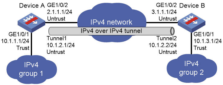

Example: Configuring an IPv4 over IPv4 tunnel
As shown in Figure 14, the two subnets IPv4 group 1 and IPv4 group 2 use private IPv4 addresses. Configure an IPv4 over IPv4 tunnel between Device A and Device B to make the two subnets reachable to each other.
Figure 14 Network diagram
# Assign an IP addresse to interface GigabitEthernet 1/0/1.
[DeviceA-GigabitEthernet1/0/1] ip address 10.1.1.1 24
# Create IPv4 over IPv4 tunnel interface Tunnel 1.
[DeviceA] interface tunnel 1 mode ipv4-ipv4
[DeviceA-Tunnel1] ip address 10.1.2.1 255.255.255.0
[DeviceA-Tunnel1] source 2.1.1.1
[DeviceA-Tunnel1] destination 3.1.1.1
[DeviceA-Tunnel1] quit
# Configure settings for routing. This example configures static routes. In the routes, the output interface is Tunnel 1 and the next hop is 2.1.1.2.
[DeviceA] ip route-static 3.1.1.1 24 2.1.1.2
[DeviceA] ip route-static 10.1.3.0 24 tunnel 1
[DeviceA-security-zone-Untrust] import interface tunnel 1
[DeviceA-security-policy-ip-1-tunnellocalout] destination-ip-host 3.1.1.1
# Configure a rule named trust-untrust in the IPv4 security policy to permit the packets from IPv4 group 1 to IPv4 group 2.
[DeviceA-security-policy-ip] rule name trust-untrust
[DeviceA-security-policy-ip-2-trust-untrust] source-zone trust
[DeviceA-security-policy-ip-2-trust-untrust] destination-zone untrust
[DeviceA-security-policy-ip-2-trust-untrust] source-ip-subnet 10.1.1.0 24
[DeviceA-security-policy-ip-2-trust-untrust] destination-ip-subnet 10.1.3.0 24
[DeviceA-security-policy-ip-2-trust-untrust] action pass
[DeviceA-security-policy-ip-2-trust-untrust] quit
[DeviceA-security-policy-ip-3-tunnellocalin] source-zone untrust
[DeviceA-security-policy-ip-3-tunnellocalin] destination-zone local
[DeviceA-security-policy-ip-3-tunnellocalin] source-ip-host 3.1.1.1
[DeviceA-security-policy-ip-3-tunnellocalin] destination-ip-host 2.1.1.1
[DeviceA-security-policy-ip-3-tunnellocalin] action pass
[DeviceA-security-policy-ip-3-tunnellocalin] quit
# Configure a rule named untrust-trust in the IPv4 security policy to permit the packets from IPv4 group 2 to IPv4 group 1.
[DeviceA-security-policy-ip] rule name untrust-trust
[DeviceA-security-policy-ip-4-untrust-trust] source-zone untrust
[DeviceA-security-policy-ip-4-untrust-trust] destination-zone trust
[DeviceA-security-policy-ip-4-untrust-trust] source-ip-subnet 10.1.3.0 24
[DeviceA-security-policy-ip-4-untrust-trust] destination-ip-subnet 10.1.1.0 24
[DeviceA-security-policy-ip-4-untrust-trust] action pass
[DeviceA-security-policy-ip-4-untrust-trust] quit
[DeviceB-GigabitEthernet1/0/1] ip address 10.1.3.1 24
# Create IPv4 over IPv4 tunnel interface Tunnel 2.
[DeviceB] interface tunnel 2 mode ipv4-ipv4
[DeviceB-Tunnel2] ip address 10.1.2.2 255.255.255.0
[DeviceB-Tunnel2] source 3.1.1.1
[DeviceB-Tunnel2] destination 2.1.1.1
[DeviceB-Tunnel2] quit
# Configure settings for routing. This example configures static routes. In the routes, the output interface is Tunnel 2 and the next hop is 3.1.1.2.
[DeviceB] ip route-static 2.1.1.1 24 3.1.1.2
[DeviceB] ip route-static 10.1.1.0 24 tunnel 2
[DeviceB-security-zone-Untrust] import interface tunnel 2
[DeviceB-security-zone-Untrust] import interface gigabitethernet 1/0/2
[DeviceB] security-zone name Trust
[DeviceB-security-zone-Trust] import interface gigabitethernet 1/0/1
[DeviceB-security-zone-Trust] quit
[DeviceB-security-policy-ip-1-tunnellocalout] source-ip-host 3.1.1.1
[DeviceB-security-policy-ip-1-tunnellocalout] destination-ip-host 2.1.1.1
# Configure a rule named trust-untrust in the IPv4 security policy to permit the packets from IPv4 group 2 to IPv4 group 1.
[DeviceB-security-policy-ip] rule name trust-untrust
[DeviceB-security-policy-ip-2-trust-untrust] source-zone trust
[DeviceB-security-policy-ip-2-trust-untrust] destination-zone untrust
[DeviceB-security-policy-ip-2-trust-untrust] source-ip-subnet 10.1.3.0 24
[DeviceB-security-policy-ip-2-trust-untrust] destination-ip-subnet 10.1.1.0 24
[DeviceB-security-policy-ip-2-trust-untrust] action pass
[DeviceB-security-policy-ip-2-trust-untrust] quit
[DeviceB-security-policy-ip-3-tunnellocalin] source-zone untrust
[DeviceB-security-policy-ip-3-tunnellocalin] destination-zone local
[DeviceB-security-policy-ip-3-tunnellocalin] source-ip-host 2.1.1.1
[DeviceB-security-policy-ip-3-tunnellocalin] destination-ip-host 3.1.1.1
[DeviceB-security-policy-ip-3-tunnellocalin] action pass
[DeviceB-security-policy-ip-3-tunnellocalin] quit
# Configure a rule named tunnellocalin in the IPv4 security policy to permit the packets from IPv4 group 1 to IPv4 group 2.
[DeviceB-security-policy-ip-4-tunnellocalin] source-zone untrust
[DeviceB-security-policy-ip-4-tunnellocalin] destination-zone local
[DeviceB-security-policy-ip-4-tunnellocalin] source-ip-subnet 10.1.1.0 24
[DeviceB-security-policy-ip-4-tunnellocalin] destination-ip-subnet 10.1.3.0 24
[DeviceB-security-policy-ip-4-tunnellocalin] action pass
[DeviceB-security-policy-ip-4-tunnellocalin] quit
# Use the display interface tunnel command to display the status of the tunnel interfaces on Device A and Device B. Verify that the tunnel interfaces are up. (Details not shown.)
# Verify that Device A and Device B can ping the IPv4 address of the peer interface GigabitEthernet 1/0/1. This example uses Device A.
[DeviceA] ping -a 10.1.1.1 10.1.3.1
Ping 10.1.3.1 (10.1.3.1) from 10.1.1.1: 56 data bytes, press CTRL_C to break
56 bytes from 10.1.3.1: icmp_seq=0 ttl=255 time=2.000 ms
56 bytes from 10.1.3.1: icmp_seq=1 ttl=255 time=1.000 ms
56 bytes from 10.1.3.1: icmp_seq=2 ttl=255 time=0.000 ms
56 bytes from 10.1.3.1: icmp_seq=3 ttl=255 time=1.000 ms
56 bytes from 10.1.3.1: icmp_seq=4 ttl=255 time=1.000 ms
--- Ping statistics for 10.1.3.1 ---
round-trip min/avg/max/std-dev = 0.000/1.000/2.000/0.632 ms

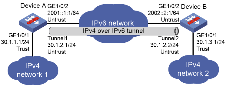

IPv4 over IPv6 tunneling adds an IPv6 header to IPv4 packets so that the IPv4 packets can pass an IPv6 network through a tunnel to realize interworking between isolated IPv4 networks.
Figure 15 IPv4 over IPv6 tunnel
Figure 15 shows the encapsulation and de-encapsulation processes.

IPv4 over IPv6 tunnels include IPv4 over IPv6 manual tunnels and DS-Lite tunnels.
An IPv4 over IPv6 manual tunnel is a point-to-point link and its source and destination IPv6 addresses are manually configured. You can establish an IPv4 over IPv6 manual tunnel to connect isolated IPv4 networks over an IPv6 network.

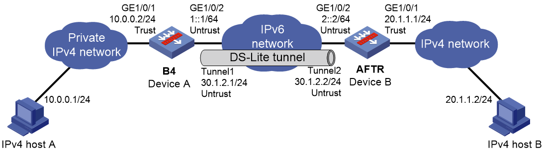

DS-Lite tunnel
Dual Stack Lite (DS-Lite) is a combination of the tunneling and NAT technologies. NAT translates the private IPv4 addresses of the IPv4 hosts before the hosts reach the IPv4 public network.
DS-Lite tunnel supports only an IPv4 host in a private network initiating communication with an IPv4 host on the Internet. It does not support an IPv4 host on the Internet initiating communication with an IPv4 host in a private network.
Figure 16 DS-Lite tunnel
As shown in Figure 16, the DS-Lite feature contains the following components:
·     Basic Bridging BroadBand (B4) element
The B4 element is typically a CPE router that connects end hosts. IPv4 packets entering the B4 router are encapsulated into IPv6 packets and sent to the AFTR. IPv6 packets from the AFTR are de-encapsulated into IPv4 packets and sent to the subscriber's network.
Hosts that can act as the B4 router are referred to as DS-Lite hosts.
·     Address Family Transition Router (AFTR)
An AFTR resides in the ISP network and terminates the tunnel from the B4 router. NAT is also implemented on the interface that is connected to the public IPv4 network.
An AFTR de-encapsulates the tunneled packet, translates the network address, and routes the packet to the destination IPv4 network. For IPv4 packets coming from the public IPv4 network, the AFTR performs reverse address translation and sends them to the B4 router by using the DS-Lite tunnel.
Figure 17 Packet forwarding process in DS-Lite
As shown in Figure 17, the packet forwarding process in DS-Lite is as follows:
1.     Upon receiving a packet from the private IPv4 network, the B4 router adds an IPv6 header to the packet and sends the IPv6 packet to the AFTR through the tunnel.
2.     The AFTR performs the following operations:
a.     Removes the IPv6 header from the tunneled packet.
b.     Assigns a tunnel ID for the B4 router.
c.     Records the mapping between the IPv6 address of the B4 router (the source IPv6 address of the packet), and the tunnel ID.
3.     After de-encapsulation, the AFTR translates the source private IPv4 address of the packet into a public IPv4 address and sends the packet to the destination IPv4 host. The AFTR also maps the NAT entries to the tunnel ID so that IPv4 networks connected to different B4 routers can use the same address space.
4.     Upon receiving the response packet from the public network, the AFTR translates the destination public IPv4 address into the private IPv4 address. The AFTR performs the following operations:
a.     Looks up the IPv6 address-tunnel ID mapping to obtain the IP address of the B4 router.
b.     Uses the address as the destination address of the encapsulated IPv6 packet.
c.     Forwards the packet to the B4 router.

Example: Configuring a DS-Lite tunnel
As shown in Figure 19, to enable hosts in the private IPv4 network to access the public IPv4 network over the IPv6 network, perform the following tasks:
·     Configure a DS-Lite tunnel between Device A and Device B.
·     Configure NAT on GigabitEthernet 1/0/1 on the AFTR.
Figure 19 Network diagram
[DeviceA-GigabitEthernet1/0/1] ip address 10.0.0.2 24
[DeviceA-GigabitEthernet1/0/2] ipv6 address 1::1 64
# Create IPv6 tunnel interface Tunnel 1.
[DeviceA] interface tunnel 1 mode ipv6
[DeviceA-Tunnel1] ip address 30.1.2.1 255.255.255.0
[DeviceA-Tunnel1] source 1::1
[DeviceA-Tunnel1] destination 2::2
# Configure settings for routing. This example configures static routes. In the routes, the output interface is Tunnel 1 and the next hop is 1::2.
[DeviceA] ipv6 route-static 2002::2:1 64 1::2
[DeviceA] ip route-static 20.1.1.0 24 tunnel 1
[DeviceA-security-policy-ipv6-1-tunnellocalout] source-ip-host 1::1
[DeviceA-security-policy-ipv6-1-tunnellocalout] destination-ip-host 2::2
# Configure a rule named trust-untrust in the IPv4 security policy to permit the packets from IPv4 host A to IPv4 host B.
[DeviceA-security-policy-ip-1-trust-untrust] source-zone trust
[DeviceA-security-policy-ip-1-trust-untrust] destination-zone untrust
[DeviceA-security-policy-ip-1-trust-untrust] source-ip-subnet 10.0.0.0 24
[DeviceA-security-policy-ip-1-trust-untrust] destination-ip-subnet 20.1.1.0 24
[DeviceA-security-policy-ip-1-trust-untrust] action pass
[DeviceA-security-policy-ip-1-trust-untrust] quit
[DeviceA-security-policy-ipv6-2-tunnellocalin] source-ip-host 2::2
[DeviceA-security-policy-ipv6-2-tunnellocalin] destination-ip-host 1::1
[DeviceA-security-policy-ipv6-2-tunnellocalin] quit
# Configure a rule named untrust-trust in the IPv4 security policy to permit the packets from IPv4 host B to IPv4 host A.
[DeviceA-security-policy-ip-2-untrust-trust] source-zone untrust
[DeviceA-security-policy-ip-2-untrust-trust] destination-zone trust
[DeviceA-security-policy-ip-2-untrust-trust] source-ip-subnet 20.1.1.0 24
[DeviceA-security-policy-ip-2-untrust-trust] destination-ip-subnet 10.0.0.0 24
[DeviceA-security-policy-ip-2-untrust-trust] action pass
[DeviceA-security-policy-ip-2-untrust-trust] quit
[DeviceB-GigabitEthernet1/0/1] ip address 20.1.1.1 24
[DeviceB] interface gigabitethernet 1/0/2
[DeviceB-GigabitEthernet1/0/2] ipv6 address 2::2 64
[DeviceB-GigabitEthernet1/0/2] quit
# Create DS-Lite tunnel interface Tunnel 2.
[DeviceB] interface tunnel 2 mode ds-lite-aftr
[DeviceB-Tunnel2] ip address 30.1.2.2 255.255.255.0
[DeviceB-Tunnel2] source gigabitethernet 1/0/2
# Enable DS-Lite tunneling on GigabitEthernet 1/0/1.
[DeviceB-GigabitEthernet1/0/1] ds-lite enable
# Enable NAT on GigabitEthernet 1/0/1 and use the IP address of GigabitEthernet 1/0/1 as the translated address.
[DeviceB-GigabitEthernet1/0/1] nat outbound
# Configure settings for routing. This example configures a static route, and the next hop in the route is 2::3.
[DeviceB] ipv6 route-static 1::1 64 2::3
[DeviceB-security-policy-ipv6-1-tunnellocalout] source-ip-host 2::2
[DeviceB-security-policy-ipv6-1-tunnellocalout] destination-ip-host 1::1
# Configure a rule named trust-untrust in the IPv4 security policy to permit the packets from IPv4 host B to IPv4 host A.
[DeviceB-security-policy-ip-2-trust-untrust] source-ip-subnet 20.1.1.0 24
[DeviceB-security-policy-ip-2-trust-untrust] destination-ip-subnet 10.0.0.0 24
[DeviceB-security-policy-ipv6-3-tunnellocalin] source-zone untrust
[DeviceB-security-policy-ipv6-3-tunnellocalin] destination-zone local
[DeviceB-security-policy-ipv6-3-tunnellocalin] source-ip-host 1::1
[DeviceB-security-policy-ipv6-3-tunnellocalin] destination-ip-host 2::2
[DeviceB-security-policy-ipv6-3-tunnellocalin] action pass
[DeviceB-security-policy-ipv6-3-tunnellocalin] quit
# Configure a rule named untrust-trust in the IPv4 security policy to permit the packets from IPv4 host A to IPv4 host B.
[DeviceB-security-policy-ip] rule name untrust-trust
[DeviceB-security-policy-ip-4-untrust-trust] source-zone untrust
[DeviceB-security-policy-ip-4-untrust-trust] destination-zone trust
[DeviceB-security-policy-ip-4-untrust-trust] source-ip-subnet 10.0.0.0 24
[DeviceB-security-policy-ip-4-untrust-trust] destination-ip-subnet 20.1.1.0 24
[DeviceB-security-policy-ip-4-untrust-trust] action pass
[DeviceB-security-policy-ip-4-untrust-trust] quit
3.     On host A, specify the IP address for the host as 10.0.0.1 and configure a static route to 20.1.1.0/24 with next hop 10.0.0.2. (Details not shown.)
4.     On host B, specify the IP address for the host as 20.1.1.2. (Details not shown.)
# Verify that host A can ping host B.
C:\> ping 20.1.1.2
Pinging 20.1.1.2 with 32 bytes of data:
Reply from 20.1.1.2: bytes=32 time=51ms TTL=255
Reply from 20.1.1.2: bytes=32 time=44ms TTL=255
Reply from 20.1.1.2: bytes=32 time=1ms TTL=255
Ping statistics for 20.1.1.2:
    Minimum = 1ms, Maximum = 51ms, Average = 24ms
