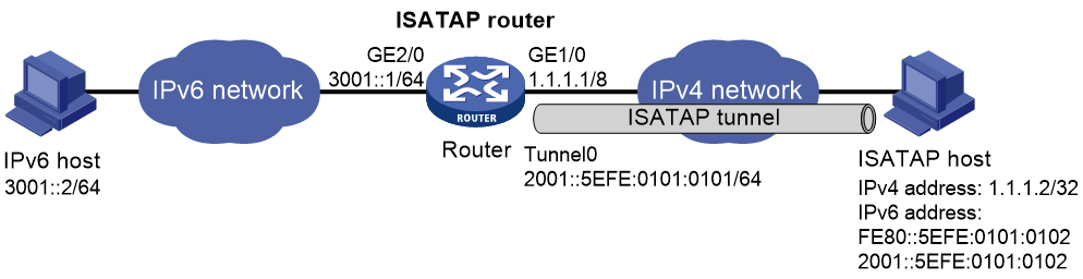

ISATAP tunneling
An ISATAP tunnel is a point-to-multipoint automatic tunnel. It provides a solution to connect an IPv6 host and an IPv6 network over an IPv4 network.
The destination address of an ISATAP tunnel is an ISATAP address. The address format is prefix:0:5EFE:abcd:efgh/64.
·     The 64-bit prefix is a valid IPv6 unicast address prefix.
·     The abcd:efgh/64 segments represent a 32-bit IPv4 address in hexadecimal notation, which identifies the tunnel destination but does not require global uniqueness.
ISATAP tunnels are mainly used for communication between IPv6 routers or between an IPv6 host and an IPv6 router over an IPv4 network.
Figure 3 Principle of ISATAP tunneling

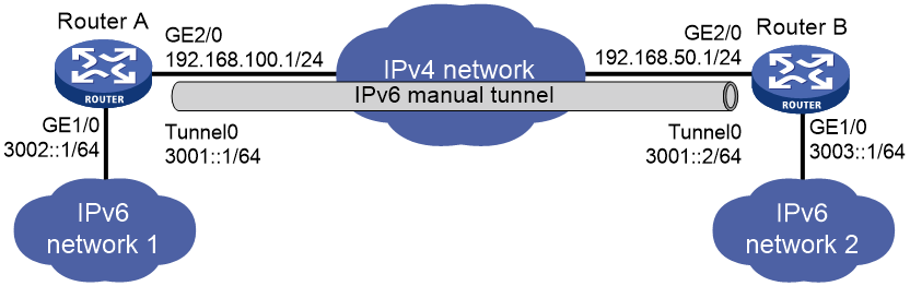

Example: Configuring an IPv6 over IPv4 manual tunnel
As shown in Figure 4, configure an IPv6 over IPv4 tunnel between Router A and Router B so the two IPv6 networks can reach each other over the IPv4 network. Because the tunnel destination IPv4 address cannot be automatically obtained from the destination IPv6 addresses, configure an IPv6 over IPv4 manual tunnel.
Figure 4 Network diagram
Make sure Router A and Router B can reach each other through IPv4.
1.     Configure Router A:
# Specify an IPv4 address for GigabitEthernet 2/0.
<RouterA> system-view
[RouterA] interface gigabitethernet 2/0
[RouterA-GigabitEthernet2/0] ip address 192.168.100.1 255.255.255.0
[RouterA-GigabitEthernet2/0] quit
# Specify an IPv6 address for GigabitEthernet 1/0.
[RouterA] interface gigabitethernet 1/0
[RouterA-GigabitEthernet1/0] ipv6 address 3002::1 64
[RouterA-GigabitEthernet1/0] quit
# Create IPv6 over IPv4 manual tunnel interface Tunnel 0.
[RouterA] interface tunnel 0 mode ipv6-ipv4
# Specify an IPv6 address for the tunnel interface.
[RouterA-Tunnel0] ipv6 address 3001::1/64
# Specify GigabitEthernet 2/0 as the source interface of the tunnel.
[RouterA-Tunnel0] source gigabitethernet 2/0
# Specify the IP address of GigabitEthernet 2/0 on Router B as the destination address of the tunnel.
[RouterA-Tunnel0] destination 192.168.50.1
[RouterA-Tunnel0] quit
# Configure a static route destined for IPv6 network 2 through Tunnel 0.
[RouterA] ipv6 route-static 3003:: 64 tunnel 0
2.     Configure Router B:
<RouterB> system-view
[RouterB] interface gigabitethernet 2/0
[RouterB-GigabitEthernet2/0] ip address 192.168.50.1 255.255.255.0
[RouterB-GigabitEthernet2/0] quit
[RouterB] interface gigabitethernet 1/0
[RouterB-GigabitEthernet1/0] ipv6 address 3003::1 64
[RouterB-GigabitEthernet1/0] quit
[RouterB] interface tunnel 0 mode ipv6-ipv4
[RouterB-Tunnel0] ipv6 address 3001::2/64
[RouterB-Tunnel0] source gigabitethernet 2/0
# Specify the IP address of GigabitEthernet 2/0 on Router A as the destination address of the tunnel.
[RouterB-Tunnel0] destination 192.168.50.1
[RouterB-Tunnel0] quit
# Configure a static route destined for IPv6 network 1 through Tunnel 0.
[RouterB] ipv6 route-static 3002:: 64 tunnel 0
# Use the display ipv6 interface command to display tunnel interface status on Router A and Router B. Verify that the interface tunnel 0 is up. (Details not shown.)
# Verify that Router B and Router A can ping the IPv6 address of GigabitEthernet 1/0 of each other. This example uses Router A.
[RouterA] ping ipv6 3003::1
Ping6(56 data bytes) 3001::1 --> 3003::1, press CTRL C to break
56 bytes from 3003::1, icmp_seq=0 hlim=64 time=45.000 ms
56 bytes from 3003::1, icmp_seq=1 hlim=64 time=10.000 ms
56 bytes from 3003::1, icmp_seq=2 hlim=64 time=4.000 ms
56 bytes from 3003::1, icmp_seq=3 hlim=64 time=10.000 ms
56 bytes from 3003::1, icmp_seq=4 hlim=64 time=11.000 ms
--- Ping6 statistics for 3003::1 ---
round-trip min/avg/max/std-dev = 4.000/16.000/45.000/14.711 ms

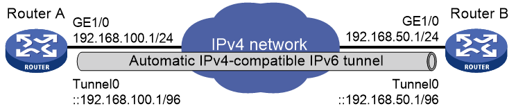

Example: Configuring an automatic IPv4-compatible IPv6 tunnel
As shown in Figure 5, dual-stack devices Router A and Router B communicate over an IPv4 network. Configure an automatic IPv4-compatible IPv6 tunnel between Router A and Router B to enable IPv6 communications over the IPv4 network.
Figure 5 Network diagram
# Specify an IPv4 address for GigabitEthernet 1/0.
[RouterA-GigabitEthernet1/0] ip address 192.168.100.1 255.255.255.0
# Create an automatic IPv4-compatible IPv6 tunnel.
[RouterA] interface tunnel 0 mode ipv6-ipv4 auto-tunnel
# Specify an IPv4-compatible IPv6 address for the tunnel interface.
[RouterA-Tunnel0] ipv6 address ::192.168.100.1/96
# Specify GigabitEthernet 1/0 as the source interface of the tunnel.
[RouterA-Tunnel0] source gigabitethernet 1/0
[RouterB-GigabitEthernet1/0] ip address 192.168.50.1 255.255.255.0
[RouterB] interface tunnel 0 mode ipv6-ipv4 auto-tunnel
[RouterB-Tunnel0] ipv6 address ::192.168.50.1/96
[RouterB-Tunnel0] source gigabitethernet 1/0
# Verify that Router B and Router A can ping the IPv4-compatible IPv6 address of each other. This example uses Router A.
[RouterA-Tunnel0] ping ipv6 ::192.168.50.1
Ping6(56 data bytes) ::192.168.100.1 --> ::192.168.50.1, press CTRL_C to break
56 bytes from ::192.168.50.1, icmp_seq=0 hlim=64 time=17.000 ms
56 bytes from ::192.168.50.1, icmp_seq=1 hlim=64 time=9.000 ms
56 bytes from ::192.168.50.1, icmp_seq=2 hlim=64 time=11.000 ms
56 bytes from ::192.168.50.1, icmp_seq=3 hlim=64 time=9.000 ms
56 bytes from ::192.168.50.1, icmp_seq=4 hlim=64 time=11.000 ms
--- Ping6 statistics for ::192.168.50.1 ---
round-trip min/avg/max/std-dev = 9.000/11.400/17.000/2.939 ms

Configuring an ISATAP tunnel
Follow these guidelines when you configure an ISATAP tunnel:
·     You do not need to configure a destination address for an ISATAP tunnel, because the destination IPv4 address is embedded in the ISATAP address.
·     Do not specify the same tunnel source addresses for tunnels of the same tunnel mode.
·     Because automatic tunnels do not support dynamic routing, configure a static route destined for the destination IPv6 network at each tunnel end. You can specify the local tunnel interface as the egress interface of the route or specify the IPv6 address of the peer tunnel interface as the next hop of the route. For more information about route configuration, see Layer 3—IP Routing Configuration Guide.
2.     Enter ISATAP tunnel interface view.
interface tunnel number [ mode ipv6-ipv4 isatap ]
3.     Specify an IPv6 address for the tunnel interface.
See "Configuring basic IPv6 settings."
4.     Configure a source address or source interface for the tunnel.
source { ipv4-address | interface-type interface-number }
By default, no source address or source interface is configured for a tunnel.
If you specify a source address, it is used as the source IP address of tunneled packets.
If you specify a source interface, the primary IP address of this interface is used as the source IP address of tunneled packets.
5.     (Optional.) Set the DF bit for tunneled packets.
tunnel dfbit enable
By default, the DF bit is not set for tunneled packets.
Example: Configuring an ISATAP tunnel
As shown in Figure 8, configure an ISATAP tunnel between the ISATAP router (Router) and the ISATAP host so the ISATAP host in the IPv4 network can access the IPv6 network.
Figure 8 Network diagram
1.     Configure the ISATAP router (Router):
# Specify an IPv6 address for GigabitEthernet 2/0.
<Router> system-view
[Router] interface gigabitethernet 2/0
[Router-GigabitEthernet2/0] ipv6 address 3001::1/64
[Router-GigabitEthernet2/0] quit
[Router] interface gigabitethernet 1/0
[Router-GigabitEthernet1/0] ip address 1.1.1.1 255.0.0.0
[Router-GigabitEthernet1/0] quit
# Create ISATAP tunnel interface Tunnel 0.
[Router] interface tunnel 0 mode ipv6-ipv4 isatap
# Specify an EUI-64 IPv6 address for the tunnel interface.
[Router-Tunnel0] ipv6 address 2001:: 64 eui-64
[Router-Tunnel0] source gigabitethernet 1/0
# Disable RA suppression so that the ISATAP host can acquire information such as the address prefix from the RA message advertised by the ISATAP router.
[Router-Tunnel0] undo ipv6 nd ra halt
[Router-Tunnel0] quit
2.     Configure the ISATAP host:
Configurations on the ISATAP host vary by operating system. The following configuration is performed on Windows XP.
# Install IPv6.
C:\>ipv6 install
# On a host running Windows XP, the ISATAP interface is typically interface 2. Display information about the ISATAP interface.
C:\>ipv6 if 2
Interface 2: Automatic Tunneling Pseudo-Interface
  Guid {48FCE3FC-EC30-E50E-F1A7-71172AEEE3AE}
  does not use Neighbor Discovery
  does not use Router Discovery
  routing preference 1
  EUI-64 embedded IPv4 address: 0.0.0.0
  router link-layer address: 0.0.0.0
  preferred link-local fe80::5efe:1.1.1.2, life infinite
  link MTU 1280 (true link MTU 65515)
  current hop limit 128
  reachable time 42500ms (base 30000ms)
  retransmission interval 1000ms
  DAD transmits 0
  default site prefix length 48
# Specify an IPv4 address for the ISATAP router.
C:\>netsh interface ipv6 isatap set router 1.1.1.1
# Display information about the ISATAP interface.
C:\>ipv6 if 2
  uses Router Discovery
  EUI-64 embedded IPv4 address: 1.1.1.2
  router link-layer address: 1.1.1.1
  preferred global 2001::5efe:1.1.1.2, life 29d23h59m46s/6d23h59m46s (public)
  link MTU 1500 (true link MTU 65515)
  current hop limit 255
  DAD transmits 0
The host has obtained the prefix 2001::/64 and has automatically generated the global unicast address 2001::5efe:1.1.1.2. The message "uses Router Discovery" indicates that the router discovery feature is enabled on the host.
# Display information about IPv6 routes on the host.
C:\>ipv6 rt
2001::/64 -> 2 pref 1if+8=9 life 29d23h59m43s (autoconf)
::/0 -> 2/fe80::5efe:1.1.1.1 pref 1if+256=257 life 29m43s (autoconf)
3.     On the IPv6 host, configure a route to the ISATAP router.
C:\>netsh interface ipv6 set route 2001::/64 5 3001::1
# Verify that the ISATAP host can ping the IPv6 host.
C:\>ping 3001::2
Pinging 3001::2 with 32 bytes of data:
Reply from 3001::2: time=1ms
Ping statistics for 3001::2:

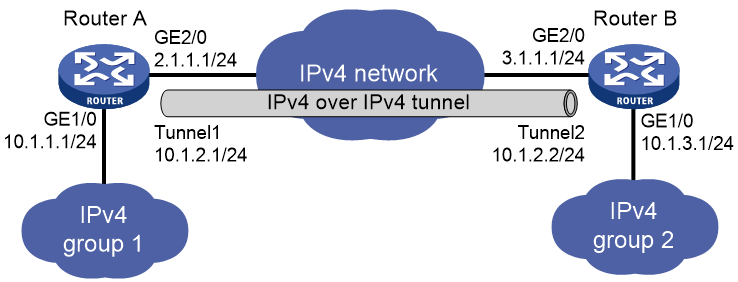

IPv4 over IPv4 tunneling
About IPv4 over IPv4 tunneling
IPv4 over IPv4 tunneling (RFC 1853) enables isolated IPv4 networks to communicate. For example, an IPv4 over IPv4 tunnel can connect isolated private IPv4 networks over a public IPv4 network.
Figure 9 IPv4 over IPv4 tunnel
Figure 9 shows the encapsulation and de-encapsulation processes.
·     Encapsulation:
a.     Device A receives an IP packet from an IPv4 host and submits it to the IP protocol stack.
b.     The IPv4 protocol stack determines how to forward the packet according to the destination address in the IP header. If the packet is destined for the IPv4 host connected to Device B, Device A delivers the packet to the tunnel interface.
c.     The tunnel interface adds a new IPv4 header to the IPv4 packet and submits it to the IP protocol stack.
In the new header, the source IP address specifies the tunnel source, and the destination IP address specifies the tunnel destination.
d.     The IP protocol stack uses the destination IP address of the new IP header to look up the routing table, and then sends the packet out.
·     De-encapsulation:
a.     After receiving the packet, Device B delivers it to the IP protocol stack.
b.     If the protocol number is 4 (indicating an IPv4 packet is encapsulated within the packet), the IP protocol stack delivers the packet to the tunnel module for de-encapsulation.
c.     The tunnel module de-encapsulates the IP packet and sends it back to the IP protocol stack.
d.     The protocol stack forwards the de-encapsulated packet.
Restrictions and guidelines: IPv4 over IPv4 tunnel configuration
Follow these guidelines when you configure an IPv4 over IPv4 tunnel:
·     The tunnel destination address specified on the local device must be identical with the tunnel source address specified on the tunnel peer device.
·     Do not specify the same tunnel source and destination addresses for tunnels of the same tunnel mode.
·     The IPv4 address of the local tunnel interface cannot be on the same subnet as the destination address configured on the tunnel interface.
·     To ensure correct packet forwarding, identify whether the destination IPv4 network and the IPv4 address of the local tunnel interface are on the same subnet. If they are not, configure a route reaching the destination IPv4 network through the tunnel interface. You can configure the route by using one of the following methods:
¡     Configure a static route, and specify the local tunnel interface as the egress interface or specify the IPv4 address of the peer tunnel interface as the next hop.
¡     Enable a dynamic routing protocol on both the local and remote tunnel interfaces.
·     The destination address of the route passing the tunnel interface cannot be on the same subnet as the destination address configured on the tunnel interface.
Configuring an IPv4 over IPv4 tunnel
2.     Enter IPv4 over IPv4 tunnel interface view.
interface tunnel number [ mode ipv4-ipv4 ]
3.     Configure an IPv4 address for the tunnel interface.
ip address ip-address { mask | mask-length } [ sub ]
5.     Configure a destination address for the tunnel.
destination ipv4-address
By default, no destination address is configured for a tunnel.
The tunnel destination address must be the IP address of the receiving interface on the tunnel peer. It is used as the destination IP address of tunneled packets.

IPv4 over IPv4 tunnel configuration examples
Example: Configuring an IPv4 over IPv4 tunnel
As shown in Figure 10, the two subnets IPv4 group 1 and IPv4 group 2 use private IPv4 addresses. Configure an IPv4 over IPv4 tunnel between Router A and Router B to make the two subnets reachable to each other.
Figure 10 Network diagram
[RouterA-GigabitEthernet1/0] ip address 10.1.1.1 255.255.255.0
# Specify an IPv4 address for GigabitEthernet 2/0, which is the physical interface of the tunnel.
[RouterA-GigabitEthernet2/0] ip address 2.1.1.1 255.255.255.0
# Create IPv4 over IPv4 tunnel interface Tunnel 1.
[RouterA] interface tunnel 1 mode ipv4-ipv4
# Specify an IPv4 address for the tunnel interface.
[RouterA-Tunnel1] ip address 10.1.2.1 255.255.255.0
# Specify the IP address of GigabitEthernet 2/0 as the source address of the tunnel.
[RouterA-Tunnel1] source 2.1.1.1
[RouterA-Tunnel1] destination 3.1.1.1
[RouterA-Tunnel1] quit
# Configure a static route destined for IPv4 group 2 through the tunnel.
[RouterA] ip route-static 10.1.3.0 255.255.255.0 tunnel 1
[RouterB-GigabitEthernet1/0] ip address 10.1.3.1 255.255.255.0
[RouterB-GigabitEthernet2/0] ip address 3.1.1.1 255.255.255.0
# Create IPv4 over IPv4 tunnel interface Tunnel 2.
[RouterB] interface tunnel 2 mode ipv4-ipv4
[RouterB-Tunnel2] ip address 10.1.2.2 255.255.255.0
[RouterB-Tunnel2] source 3.1.1.1
[RouterB-Tunnel2] destination 2.1.1.1
[RouterB-Tunnel2] quit
# Configure a static route destined for IPv4 group 1 through the tunnel.
[RouterB] ip route-static 10.1.1.0 255.255.255.0 tunnel 2
# Use the display interface tunnel command to display the status of the tunnel interfaces on Router A and Router B. Verify that the tunnel interfaces are up. (Details not shown.)
# Verify that Router A and Router B can ping the IPv4 address of the peer interface GigabitEthernet 1/0. This example uses Router A.
[RouterA] ping -a 10.1.1.1 10.1.3.1
Ping 10.1.3.1 (10.1.3.1) from 10.1.1.1: 56 data bytes, press CTRL_C to break
56 bytes from 10.1.3.1: icmp_seq=0 ttl=255 time=2.000 ms
56 bytes from 10.1.3.1: icmp_seq=1 ttl=255 time=1.000 ms
56 bytes from 10.1.3.1: icmp_seq=2 ttl=255 time=0.000 ms
56 bytes from 10.1.3.1: icmp_seq=3 ttl=255 time=1.000 ms
56 bytes from 10.1.3.1: icmp_seq=4 ttl=255 time=1.000 ms
--- Ping statistics for 10.1.3.1 ---
round-trip min/avg/max/std-dev = 0.000/1.000/2.000/0.632 ms

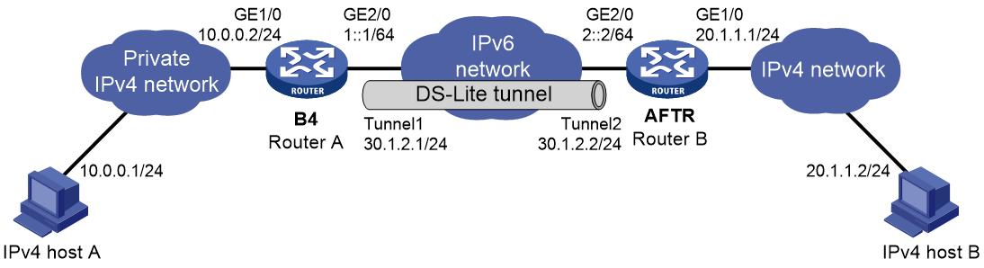

DS-Lite tunnel
Dual Stack Lite (DS-Lite) is a combination of the tunneling and NAT technologies. NAT translates the private IPv4 addresses of the IPv4 hosts before the hosts reach the IPv4 public network.
DS-Lite tunnel supports only an IPv4 host in a private network initiating communication with an IPv4 host on the Internet. It does not support an IPv4 host on the Internet initiating communication with an IPv4 host in a private network.
Figure 12 DS-Lite tunnel
As shown in Figure 12, the DS-Lite feature contains the following components:
·     Basic Bridging BroadBand (B4) element
The B4 element is typically a CPE router that connects end hosts. IPv4 packets entering the B4 router are encapsulated into IPv6 packets and sent to the AFTR. IPv6 packets from the AFTR are de-encapsulated into IPv4 packets and sent to the subscriber's network.
Hosts that can act as the B4 router are referred to as DS-Lite hosts.
·     Address Family Transition Router (AFTR)
An AFTR resides in the ISP network and terminates the tunnel from the B4 router. NAT is also implemented on the interface that is connected to the public IPv4 network.
An AFTR de-encapsulates the tunneled packet, translates the network address, and routes the packet to the destination IPv4 network. For IPv4 packets coming from the public IPv4 network, the AFTR performs reverse address translation and sends them to the B4 router by using the DS-Lite tunnel.
Figure 13 Packet forwarding process in DS-Lite
As shown in Figure 13, the packet forwarding process in DS-Lite is as follows:
1.     Upon receiving a packet from the private IPv4 network, the B4 router adds an IPv6 header to the packet and sends the IPv6 packet to the AFTR through the tunnel.
2.     The AFTR performs the following operations:
a.     Removes the IPv6 header from the tunneled packet.
b.     Assigns a tunnel ID for the B4 router.
c.     Records the mapping between the IPv6 address of the B4 router (the source IPv6 address of the packet), and the tunnel ID.
3.     After de-encapsulation, the AFTR translates the source private IPv4 address of the packet into a public IPv4 address and sends the packet to the destination IPv4 host. The AFTR also maps the NAT entries to the tunnel ID so that IPv4 networks connected to different B4 routers can use the same address space.
4.     Upon receiving the response packet from the public network, the AFTR translates the destination public IPv4 address into the private IPv4 address. The AFTR performs the following operations:
a.     Looks up the IPv6 address-tunnel ID mapping to obtain the IP address of the B4 router.
b.     Uses the address as the destination address of the encapsulated IPv6 packet.
c.     Forwards the packet to the B4 router.
Figure 13 shows an example of PAT translation for dynamic NAT. Typically, dynamic NAT is used. When you use static NAT for DS-Lite tunneling, make sure the IP addresses of private IPv4 networks connected to different B4 routers do not overlap. For more information about NAT, see "Configuring NAT."

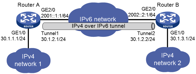

Example: Configuring an IPv4 over IPv6 tunnel
As shown in Figure 14, configure an IPv4 over IPv6 manual tunnel between Router A and Router B so the two networks can reach each other over the IPv6 network.
Figure 14 Network diagram
Make sure Router A and Router B can reach each other through IPv6.
[RouterA-GigabitEthernet1/0] ip address 30.1.1.1 255.255.255.0
# Specify an IPv6 address for GigabitEthernet 2/0, which is the physical interface of the tunnel.
[RouterA-GigabitEthernet2/0] ipv6 address 2001::1:1 64
# Create IPv6 tunnel interface Tunnel 1.
[RouterA] interface tunnel 1 mode ipv6
[RouterA-Tunnel1] ip address 30.1.2.1 255.255.255.0
[RouterA-Tunnel1] source 2001::1:1
[RouterA-Tunnel1] destination 2002::2:1
# Configure a static route destined for IPv4 network 2 through the tunnel.
[RouterA] ip route-static 30.1.3.0 255.255.255.0 tunnel 1
[RouterB-GigabitEthernet1/0] ip address 30.1.3.1 255.255.255.0
[RouterB-GigabitEthernet2/0] ipv6 address 2002::2:1 64
# Create IPv6 tunnel interface Tunnel 2.
[RouterB] interface tunnel 2 mode ipv6
[RouterB-Tunnel2] ip address 30.1.2.2 255.255.255.0
[RouterB-Tunnel2] source 2002::2:1
[RouterB-Tunnel2] destination 2001::1:1
# Configure a static route destined for IPv4 network 1 through the tunnel.
[RouterB] ip route-static 30.1.1.0 255.255.255.0 tunnel 2
[RouterA] ping -a 30.1.1.1 30.1.3.1
Ping 30.1.3.1 (30.1.3.1) from 30.1.1.1: 56 data bytes, press CTRL_C to break
56 bytes from 30.1.3.1: icmp_seq=0 ttl=255 time=3.000 ms
56 bytes from 30.1.3.1: icmp_seq=1 ttl=255 time=1.000 ms
56 bytes from 30.1.3.1: icmp_seq=2 ttl=255 time=0.000 ms
56 bytes from 30.1.3.1: icmp_seq=3 ttl=255 time=1.000 ms
56 bytes from 30.1.3.1: icmp_seq=4 ttl=255 time=1.000 ms
--- Ping statistics for 30.1.3.1 ---
round-trip min/avg/max/std-dev = 0.000/1.200/3.000/0.980 ms

Example: Configuring a DS-Lite tunnel
As shown in Figure 15, to enable hosts in the private IPv4 network to access the public IPv4 network over the IPv6 network, perform the following tasks:
·     Configure a DS-Lite tunnel between Router A and Router B.
·     Configure NAT on GigabitEthernet 1/0 on the AFTR.
Figure 15 Network diagram
