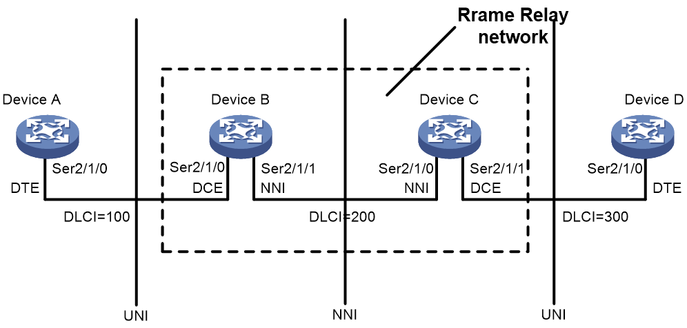

Frame Relay network components
As shown in Figure 1:
· A Frame Relay network provides data communications between user devices such as routers and hosts. The user devices are also called data terminal equipment (DTE).
· The devices that provide access to the Frame Relay network for DTEs are called data circuit-terminating equipment (DCE).
Frame Relay interfaces include the following types:
· User-to-network interface (UNI)—A DCE is connected to a DTE through UNI interfaces. UNI interfaces include the following types:
¡ DTE interface—The UNI interface on the DTE side.
¡ DCE interface—The UNI interface on the DCE side.
· Network-to-network interface (NNI)—A DCE is connected to a Frame Relay switch in the Frame Relay network through an NNI interface. The switches in the Frame Relay network are interconnected with NNI interfaces.
A DTE interface can connect only to a DCE interface, and an NNI interface can connect only to an NNI interface. On a Frame Relay switch, the Frame Relay interface type must be NNI or DCE.
· Device B and Device C form a simple Frame Relay network.
· DTE devices Device A and Device D are attached to the network.
The interface type DTE or DCE is identified only for the UNI interfaces. A virtual circuit between two DTE devices can be assigned different DLCIs on different segments.

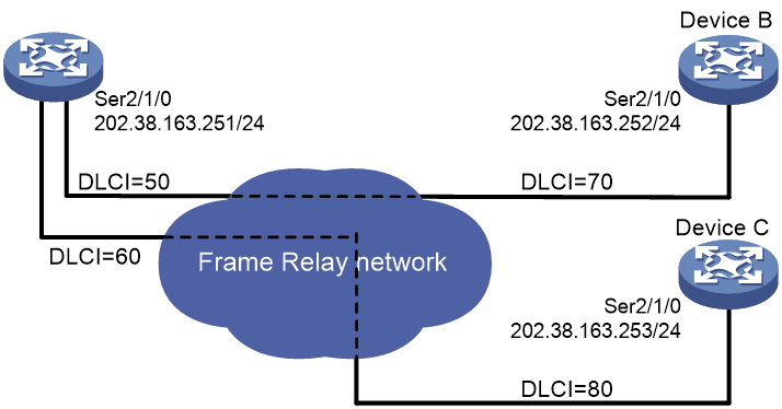

With Frame Relay, you can construct a public or private network as shown in Figure 2 and construct direct connections between data devices as shown in Figure 3.
Figure 2 Interconnecting LANs through a Frame Relay network

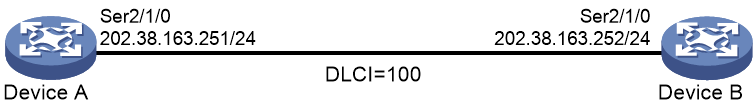

Figure 3 Interconnecting LANs through a dedicated line

Example: Interconnecting LANs through a dedicated line
As shown in Figure 4, configure Frame Relay so that Router A and Router B can communicate.
(Method 1) Using main interfaces:
1. Configure Router A:
# Assign an IP address to Serial 2/1/0.
<RouterA> system-view
[RouterA] interface serial 2/1/0
[RouterA-Serial2/1/0] ip address 202.38.163.251 255.255.255.0
# Enable Frame Relay encapsulation on the interface.
[RouterA-Serial2/1/0] link-protocol fr
# Set the type of the interface to DCE.
[RouterA-Serial2/1/0] fr interface-type dce
# Configure a local virtual circuit.
[RouterA-Serial2/1/0] fr dlci 100
2. Configure Router B:
<RouterB> system-view
[RouterB] interface serial 2/1/0
[RouterB-Serial2/1/0] ip address 202.38.163.252 255.255.255.0
[RouterB-Serial2/1/0] link-protocol fr
# Set the type of the interface to DTE.
[RouterB-Serial2/1/0] fr interface-type dte
[RouterB-Serial2/1/0] quit
(Method 2) Using subinterfaces:
# Enable Frame Relay encapsulation on Serial 2/1/0.
# Set the type of Serial 2/1/0 to DCE.
[RouterA-Serial2/1/0] quit
# Create a subinterface named Serial 2/1/0.1.
[RouterA] interface serial 2/1/0.1 p2p
# Configure the IP address and create a virtual circuit for Serial 2/1/0.1.
[RouterA-Serial2/1/0.1] ip address 202.38.163.251 255.255.255.0
[RouterA-Serial2/1/0.1] fr dlci 100
# Set the type of Serial 2/1/0 to DTE.
[RouterB] interface serial 2/1/0.1 p2p
[RouterB-Serial2/1/0.1] ip address 202.38.163.252 255.255.255.0
[RouterB-Serial2/1/0.1] fr dlci 100
[RouterB-Serial2/1/0.1] quit

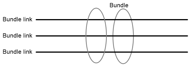

MFR uses the following concepts:
· Bundle—A virtual interface formed by combining multiple physical interfaces. A bundle corresponds to an MFR interface. A bundle is visible to the data link layer.
· Bundle link—Corresponds to a physical interface. A bundle contains and manages multiple bundle links, as shown in Figure 5. Bundle links are visible to the physical layer.
Figure 5 Bundle and bundle links
After a bundle is formed, its bundle links periodically send hello messages to maintain link status. If a bundle link fails to receive a hell acknowledgment after it resends hell messages for the specified maximum number of times, the bundle link is considered to be down at the link layer.
