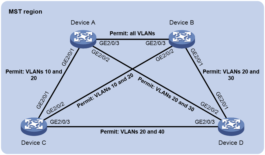

Configuring an MST region
Spanning tree devices belong to the same MST region if they are both connected through a physical link and configured with the following details:
· Format selector (0 by default, not configurable).
· MST region name.
· MST region revision level.
· VLAN-to-instance mapping entries in the MST region.
The configuration of MST region-related parameters (especially the VLAN-to-instance mapping table) might cause MSTP to begin a new spanning tree calculation. To reduce the possibility of topology instability, the MST region configuration takes effect only after you activate it by doing one of the following:
· Use the active region-configuration command.
· Enable a spanning tree protocol by using the stp global enable command if the spanning tree protocol is disabled.
In STP, PVST, or RSTP mode, MST region configurations do not take effect.
1. Enter system view.
2. Enter MST region view.
stp region-configuration
3. Configure the MST region name.
region-name name
The default setting is the MAC address.
4. Configure the VLAN-to-instance mapping table. Choose one option as needed:
¡ Map a list of VLANs to an MSTI.
instance instance-id vlan vlan-id-list
¡ Quickly create a VLAN-to-instance mapping table.
vlan-mapping modulo modulo
By default, all VLANs in an MST region are mapped to the CIST (or MSTI 0).
5. Configure the MSTP revision level of the MST region.
revision-level level
The default setting is 0.
6. (Optional.) Display the MST region configurations that are not activated yet.
check region-configuration
7. Manually activate MST region configuration.

Spanning tree configuration examples
Example: Configuring MSTP
As shown in Figure 20, all devices on the network are in the same MST region. Device A and Device B work at the distribution layer. Device C and Device D work at the access layer.
Configure MSTP so that frames of different VLANs are forwarded along different spanning trees.
· VLAN 10 frames are forwarded along MSTI 1.
· VLAN 30 frames are forwarded along MSTI 3.
· VLAN 40 frames are forwarded along MSTI 4.
· VLAN 20 frames are forwarded along MSTI 0.
VLAN 10 and VLAN 30 are terminated on the distribution layer devices, and VLAN 40 is terminated on the access layer devices. The root bridges of MSTI 1 and MSTI 3 are Device A and Device B, respectively, and the root bridge of MSTI 4 is Device C.
1. Configure VLANs and VLAN member ports. (Details not shown.)
¡ Create VLAN 10, VLAN 20, and VLAN 30 on both Device A and Device B.
¡ Create VLAN 10, VLAN 20, and VLAN 40 on Device C.
¡ Create VLAN 20, VLAN 30, and VLAN 40 on Device D.
¡ Configure the ports on these devices as trunk ports and assign them to related VLANs.
2. Configure Device A:

Based on the output, you can draw each MSTI mapped to each VLAN, as shown in Figure 21.

Example: Configuring PVST
As shown in Figure 22, Device A and Device B work at the distribution layer, and Device C and Device D work at the access layer.
Configure PVST to meet the following requirements:
· Frames of a VLAN are forwarded along the spanning trees of the VLAN.
· VLAN 10, VLAN 20, and VLAN 30 are terminated on the distribution layer devices, and VLAN 40 is terminated on the access layer devices.
· The root bridge of VLAN 10 and VLAN 20 is Device A.
· The root bridge of VLAN 30 is Device B.
· The root bridge of VLAN 40 is Device C.
