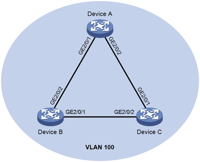

Example: Configuring basic loop detection functions
As shown in Figure 3, configure Device A to shut down a looped port in addition to logging loop events.

The output shows the following information:
· Device A detected loops on GigabitEthernet 2/0/1 and GigabitEthernet 2/0/2 within a loop detection interval.
· Loops on GigabitEthernet 2/0/1 and GigabitEthernet 2/0/2 were removed.
# Use the display loopback-detection command to display the loop detection configuration and status on devices, for example, Device A.
[DeviceA] display loopback-detection
Loop detection is enabled.
Loop detection interval is 35 second(s).
No loopback is detected.
The output shows that the device has removed the loops from GigabitEthernet 2/0/1 and GigabitEthernet 2/0/2.
# Display the status of GigabitEthernet 2/0/1 on devices, for example, Device A.
[DeviceA] display interface gigabitethernet 2/0/1
GigabitEthernet2/0/1 current state: DOWN (Loop detection down)
The output shows that GigabitEthernet 2/0/1 has been shut down by the loop detection module.
# Display the status of GigabitEthernet 2/0/2 on devices, for example, Device A.
[DeviceA] display interface gigabitethernet 2/0/2
GigabitEthernet2/0/2 current state: DOWN (Loop detection down)
The output shows that GigabitEthernet 2/0/2 has been shut down by the loop detection module.
