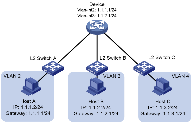

As shown in Figure 2, Host A is in VLAN 2, Host B is in VLAN 3, and Host C is in VLAN 4. For Host A and Host B to communicate with each other, perform the following tasks:
1.     Specify 1.1.1.1/24 and 1.1.2.1/24 as the gateway IP address for Host A and Host B, respectively.
2.     On the device, create VLAN-interface 2 and configure the IP address as 1.1.1.1/24, which is the same as the gateway address of Host A. Create VLAN-interface 3 and configure the IP address as 1.1.2.1/24, which is the same as the gateway address of Host B.
VLAN termination by the outermost VLAN ID of packets is automatically performed on VLAN interfaces. For example, when Host A sends a packet to Host B, VLAN-interface 2 removes the VLAN tag from the packet and forwards it to VLAN-interface 3. Then, VLAN-interface 3 tags the packet with VLAN 3 and Host B can receive the packet.
Because the device does not have a VLAN interface to terminate packets from VLAN 4, Host C cannot communicate with Host A or Host B.
Figure 2 Inter-VLAN communication through VLAN interfaces

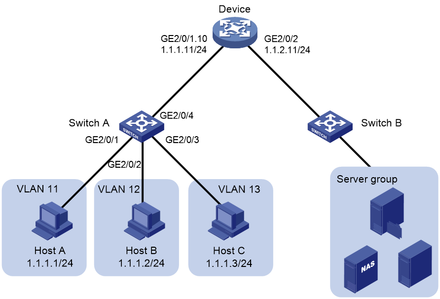

Example: Configuring ambiguous Dot1q termination
As shown in Figure 3, configure ambiguous Dot1q termination so that hosts in different VLANs can communicate with the server group.
Figure 3 Network diagram
In this example, L2 switch B uses the factory configuration.
1.     Configure Host A, Host B, and Host C:
# Assign 1.1.1.1/24, 1.1.1.2/24, and 1.1.1.3/24 to Host A, Host B, and Host C, respectively. (Details not shown.)
# Specify 1.1.1.11/24 as the gateway IP address for the hosts. (Details not shown.)
2.     Configure Layer 2 Switch A:
# Create VLAN 11.
<L2_SwitchA> system-view
[L2_SwitchA] vlan 11
# Assign GigabitEthernet 2/0/1 to VLAN 11.
[L2_SwitchA-vlan11] port gigabitethernet 2/0/1
[L2_SwitchA-vlan11] quit
# Create VLAN 12.
[L2_SwitchA] vlan 12
# Assign GigabitEthernet 2/0/2 to VLAN 12.
[L2_SwitchA-vlan12] port gigabitethernet 2/0/2
[L2_SwitchA-vlan12] quit
# Create VLAN 13.
[L2_SwitchA] vlan 13
# Assign GigabitEthernet 2/0/3 to VLAN 13.
[L2_SwitchA-vlan13] port gigabitethernet 2/0/3
[L2_SwitchA-vlan13] quit
# Configure GigabitEthernet 1/0/7 as a trunk port and assign the port to VLANs 11 through 13.
[L2_SwitchA] interface gigabitethernet 1/0/7
[L2_SwitchA-GigabitEthernet1/0/7] port link-type trunk
[L2_SwitchA-GigabitEthernet1/0/7] port trunk permit vlan 11 to 13
3.     Configure the device:
# Create Ethernet subinterface GigabitEthernet 2/0/1.10 and assign an IP address to the subinterface.
<Device> system-view
[Device] interface gigabitethernet 2/0/1.10
[Device-GigabitEthernet2/0/1.10] ip address 1.1.1.11 255.255.255.0
# Enable Dot1q termination on GigabitEthernet 2/0/1.10 to terminate VLAN-tagged packets whose Layer 1 VLAN IDs are 11, 12, or 13.
[Device-GigabitEthernet2/0/1.10] vlan-type dot1q vid 11 to 13
# Enable GigabitEthernet 2/0/1.10 to transmit broadcasts and multicasts.
[Device-GigabitEthernet2/0/1.10] vlan-termination broadcast enable
[Device-GigabitEthernet2/0/1.10] quit
# Configure an IP address for GigabitEthernet 2/0/2.
[Device] interface gigabitethernet 2/0/2
[Device-GigabitEthernet2/0/2] ip address 1.1.2.11 255.255.255.0
4.     Configure the server group:
# Assign each device in the server group an IP address on network segment 1.1.2.0/24. (Details not shown.)
# Specify 1.1.2.11/24 as the gateway IP address for the server group. (Details not shown.)
# Verify that Host A, Host B, and Host C can ping the device in the server group. (Details not shown.)

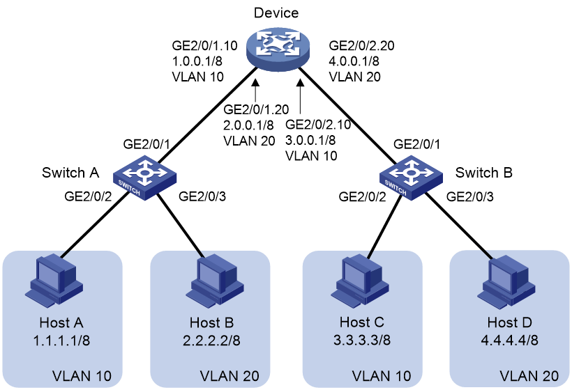

Example: Configuring unambiguous Dot1q termination
As shown in Figure 4, configure unambiguous Dot1q termination on subinterfaces of the device to implement intra-VLAN and inter-VLAN communications between hosts.
Figure 4 Network diagram
1.     Configure Host A, Host B, Host C, and Host D:
# On Host A, specify 1.1.1.1/8 and 1.0.0.1/8 as its IP address and gateway IP address, respectively. (Details not shown.)
# On Host B, specify 2.2.2.2/8 and 2.0.0.1/8 as its IP address and gateway IP address, respectively. (Details not shown.)
# On Host C, specify 3.3.3.3/8 and 3.0.0.1/8 as its IP address and gateway IP address, respectively. (Details not shown.)
# On Host D, specify 4.4.4.4/8 and 4.0.0.1/8 as its IP address and gateway IP address, respectively. (Details not shown.)
# Create VLAN 10.
[L2_SwitchA] vlan 10
# Assign GigabitEthernet 2/0/2 to VLAN 10.
[L2_SwitchA-vlan10] port gigabitethernet 2/0/2
[L2_SwitchA-vlan10] quit
# Create VLAN 20.
[L2_SwitchA] vlan 20
# Assign GigabitEthernet 2/0/3 to VLAN 20.
[L2_SwitchA-vlan20] port gigabitethernet 2/0/3
[L2_SwitchA-vlan20] quit
# Configure GigabitEthernet 2/0/1 as a trunk port, and assign the port to VLANs 10 and 20.
[L2_SwitchA] interface gigabitethernet 2/0/1
[L2_SwitchA-GigabitEthernet2/0/1] port link-type trunk
[L2_SwitchA-GigabitEthernet2/0/1] port trunk permit vlan 10 20
3.     Configure Layer 2 Switch B in the same way you configure Layer 2 Switch A. (Details not shown.)
4.     Configure the device:
# Create GigabitEthernet 2/0/1.10 and assign an IP address to this interface.
[Device-GigabitEthernet2/0/1.10] ip address 1.0.0.1 255.0.0.0
# Configure GigabitEthernet 2/0/1.10 to terminate packets tagged with VLAN 10.
[Device-GigabitEthernet2/0/1.10] vlan-type dot1q vid 10
# Create GigabitEthernet 2/0/1.20 and assign an IP address to this interface.
[Device] interface gigabitethernet 2/0/1.20
[Device-GigabitEthernet2/0/1.20] ip address 2.0.0.1 255.0.0.0
# Configure GigabitEthernet 2/0/1.20 to terminate packets tagged with VLAN 20.
[Device-GigabitEthernet2/0/1.20] vlan-type dot1q vid 20
[Device-GigabitEthernet2/0/1.20] quit
# Configure GigabitEthernet 2/0/1.10 and assign an IP address to this interface.
[Device-GigabitEthernet2/0/1.10] ip address 3.0.0.1 255.0.0.0
# Configure GigabitEthernet 2/0/1.20 and assign an IP address to this interface.
[Device-GigabitEthernet2/0/1.20] ip address 4.0.0.1 255.0.0.0
# Verify that Host A, Host B, Host C, and Host D can ping each other. (Details not shown.)
