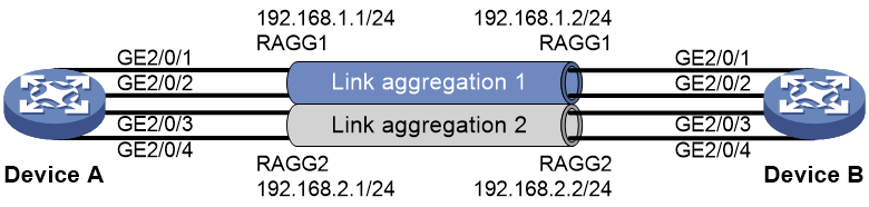

As shown in Figure 1, Device A and Device B are connected by three physical Ethernet links. These physical Ethernet links are combined into an aggregate link called link aggregation 1. The bandwidth of this aggregate link can reach up to the total bandwidth of the three physical Ethernet links. At the same time, the three Ethernet links back up one another. When a physical Ethernet link fails, the traffic transmitted on the failed link is switched to the other two links.
Figure 1 Ethernet link aggregation diagram

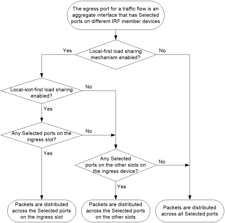

Load sharing modes for link aggregation groups
In a link aggregation group, traffic can be load shared across the Selected ports based on any of the following modes:
· Per-flow load sharing—Distributes traffic on a per-flow basis. The load sharing mode classifies packets into flows and forwards packets of the same flow on the same link. This mode can be one of or a combination of the following traffic classification criteria:
¡ Ingress port.
¡ Source or destination IP.
¡ Source or destination MAC.
¡ Source or destination port number.
¡ MPLS label.
¡ Protocol number.
¡ VLAN tag.
· Bandwidth usage-based load sharing—Distributes a data flow to the Selected port that had the lowest bandwidth usage when the first packet of that data flow arrived. In this mode, each flow is identified by an IP five-tuple (source and destination IP addresses, source and destination ports, and protocol). For packets that do not contain the IP five-tuple, the default load sharing mode applies.
· Per-packet load sharing—Distributes traffic on a per-packet basis. Traffic is distributed across the Selected member ports in proportion to their expected bandwidth, which is configurable with the bandwidth command.

¡ Enabling local-slot-first load sharing for link aggregation
With local-first load sharing enabled, an aggregate interface distributes traffic preferentially across the Selected member ports on the ingress member device. A switching fabric module forwards the traffic between the slots where these Selected member ports are located. If the inter-slot traffic exceeds bandwidth of the switching fabric module, traffic loss occurs.
To eliminate traffic loss, enable local-slot-first load sharing. This feature enables an aggregate interface to distribute traffic preferentially across the Selected member ports on the ingress slot. If the ingress slot does not have Selected member ports, the aggregate interface distributes traffic across all Selected member ports on the ingress member device.
Figure 4 Local-slot-first load sharing for multichassis link aggregation in an IRF fabric
For local-slot-first load sharing to take effect on an aggregate interface, make sure local-first load sharing is enabled on the aggregate interface.
You can configure local-slot-first load sharing globally or on a per-interface basis. An aggregate interface preferentially uses the interface-specific setting. If no interface-specific setting is available, the aggregate interface uses the global setting.
Enabling local-slot-first load sharing for link aggregation globally
1. Enter system view.
2. Enable local-slot-first load sharing for link aggregation globally.
link-aggregation load-sharing mode local-first slot-based
By default, local-slot-first load sharing is enabled globally.
Enabling local-slot-first load sharing for an aggregate interface
2. Enter aggregate interface view.
¡ Enter Layer 2 aggregate interface view.
¡ Enter Layer 3 aggregate interface view.
interface route-aggregation interface-number
3. Enable local-slot-first load sharing on the aggregate interface.
link-aggregation group load-sharing mode local-first slot-based
By default, local-slot-first load sharing is not configured on aggregate interfaces. An aggregate interface uses the global local-slot-first load-sharing setting.

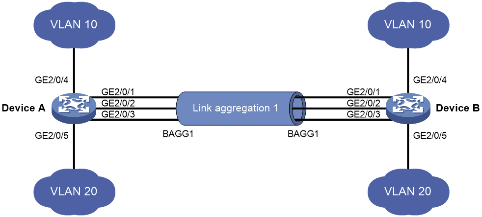

Example: Configuring a Layer 2 static aggregation group
On the network shown in Figure 5, perform the following tasks:
· Configure a Layer 2 static aggregation group on both Device A and Device B.
· Enable VLAN 10 at one end of the aggregate link to communicate with VLAN 10 at the other end.
· Enable VLAN 20 at one end of the aggregate link to communicate with VLAN 20 at the other end.
1. Configure Device A:
# Create VLAN 10, and assign port GigabitEthernet 2/0/4 to VLAN 10.
<DeviceA> system-view
[DeviceA] vlan 10
[DeviceA-vlan10] port gigabitethernet 2/0/4
[DeviceA-vlan10] quit
# Create VLAN 20, and assign port GigabitEthernet 2/0/5 to VLAN 20.
[DeviceA] vlan 20
[DeviceA-vlan20] port gigabitethernet 2/0/5
[DeviceA-vlan20] quit
# Create Layer 2 aggregate interface Bridge-Aggregation 1.
[DeviceA] interface bridge-aggregation 1
[DeviceA-Bridge-Aggregation1] quit
# Assign ports GigabitEthernet 2/0/1 through GigabitEthernet 2/0/3 to link aggregation group 1.
[DeviceA] interface gigabitethernet 2/0/1
[DeviceA-GigabitEthernet2/0/1] port link-aggregation group 1
[DeviceA-GigabitEthernet2/0/1] quit
[DeviceA] interface gigabitethernet 2/0/2
[DeviceA-GigabitEthernet2/0/2] port link-aggregation group 1
[DeviceA-GigabitEthernet2/0/2] quit
[DeviceA] interface gigabitethernet 2/0/3
[DeviceA-GigabitEthernet2/0/3] port link-aggregation group 1
[DeviceA-GigabitEthernet2/0/3] quit
# Configure Layer 2 aggregate interface Bridge-Aggregation 1 as a trunk port and assign it to VLANs 10 and 20.
[DeviceA-Bridge-Aggregation1] port link-type trunk
[DeviceA-Bridge-Aggregation1] port trunk permit vlan 10 20
2. Configure Device B in the same way Device A is configured. (Details not shown.)
# Display detailed information about all aggregation groups on Device A.
[DeviceA] display link-aggregation verbose
Loadsharing Type: Shar -- Loadsharing, NonS -- Non-Loadsharing
Port Status: S -- Selected, U -- Unselected, I -- Individual
Port: A -- Auto port
Flags: A -- LACP_Activity, B -- LACP_Timeout, C -- Aggregation,
G -- Defaulted, H -- Expired
Aggregate Interface: Bridge-Aggregation1
Aggregation Mode: Static
Port Status Priority Oper-Key
GE2/0/1 S 32768 1
GE2/0/2 S 32768 1
GE2/0/3 S 32768 1
The output shows that link aggregation group 1 is a Layer 2 static aggregation group that contains three Selected ports.
Example: Configuring a Layer 2 dynamic aggregation group
On the network shown in Figure 6, perform the following tasks:
· Configure a Layer 2 dynamic aggregation group on both Device A and Device B.
# Create VLAN 10, and assign the port GigabitEthernet 2/0/4 to VLAN 10.
[DeviceA] vlan 10
# Create VLAN 20, and assign the port GigabitEthernet 2/0/5 to VLAN 20.
[DeviceA] vlan 20
# Create Layer 2 aggregate interface Bridge-Aggregation 1, and set the link aggregation mode to dynamic.
[DeviceA-Bridge-Aggregation1] link-aggregation mode dynamic
Creation Mode: Manual
Aggregation Mode: Dynamic
System ID: 0x8000, 000f-e267-6c6a
Local:
Port Status Priority Oper-Key Flag
GE1/0/1 S 32768 1 {ACDEF}
GE1/0/2 S 32768 1 {ACDEF}
GE1/0/3 S 32768 1 {ACDEF}
Remote:
Actor Partner Priority Oper-Key SystemID Flag
GE1/0/1 1 32768 1 0x8000, 000f-e267-57ad {ACDEF}
GE1/0/2 2 32768 1 0x8000, 000f-e267-57ad {ACDEF}
GE1/0/3 3 32768 1 0x8000, 000f-e267-57ad {ACDEF}
The output shows that link aggregation group 1 is a Layer 2 dynamic aggregation group that contains three Selected ports.

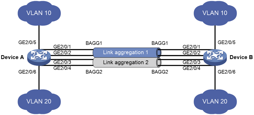

Example: Configuring Layer 2 aggregation load sharing
On the network shown in Figure 7, perform the following tasks:
· Configure Layer 2 static aggregation groups 1 and 2 on Device A and Device B, respectively.
· Configure link aggregation groups 1 and 2 to load share traffic across aggregation group member ports.
¡ Configure link aggregation group 1 to load share packets based on source MAC addresses.
¡ Configure link aggregation group 2 to load share packets based on destination MAC addresses.
# Create VLAN 10, and assign the port GigabitEthernet 2/0/5 to VLAN 10.
[DeviceA] vlan 10
[DeviceA-vlan10] port gigabitethernet 2/0/5
# Create VLAN 20, and assign the port GigabitEthernet 2/0/6 to VLAN 20.
[DeviceA] vlan 20
[DeviceA-vlan20] port gigabitethernet 2/0/6
# Configure Layer 2 aggregation group 1 to load share packets based on source MAC addresses.
[DeviceA-Bridge-Aggregation1] link-aggregation load-sharing mode source-mac
# Assign ports GigabitEthernet 2/0/1 and GigabitEthernet 2/0/2 to link aggregation group 1.
# Configure Layer 2 aggregate interface Bridge-Aggregation 1 as a trunk port and assign it to VLAN 10.
# Create Layer 2 aggregate interface Bridge-Aggregation 2.
[DeviceA] interface bridge-aggregation 2
# Configure Layer 2 aggregation group 2 to load share packets based on destination MAC addresses.
[DeviceA-Bridge-Aggregation2] link-aggregation load-sharing mode destination-mac
[DeviceA-Bridge-Aggregation2] quit
# Assign ports GigabitEthernet 2/0/3 and GigabitEthernet 2/0/4 to link aggregation group 2.
[DeviceA-GigabitEthernet2/0/3] port link-aggregation group 2
[DeviceA] interface gigabitethernet 2/0/4
[DeviceA-GigabitEthernet2/0/4] port link-aggregation group 2
[DeviceA-GigabitEthernet2/0/4] quit
# Configure Layer 2 aggregate interface Bridge-Aggregation 2 as a trunk port and assign it to VLAN 20.
[DeviceA-Bridge-Aggregation2] port link-type trunk
[DeviceA-Bridge-Aggregation2] port trunk permit vlan 20
