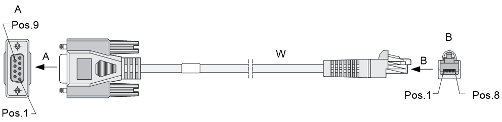

Console cable
RJ-45 to DB9 console cable
An RJ-45 to DB9 console cable is used to connect the console port on the firewall to the serial port on a configuration terminal (a PC for example):
·     Connect the DB9 female connector of the cable to the 8-core serial port on the configuration terminal.
·     Connect the RJ-45 connector of the cable to the console port on the firewall.
Figure1-1 RJ-45 to DB9 console cable
Table1-1 RJ-45 to DB9 console cable pinouts
RJ-45
Signal
Direction
DB-9
1
RTS
7
2
DTR
4
3
TXD
3
4
CD
1
5
GND
5
6
RXD
2
7
DSR
6
8
CTS
8

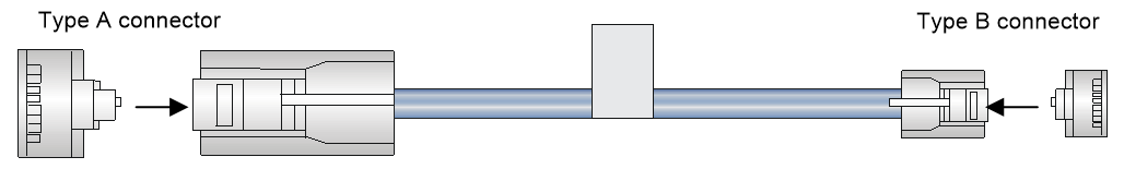

Micro USB console cable
A micro USB console cable is used to connect the micro USB console port on the firewall to the USB port on a configuration terminal (a PC for example):
·     Connect the USB Type A connector of the cable to the USB port on the configuration terminal.
·     Connect the USB Type mini-A/B connector to the micro USB console port on the firewall.
Figure1-2 Micro USB console cable
Table1-2 Micro USB console cable pinouts
Signal
Signal
1
VBUS
1
VBUS
2
D-
2
D-
3
D+
3
D+
4
ID(NC)
4
GND
5
GND

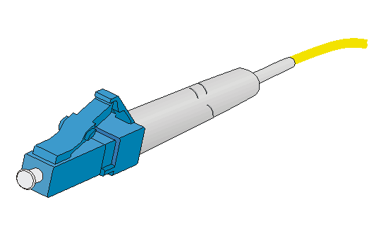

Fiber connectors are indispensable passive components in an optical fiber communication system. They allow the removable connection between optical channels, which makes the optical system debugging and maintenance more convenient. There are multiple types of fiber connectors. Figure1-6 shows an LC connector.
Figure1-6 Appearance of an LC connector
Follow these guidelines when you connect an optical fiber:
·     Before connecting an optical fiber, make sure the connector and cable type match the interface module.
·     The fiber Ethernet port of the firewall supports only the LC connector.
·     Fiber connectors are fitted with dust caps. Keep the dust caps secure when the fiber connectors are in use. Install dust caps when the fiber connectors are not in use to avoid damage to their end face. Replace the dust cap if it is loose or polluted.
·     Before connecting an optical fiber, use dust free paper and absolute alcohol to clean the end face of the two fiber connectors. You can brush the end faces only in one direction.
·     Never bend or curve a fiber when connecting it.
·     If the fiber has to pass through a metallic board hole, when passing through a metallic board hole or bending along the acute side of mechanical parts, the fiber must wear jackets or cushions.
