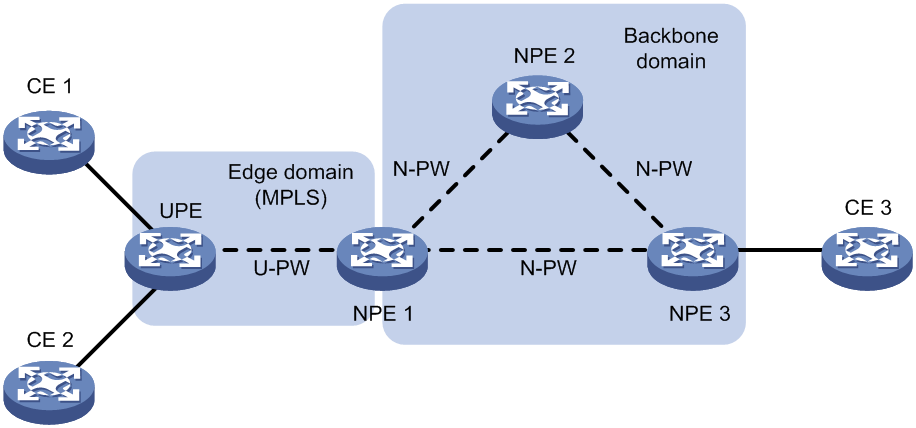

H-VPLS
VPLS requires a full mesh of PWs among all PEs in a VPLS instance. In a large-scale network, however, a full mesh of PWs causes very high PW signaling overhead and brings difficulties for network management and expansion. Hierarchical VPLS (H-VPLS) reduces the number of PWs by dividing a VPLS network into a backbone domain and edge domains.
Only static PWs and LDP PWs support H-VPLS.
In H-VPLS:
·     An edge domain provides access for a user network to the backbone domain.
·     The Network Provider Edge (NPE) devices are fully meshed in the backbone domain. A PW between NPEs is referred to as an N-PW.
·     A User facing-Provider Edge (UPE) device only establishes a PW with the neighboring NPE. A PW between a UPE and an NPE is referred to as a U-PW.
H-VPLS access modes
H-VPLS supports the following access modes:
·     MPLS access mode
As shown in Figure 3, the edge domain is an MPLS network. The UPE creates a U-PW with NPE 1. The UPE does not create PWs to any remote PEs. After receiving a packet from a CE, the UPE adds the label assigned to the U-PW into the packet and forwards the packet to NPE 1 through a public tunnel. NPE 1 maps the packet to the VSI that corresponds to the PW label, and searches the MAC address table of the VSI to forward the packet.
Figure 3 H-VPLS using MPLS access
A U-PW created on the NPE must have split horizon disabled because the NPE needs to forward packets between U-PW and N-PW.
·     Ethernet access mode
As shown in Figure 4, the edge domain is an Ethernet network. The UPE and NPE 1 establish a point-to-point Ethernet QinQ connection in between. After the UPE receives a packet from a CE, it adds an outer VLAN tag into the packet and forwards the packet to NPE 1. NPE 1 regards the outer VLAN tag as the service provider VLAN tag. It maps the packet to the VSI that corresponds to the VLAN tag and then searches the MAC address table of the VSI to forward the packet.
Figure 4 H-VPLS using Ethernet access

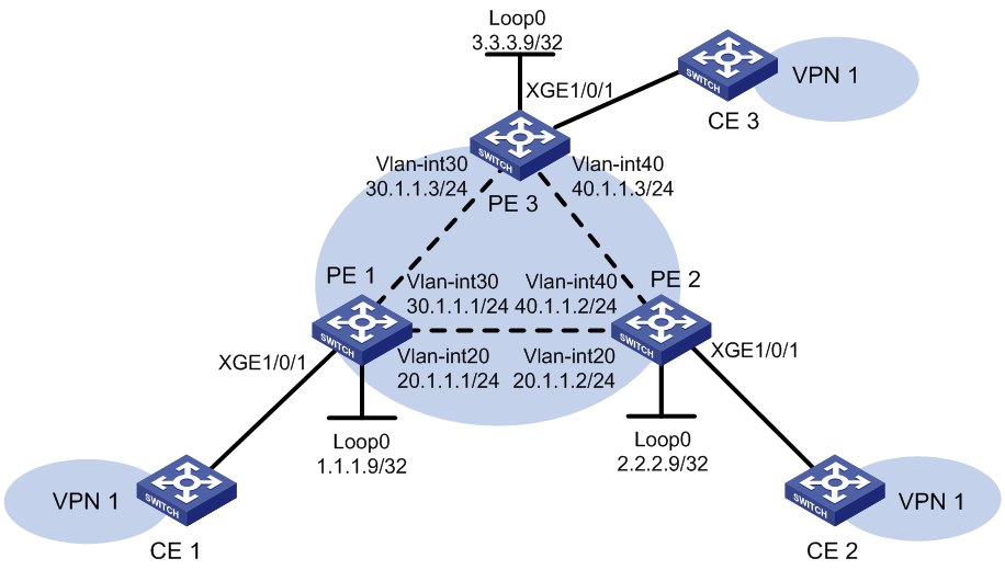

VPLS configuration examples
Example: Configuring static PWs
Configure a VSI on each PE, and establish static PWs between the PEs to interconnect the CEs.
Configure an Ethernet service instance on Ten-GigabitEthernet 1/0/1 to match packets with an outer VLAN ID of 100 on each PE. Bind the Ethernet service instance to the VSI to forward the matching packets through the VSI.
Figure 5 Network diagram
1.     Disable the spanning tree feature globally or map each VLAN to an MSTI. (Details not shown.)
For more information, see spanning tree in Layer 2—LAN Switching Configuration Guide.
2.     Configure PE 1:

[PE2] mpls lsr-id 2.2.2.9
# Enable L2VPN.
[PE2] l2vpn enable
# Enable global LDP.
[PE2] mpls ldp
[PE2-ldp] quit
# Configure VLAN-interface 20 (the interface connected to PE 1), and enable LDP on the interface.
[PE2] interface vlan-interface 20
[PE2-Vlan-interface20] ip address 20.1.1.2 24
[PE2-Vlan-interface20] mpls enable
[PE2-Vlan-interface20] mpls ldp enable
[PE2-Vlan-interface20] quit
# Configure VLAN-interface 40 (the interface connected to PE 3), and enable LDP on the interface.
[PE2] interface vlan-interface 40
[PE2-Vlan-interface40] ip address 40.1.1.2 24
[PE2-Vlan-interface40] mpls enable
[PE2-Vlan-interface40] mpls ldp enable
[PE2-Vlan-interface40] quit
# Configure OSPF for LDP to create LSPs.
[PE2] ospf
[PE2-ospf-1] area 0
[PE2-ospf-1-area-0.0.0.0] network 20.1.1.0 0.0.0.255
[PE2-ospf-1-area-0.0.0.0] network 40.1.1.0 0.0.0.255
[PE2-ospf-1-area-0.0.0.0] network 2.2.2.9 0.0.0.0
[PE2-ospf-1-area-0.0.0.0] quit
[PE2-ospf-1] quit
# Create a VSI, specify the peer PEs, and establish static PWs to the peer PEs.
[PE2] vsi svc
[PE2-vsi-svc] pwsignaling static
[PE2-vsi-svc-static] peer 1.1.1.9 pw-id 3 in-label 100 out-label 100
[PE2-vsi-svc-static-1.1.1.9-3] quit
[PE2-vsi-svc-static] peer 3.3.3.9 pw-id 3 in-label 300 out-label 300
[PE2-vsi-svc-static-3.3.3.9-3] quit
[PE2-vsi-svc-static] quit
[PE2-vsi-svc] quit
# Create Ethernet service instance 10 on Ten-GigabitEthernet 1/0/1 to match packets with an outer VLAN ID of 100, and bind the Ethernet service instance to the VSI svc.
[PE2] interface ten-gigabitethernet 1/0/1
[PE2-Ten-GigabitEthernet1/0/1] service-instance 10
[PE2-Ten-GigabitEthernet1/0/1-srv10] encapsulation s-vid 100
[PE2-Ten-GigabitEthernet1/0/1-srv10] xconnect vsi svc
4.     Configure PE 3:
# Configure an LSR ID.
<PE3> system-view
[PE3] interface loopback 0
[PE3-LoopBack0] ip address 3.3.3.9 32
[PE3-LoopBack0] quit
[PE3] mpls lsr-id 3.3.3.9
# Enable L2VPN.
[PE3] l2vpn enable
[PE3] mpls ldp
[PE3-ldp] quit
# Configure VLAN-interface 30 (the interface connected to PE 1), and enable LDP on the interface.
[PE3] interface vlan-interface 30
[PE3-Vlan-interface30] ip address 30.1.1.3 24
[PE3-Vlan-interface30] mpls enable
[PE3-Vlan-interface30] mpls ldp enable
[PE3-Vlan-interface30] quit
# Configure VLAN-interface 40 (the interface connected to PE 2), and enable LDP on the interface.
[PE3] interface vlan-interface 40
[PE3-Vlan-interface40] ip address 40.1.1.3 24
[PE3-Vlan-interface40] mpls enable
[PE3-Vlan-interface40] mpls ldp enable
[PE3-Vlan-interface40] quit
[PE3] ospf
[PE3-ospf-1] area 0
[PE3-ospf-1-area-0.0.0.0] network 30.1.1.0 0.0.0.255
[PE3-ospf-1-area-0.0.0.0] network 40.1.1.0 0.0.0.255
[PE3-ospf-1-area-0.0.0.0] network 3.3.3.9 0.0.0.0
[PE3-ospf-1-area-0.0.0.0] quit
[PE3-ospf-1] quit
[PE3] vsi svc
[PE3-vsi-svc] pwsignaling static
[PE3-vsi-svc-static] peer 1.1.1.9 pw-id 3 in-label 200 out-label 200
[PE3-vsi-svc-static-1.1.1.9-3] quit
[PE3-vsi-svc-static] peer 2.2.2.9 pw-id 3 in-label 300 out-label 300
[PE3-vsi-svc-static-2.2.2.9-3] quit
[PE3-vsi-svc-static] quit
[PE3-vsi-svc] quit
[PE3] interface ten-gigabitethernet 1/0/1
[PE3-Ten-GigabitEthernet1/0/1] service-instance 10
[PE3-Ten-GigabitEthernet1/0/1-srv10] encapsulation s-vid 100
[PE3-Ten-GigabitEthernet1/0/1-srv10] xconnect vsi svc
# Verify that two static PWs in up state have been established on PE 1.
[PE1] display l2vpn pw verbose
VSI Name: svc
  Peer: 2.2.2.9          PW ID: 3
    Signaling Protocol  : Static
    Link ID             : 8          PW State : Up
    In Label            : 100        Out Label: 100
    MTU                 : 1500
    PW Attributes       : Main
    VCCV CC             : -
    VCCV BFD            : -
    Flow Label          : -
    Tunnel Group ID     : 0x160000001
    Tunnel NHLFE IDs    : 1027
    Admin PW            : -
  Peer: 3.3.3.9          PW ID: 3
    Link ID             : 9          PW State : Up
    In Label            : 200        Out Label: 200
    MTU                 : 1500
    VCCV CC             : -
    VCCV BFD            : -
    Flow Label          : -
    Tunnel Group ID     : 0x260000002
    Tunnel NHLFE IDs    : 1028
    Admin PW            : -

Example: Configuring BGP auto-discovery LDP PWs
Configure a VSI on each PE. Use BGP to discover remote PEs and use LDP to create PWs among PEs so CEs in different sites of VPN 1 can communicate with each other.
Figure 8 Network diagram
2.     Configure an IGP and public tunnels on each PE. (Details not shown.)
3.     Configure PE 1:
# Configure basic MPLS.
<PE1> system-view
[PE1] interface loopback 0
[PE1-LoopBack0] ip address 1.1.1.9 32
[PE1-LoopBack0] quit
[PE1] mpls lsr-id 1.1.1.9
[PE1] mpls ldp
[PE1-ldp] quit
# Establish IBGP connections to PE 1 and PE 2, and use BGP to advertise VPLS PE information.
[PE1] bgp 100
[PE1-bgp-default] peer 2.2.2.9 as-number 100
[PE1-bgp-default] peer 2.2.2.9 connect-interface loopback 0
[PE1-bgp-default] peer 3.3.3.9 as-number 100
[PE1-bgp-default] peer 3.3.3.9 connect-interface loopback 0
[PE1-bgp-default] address-family l2vpn
[PE1-bgp-default-l2vpn] peer 2.2.2.9 enable
[PE1-bgp-default-l2vpn] peer 3.3.3.9 enable
[PE1-bgp-default-l2vpn] quit
[PE1-bgp-default] quit
# Enable L2VPN.
[PE1] l2vpn enable
# Configure VSI aaa to use BGP to discover remote PEs and use LDP to establish LDP PWs to PE 2 and PE 3.
[PE1] vsi aaa
[PE1-vsi-aaa] auto-discovery bgp
[PE1-vsi-aaa-auto] route-distinguisher 1:1
[PE1-vsi-aaa-auto] vpn-target 1:1
[PE1-vsi-aaa-auto] signaling-protocol ldp
[PE1-vsi-aaa-auto-ldp] vpls-id 100:100
[PE1-vsi-aaa-auto-ldp] quit
[PE1-vsi-aaa-auto] quit
[PE1-vsi-aaa] quit
# Create Ethernet service instance 10 on Ten-GigabitEthernet 1/0/1 to match packets with an outer VLAN ID of 100, and bind the Ethernet service instance to the VSI aaa.
[PE1] interface ten-gigabitethernet 1/0/1
[PE1-Ten-GigabitEthernet1/0/1] service-instance 10
[PE1-Ten-GigabitEthernet1/0/1-srv10] encapsulation s-vid 100
[PE1-Ten-GigabitEthernet1/0/1-srv10] xconnect vsi aaa
4.     Configure PE 2:
<PE2> system-view
[PE2] interface loopback 0
[PE2-LoopBack0] ip address 2.2.2.9 32
[PE2-LoopBack0] quit
[PE2] mpls ldp
[PE2-ldp] quit
# Establish IBGP connections to PE 1 and PE 3, and use BGP to advertise VPLS PE information.
[PE2] bgp 100
[PE2-bgp-default] peer 1.1.1.9 as-number 100
[PE2-bgp-default] peer 1.1.1.9 connect-interface loopback 0
[PE2-bgp-default] peer 3.3.3.9 as-number 100
[PE2-bgp-default] peer 3.3.3.9 connect-interface loopback 0
[PE2-bgp-default] address-family l2vpn
[PE2-bgp-default-l2vpn] peer 1.1.1.9 enable
[PE2-bgp-default-l2vpn] peer 3.3.3.9 enable
[PE2-bgp-default-l2vpn] quit
[PE2-bgp-default] quit
# Enable L2VPN.
[PE2] l2vpn enable
# Configure VSI aaa to use BGP to discover remote PEs and use LDP to establish LDP PWs to PE 1 and PE 3.
[PE2] vsi aaa
[PE2-vsi-aaa] auto-discovery bgp
[PE2-vsi-aaa-auto] route-distinguisher 1:1
[PE2-vsi-aaa-auto] vpn-target 1:1
[PE2-vsi-aaa-auto] signaling-protocol ldp
[PE2-vsi-aaa-auto-ldp] vpls-id 100:100
[PE2-vsi-aaa-auto-ldp] quit
[PE2-vsi-aaa-auto] quit
[PE2-vsi-aaa] quit
[PE2-Ten-GigabitEthernet1/0/1-srv10] xconnect vsi aaa
5.     Configure PE 3:
<PE3> system-view
[PE3] mpls ldp
[PE3-ldp] quit
[PE3] bgp 100
[PE3-bgp-default] peer 1.1.1.9 as-number 100
[PE3-bgp-default] peer 1.1.1.9 connect-interface loopback 0
[PE3-bgp-default] peer 2.2.2.9 as-number 100
[PE3-bgp-default] peer 2.2.2.9 connect-interface loopback 0
[PE3-bgp-default] address-family l2vpn
[PE3-bgp-default-l2vpn] peer 1.1.1.9 enable
[PE3-bgp-default-l2vpn] peer 2.2.2.9 enable
[PE3-bgp-default-l2vpn] quit
[PE3-bgp-default] quit
# Enable L2VPN.
[PE3] l2vpn enable
# Configure VSI aaa to use BGP to discover remote PEs and use LDP to establish LDP PWs to PE 1 and PE 2.
[PE3] vsi aaa
[PE3-vsi-aaa] auto-discovery bgp
[PE3-vsi-aaa-auto] route-distinguisher 1:1
[PE3-vsi-aaa-auto] vpn-target 1:1
[PE3-vsi-aaa-auto] signaling-protocol ldp
[PE3-vsi-aaa-auto-ldp] vpls-id 100:100
[PE3-vsi-aaa-auto-ldp] quit
[PE3-vsi-aaa-auto] quit
[PE3-vsi-aaa] quit
[PE3-Ten-GigabitEthernet1/0/1-srv10] xconnect vsi aaa

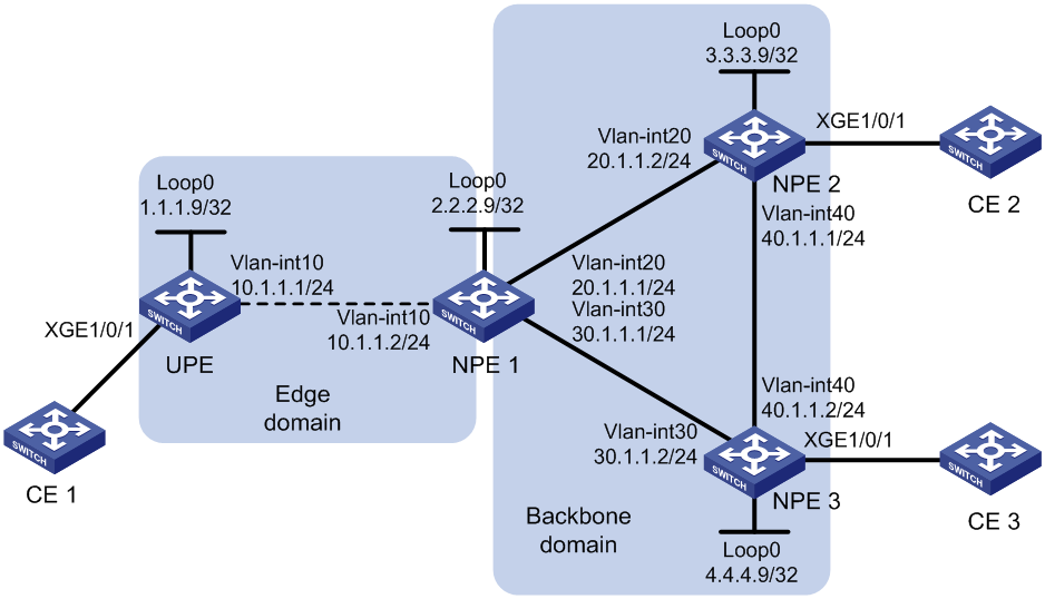

Example: Configuring H-VPLS using MPLS access
Configure an H-VPLS network using MPLS access to avoid full-mesh PW configuration. The H-VPLS uses LDP as the PW signaling protocol.
Figure 9 Network diagram
3.     Configure UPE:
<UPE> system-view
[UPE] interface loopback 0
[UPE-LoopBack0] ip address 1.1.1.9 32
[UPE-LoopBack0] quit
[UPE] mpls lsr-id 1.1.1.9
[UPE] mpls ldp
[UPE-ldp] quit
# Enable L2VPN.
[UPE] l2vpn enable
# Configure VSI aaa to use LDP to establish a U-PW to NPE 1.
[UPE] vsi aaa
[UPE-vsi-aaa] pwsignaling ldp
[UPE-vsi-aaa-ldp] peer 2.2.2.9 pw-id 500
[UPE-vsi-aaa-ldp-2.2.2.9-500] quit
[UPE-vsi-aaa-ldp] quit
[UPE-vsi-aaa] quit
[UPE] interface ten-gigabitethernet 1/0/1
[UPE-Ten-GigabitEthernet1/0/1] service-instance 10
[UPE-Ten-GigabitEthernet1/0/1-srv10] encapsulation s-vid 100
[UPE-Ten-GigabitEthernet1/0/1-srv10] xconnect vsi aaa
4.     Configure NPE 1:
<NPE1> system-view
[NPE1] interface loopback 0
[NPE1-LoopBack0] ip address 2.2.2.9 32
[NPE1-LoopBack0] quit
[NPE1] mpls lsr-id 2.2.2.9
[NPE1] mpls ldp
[NPE1–ldp] quit
# Enable L2VPN.
[NPE1] l2vpn enable
# Configure VSI aaa that uses LDP as the PW signaling protocol, establish a U-PW to the UPE, and establish N-PWs to NPE 2 and NPE 3.
[NPE1] vsi aaa
[NPE1-vsi-aaa] pwsignaling ldp
[NPE1-vsi-aaa-ldp] peer 1.1.1.9 pw-id 500 no-split-horizon
[NPE1-vsi-aaa-ldp-1.1.1.9-500] quit
[NPE1-vsi-aaa-ldp] peer 3.3.3.9 pw-id 500
[NPE1-vsi-aaa-ldp-3.3.3.9-500] quit
[NPE1-vsi-aaa-ldp] peer 4.4.4.9 pw-id 500
[NPE1-vsi-aaa-ldp-4.4.4.9-500] quit
[NPE1-vsi-aaa-ldp] quit
[NPE1-vsi-aaa] quit
5.     Configure NPE 2:
<NPE2> system-view
[NPE2] interface loopback 0
[NPE2-LoopBack0] ip address 3.3.3.9 32
[NPE2-LoopBack0] quit
[NPE2] mpls lsr-id 3.3.3.9
[NPE2] mpls ldp
[NPE2–ldp] quit
# Enable L2VPN.
[NPE2] l2vpn enable
# Configure VSI aaa that uses LDP as the PW signaling protocol, and establish N-PWs to NPE 1 and NPE 3.
[NPE2] vsi aaa
[NPE2-vsi-aaa] pwsignal ldp
[NPE2-vsi-aaa-ldp] peer 2.2.2.9 pw-id 500
[NPE2-vsi-aaa-ldp-2.2.2.9-500] quit
[NPE2-vsi-aaa-ldp] peer 4.4.4.9 pw-id 500
[NPE2-vsi-aaa-ldp-4.4.4.9-500] quit
[NPE2-vsi-aaa-ldp] quit
[NPE2-vsi-aaa] quit
[NPE2] interface ten-gigabitethernet 1/0/1
[NPE2-Ten-GigabitEthernet1/0/1] service-instance 10
[NPE2-Ten-GigabitEthernet1/0/1-srv10] encapsulation s-vid 100
[NPE2-Ten-GigabitEthernet1/0/1-srv10] xconnect vsi aaa
[NPE2-Ten-GigabitEthernet1/0/1-srv10] quit
[NPE2-Ten-GigabitEthernet1/0/1] quit
6.     Configure NPE 3:
<NPE3> system-view
[NPE3] interface loopback 0
[NPE3-LoopBack0] ip address 4.4.4.9 32
[NPE3-LoopBack0] quit
[NPE3] mpls lsr-id 4.4.4.9
[NPE3] mpls ldp
[NPE3–ldp] quit
# Enable L2VPN.
[NPE3] l2vpn enable
# Configure VSI aaa that uses LDP as the PW signaling protocol, and establish N-PWs to NPE 1 and NPE 2.
[NPE3] vsi aaa
[NPE3-vsi-aaa] pwsignal ldp
[NPE3-vsi-aaa-ldp] peer 2.2.2.9 pw-id 500
[NPE3-vsi-aaa-ldp-2.2.2.9-500] quit
[NPE3-vsi-aaa-ldp] peer 3.3.3.9 pw-id 500
[NPE3-vsi-aaa-ldp-3.3.3.9-500] quit
[NPE3-vsi-aaa-ldp] quit
[NPE3-vsi-aaa] quit
[NPE3] interface ten-gigabitethernet 1/0/1
[NPE3-Ten-GigabitEthernet1/0/1] service-instance 10
[NPE3-Ten-GigabitEthernet1/0/1-srv10] encapsulation s-vid 100
[NPE3-Ten-GigabitEthernet1/0/1-srv10] xconnect vsi aaa
[NPE3-Ten-GigabitEthernet1/0/1-srv10] quit
[NPE3-Ten-GigabitEthernet1/0/1] quit
# Verify that PWs in up state have been established on each PE.
[UPE] display l2vpn pw verbose
VSI Name: aaa
  Peer: 2.2.2.9          PW ID: 500
    Signaling Protocol  : LDP
    In Label            : 1277       Out Label: 1277
    MTU                 : 1500

[NPE1] display l2vpn pw verbose
VSI Name: aaa
  Peer: 1.1.1.9          PW ID: 500
    MTU                 : 1500
    PW Attributes       : Main, No-split-horizon
    VCCV CC             : -
    VCCV BFD            : -
    Flow Label          : -
    Tunnel Group ID     : 0x460000000
    Tunnel NHLFE IDs    : 1030
    Admin PW            : -
  Peer: 3.3.3.9          PW ID: 500
    In Label            : 1276       Out Label: 1275
    MTU                 : 1500
    VCCV CC             : -
    VCCV BFD            : -
    Flow Label          : -
    Tunnel Group ID     : 0x560000001
    Tunnel NHLFE IDs    : 1031
    Admin PW            : -
  Peer: 4.4.4.9          PW ID: 500
    Link ID             : 10          PW State : Up
    In Label            : 1278       Out Label: 1279
    MTU                 : 1500
    VCCV CC             : -
    VCCV BFD            : -
    Flow Label          : -
    Tunnel Group ID     : 0x570000001
    Tunnel NHLFE IDs    : 1032
    Admin PW            : -
[NPE2] display l2vpn pw verbose
VSI Name: aaa
    In Label            : 1275       Out Label: 1276
    MTU                 : 1500
    VCCV CC             : -
    VCCV BFD            : -
    Flow Label          : -
    Tunnel Group ID     : 0x660000000
    Admin PW            : -
    MTU                 : 1500
    VCCV CC             : -
    VCCV BFD            : -
    Flow Label          : -
    Tunnel Group ID     : 0x670000000
    Admin PW            : -
[NPE3] display l2vpn pw verbose
VSI Name: aaa
    In Label            : 1279       Out Label: 1278
    MTU                 : 1500
    VCCV CC             : -
    VCCV BFD            : -
    Flow Label          : -
    Admin PW            : -
    MTU                 : 1500
    VCCV CC             : -
    VCCV BFD            : -
    Flow Label          : -
    Admin PW            : -
