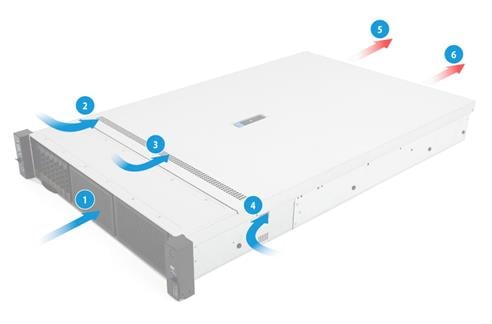

Airflow direction of the server
Figure 2 Airflow direction of the server
(1) to (4) Directions of the airflow into the chassis and power supplies |
(5) Direction of the airflow out of the power supplies |
(6) Direction of the airflow out of the chassis |

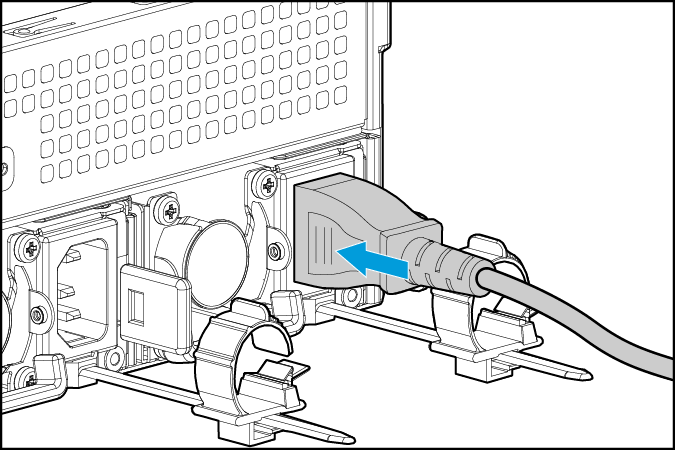

1. Insert the power cord plug into the power receptacle of a power supply at the rear panel, as shown in Figure 8.
Figure 8 Connecting the power cord
2. Connect the other end of the power cord to the power source, for example, the power strip on the rack.
3. Secure the power cord to avoid unexpected disconnection of the power cord.
Multiple types of wire fasteners can be used for securing the power cord. In this procedure, a cable clamp is used.
a. If the cable clamp is positioned too near the power cord that it blocks the power cord plug connection, press down the tab on the cable mount and slide the clip backward.
Figure 9 Sliding the cable clamp backward
b. Open the cable clamp, place the power cord through the opening in the cable clamp, and then close the cable clamp, as shown by callouts 1, 2, 3, and 4 in Figure 10.
Figure 10 Securing the AC power cord
c. Slide the cable clamp forward until it is flush against the edge of the power cord plug, as shown in Figure 11.
Figure 11 Sliding the cable clamp forward

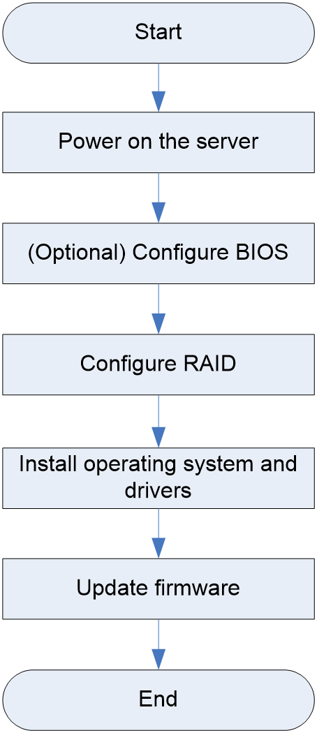

Configuration flowchart
Figure 14 Configuration flowchart
Powering on the server
1. Power on the server. For information about the procedures, see "Powering on the server."
2. Verify that the health LED on the front panel is steady green, which indicates that the system is operating correctly. For more information about the health LED status, see "LEDs and buttons."

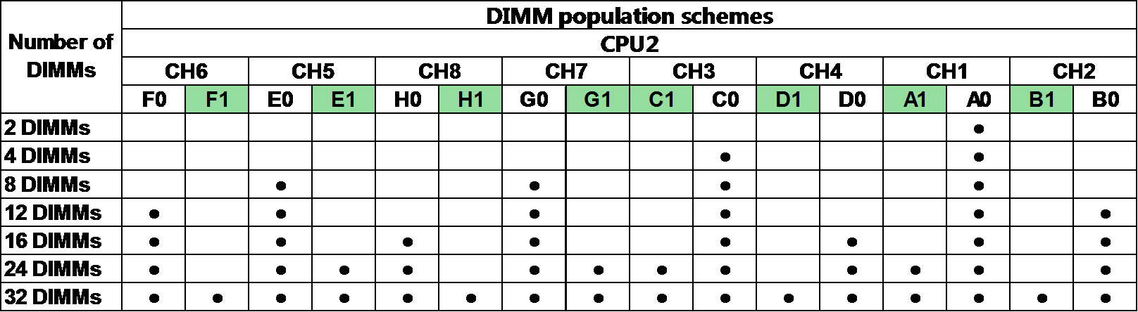

Guidelines for installing only DDR4 DIMMs
When you install only DDR4 DIMMs, follow these restrictions and guidelines:
· Make sure their corresponding processors are present before powering on the server.
· Make sure all DDR4 DIMMs installed on the server have the same product code.
· For the configured memory mode to take effect, make sure the following installation requirements are met:
Memory mode |
DIMM population requirements |
Independent |
· If one processor is present, see Figure 15. · If two processors are present, see Figure 16 and Figure 17. |
Mirror |
· A minimum of two DIMMs for a processor. · Strictly follow the DIMM installation schemes recommended for installing a minimum of two DIMMs per processor. ¡ If one processor is present, see Figure 15. ¡ If two processors are present, see Figure 16 and Figure 17. |
NOTE: · If the DIMM configuration does not meet the requirements for the configured memory mode, the system uses the default memory mode (Independent mode). · In Figure 15, Figure 16, and Figure 17, the black DIMM slots (for example, the F1 slot) are grey colored, and the white DIMM slots (for example, the F0 slot) are not colored. |
Figure 15 DDR4-only DIMM population schemes for one processor
Figure 16 DDR4-only DIMM population schemes for two processors (1)
Figure 17 DDR4-only DIMM population schemes for two processors (2)

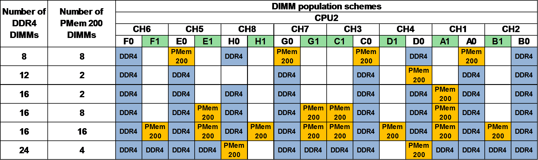

Guidelines for installing a mixture of PMem 200 and DDR4 DIMMs
When you install PMem 200 and DDR4 DIMMs on the server, follow these restrictions and guidelines:
· Make sure the PMem 200 DIMMs have never been used on any other products. If they have been used on any other products, they might be unusable on the server.
· Make sure all DDR4 DIMMs have the same product code and all PMem DIMMs have the same product code.
· Depending on the processor and DIMM configuration, use the schemes shown in Figure 18, Figure 19, and Figure 20 to populate the DIMM slots.
NOTE: In Figure 18, Figure 19, and Figure 20, the black DIMM slots (for example, the B1 slot) are grey colored, and the white DIMM slots (for example, the B0 slot) are not colored. |
If one processor is present, populate DIMMs as shown in Figure 18.
Figure 18 Mixed DDR4 and PMem DIMM population schemes for one processor
If two processors are present, populate DIMMs as shown in Figure 19 or Figure 20.
Figure 19 Mixed DDR4 and PMem DIMM population schemes for two processors (1)
Figure 20 Mixed DDR4 and PMem DIMM population schemes for two processors (1)

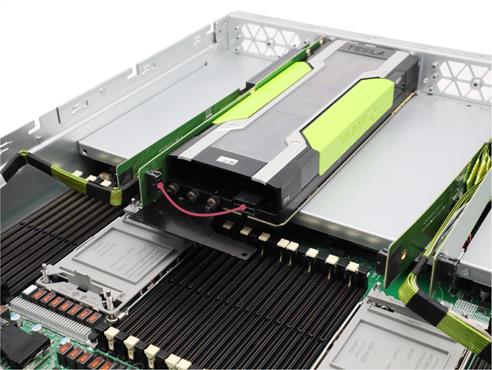

Replacing a GPU module
Guidelines
· When you install dual-width FHFL GPUs, use Table 10 to select slots and follow these restrictions and guidelines:
¡ Install the GPUs in X16 PCIe slots.
¡ If you are installing three or fewer GPUs, you must install them on riser cards.
¡ If you are installing four GPUs, you must also install a rear 4GPU module.
· When you install dual-width FHFL GPUs, use Table 11 to select slots and follow these restrictions and guidelines:
¡ If you are installing three or fewer GPUs, install one GPU on each riser card.
¡ If you are installing more than four GPUs, use two RC-3FHFL-2U-SW-G5 riser cards, one for two GPUs.
· When you install single-width HHHL GPUs, use Table 12 to select slots and follow these restrictions and guidelines:
¡ If you are installing eight or more GPUs, you can use X8 PCIe slots. In any other cases, you must install the GPUs in X16 PCIe slots.
¡ If you are installing more than 10 GPUs, you must also use a mid GPU adapter.
Table 10 Recommended slots for dual-width FHFL GPUs
Number of GPUs |
Recommended slots |
1 |
slot 5 |
2 |
slot 2/5 |
3 |
slot 2/5/7 |
4 |
slot 11/12/13/14 |
Table 11 Recommended slots for single-width FHFL GPUs
Number of GPUs |
Recommended slots |
1 |
slot 5 |
2 |
slot 2/5 |
3 |
slot 2/5/7 |
4 |
slot 1/2/4/5 |
5 |
slot 1/2/4/5/7 |
Table 12 Recommended slots for HHHL GPUs
Number of GPUs |
Recommended slots |
1 |
slot 5 |
2 |
slot 2/5 |
3 |
slot 2/5/7 |
4 |
slot 2/3/5/6 |
5 |
slot 2/3/4/5/6 |
6 |
slot 1/2/3/4/5/6 |
7 |
slot 1/2/3/4/5/6/7 |
8 |
slot 1/2/3/4/5/6/7/8 |
9 |
slot 1/2/3/4/5/6/7/8/9 |
10 |
slot 1/2/3/4/5/6/7/8/9/10 |
14 |
slot 1/2/3/4/5/6/7/8/9/10/12/13/14/15 |
Take the following ESD prevention measures:
· Wear antistatic clothing.
· Wear an ESD wrist strap and make sure it makes good skin contact and is reliably grounded.
· Do not wear any conductive objects, such as jewelry or watches.
When you replace a component, examine the slot and connector for damages. Make sure the pins are not damaged (bent for example) and do not contain any foreign objects.
Removing a GPU module
1. Power off the server. For more information, see "Powering off the server."
2. Remove the server from the rack. For more information, see "Removing the server from a rack."
3. Remove the access panel:
a. Press the button on the locking lever and then lift the locking lever.
The access panel automatically slides to the server rear.
b. Lift the access panel to remove it from the server.
4. Disconnect all cables that hinder the replacement, if any.
5. Remove the riser card where the GPU module resides. Holding the riser card by the notch and handle, lift the riser card to remove the riser card out of the chassis.
6. Remove the GPU module from the riser card:
a. Disconnect the cable from the GPU module.
b. Open the retaining latch on the riser card, and pull the GPU module out from the slot.
Adjusting the length of the riser card
Perform this task if you replace the GPU module with a new GPU module of a different length.
To adjust the length of the riser card:
1. Loosen the screws on the riser card.
2. Adjust the length of the riser card.
3. Fasten the screws of the riser card.
4. Install an air baffle that fits the riser card.
Installing a GPU module
1. Install a GPU module on the riser card:
a. Insert the GPU module into the PCIe slot along the guide rails, and then close the retaining latch.
b. Connect the GPU module power cord.
2. Reconnect other cables to the riser card.
3. Install the riser card on the server. Insert the riser card into the chassis along the slot.
4. Install the access panel:
a. Place the access panel onto the server.
b. Slide the access panel to the server front until it snaps into place.
5. Rack-mount the server. For more information, see "Rack-mounting the server."
6. Connect the power cord.
7. Power on the server. For more information, see "Powering on the server."

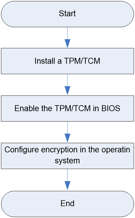

Installing and setting up a TCM or TPM
Trusted platform module (TPM) is a microchip embedded in the system board. It stores encryption information (such as encryption keys) for authenticating server hardware and software. The TPM operates with drive encryption programs such as Microsoft Windows BitLocker to provide operating system security and data protection. For information about Microsoft Windows BitLocker, visit the Microsoft website at http://www.microsoft.com.
Trusted cryptography module (TCM) is a trusted computing platform-based hardware module with protected storage space, which enables the platform to implement password calculation.
Installation and setup flowchart
Figure 21 TCM/TPM installation and setup flowchart
Guidelines
· Do not remove an installed TCM or TPM. Once installed, the module becomes a permanent part of the system board.
· If you want to replace the failed TCM or TPM, remove the system board, and then contact H3C Support to replace the TCM or TPM and the system board.
· When installing or replacing hardware, H3C technicians cannot configure the TCM or TPM or enter the recovery key. For security reasons, only the user can perform the tasks.
· When replacing the system board, do not remove the TCM or TPM from the system board. H3C will provide a TCM or TPM with a spare system board for the replacement.
· Any attempt to remove an installed TCM or TPM from the system board breaks or disfigures the TCM or TPM security rivet. Upon locating a broken or disfigured rivet on an installed TCP or TPM, administrators should consider the system compromised and take appropriate measures to ensure the integrity of the system data.
· H3C is not liable for blocked data access caused by improper use of the TCM or TPM. For more information, see the encryption technology feature documentation provided by the operating system.

Enabling the TCM or TPM in the BIOS
1. Access the BIOS utility. For information about how to enter the BIOS utility, see the BIOS user guide.
2. Select Advanced > Trusted Computing, and press Enter.
3. Enable TCM or TPM. By default, the TCM and TPM are enabled for a server.
If the server is installed with a TPM, select TPM State > Enabled, and then press Enter.
If the TPM is installed with a TCM, select TCM State > Enabled, and then press Enter.
4. Log in to HDM to verify that the TCM or TPM is operating correctly. For more information, see HDM online help.

3. Remove the power cord from the power supply:
a. Press the tab to disengage the ratchet from the tie mount, slide the cable clamp outward, and then release the tab.
b. Open the cable clamp and remove the power cord out of the clamp.
c. Unplug the power cord.

Installing a 4GPU module at the server rear
a. Insert the GPU module into the 4GPU module slot along the guide rails.
2. Reconnect other cables to the 4GPU module.
3. Install the 4GPU module on the server. Insert the 4GPU module into the chassis along the slot.

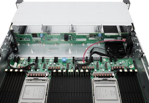

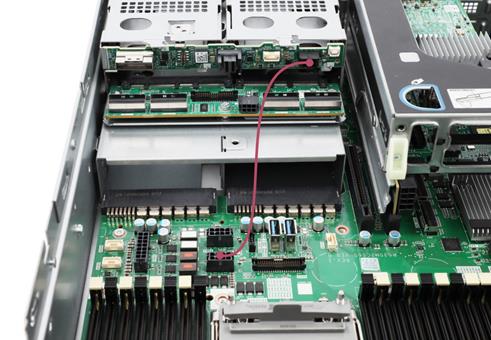

Connecting drive cables
For detailed cabling solutions for drives, including the codes and connecting schemes of SAS/SATA data cables, NVMe data cables, power cords, and AUX cables, see H3C UIS 3000 G5 Server Drive Configurations and Cabling Solutions (Drive Configurations and Cabling Solutions).
About using Drive Configurations and Cabling Solutions
Drive Configurations and Cabling Solutions contains the following sheets:
· Drive Configurations sheet—Provides detailed information about all drive configuration options supported by the server, including the type and number of drives, type, number and location of drive backplanes, type and slot of storage controllers, and routing schemes for AUX signal cables, power cords, and data cables.
· Glossary and Cabling Solutions sheet—Provides the common terms and cabling examples.
This section uses the drive configuration of 8SFF UniBay (8*SATA/SAS/NVMe, 0302A5H1)+8SFF UniBay (8*SATA/SAS/NVMe, 0302A5H1)+8SFF UniBay (8*SATA/SAS/NVMe, 0302A5H1) drives at the front + 2SFF (2*SAS/SATA, 0302A5QT) drives at the rear to tell you how to use the guide for cabling drives.
1. Open Drive Configurations and Cabling Solutions and select the Drive Configurations sheet.
2. Locate the 8SFF UniBay (8*SATA/SAS/NVMe, 0302A5H1)+8SFF UniBay (8*SATA/SAS/NVMe, 0302A5H1)+8SFF UniBay (8*SATA/SAS/NVMe, 0302A5H1) drives at the front + 2SFF (2*SAS/SATA, 0302A5QT) drives at the rear drive configuration.
3. Click the plus icon (+) to expand the detailed drive configuration.
As shown in Figure 22 and Figure 23, the slots in grey support SAS/SATA drives and the slots in green support SAS/SATA/NVMe drives. Some green slots support only NVMe drives if such restrictions are provided in the Remarks column.
Figure 22 Three 8SFF UniBay (8*SATA/SAS/NVMe, 0302A5H1) drives at the front
Figure 23 2SFF SAS/SATA drives at the rear
4. From the configuration options, select the drive configuration of your server and cable the drives accordingly. The following uses the configuration option 2 in Figure 24 as an example.
¡ Storage controllers—Type of storage controllers.
- Standard PMC 8i (2SFF drive at the rear)—A standard PMC 8i storage controller that controls all SAS or SATA drives in the 2SFF drive bay at the rear.
- Embedded NVMEx8—A controller embedded on the system board that controls eight NVMe drives.
- Riser1 Redriver—An NVMe SSD expander module installed on the Riser1 connector.
- Riser2 Redriver—An NVMe SSD expander module installed on the Riser2 connector.
¡ Storage controller slots—Slots in which you can install the standard PMC storage controllers. "Slot7/8" indicates that the standard PMC storage controller can be installed in slot 7 or 8. For more information about slot numbers, see "Rear panel."
¡ AUX cables—AUX signal cable code and cabling scheme. For more information, see Table 14.
¡ Power cords—Power cord code and cabling scheme. For more information, see Table 14.
¡ SAS/SATA cables—SAS/SATA data cable code and cabling scheme. For more information, see Table 14.
¡ NVMe cables—NVMe data cable code and cabling scheme. For more information, see Table 14.
Figure 24 Drive configuration and cabling scheme for configuration option 2

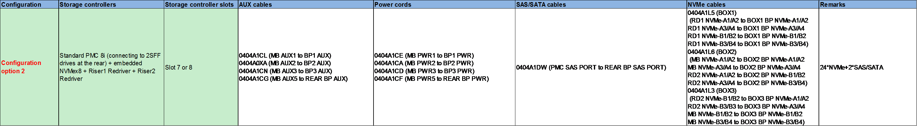

Table 14 Cabling scheme for drive configuration option 2
Cable type |
Cable code |
Cabling method |
Remarks |
AUX signal cable |
0404A1CL |
MB AUX1 to BP1 AUX, connecting connector AUX1 on the system board to connector AUX on the drive backplane in drive bay 1. |
0404A0XA |
MB AUX2 to BP2 AUX, connecting connector AUX2 on the system board to connector AUX on the drive backplane in drive bay 2. |
0404A1CN |
MB AUX3 to BP3 AUX, connecting connector AUX3 on the system board to connector AUX on the drive backplane in drive bay 3. |
0404A1CG |
MB AUX5 to REAR BP AUX, connecting connector AUX5 on the system board to connector AUX on the rear drive backplane. |
Power cord |
0404A1CE |
MB PWR1 to BP1 PWR, connecting connector PWR1 on the system board to connector PWR on the drive backplane in drive bay 1. |
0404A1CA |
MB PWR2 to BP2 PWR, connecting connector PWR2 on the system board to connector PWR on the drive backplane in drive bay 2. |
0404A1CD |
MB PWR3 to BP3 PWR, connecting connector PWR3 on the system board to connector PWR on the drive backplane in drive bay 3. |
0404A1CF |
MB PWR5 to REAR BP PWR, connecting connector PWR5 on the system board to connector PWR on the rear drive backplane. |
SAS/SATA data cable |
0404A1DW |
PMC SAS PORT to REAR BP SAS PORT, connecting the SAS connector on the PMC storage controller to connector SAS PORT on the rear drive backplane. |
NVMe data cable |
0404A1L5 |
Four 0404A1L5 NVMe drive data cables: · RD1 NVME-A1/A2 to BOX1 BP NVME-A1/A2, connecting connector NVMe-A1/A2 on the NVMe SSD expander module on riser connector 1 to connector NVMe A1/A2 on the drive backplane in drive bay 1. · RD1 NVME-A3/A4 to BOX1 BP NVME-A3/A4, connecting connector NVMe-A3/A4 on the NVMe SSD expander module on riser connector 1 to connector NVMe A3/A4 on the drive backplane in drive bay 1. · RD1 NVME-B1/B2 to BOX1 BP NVME-B1/B2, connecting connector NVMe-B1/B2 on the NVMe SSD expander module on riser connector 1 to connector NVMe B1/B2 on the drive backplane in drive bay 1. · RD1 NVME-B3/B4 to BOX1 BP NVME- B3/B4, connecting connector NVMe B3/B4 on the NVMe SSD expander module on riser connector 1 to connector NVMe B3/B4 on the drive backplane in drive bay 1. |
0404A1L6 |
Four 0404A1L6 NVMe drive data cables: · MB NVME-A1/A2 to BOX2 BP NVME-A1/A2, connecting connector NVMe-A1/A2 on the system board to connector NVMe A1/A2 on the drive backplane in drive bay 2. · MB NVME-A3/A4 to BOX2 BP NVME-A3/A4, connecting connector NVMe-A3/A4 on the system board to connector NVMe A3/A4 on the drive backplane in drive bay 2. · RD2 NVME-B1/B2 to BOX2 BP NVME-B1/B2, connecting connector NVMe-B1/B2 on the NVMe SSD expander module on riser connector 2 to connector NVMe B1/B2 on the drive backplane in drive bay 2. · RD2 NVME-B3/B4 to BOX2 BP NVME-B3/B4, connecting connector NVMe-A3/A4 on the NVMe SSD expander module on riser connector 2 to connector NVMe B3/B4 on the drive backplane in drive bay 2. |
0404A1L3 |
Four 0404A1L3 NVMe drive data cables: · RD2 NVME-B1/B2 to BOX3 BP NVME-A1/A2, connecting connector NVMe-B1/B2 on the NVMe SSD expander module on riser connector 2 to connector NVMe A1/A2 on the drive backplane in drive bay 3. · RD2 NVME-B3/B4 to BOX3 BP NVME-A3/A4, connecting connector NVMe-A3/A4 on the NVMe SSD expander module on riser connector 2 to connector NVMe A3/A4 on the drive backplane in drive bay 3. · MB NVME-B1/B2 to BOX3 BP NVME-B1/B2, connecting connector NVMe-B1/B2 on the system board to connector NVMe B1/B2 on the drive backplane in drive bay 3. · MB NVME-B3/B4 to BOX3 BP NVME-B3/B4, connecting connector NVMe B3/B4 on the system board to connector NVMe B3/B4 on the drive backplane in drive bay 3. |

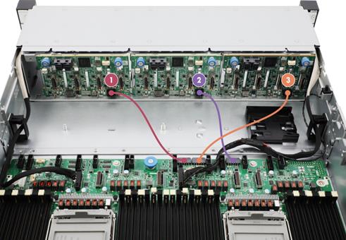

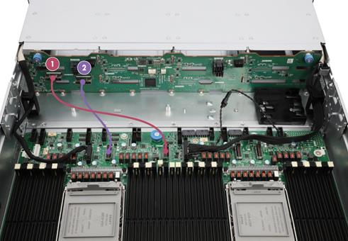

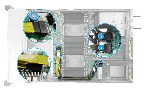

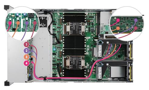

Figure 25 Connecting NVMe data cables for the three 8SFF UniBay NVMe drives at the front (1)
(1) to (4): NVMe data cables connected to the LP SlimSAS connectors on the system board |

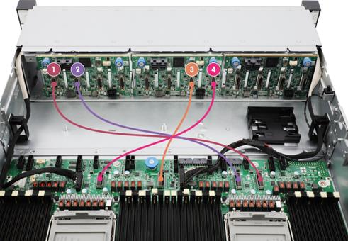

Figure 26 Connecting NVMe data cables for the three 8SFF UniBay NVMe drives at the front (2)
(1) to (4): NVMe data cables connected to the NVMe SSD expander module on riser connector 1 |

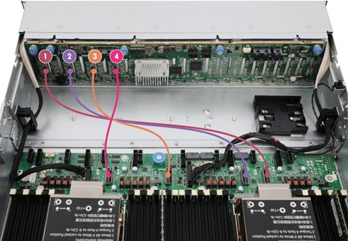

Figure 27 Connecting NVMe data cables for the three 8SFF UniBay NVMe drives at the front (3)
(1) to (4): NVMe data cables connected to the NVMe SSD expander module on riser connector 2 |
Figure 28 Connecting AUX cables for the three 8SFF UniBay drives at the front
(1): AUX cable for the 8SFF UniBay drive backplane in drive bay 3 |
(2): AUX cable for the 8SFF UniBay drive backplane in drive bay 2 |
(3): AUX cable for the 8SFF UniBay drive backplane in drive bay 1 |

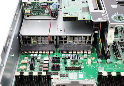

Figure 29 Connecting power cords for the three 8SFF UniBay drives at the front
(1): Power cord for the 8SFF UniBay drive backplane in drive bay 3 |
(2): Power cord for the 8SFF UniBay drive backplane in drive bay 2 |
(3): Power cord for the 8SFF UniBay drive backplane in drive bay 1 |

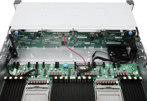

Figure 30 Connecting an SAS/SATA data cable for the 2SFF drives at the rear
Figure 31 Connecting an AUX cable for the 2SFF drives at the rear
Figure 32 Connecting a power cord for the 2SFF drives at the rear
Drive cabling examples

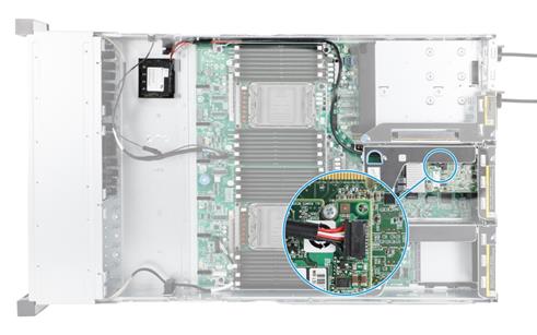

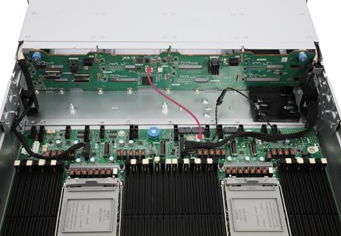

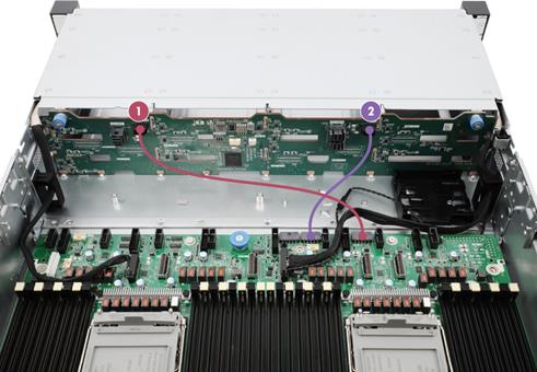

1. Connect an SAS/SATA data cable for the 8LFF drives at the front.
Figure 33 Connecting an SAS/SATA data cable for the 8LFF drives at the front

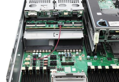

2. Connect an AUX cable for the 8LFF drives at the front.
Figure 34 Connecting an AUX cable for the 8LFF drives at the front

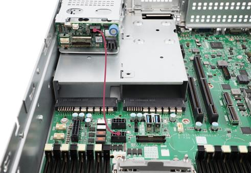

3. Connect a power cord for the 8LFF drives at the front.
Figure 35 Connecting a power cord for the 8LFF drives at the front.

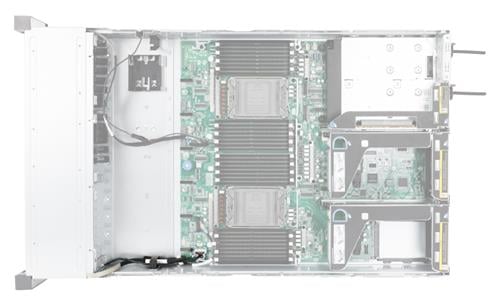

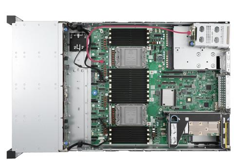

25SFF drives at the front

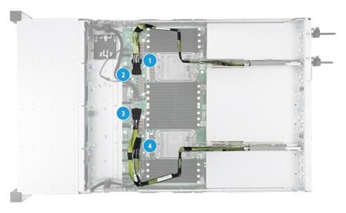

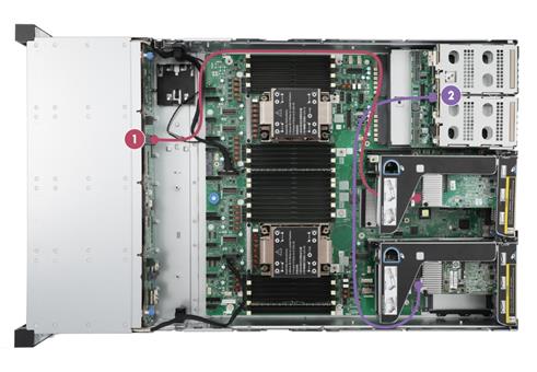

1. Connect NVMe data cables for the 25SFF drives at the front.
Figure 36 Connecting NVMe data cables for the 25SFF drives at the front

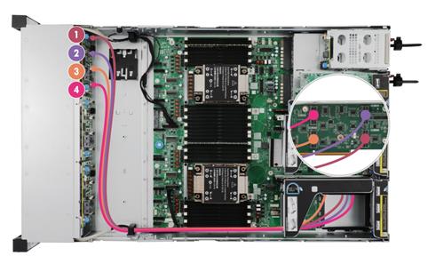

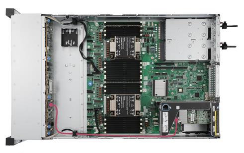

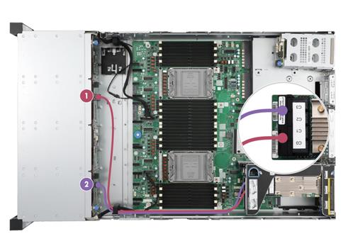

2. Connect SAS/SATA data cables for the 25SFF drives at the front.
Figure 37 Connecting SAS/SATA data cables for the 25SFF drives at the front

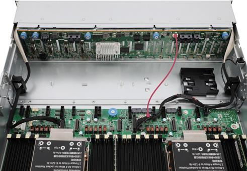

3. Connect an AUX cable for the 25SFF drives at the front.
Figure 38 Connecting an AUX cable for the 25SFF drives at the front
4. Connect power cords for the 25SFF drives at the front.
Figure 39 Connecting power cords for the 25SFF drives at the front
(1) to (3): Power cords from the 25SFF drive backplane to the system board |

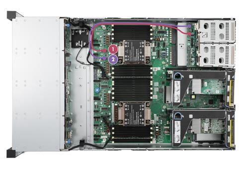

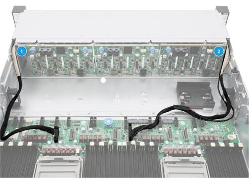

8SFF UniBay+8SFF UniBay+8SFF UniBay drives at the front + 2SFF drives at the rear
1. Connect NVMe data cables for the three 8SFF UniBay drives at the front.
Figure 40 Connecting NVMe data cables for the three 8SFF UniBay drives at the front (1)
Figure 41 Connecting NVMe data cables for the three 8SFF UniBay drives at the front (2)
Figure 42 Connecting NVMe data cables for the three 8SFF UniBay drives at the front (3)
2. Connect AUX signal cables for the three 8SFF UniBay drives at the front.
Figure 43 Connecting AUX signal cables for the three 8SFF UniBay drives at the front
(1): AUX cable from the 8SFF UniBay drive backplane in drive bay 3 to the system board |
(2): AUX cable from the 8SFF UniBay drive backplane in drive bay 2 to the system board |
(3): AUX cable from the 8SFF UniBay drive backplane in drive bay 1 to the system board |
3. Connect power cords for the three 8SFF UniBay drives at the front.
Figure 44 Connecting power cords for the three 8SFF UniBay drives at the front
(1): Power cord from the 8SFF UniBay drive backplane in drive bay 3 to the system board |
(2): Power cord from the 8SFF UniBay drive backplane in drive bay 2 to the system board |
(3): Power cord from the 8SFF UniBay drive backplane in drive bay 1 to the system board |

12LFF drives at the front + 2SFF UniBay drives at the rear
1. Connect SAS/SATA data cables for the 12LFF drives at the front.
Figure 48 Connecting SAS/SATA data cables for the 12LFF drives at the front
(1) and (2): SAS/SATA data cables for the 12LFF SAS/SATA drive backplane |
2. Connect an AUX cable for the 12LFF drives at the front.
Figure 49 Connecting an AUX cable for the 12LFF drives at the front
3. Connect power cords for the 12LFF drives at the front.
Figure 50 Connecting power cords for the 12LFF drives at the front
(1) to (2): Power cords from the 12LFF SAS/SATA drive backplane to the system board |
4. Connect NVMe data cables for the 2SFF UniBay drives at the rear.
Figure 51 Connecting NVMe data cables for the 2SFF UniBay drives at the rear
5. Connect an AUX cable for the 2SFF UniBay drives at the rear
Figure 52 Connecting an AUX cable for the 2SFF UniBay drives at the rear
6. Connect a power cord for the 2SFF UniBay drives at the rear.
Figure 53 Connecting a power cord for the 2SFF UniBay drives at the rear
12LFF (8 SAS/SATA+4UniBay) drives at the front + 2SFF drives (including an OCP adapter) at the rear
1. Connect NVMe data cables for the 12LFF drives at the front.
Figure 54 Connecting NVMe data cables for the 12LFF drives at the front
(1) and (2): NVMe data cables for the 12LFF drives at the front |
2. Connect SAS/SATA data cables for the 12LFF drives at the front and 2SFF drives at the rear.
Figure 55 Connecting SAS/SATA data cables for the 12LFF drives at the front and 2SFF drives at the rear
(1):SAS/SATA data cable for the 12LFF drive backplane |
(2) SAS/SATA data cable for the 2SFF drive backplane |

Connecting OCP adapter cables
Figure 60 Connecting an AUX cable for the OCP adapter
Figure 61 Connecting a power cord for the OCP adapter
Figure 62 Connecting data cables for the OCP adapter
(1) and (2): Data cables for the OCP adapter |
Connecting supercapacitor extension cables
Figure 63 Connecting supercapacitor extension cables

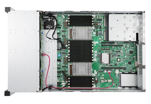

Connecting cables for the GPU at the rear
Figure 64 Connecting data cables for the GPU at the rear
(1) to (4): Data cables for the GPU at the rear |
Figure 65 Connecting a power cord for the GPU module at the rear
Connecting the SATA M.2 SSD data cables
Figure 66 Connecting the SATA M.2 SSD data cables
Connecting the PCIe signal cables
Figure 67 Connecting the PCIe signal cables
Table 15 Cabling method
Riser card connector |
Cable code |
Cable number |
Connector on the riser card |
Connector on the system board |
Riser1 |
0404A1EB |
1 |
SlimSAS connector 1 |
LP SlimSAS connector A1/A2 |
2 |
SlimSAS connector 2 |
LP SlimSAS connector A3/A4 |
Riser2 |
0404A1ED |
1 |
LP SlimSAS connector B1/B2 |
2 |
LP SlimSAS connector B3/B4 |
