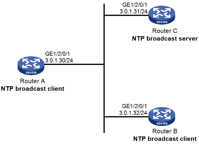

Figure 1 shows how NTP synchronizes the system time between two devices (Device A and Device B, in this example). Assume that:
·     Prior to the time synchronization, the time is set to 10:00:00 am for Device A and 11:00:00 am for Device B.
·     Device B is used as the NTP server. Device A is to be synchronized to Device B.
·     It takes 1 second for an NTP message to travel from Device A to Device B, and from Device B to Device A.
·     It takes 1 second for Device B to process the NTP message.
Figure 1 Basic work flow
The synchronization process is as follows:
1.     Device A sends Device B an NTP message, which is timestamped when it leaves Device A. The time stamp is 10:00:00 am (T1).
2.     When this NTP message arrives at Device B, Device B adds a timestamp showing the time when the message arrived at Device B. The timestamp is 11:00:01 am (T2).
3.     When the NTP message leaves Device B, Device B adds a timestamp showing the time when the message left Device B. The timestamp is 11:00:02 am (T3).
4.     When Device A receives the NTP message, the local time of Device A is 10:00:03 am (T4).
Up to now, Device A can calculate the following parameters based on the timestamps:
·     The roundtrip delay of the NTP message: Delay = (T4 – T1) – (T3 – T2) = 2 seconds.
·     Time difference between Device A and Device B: Offset = [ (T2 – T1) + (T3 – T4) ] /2 = 1 hour.
Based on these parameters, Device A can be synchronized to Device B.

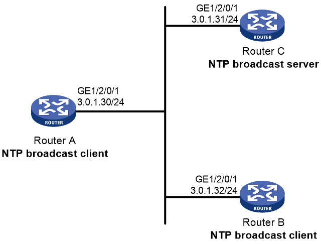

NTP architecture
NTP uses stratums 1 to 16 to define clock accuracy, as shown in Figure 2. A lower stratum value represents higher accuracy. Clocks at stratums 1 through 15 are in synchronized state, and clocks at stratum 16 are not synchronized.
Figure 2 NTP architecture
A stratum 1 NTP server gets its time from an authoritative time source, such as an atomic clock. It provides time for other devices as the primary NTP server. A stratum 2 time server receives its time from a stratum 1 time server, and so on.
To ensure time accuracy and availability, you can specify multiple NTP servers for a device. The device selects an optimal NTP server as the clock source based on parameters such as stratum. The clock that the device selects is called the reference source. For more information about clock selection, see the related protocols and standards.
If the devices in a network cannot synchronize to an authoritative time source, you can perform the following tasks:
·     Select a device that has a relatively accurate clock from the network.
·     Use the local clock of the device as the reference clock to synchronize other devices in the network.

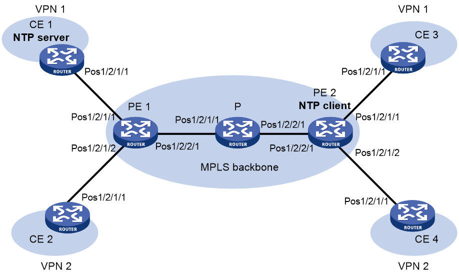

NTP for MPLS L3VPN instances
On an MPLS L3VPN network, a PE that acts as an NTP client or active peer can synchronize with the NTP server or passive peer in an MPLS L3VPN instance.
As shown in Figure 4, users in VPN 1 and VPN 2 are connected to the MPLS backbone network through provider edge (PE) devices. VPN instances vpn1 and vpn2 have been created for VPN 1 and VPN 2, respectively on the PEs. Services of the two VPN instances are isolated. Time synchronization between PEs and devices in the two VPN instances can be realized if you perform the following tasks:
·     Configure the PEs to operate in NTP client or symmetric active mode.
·     Specify the VPN instance to which the NTP server or NTP symmetric passive peer belongs.
Figure 4 Network diagram
For more information about MPLS L3VPN, VPN instance, and PE, see MPLS Configuration Guide.

Example: Configuring NTP client/server association mode
As shown in Figure 5, perform the following tasks:
·     Configure Device A's local clock as its reference source, with stratum level 2.
·     Configure Device B to operate in client mode and specify Device A as the NTP server of Device B.
Figure 5 Network diagram
1.     Assign an IP address to each interface, and make sure Device A and Device B can reach each other, as shown in Figure 5. (Details not shown.)
2.     Configure Device A:

Example: Configuring IPv6 NTP client/server association mode
As shown in Figure 6, perform the following tasks:
·     Configure Device B to operate in client mode and specify Device A as the IPv6 NTP server of Device B.
Figure 6 Network diagram
1.     Assign an IP address to each interface, and make sure Device A and Device B can reach each other, as shown in Figure 6. (Details not shown.)

Example: Configuring NTP broadcast association mode
As shown in Figure 10, configure Router C as the NTP server of multiple devices on the same network segment so that these devices synchronize the time with Router C.
·     Configure Router C's local clock as its reference source, with stratum level 2.
·     Configure Router C to operate in broadcast server mode and send broadcast messages from GigabitEthernet 1/2/0/1.
·     Configure Router B and Router A to operate in broadcast client mode and receive broadcast messages on GigabitEthernet 1/2/0/1.
Figure 10 Network diagram
1.     Assign an IP address to each interface, and make sure Router A, Router B, and Router C can reach each other, as shown in Figure 10. (Details not shown.)
2.     Configure Router C:

The following procedure uses Router A as an example to verify the configuration.
# Verify that Router A has synchronized its time with Router C, and the clock stratum level of Router A is 3.
[RouterA-GigabitEthernet1/2/0/1] display ntp-service status
 Clock status: synchronized
 Clock stratum: 3
 System peer: 3.0.1.31
 Local mode: bclient
 Reference clock ID: 3.0.1.31
 Leap indicator: 00
 Clock jitter: 0.044281 s
 Stability: 0.000 pps
 Clock precision: 2^-18
 Root delay: 0.00229 ms
 Root dispersion: 4.12572 ms
 Reference time: d0d289fe.ec43c720  Sat, Jan  8 2011  7:00:14.922
 System poll interval: 64 s
# Verify that an IPv4 NTP association has been established between Router A and Router C.
[RouterA-GigabitEthernet1/2/0/1] display ntp-service sessions
       source          reference       stra reach poll  now offset  delay disper
 [1245]3.0.1.31        127.127.1.0        2     1   64  519   -0.0 0.0022 4.1257
Notes: 1 source(master),2 source(peer),3 selected,4 candidate,5 configured.
 Total sessions: 1
Example: Configuring NTP multicast association mode
As shown in Figure 11, configure Router C as the NTP server for multiple devices on different network segments so that these devices synchronize the time with Router C.
·     Configure Router C to operate in multicast server mode and send multicast messages from GigabitEthernet 1/2/0/1.
·     Configure Router D and Router A to operate in multicast client mode and receive multicast messages on GigabitEthernet 1/2/0/1.
Figure 11 Network diagram
1.     Assign an IP address to each interface, and make sure the routers can reach each other, as shown in Figure 11. (Details not shown.)

4.     Verify the configuration:
# Verify that Router D has synchronized its time with Router C, and the clock stratum level of Router D is 3.
Router D and Router C are on the same subnet, so Router D can receive multicast messages from Router C without being enabled with the multicast function.
[RouterD-GigabitEthernet1/2/0/1] display ntp-service status
 Clock stratum: 3
 Local mode: bclient
 Leap indicator: 00
# Verify that an IPv4 NTP association has been established between Router D and Router C.
[RouterD-GigabitEthernet1/2/0/1] display ntp-service sessions
 Total sessions: 1
5.     Configure Router B:
Because Router A and Router C are on different subnets, you must enable the multicast functions on Router B before Router A can receive multicast messages from Router C.
# Enable the IP multicast function.
<RouterB> system-view
[RouterB] multicast routing
[RouterB-mrib] quit
[RouterB] interface gigabitethernet 1/2/0/1
[RouterB-GigabitEthernet1/2/0/1] igmp enable
[RouterB-GigabitEthernet1/2/0/1] igmp static-group 224.0.1.1
[RouterB-GigabitEthernet1/2/0/1] quit
[RouterB] interface gigabitethernet 1/2/0/2
[RouterB-GigabitEthernet1/2/0/2] pim dm
[RouterB-GigabitEthernet1/2/0/2] quit
6.     Configure Router A:
# Enable the NTP service.
<RouterA> system-view
[RouterA] ntp-service enable
# Specify NTP for obtaining the time on the default MDC.
[RouterA] clock protocol ntp mdc 1
# Configure Router A to operate in multicast client mode and receive multicast messages from GigabitEthernet 1/2/0/1.
[RouterA] interface gigabitethernet 1/2/0/1
[RouterA-GigabitEthernet1/2/0/1] ntp-service multicast-client
[RouterA-GigabitEthernet1/2/0/1] quit
 Clock stratum: 3
 Local mode: bclient
 Leap indicator: 00
 Clock jitter: 0.165741 s
 Clock precision: 2^-10
 Root delay: 0.00534 ms
 Root dispersion: 4.51282 ms
 Reference time: d0c61289.10b1193f  Wed, Dec 29 2010 20:03:21.065
 [1234]3.0.1.31        127.127.1.0        2   247   64   381  -0.0 0.0053 4.5128
 Total sessions: 1

Example: Configuring NTP authentication in broadcast mode
As shown in Figure 13, configure Router C as the NTP server for multiple devices on the same segment so that these devices synchronize the time with Router C. Configure Router A and Router B to authenticate the NTP server.
·     Configure Router C's local clock as its reference source, with stratum level 3.
·     Configure Router A and Router B to operate in broadcast client mode and receive broadcast messages on GigabitEthernet 1/2/0/1.
·     Configure NTP authentication on Router A, Router B, and Router C.
Figure 13 Network diagram
1.     Assign an IP address to each interface, and make sure Router A, Router B, and Router C can reach each other, as shown in Figure 13. (Details not shown.)
2.     Configure Router A:

Example: Configuring MPLS L3VPN network time synchronization in client/server mode
As shown in Figure 14, two MPLS L3VPN instances are present on PE 1 and PE 2: vpn1 and vpn2. CE 1 and CE 3 are devices in VPN 1.
To synchronize time between PE 2 and CE 1 in VPN 1, perform the following tasks:
·     Configure CE 1's local clock as its reference source, with stratum level 2.
·     Configure CE 1 in the VPN instance vpn1 as the NTP server of PE 2.
Figure 14 Network diagram

Before you perform the following configuration, be sure you have completed MPLS L3VPN-related configurations. For information about configuring MPLS L3VPN, see MPLS Configuration Guide.
1.     Assign an IP address to each interface, as shown in Figure 14. Make sure CE 1 and PE 1, PE 1 and PE 2, and PE 2 and CE 3 can reach each other. (Details not shown.)
2.     Configure CE 1:
