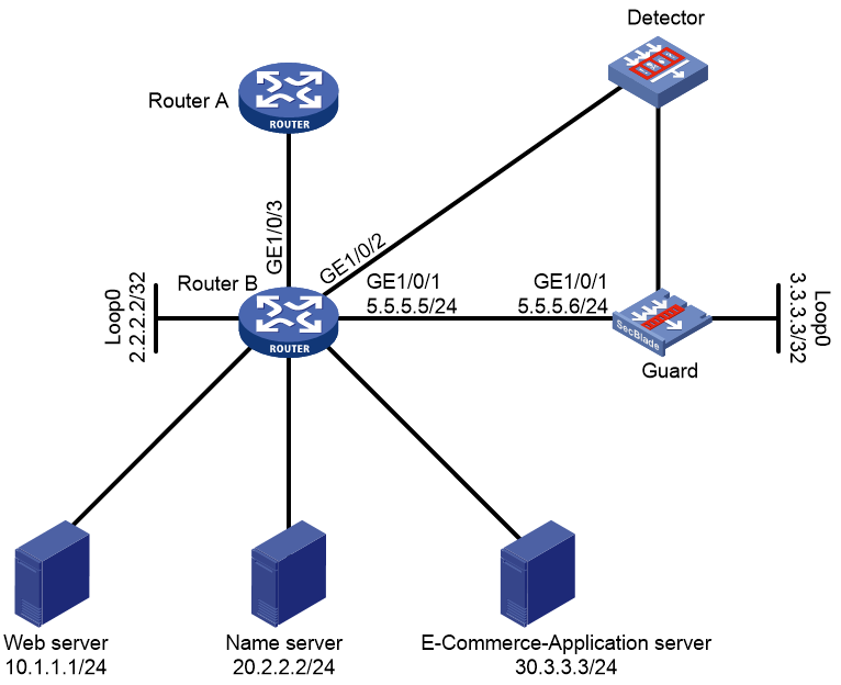

Figure 1 Guard route network diagram
As shown in Figure 1, Device B uses port mirroring to mirror traffic destined for the application servers to the detector for monitoring. It uses a routing protocol to redistribute guard routes from the guard device.
When no abnormal traffic is detected, Device B forwards traffic without the participation of the guard device.
When abnormal traffic is detected, the detector performs one of the following tasks:
·     Sends a notification to the guard device. The guard device then automatically generates a guard route.
·     Generates an alarm to notify the network administrator. The administrator then manually configures a guard route on the guard device.
The destination address of the guard route is the address to which the abnormal traffic is destined.
After the guard route is configured, the guard device advertises the route to Device B. Device B directs all traffic destined to the destination address of the guard route to the guard device. The guard device filters and cleans the traffic and then sends the normal traffic back to Device B.

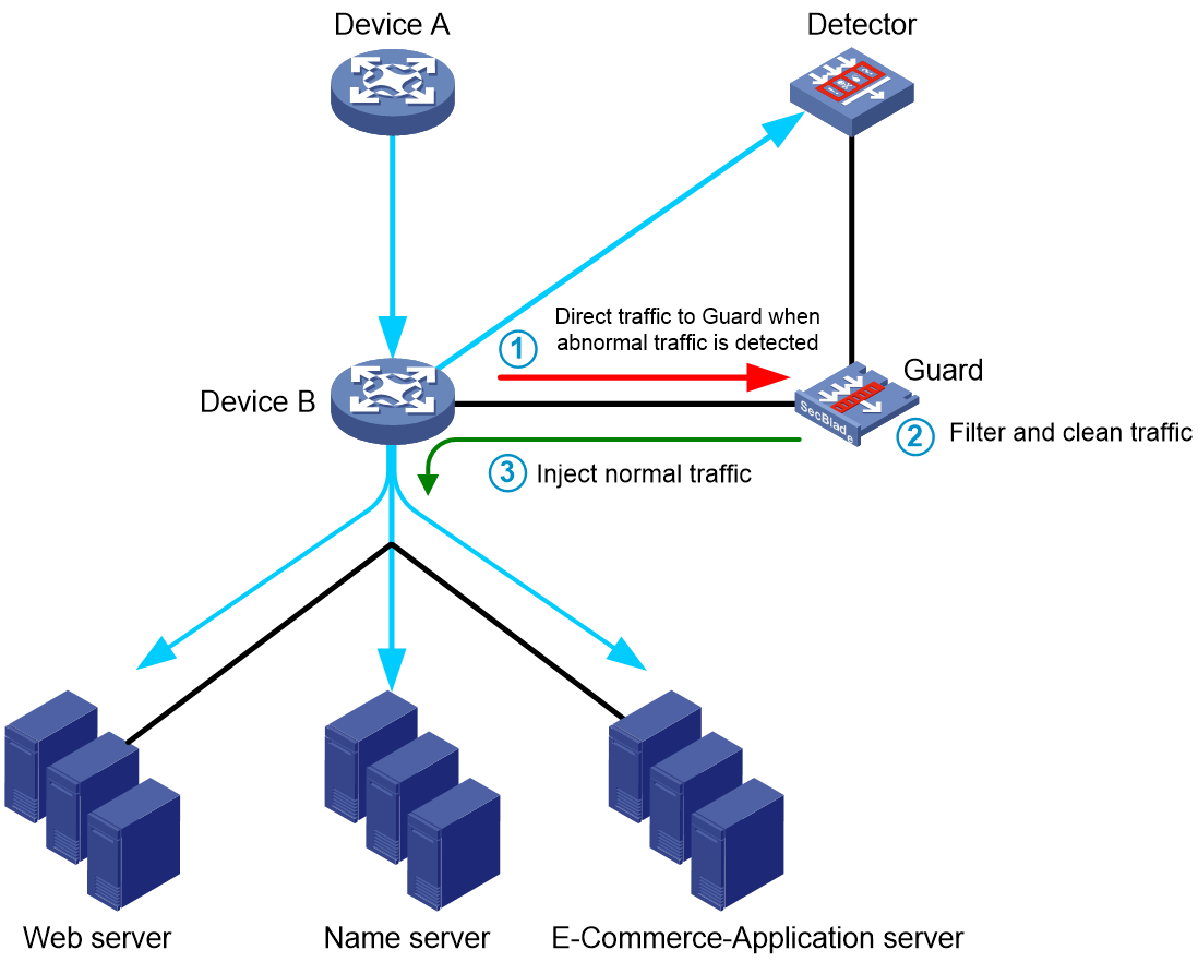

Figure 2 Network diagram
1.     Configure IP addresses and routes to ensure network connectivity. (Details not shown.)

The output shows that traffic destined to 1.1.1.1/32 will be directed to the guard device, and Router B will not advertise route 1.1.1.1/32.
