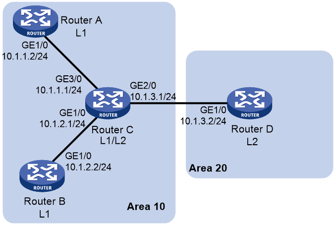

IS-IS has a 2-level hierarchy to support large-scale networks. A large-scale routing domain is divided into multiple areas. Typically, a Level-1 router is deployed within an area. A Level-2 router is deployed between areas. A Level-1-2 router is deployed between Level-1 and Level-2 routers.
Level-1 router
A Level-1 router establishes neighbor relationships with Level-1 and Level-1-2 routers in the same area. It maintains an LSDB comprising intra-area routing information. A Level-1 router forwards packets destined for external areas to the nearest Level-1-2 router. Level-1 routers in different areas cannot establish neighbor relationships.
Level-2 router
A Level-2 router establishes neighbor relationships with Level-2 and Level-1-2 routers in the same area or in different areas. It maintains a Level-2 LSDB containing inter-area routing information. All the Level-2 and Level-1-2 routers must be contiguous to form the backbone of the IS-IS routing domain. Level-2 routers can establish neighbor relationships even if they are in different areas.
Level-1-2 router
A router with both Level-1 and Level-2 router functions is a Level-1-2 router. It can establish Level-1 neighbor relationships with Level-1 and Level-1-2 routers in the same area. It can establish Level-2 neighbor relationships with Level-2 and Level-1-2 routers in different areas. A Level-1 router can reach other areas only through a Level-1-2 router. The Level-1-2 router maintains two LSDBs, a Level-1 LSDB for intra-area routing and a Level-2 LSDB for inter-area routing.

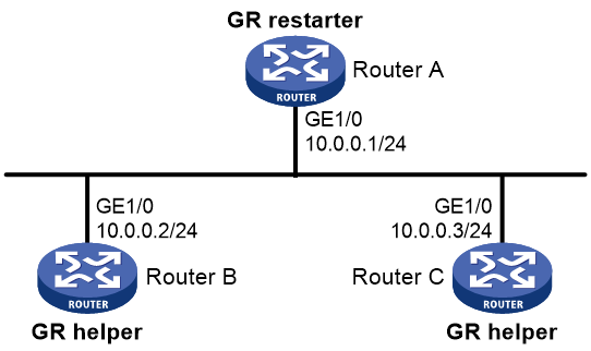

Figure 2 shows one IS-IS network topology. Area 1 is the backbone that comprises a set of Level-2 routers. The other four areas are non-backbone areas connected to the backbone through Level-1-2 routers.
Figure 2 IS-IS topology 1

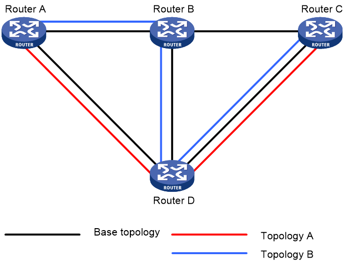

Figure 3 shows another IS-IS topology. No area is defined as the backbone in this topology. The backbone comprises all contiguous Level-2 and Level-1-2 routers in different areas. The IS-IS backbone does not need to be a specific area.
Figure 3 IS-IS topology 2
Both the Level-1 and Level-2 routers use the SPF algorithm to generate the shortest path tree.

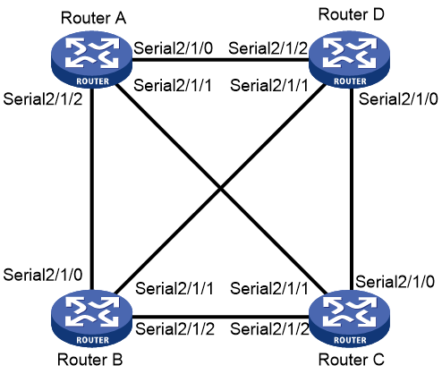

As shown in Figure 4, the same level routers on a network, including non-DIS routers, establish adjacency with each other.
Figure 4 DIS in the IS-IS broadcast network

Configuring IPv4 IS-IS MTR
Typically, service packets with the same destination are forwarded over the same link. To forward them over different links, you can use one of the following methods:
·     Policy-based routing (PBR). Use PBR to change the next hop.
·     Traffic engineering (TE).
·     Multi-Topology Routing (MTR).
MTR is based on topology and is easier to deploy than TE. MTR splits the topology of a specific address family (for example, IPv4) into multiple topologies, and forwards traffic on a per-topology basis.
Figure 7 Network diagram
As shown in Figure 7, the base topology is split into two topologies, topology A and topology B. You can forward voice traffic through topology A and video traffic through topology B.
Router B does not belong to topology A. In topology B, the links between Router A and Router D and the links between Router B and Router C do not exist. Route calculation and traffic forwarding are performed in each topology independently.
You must configure MTR before configuring IPv4 IS-IS MTR. For more information about MTR, see "Configuring MTR."

Configuring IPv6 IS-IS MTR
On a network, IPv4 and IPv6 topologies must be consistent so that both IPv6 IS-IS and IPv4 IS-IS can use the SPF algorithm to perform route calculation. If they are different, routers supporting both IPv4 and IPv6 might send IPv6 packets to routers that do not support IPv6, resulting in packet loss.
To resolve this issue, configure IPv6 IS-IS MTR to perform route calculation separately in IPv4 and IPv6 topologies. For more information about MTR, see "Configuring MTR."
Figure 8 Network diagram
As shown in Figure 8, the numbers refer to the link costs. Router A, Router B, and Router D support both IPv4 and IPv6. Router C supports only IPv4 and cannot forward IPv6 packets.
Enable IPv6 IS-IS MTR on Router A, Router B, Router C, and Router D to make them perform route calculation separately in IPv4 and IPv6 topologies. With this configuration, Router A does not forward IPv6 packets destined to Router D through Router B, avoiding packet loss.
As a best practice to avoid route calculation failures, configure this feature when both IPv4 and IPv6 topologies exist in the network.

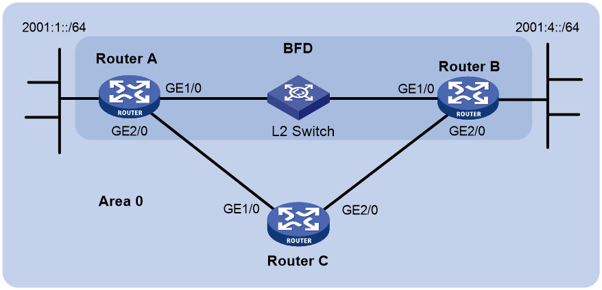

Configuring IS-IS FRR
A link or router failure on a path can cause packet loss. IS-IS FRR enables fast rerouting to minimize the failover time.
Figure 10 Network diagram for IS-IS FRR
In Figure 10, after you enable FRR on Router B, IS-IS automatically calculates or designates a backup next hop when a link failure is detected. In this way, packets are directed to the backup next hop to reduce traffic recovery time. Meanwhile, IS-IS calculates the shortest path based on the new network topology, and forwards packets over the path after network convergence.
You can assign a backup next hop for IS-IS FRR through the following ways:
·     Enable IS-IS FRR to calculate a backup next hop through Loop Free Alternate (LFA) calculation.
·     Designate a backup next hop with a routing policy for routes matching specific criteria.
The LFA calculation of FRR and that of TE are mutually exclusive.

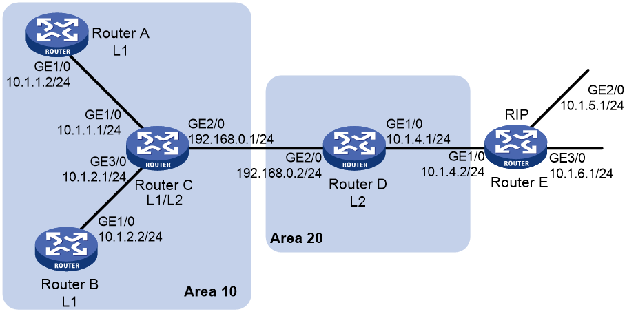

Example: Configuring basic IS-IS
As shown in Figure 11, Router A, Router B, Router C, and Router D reside in an AS.
Router A and Router B are Level-1 routers, Router D is a Level-2 router, and Router C is a Level-1-2 router connecting two areas. Router A, Router B, and Router C are in area 10, and Router D is in area 20.
Figure 11 Network diagram
1.     Configure IP addresses for interfaces. (Details not shown.)
2.     Configure IS-IS:
# Configure Router A
<RouterA> system-view
[RouterA] isis 1
[RouterA-isis-1] is-level level-1
[RouterA-isis-1] network-entity 10.0000.0000.0001.00
[RouterA-isis-1] quit
[RouterA] interface gigabitethernet 1/0
[RouterA-GigabitEthernet1/0] isis enable 1
[RouterA-GigabitEthernet1/0] quit
# Configure Router B.
<RouterB> system-view
[RouterB] isis 1
[RouterB-isis-1] is-level level-1
[RouterB-isis-1] network-entity 10.0000.0000.0002.00
[RouterB-isis-1] quit
[RouterB] interface gigabitethernet 1/0
[RouterB-GigabitEthernet1/0] isis enable 1
[RouterB-GigabitEthernet1/0] quit
# Configure Router C.
<RouterC> system-view
[RouterC] isis 1
[RouterC-isis-1] network-entity 10.0000.0000.0003.00
[RouterC-isis-1] quit
[RouterC] interface gigabitethernet 3/0
[RouterC-GigabitEthernet3/0] isis enable 1
[RouterC-GigabitEthernet3/0] quit
[RouterC] interface gigabitethernet 1/0
[RouterC-GigabitEthernet1/0] isis enable 1
[RouterC-GigabitEthernet1/0] quit
[RouterC] interface gigabitethernet 2/0
[RouterC-GigabitEthernet2/0] isis enable 1
[RouterC-GigabitEthernet2/0] quit
# Configure Router D
<RouterD> system-view
[RouterD] isis 1
[RouterD-isis-1] is-level level-2
[RouterD-isis-1] network-entity 20.0000.0000.0004.00
[RouterD-isis-1] quit
[RouterD] interface gigabitethernet 1/0
[RouterD-GigabitEthernet1/0] isis enable 1
[RouterD-GigabitEthernet1/0] quit
[RouterD] interface gigabitethernet 2/0
[RouterD-GigabitEthernet2/0] isis enable 1
[RouterD-GigabitEthernet2/0] quit
# Display the IS-IS LSDB information.
[RouterA] display isis lsdb
                        Database information for ISIS(1)
                          Level-1 Link State Database
LSPID                 Seq Num      Checksum      Holdtime      Length  ATT/P/OL
0000.0000.0001.00-00* 0x00000004   0xdf5e        1096          68      0/0/0
0000.0000.0002.00-00  0x00000004   0xee4d        1102          68      0/0/0
0000.0000.0002.01-00  0x00000001   0xdaaf        1102          55      0/0/0
0000.0000.0003.00-00  0x00000009   0xcaa3        1161          111     1/0/0
0000.0000.0003.01-00  0x00000001   0xadda        1112          55      0/0/0
    *-Self LSP, +-Self LSP(Extended), ATT-Attached, P-Partition, OL-Overload
[RouterB] display isis lsdb
0000.0000.0001.00-00  0x00000006   0xdb60        988           68      0/0/0
0000.0000.0002.00-00* 0x00000008   0xe651        1189          68      0/0/0
0000.0000.0002.01-00* 0x00000005   0xd2b3        1188          55      0/0/0
0000.0000.0003.00-00  0x00000014   0x194a        1190          111     1/0/0
0000.0000.0003.01-00  0x00000002   0xabdb        995           55      0/0/0
[RouterC] display isis lsdb
0000.0000.0001.00-00  0x00000006   0xdb60        847           68      0/0/0
0000.0000.0002.00-00  0x00000008   0xe651        1053          68      0/0/0
0000.0000.0002.01-00  0x00000005   0xd2b3        1052          55      0/0/0
0000.0000.0003.00-00* 0x00000014   0x194a        1051          111     1/0/0
0000.0000.0003.01-00* 0x00000002   0xabdb        854           55      0/0/0
                          Level-2 Link State Database
0000.0000.0003.00-00* 0x00000012   0xc93c        842           100     0/0/0
0000.0000.0004.00-00  0x00000026   0x331         1173          84      0/0/0
0000.0000.0004.01-00  0x00000001   0xee95        668           55      0/0/0
[RouterD] display isis lsdb
0000.0000.0003.00-00  0x00000013   0xc73d        1003          100     0/0/0
0000.0000.0004.00-00* 0x0000003c   0xd647        1194          84      0/0/0
0000.0000.0004.01-00* 0x00000002   0xec96        1007          55      0/0/0
# Display the IS-IS routing information on each router.
[RouterA] display isis route
                         Route information for IS-IS(1)
                         Level-1 IPv4 Forwarding Table
 IPv4 Destination     IntCost    ExtCost ExitInterface   NextHop         Flags
 10.1.1.0/24          10         NULL    GE1/1/0         Direct          D/L/-
 10.1.2.0/24          20         NULL    GE1/1/0         10.1.1.1        R/-/-
 192.168.0.0/24       20         NULL    GE1/1/0         10.1.1.1        R/-/-
 0.0.0.0/0            10         NULL    GE1/1/0         10.1.1.1        R/-/-
      Flags: D-Direct, R-Added to Rib, L-Advertised in LSPs, U-Up/Down Bit Set
[RouterC] display isis route
 10.1.2.0/24          10         NULL    GE1/3/0         Direct          D/L/-
 192.168.0.0/24       10         NULL    GE1/2/0         Direct          D/L/-
                         Level-2 IPv4 Forwarding Table
 10.1.1.0/24          10         NULL                                    D/L/-
 10.1.2.0/24          10         NULL                                    D/L/-
 192.168.0.0/24       10         NULL                                    D/L/-
 172.16.0.0/16        20         NULL    GE1/2/0         192.168.0.2     R/-/-
[RouterD] display isis route
 10.1.1.0/24          20         NULL    GE1/2/0         192.168.0.1     R/-/-
 10.1.2.0/24          20         NULL    GE1/2/0         192.168.0.1     R/-/-
 172.16.0.0/16        10         NULL    GE1/1/0         Direct          D/L/-
The output shows that the routing table of Level-1 routers contains a default route with the next hop as the Level-1-2 router. The routing table of Level-2 router contains all Level-1 and Level-2 routes.

Example: Configuring IS-IS route redistribution
As shown in Figure 13, Router A, Router B, Router C, and Router D reside in the same AS. They use IS-IS to interconnect. Router A and Router B are Level-1 routers, Router D is a Level-2 router, and Router C is a Level-1-2 router.
Redistribute RIP routes into IS-IS on Router D.
Figure 13 Network diagram
2.     Configure basic IS-IS:
# Configure Router A.
[RouterA] isis 1
[RouterB] isis 1
[RouterC] isis 1
# Configure Router D.
[RouterD] isis 1
# Display IS-IS routing information on each router.
 10.1.4.0/24          10         NULL                                    D/L/-
 10.1.4.0/24          10         NULL    GE1/1/0         Direct          D/L/-
3.     Configure RIPv2 on Router D and Router E, and configure IS-IS to redistribute RIP routes on Router D:
# Configure RIPv2 on Router D.
[RouterD] rip 1
[RouterD-rip-1] network 10.0.0.0
[RouterD-rip-1] version 2
[RouterD-rip-1] undo summary
# Configure RIPv2 on Router E.
[RouterE] rip 1
[RouterE-rip-1] network 10.0.0.0
[RouterE-rip-1] version 2
[RouterE-rip-1] undo summary
# On Router D, configure IS-IS to redistribute routes from RIP.
[RouterD-rip-1] quit
[RouterD] isis 1
[RouterD–isis-1] address-family ipv4
[RouterD–isis-1-ipv4] import-route rip level-2
# Display IS-IS routing information on Router C.
 10.1.4.0/24          20         NULL    GE1/2/0         192.168.0.2     R/L/-
 10.1.5.0/24          10         0       GE1/2/0         192.168.0.2     R/L/-
 10.1.6.0/24          10         0       GE1/2/0         192.168.0.2     R/L/-
Example: Configuring IS-IS authentication
As shown in Figure 14, Router A, Router B, Router C, and Router D reside in the same IS-IS routing domain.
Router A, Router B, and Router C belong to Area 10, and Router D belongs to Area 20.
·     Configure neighbor relationship authentication between neighbors.
·     Configure area authentication in Area 10 to prevent untrusted routes from entering into the area.
·     Configure routing domain authentication on Router C and Router D to prevent untrusted routes from entering the routing domain.
Figure 14 Network diagram
[RouterA] isis 1
[RouterB] isis 1
[RouterC] isis 1
[RouterD] isis 1
[RouterD-isis-1] network-entity 20.0000.0000.0001.00
3.     Configure neighbor relationship authentication between neighbors:
# Set the authentication mode to MD5 and set the plaintext key to eRq on GigabitEthernet 1/0 of Router A and on GigabitEthernet 3/0 of Router C.
[RouterA-GigabitEthernet1/0] isis authentication-mode md5 plain eRg
[RouterC-GigabitEthernet3/0] isis authentication-mode md5 plain eRg
# Set the authentication mode to MD5 and set the plaintext key to t5Hr on GigabitEthernet 1/0 of Router B and on GigabitEthernet 1/0 of Router C.
[RouterB-GigabitEthernet1/0] isis authentication-mode md5 plain t5Hr
[RouterC-GigabitEthernet1/0] isis authentication-mode md5 plain t5Hr
# Set the authentication mode to MD5 and set the plaintext key to hSec on GigabitEthernet 1/0 of Router D and on GigabitEthernet 2/0 of Router C.
[RouterC-GigabitEthernet2/0] isis authentication-mode md5 plain hSec
[RouterD-GigabitEthernet1/0] isis authentication-mode md5 plain hSec
4.     Set the area authentication mode to MD5 and set the plaintext key to 10Sec on Router A, Router B, and Router C.
[RouterA] isis 1
[RouterA-isis-1] area-authentication-mode md5 plain 10Sec
[RouterB] isis 1
[RouterB-isis-1] area-authentication-mode md5 plain 10Sec
[RouterC] isis 1
[RouterC-isis-1] area-authentication-mode md5 plain 10Sec
5.     Set routing domain authentication mode to MD5 and set the plaintext key to 1020Sec on Router C and Router D.
[RouterC] isis 1
[RouterC-isis-1] domain-authentication-mode md5 plain 1020Sec
[RouterD] isis 1
[RouterD-isis-1] domain-authentication-mode md5 plain 1020Sec

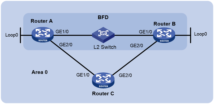

Example: Configuring BFD for IS-IS
·     As shown in Figure 16, run IS-IS on Router A, Router B and Router C so that they can reach each other at the network layer.
·     After the link over which Router A and Router B communicate through the Layer 2 switch fails, BFD can quickly detect the failure and notify IS-IS of the failure. Router A and Router B then communicate through Router C.
Figure 16 Network diagram
Table 4 Interface and IP address assignment
Device
Interface
IP address
Device
Interface
IP address
Router A
GE1/0
192.168.0.102/24
Router B
GE1/0
192.168.0.100/24
GE2/0
10.1.1.102/24
GE2/0
13.1.1.1/24
Loop0
121.1.1.1/32
Loop0
120.1.1.1/32
Router C
GE1/0
10.1.1.100/24
GE2/0
13.1.1.2/24
[RouterA] isis
[RouterA] interface loopback 0
[RouterA-LoopBack0] isis enable
[RouterA-LoopBack0] quit
[RouterA] interface gigabitethernet 2/0
[RouterA-GigabitEthernet2/0] isis enable
[RouterA-GigabitEthernet2/0] quit
[RouterB] isis
[RouterB] interface loopback 0
[RouterB-LoopBack0] isis enable
[RouterB-LoopBack0] quit
[RouterB] interface gigabitethernet 2/0
[RouterB-GigabitEthernet2/0] isis enable
[RouterB-GigabitEthernet2/0] quit
[RouterC] isis
3.     Configure BFD functions:
# Enable BFD and configure BFD parameters on Router A.
[RouterA] bfd session init-mode active
[RouterA-GigabitEthernet1/0] isis bfd enable
[RouterA-GigabitEthernet1/0] bfd min-receive-interval 500
[RouterA-GigabitEthernet1/0] bfd min-transmit-interval 500
[RouterA-GigabitEthernet1/0] bfd detect-multiplier 7
# Enable BFD and configure BFD parameters on Router B.
[RouterB] bfd session init-mode active
[RouterB-GigabitEthernet1/0] isis bfd enable
[RouterB-GigabitEthernet1/0] bfd min-receive-interval 500
[RouterB-GigabitEthernet1/0] bfd min-transmit-interval 500
[RouterB-GigabitEthernet1/0] bfd detect-multiplier 8
# Display the BFD session information on Router A.
<RouterA> display bfd session
Total sessions: 1        Up sessions: 1        Init mode: Active
 IPv4 session working in control packet mode:
 LD/RD           SourceIP        DestinationIP   State   Holdtime    Interface
 3/1             192.168.0.102   192.168.0.100   Up      1700ms      GE1/0

Example: Configuring IS-IS FRR
As shown in Figure 17, Router A, Router B, and Router C reside in the same IS-IS routing domain.
·     Run IS-IS on all the routers to interconnect them with each other.
·     Configure IS-IS FRR so that when Link A fails, traffic can be switched to Link B immediately.
Figure 17 Network diagram

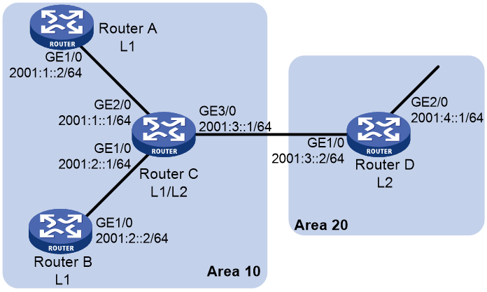

IPv6 IS-IS configuration examples
Example: Configuring IPv6 IS-IS basics
As shown in Figure 18, Router A, Router B, Router C, and Router D, all enabled with IPv6, reside in the same AS. Configure IPv6 IS-IS on the routers so that they can reach each other.
Figure 18 Network diagram
1.     Configure IPv6 addresses for interfaces. (Details not shown.)
2.     Configure IPv6 IS-IS:
[RouterA] isis 1
[RouterA-isis-1] address-family ipv6
[RouterA-isis-1-ipv6] quit
[RouterA-GigabitEthernet1/0] isis ipv6 enable 1
[RouterB] isis 1
[RouterB-isis-1] address-family ipv6
[RouterB-isis-1-ipv6] quit
[RouterB-GigabitEthernet1/0] isis ipv6 enable 1
[RouterC] isis 1
[RouterC-isis-1] address-family ipv6
[RouterC-isis-1-ipv6] quit
[RouterC-GigabitEthernet1/0] isis ipv6 enable 1
[RouterC-GigabitEthernet2/0] isis ipv6 enable 1
[RouterC-GigabitEthernet3/0] isis ipv6 enable 1
[RouterD] isis 1
[RouterD-isis-1] address-family ipv6
[RouterD-isis-1-ipv6] quit
[RouterD-GigabitEthernet1/0] isis ipv6 enable 1
[RouterD-GigabitEthernet2/0] isis ipv6 enable 1
# Display the IPv6 IS-IS routing table on Router A.
[RouterA] display isis route ipv6
                         Level-1 IPv6 forwarding table
 Destination : ::                                      PrefixLen: 0
 Flag        : R/-/-                                   Cost     : 10
 Next hop    : FE80::200:FF:FE0F:4                     Interface: GE1/0
 Destination : 2001:1::                                PrefixLen: 64
 Flag        : D/L/-                                   Cost     : 10
 Next hop    : Direct                                  Interface: GE1/0
 Destination : 2001:2::                                PrefixLen: 64
 Flag        : R/-/-                                   Cost     : 20
 Destination : 2001:3::                                PrefixLen: 64
# Display the IPv6 IS-IS routing table on Router B.
[RouterB] display isis route ipv6

# Display the IPv6 IS-IS routing table on Router C.
[RouterC] display isis route ipv6
 Next hop    : Direct                                  Interface: GE2/0
 Next hop    : Direct                                  Interface: GE3/0
                         Level-2 IPv6 forwarding table
 Destination : 2001:4::1                               PrefixLen: 64
# Display the IPv6 IS-IS routing table on Router D.
[RouterD] display isis route ipv6
 Flag        : D/L/-                                   Cost     : 0
Example: Configuring BFD for IPv6 IS-IS
As shown in Figure 19:
·     Configure IPv6 IS-IS on Router A, Router B, and Router C so that they can reach each other.
·     Enable BFD on GigabitEthernet 1/0 of Router A and Router B.
When the link between Router B and the Layer 2 switch fails, BFD can quickly detect the failure and notify IPv6 IS-IS of the failure. Then Router A and Router B communicate through Router C.
Figure 19 Network diagram
Table 6 Interface and IP address assignment
Device
Interface
IPv6 address
Device
Interface
IPv6 address
Router A
GE1/0
2001::1/64
Router B
GE1/0
2001::2/64
GE2/0
2001:2::1/64
GE2/0
2001:3::2/64
Router C
GE1/0
2001:2::2/64
GE2/0
2001:3::1/64
[RouterA] isis 1
[RouterA-GigabitEthernet2/0] isis ipv6 enable 1
[RouterB] isis 1
[RouterB-GigabitEthernet2/0] isis ipv6 enable 1
[RouterC] isis 1
[RouterC-GigabitEthernet1/0 quit
[RouterA-GigabitEthernet1/0] isis ipv6 bfd enable
[RouterA-GigabitEthernet1/0] return
[RouterB-GigabitEthernet1/0] isis ipv6 bfd enable
[RouterB-GigabitEthernet1/0] bfd detect-multiplier 6
# Display BFD session information on Router A.
 IPv6 session working in control packet mode:
       Local discr: 1441                 Remote discr: 1450
         Source IP: FE80::20F:FF:FE00:1202 (link-local address of GigabitEthernet1/0 on Router A)
    Destination IP: FE80::20F:FF:FE00:1200 (link-local address of GigabitEthernet1/0 on Router B)
     Session state: Up                      Interface: GE1/0
         Hold time: 2319ms
# Display routes destined for 2001:4::0/64 on Router A.
<RouterA> display ipv6 routing-table 2001:4::0 64
Summary Count : 2
Destination: 2001:4::/64                                 Protocol  : IS_L1
NextHop    : FE80::20F:FF:FE00:1200                      Preference: 15
Interface  : GE1/1/0                                     Cost      : 10
The output shows that Router A and Router B communicate through GigabitEthernet 1/0. Then the link over GigabitEthernet 1/0 fails.
Summary Count : 1
NextHop    : FE80::BAAF:67FF:FE27:DCD0                   Preference: 15
Interface  : GE1/2/0                                     Cost      : 20
The output shows that Router A and Router B communicate through GigabitEthernet 2/0.
