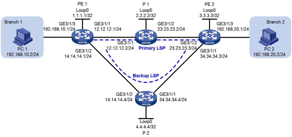

Example: Configuring BFD for an LSP
As shown in Figure 1, Branch 1 and Branch 2 of a company are connected to each other through an MPLS backbone of the ISP. The branches need to exchange real-time data.
To ensure high availability of the real-time service between the branches, deploy LDP FRR on the MPLS backbone to provide a primary LSP and a backup LSP. Configure BFD for the primary LSP, so when the primary LSP fails, BFD can quickly detect the failure and notify LDP of the failure to trigger a traffic switchover to the backup LSP.
Figure 1 Network diagram
Procedures

5.     Enable BFD for MPLS, and configure BFD to verify connectivity for the LSP:
# Configure PE 1.
[PE1] mpls bfd enable
[PE1] mpls bfd 3.3.3.3 32
# Configure PE 2.
[PE2] mpls bfd enable
[PE2] mpls bfd 1.1.1.1 32
1.     On PE 1 and PE 2, execute the display mpls bfd command to view information about the BFD sessions for the LSPs. Take PE 1 as an example:
[PE1]display mpls bfd
 Total number of sessions: 2, 2 up, 0 down, 0 init
 FEC Type: LSP
 FEC Info:
   Destination: 1.1.1.1
   Mask Length: 32
 NHLFE ID: -
 Local Discr: 1026                   Remote Discr: 514
 Source IP: 1.1.1.1                  Destination IP: 3.3.3.3
 Session State: Up                   Session Role: Active
 Template Name: -
 FEC Type: LSP
 FEC Info:
   Destination: 3.3.3.3
   Mask Length: 32
 NHLFE ID: 1028
 Local Discr: 1025                   Remote Discr: -
 Source IP: 1.1.1.1                  Destination IP: 127.0.0.1
 Session State: Up                   Session Role: Passive
 Template Name: -
2.     On PE 1, execute the tracert mpls ipv4 command to verify that the current LSP in use is the primary LSP. (To use the tracert feature, you must also enable sending of ICMP time exceeded messages on the transit devices and enable sending of ICMP destination unreachable messages on the destination device.)
<PE1>tracert mpls -a 192.168.10.1 ipv4 192.168.20.0 24
MPLS trace route FEC 192.168.20.0/24
  TTL   Replier            Time    Type      Downstream
  0                                Ingress   12.12.12.2/[1141]
  1     12.12.12.2         2 ms    Transit   23.23.23.3/[1141]
  2     23.23.23.3         2 ms    Egress
3.     Continuously ping PE 2 from PE 1. During this period, shut down GigabitEthernet 3/1/1 of P 1. Verify the communication between PE 1 and PE 2.
# Continuously ping PE 2 from PE 1.
<PE1>ping -c 100000 -a 192.168.10.1 192.168.20.1
Ping 192.168.20.1 (192.168.20.1) from 192.168.10.1: 56 data bytes, press CTRL_C
to break
56 bytes from 192.168.20.1: icmp_seq=0 ttl=254 time=2.576 ms
56 bytes from 192.168.20.1: icmp_seq=1 ttl=254 time=1.996 ms
# Shut down GigabitEthernet 3/1/1 of P 1.
[P1] interface gigabitethernet3/1/1
[P1-GigabitEthernet3/1/1] shut
# You can see that PE 1 and PE 2 resumed connectivity quickly after a short period of disconnection.
to break
56 bytes from 192.168.20.1: icmp_seq=7 ttl=254 time=2.214 ms
Request time out
56 bytes from 192.168.20.1: icmp_seq=9 ttl=254 time=2.659 ms
56 bytes from 192.168.20.1: icmp_seq=10 ttl=254 time=5.049 ms
56 bytes from 192.168.20.1: icmp_seq=11 ttl=254 time=2.098 ms
56 bytes from 192.168.20.1: icmp_seq=12 ttl=254 time=2.225 ms
56 bytes from 192.168.20.1: icmp_seq=13 ttl=254 time=2.187 ms
--- Ping statistics for 192.168.20.1 ---
14 packet(s) transmitted, 13 packet(s) received, 7.1% packet loss
round-trip min/avg/max/std-dev = 1.990/2.455/5.049/0.772 ms

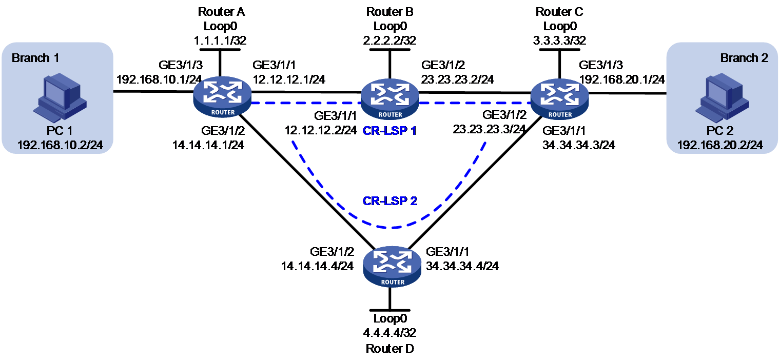

Example: Configuring BFD for an MPLS TE tunnel
As shown in Figure 2, Branch 1 and Branch 2 of a company are connected to each other through an MPLS TE tunnel. The branches need to exchange real-time data.
To ensure high availability of the real-time service between the branches, deploy CRLSP backup for the MPLS TE tunnel to provide a primary CRLSP and a backup CRLSP. Configure BFD for the MPLS TE tunnel, so when the primary CRLSP fails, BFD can quickly detect the failure and notify RSVP of the failure to trigger a traffic switchover to the backup CRLSP.
Figure 2 Network diagram
·     OSPF TE uses Opaque Type 10 LSAs to carry link TE attributes. To configure OSPF TE, you must enable the OSPF Opaque capability. For more information about the OSPF Opaque capability, see OSPF configuration in Layer 3—IP Routing Configuration Guide for the device.
·     MPLS TE cannot reserve resources and allocate labels on OSPF virtual links to establish CRLSPs. To configure OSPF TE, make sure no virtual links exist in OSPF areas.
Procedures
1.     Assign IP addresses to interfaces:

Configuration files
·     Router A:
ospf 1
 area 0.0.0.0
  network 1.1.1.1 0.0.0.0
  network 12.12.12.0 0.0.0.255
  network 14.14.14.0 0.0.0.255
  network 192.168.10.0 0.0.0.255
  mpls te enable
 mpls lsr-id 1.1.1.1
mpls te
explicit-path cr-lsp1
 nexthop index 1 12.12.12.2 include strict
explicit-path cr-lsp2
 nexthop index 1 14.14.14.4 include strict
rsvp
 mpls bfd enable
interface LoopBack0
 ip address 1.1.1.1 255.255.255.255
interface GigabitEthernet3/1/1
 port link-mode route
 ip address 12.12.12.1 255.255.255.0
 mpls enable
 mpls te enable
 rsvp enable
interface GigabitEthernet3/1/2
 ip address 14.14.14.1 255.255.255.0
 mpls enable
 mpls te enable
 rsvp enable
interface GigabitEthernet3/1/3
 ip address 192.168.10.1 255.255.255.0
interface Tunnel3 mode mpls-te
 ip address 9.1.1.1 255.255.255.0
 mpls te path preference 1 explicit-path cr-lsp1
 mpls te path preference 2 explicit-path cr-lsp2
 mpls te backup hot-standby
 mpls bfd
 destination 3.3.3.3
 ip route-static 192.168.20.0 24 Tunnel3 preference 1
·     Router B:
ospf 1
 area 0.0.0.0
  network 2.2.2.2 0.0.0.0
  network 23.23.23.0 0.0.0.255
  mpls te enable
 mpls lsr-id 2.2.2.2
mpls te
rsvp
interface LoopBack0
 ip address 2.2.2.2 255.255.255.255
 ip address 12.12.12.2 255.255.255.0
 mpls enable
 mpls te enable
 rsvp enable
 ip address 23.23.23.2 255.255.255.0
 mpls enable
 mpls te enable
 rsvp enable
·     Router C:
ospf 1
 area 0.0.0.0
  network 3.3.3.3 0.0.0.0
  network 34.34.34.0 0.0.0.255
  network 192.168.20.0 0.0.0.255
  mpls te enable
 mpls lsr-id 3.3.3.3
mpls te
 nexthop index 1 23.23.23.2 include strict
 nexthop index 1 34.34.34.4 include strict
rsvp
 mpls bfd enable
interface LoopBack0
 ip address 3.3.3.3 255.255.255.255
 ip address 34.34.34.3 255.255.255.0
 mpls enable
 mpls te enable
 rsvp enable
 ip address 23.23.23.3 255.255.255.0
 mpls enable
 mpls te enable
 rsvp enable
 ip address 192.168.20.1 255.255.255.0
 ip address 9.3.3.3 255.255.255.0
 mpls bfd
 destination 1.1.1.1
 ip route-static 192.168.10.0 24 Tunnel3 preference 1
·     Router D:
ospf 1
 area 0.0.0.0
  network 4.4.4.4 0.0.0.0
  mpls te enable
 mpls lsr-id 4.4.4.4
mpls te
rsvp
interface LoopBack0
 ip address 4.4.4.4 255.255.255.255
 ip address 34.34.34.4 255.255.255.0
 mpls enable
 mpls te enable
 rsvp enable
 ip address 14.14.14.4 255.255.255.0
 mpls enable
 mpls te enable
 rsvp enable
Related documentation
·     H3C SR8800-F Routers MPLS Configuration Guide-R7951P01
·     H3C SR8800-F Routers MPLS Command Reference-R7951P01
