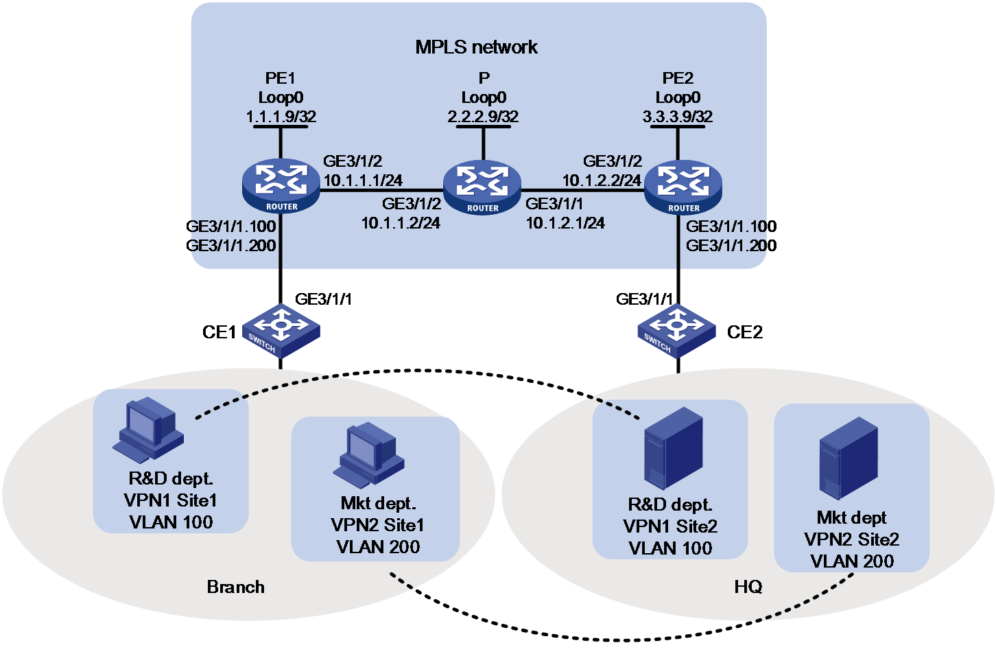

Example: Configuring LDP PWs
As shown in Figure 1, the MPLS network provides L2VPN services for a customer. Configure LDP PWs between PE 1 and PE 2 so the R&D and Marketing departments use different VPN connections to achieve data isolation.
Figure 1 Network diagram
Analysis
To use LDP PWs to implement MPLS L2VPN, configure two levels of labels:
·     Inner labelsPW labels dynamically generated by LDP.
·     Outer labels—Public tunnel labels dynamically generated by LDP in this example.
To identify packets to be transported by MPLS L2VPN, configure subinterfaces on the CE-facing ports of PEs.
Procedures

3.     Configure a subinterface for each department and bind the subinterfaces to their respective VPN connections:
# On PE 1, enable MPLS L2VPN globally.
[PE1] l2vpn enable
# On PE 1, create subinterfaces GigabitEthernet 3/1/1.100 and GigabitEthernet 3/1/1.200.
[PE1] interface GigabitEthernet 3/1/1.100
[PE1-GigabitEthernet3/1/1.100] vlan-type dot1q vid 100
[PE1-GigabitEthernet3/1/1.100] quit
[PE1] interface GigabitEthernet 3/1/1.200
[PE1-GigabitEthernet3/1/1.200] vlan-type dot1q vid 200
[PE1-GigabitEthernet3/1/1.200] quit
# On PE 1, create cross-connect group vpna, create cross-connect ldp in the group, and bind GigabitEthernet3/1/1.100 to the cross-connect.

# Display L2VPN PW information on PE 1. The output shows that two LDP PWs have been established.
[PE1] display l2vpn pw
Flags: M - main, B - backup, H - hub link, S - spoke link, N - no split horizon
Total number of PWs: 2, 2 up, 0 blocked, 0 down, 0 defect
Xconnect-group Name: vpna
Peer            PW ID      In/Out Label    Proto  Flag  Link ID    State
3.3.3.9         100        65663/65663     LDP    M     1          Up
Xconnect-group Name: vpnb
3.3.3.9         200        65662/65662     LDP    M     1          Up
# Display L2VPN PW information on PE 2. The output shows that two LDP PWs have been established.
[PE2] display l2vpn pw
1.1.1.9         100        65663/65663     LDP    M     1          Up
1.1.1.9         200        65662/65662     LDP    M     1          Up
# Verify that the host and the server in the same VLAN can ping each other. (Details not shown.)

xconnect-group vpna
 connection ldp
  ac interface GigabitEthernet3/1/1.100
  peer 1.1.1.9 pw-id 100
xconnect-group vpnb
 connection ldp
  ac interface GigabitEthernet3/1/1.200
  peer 1.1.1.9 pw-id 200

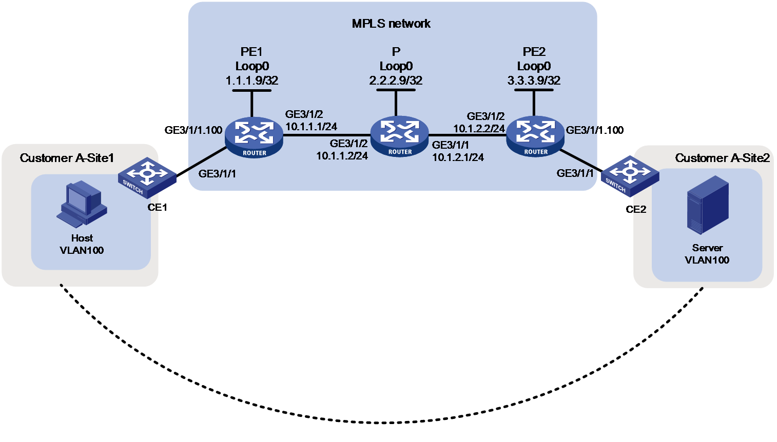

Example: Configuring a BGP PW
As shown in Figure 2, a customer has two VPN sites and will add eight sites in the future. Configure a BGP PW between PE 1 and PE 2 to allow VPN communication between the two sites and reserve enough VPN resources for future extension.
Figure 2 Network diagram
Analysis
To use BGP PWs to implement MPLS L2VPN, configure two levels of labels:
·     Inner labelsPW labels dynamically generated by BGP.
To use BGP to transmit inner labels between PEs, create a subinterface and an IBGP connection, and specify the peer PE as a BGP peer on each PE.
To simplify configuration required by future expansion of the customer network, set the maximum number of CEs in the VPN to 10.
Procedures
