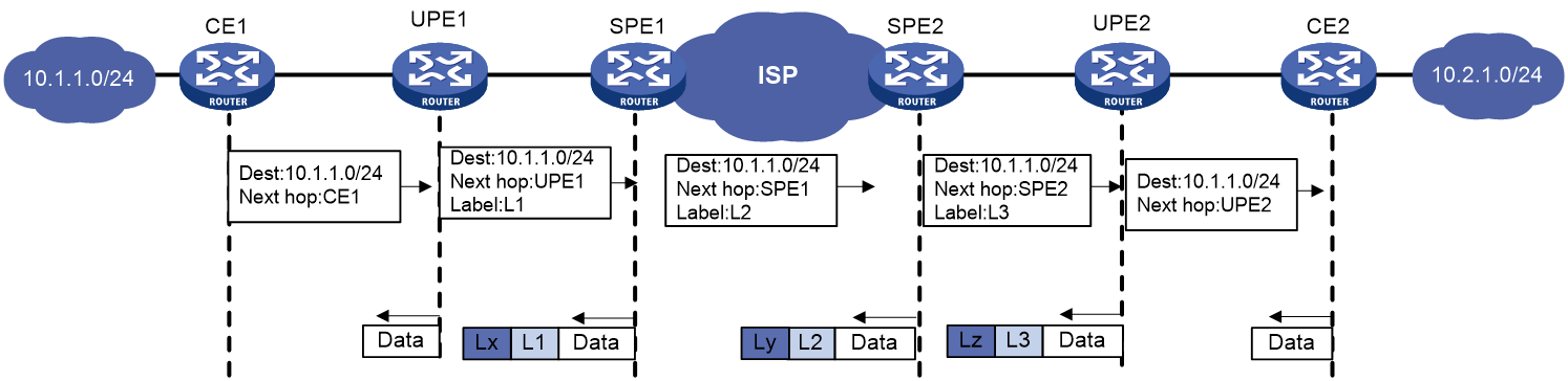

Hierarchy of VPN (HoVPN) divides PEs into underlayer PEs (UPEs) or user-end PEs, and superstratum PEs (SPEs) or service provider-end PEs. UPEs and SPEs form a hierarchical PE structure.
UPEs and SPEs together provide the functions of a conventional PE.
·     UPE—Provides user access. It maintains the routes of directly connected VPN sites. It does not maintain the routes of the remote sites in the VPN, or it only maintains their summary routes. A UPE assigns inner labels to the routes of its directly connected sites, and advertises the labels along with VPN routes to the SPE through MP-BGP.
·     SPE—Manages and advertises VPN routes. It maintains all the routes of the VPNs connected through UPEs, including the routes of both the local and remote sites. An SPE advertises routes along with labels to UPEs, including the default routes of VPN instances or summary routes and the routes permitted by the routing policy. By using routing policies, you can control which sites in a VPN can communicate with each other.
Figure 1 Routing process and label exchange for HoVPN

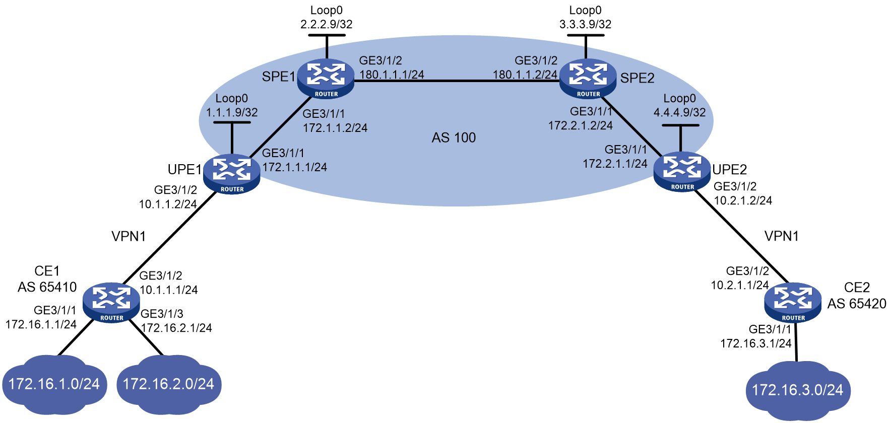

As shown in Figure 2, the SPE devices and UPE devices are in AS 100. The SPEs are ISP backbone devices. The UPEs are connected to the CEs of the user network. CE 1 and CE 2 belong to VPN 1.
Configure HoVPN and advertise default routes to allow communication between CE 1 (172.16.1.0/24 and 172.16.2.0/24) and CE 2 (172.16.3.0/24).
Figure 2 Network diagram
Analysis
To allow communication between CE 1 and CE 2, configure each SPE to advertise the default route of the VPN instance to its peer.
Associating an interface with a VPN instance deletes the IP address of the interface. You must reconfigure the IP address of the interface after the association. To avoid configuring the interface's IP address twice, configure the association first.

6.     Configure default routes to allow CE 1 and CE 2 to communicate with each other:
# On SPE 1, advertise the default route of the VPN instance to UPE 1.
[SPE1] bgp 100
[SPE1-bgp] address-family vpnv4
[SPE1-bgp-vpnv4] peer 1.1.1.9 default-route-advertise vpn-instance vpn1
# On SPE 2, advertise the default route of the VPN instance to UPE 2.
[SPE2] bgp 100
[SPE2-bgp-default] address-family vpnv4
[SPE2-bgp-default-vpnv4] peer 4.4.4.9 default-route-advertise vpn-instance vpn1
# Configure a default route on CE 1.
[CE1] ip route-static 0.0.0.0 0 10.1.1.2
# Configure a default route on CE 2.
[CE2] ip route-static 0.0.0.0 0 10.2.1.2
# Verify that CE 1 has learned the route to subnet 172.16.3.0/24 of CE 2.
[CE1] display ip routing-table
Destinations : 25        Routes : 25
0.0.0.0/0           Static 60   0            10.1.1.2        GE3/1/2
172.16.1.0/24       Direct 0    0            172.16.1.1      GE3/1/1
172.16.1.0/32       Direct 0    0            172.16.1.1      GE3/1/1
172.16.1.1/32       Direct 0    0            127.0.0.1       InLoop0
172.16.1.255/32     Direct 0    0            172.16.1.1      GE3/1/1
172.16.2.0/24       Direct 0    0            172.16.2.1      GE3/1/3
172.16.2.0/32       Direct 0    0            172.16.2.1      GE3/1/3
172.16.2.1/32       Direct 0    0            127.0.0.1       InLoop0
172.16.2.255/32     Direct 0    0            172.16.2.1      GE3/1/3
CE 1-connected networks (172.16.1.0/24 and 172.16.2.0/24) and CE 2-connected network (172.16.3.0/24) can communicate with each other.
