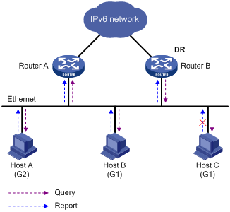

Joining an IPv6 multicast group
Figure 1 MLD queries and reports
As shown in Figure 1, Host B and Host C want to receive the IPv6 multicast data addressed to IPv6 multicast group G1. Host A wants to receive the IPv6 multicast data addressed to G2. The following process describes how the hosts join the IPv6 multicast groups and how the MLD querier (Router B in Figure 1) maintains the IPv6 multicast group memberships:
1.      The hosts send unsolicited MLD reports to the IPv6 multicast groups they want to join without having to wait for the MLD queries.
2.      The MLD querier periodically multicasts MLD queries (with the destination address FF02::1) to all hosts and routers on the local subnet.
3.      After receiving a query, the host whose report delay timer expires first sends an MLD report to the IPv6 multicast group G1 to announce its membership for G1. In this example, Host B sends the report. After hearing the report from Host B, Host C, which is on the same subnet as Host B, suppresses its own report for G1.
Because the MLD routers already know that G1 has a minimum of one member, other members do not need to report their memberships. This mechanism, known as the host MLD report suppression, helps reduce traffic on the local subnet.
4.      At the same time, because Host A is interested in G2, it sends a report to the IPv6 multicast group G2.
5.      Through the query/report process, the MLD routers determine that G1 and G2 have members on the local subnet. The IPv6 multicast routing protocol (for example, IPv6 PIM) that is running on the routers generates (*, G1) and (*, G2) multicast forwarding entries. These entries are the basis for subsequent IPv6 multicast forwarding. The asterisk (*) represents any IPv6 multicast source.
6.      When the IPv6 multicast data addressed to G1 or G2 reaches an MLD router, the router looks up the IPv6 multicast forwarding table. Based on the (*, G1) and (*, G2) entries, the router forwards the IPv6 multicast data to the local subnet. Then, the receivers on the subnet receive the data.

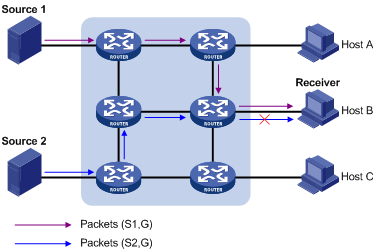

As shown in Figure 2, the network has two IPv6 multicast sources, Source 1 (S1) and Source 2 (S2). Both of the sources can send IPv6 multicast data to IPv6 multicast group G. Host B wants to receive IPv6 multicast data addressed to G from Source 1 but not from Source 2.
Figure 2 Flow paths of multicast-address-and-source-specific multicast traffic
In MLDv1, Host B cannot select IPv6 multicast sources when it joins IPv6 multicast group G. The IPv6 multicast streams from both Source 1 and Source 2 flow to Host B whether it needs them or not.
In MLDv2, Host B can explicitly express its interest in IPv6 multicast data destined to G from Source 1 but not from Source 2. Then, Host B receives only IPv6 multicast data from Source 1.

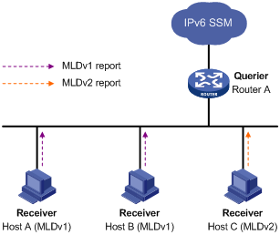

MLD SSM mapping
An MLDv2 host can explicitly specify multicast sources in its MLDv2 reports. From the reports, the MLD router can obtain the multicast source addresses and directly provide the SSM service. However, an MLDv1 host cannot specify multicast sources in its MLDv1 reports.
The MLD SSM mapping feature enables the MLD router to provide SSM support for MLDv1 receiver host. The router translates (*, G) in MLDv1 reports into (G, INCLUDE, (S1, S2...)) based on the configured MLD SSM mappings.
Figure 3 Network diagram
As shown in Figure 3, Host A and Host B on the IPv6 SSM network run MLDv1, and Host C runs MLDv2. To provide the SSM service for Host A and Host B, you must configure the MLD SSM mapping feature on Router A.
After MLD SSM mappings are configured, Router A checks the IPv6 multicast group address G carried in the message, and performs the following operations:
·           If G is not in the IPv6 SSM group range, Router A provides the ASM service.
·           If G is in the IPv6 SSM group range but does not match any MLD SSM mapping, Router A drops the report.
·           If G is in the IPv6 SSM group range and matches MLD SSM mappings, Router A translates (*, G) in the report to (G, INCLUDE, (S1, S2...)) to provide SSM services.
The MLD SSM mapping feature does not process MLDv2 reports.

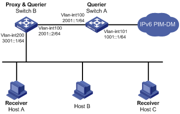

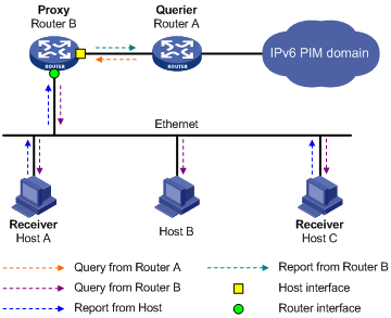

MLD proxying
As shown in Figure 4, in a simple tree-shaped topology, it is not necessary to configure IPv6 multicast routing protocols, such as IPv6 PIM, on edge devices. Instead, you can configure MLD proxying on these devices. With MLD proxying configured, the edge device acts as an MLD proxy:
·           For the upstream MLD querier, the MLD proxy device acts as a host.
·           For the downstream receiver hosts, the MLD proxy device acts as an MLD querier.
Figure 4 Network diagram
The following interfaces are defined in MLD proxying:
·           Host interface—An interface that is in the direction toward the root of the multicast forwarding tree. A host interface acts as a receiver host that is running MLD. MLD proxying must be enabled on this interface. This interface is also called the "proxy interface."
·           Router interface—An interface that is in the direction toward the leaf of the multicast forwarding tree. A router interface acts as a router that is running MLD. MLD must be configured on this interface.
An MLD proxy device maintains a group membership database, which stores the group memberships on all the router interfaces. The host interfaces and router interfaces perform actions based on this membership database.
·           The host interfaces respond to queries according to the membership database or sends join/done messages when the database changes.
·           The router interfaces participate in the querier election, send queries, and maintain memberships based on received MLD reports.

Configuring MLD SSM mappings
This feature enables the device to provide SSM services for MLDv1 hosts.
This feature does not process MLDv2 messages. Enable MLDv2 on the receiver-side interface to ensure that MLDv2 reports from MLDv2 receiver hosts can be processed.
Configuration prerequisites
Before you configure MLD SSM mappings, complete the following tasks:
·           Configure an IPv6 unicast routing protocol so that all devices in the domain can interoperate at the network layer.
·           Configure basic MLD features.
Configuration procedure
To configure an MLD SSM mapping:
Step
Remarks
1.      Enter system view.
N/A
2.      Enter MLD view.
mld [ vpn-instance vpn-instance-name ]
N/A
3.      Configure an MLD SSM mapping.
ssm-mapping ipv6-source-address ipv6-acl-number
By default, no MLD SSM mappings exist.
Configuring MLD proxying
This section describes how to configure MLD proxying.
Before you configure the MLD proxying feature, complete the following tasks:
·           Configure any IPv6 unicast routing protocol so that all devices in the domain can interoperate at the network layer.
·           Determine the router interfaces and host interface based on the network topology.
·           Enable MLD on the router interfaces.
Enabling MLD proxying
When you enable MLD proxying, follow these restrictions and guidelines:
·           You must enable MLD proxying on the receiver-side interfaces.
·           On an interface enabled with MLD proxying, only the mld version command takes effect and other MLD commands do not take effect.
·           If you enable both MLD proxying and an IPv6 multicast routing protocol on the same device, the IPv6 multicast routing protocol does not take effect.
To enable MLD proxying:
Step
Remarks
N/A
2.      Enable IPv6 multicast routing and enter IPv6 MRIB view.
ipv6 multicast routing [ vpn-instance vpn-instance-name ]
By default, IPv6 multicast routing is disabled.
3.      Return to system view.
N/A
4.      Enter interface view.
N/A
5.      Enable MLD proxying.
mld proxy enable
By default, MLD proxying is disabled.
Enabling IPv6 multicast forwarding on a non-querier interface
Typically, only MLD queriers can forward IPv6 multicast traffic and non-queriers cannot. This prevents IPv6 multicast data from being repeatedly forwarded. If a router interface on the MLD proxy failed the querier election, enable IPv6 multicast forwarding on the interface to forward IPv6 multicast data to downstream receivers.
A shared-media network might have multiple MLD proxies, including one proxy acting as a querier. To avoid duplicate IPv6 multicast traffic, do not enable IPv6 multicast forwarding on any of the non-querier MLD proxies for the network.
To enable IPv6 multicast forwarding on a non-querier interface:
Step
Remarks
N/A
2.      Enter interface view.
N/A
3.      Enable multicast forwarding on the interface.
mld proxy forwarding
By default, IPv6 multicast forwarding is disabled on a non-querier interface.
Configuring IPv6 multicast load splitting on an MLD proxy
This feature enables all proxy interfaces on an MLD proxy device to share IPv6 multicast traffic on a per-group basis.
To enable IPv6 multicast load splitting on an MLD proxy:
Step
Remarks
N/A
2.      Enter MLD view.
N/A
3.      Enable IPv6 multicast load splitting.
proxy multipath
By default, IPv6 multicast load splitting is disabled, and only the proxy interface with the highest IP address forwards IPv6 multicast data.

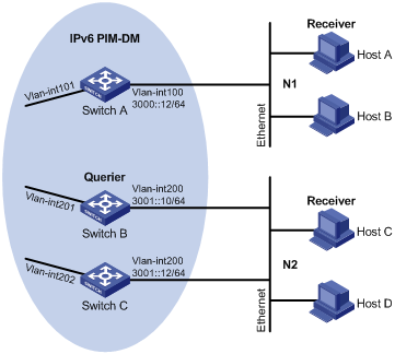

MLD configuration examples
Basic MLD features configuration examples
Network requirements
As shown in Figure 5:
·           OSPFv3 and IPv6 PIM-DM run on the network.
·           VOD streams are sent to receiver hosts in multicast. Receiver hosts of different organizations form stub networks N1 and N2. Host A and Host C are multicast receiver hosts in N1 and N2, respectively.
·           MLDv1 runs between Switch A and N1, and between the other two switches (Switch B and Switch C) and N2.
·           Switch A acts as the MLD querier in N1. Switch B acts as the MLD querier in N2 because it has a lower IPv6 address.
Configure the switches to meet the following requirements:
·           The hosts in N1 can join only IPv6 multicast group FF1E::101,.
·           The hosts in N2 can join any IPv6 multicast groups.
Figure 5 Network diagram
1.      Assign an IPv6 address and prefix length to each interface, as shown in Figure 5. (Details not shown.)
2.      Configure OSPFv3 on the switches in the IPv6 PIM-DM domain. (Details not shown.)
3.      Enable the IPv6 multicast routing, MLD, and IPv6 PIM-DM:
# On Switch A, enable IPv6 multicast routing.
<SwitchA> system-view
[SwitchA] ipv6 multicast routing
[SwitchA-mrib6] quit
# Enable MLD on VLAN-interface 100.
[SwitchA-Vlan-interface100] mld enable
# Enable IPv6 PIM-DM on VLAN-interface 101.
[SwitchA] interface vlan-interface 101
[SwitchA-Vlan-interface101] ipv6 pim dm
[SwitchA-Vlan-interface101] quit
# On Switch B, enable IPv6 multicast routing.
<SwitchB> system-view
[SwitchB] ipv6 multicast routing
[SwitchB-mrib6] quit
# Enable MLD on VLAN-interface 200.
[SwitchB] interface vlan-interface 200
[SwitchB-Vlan-interface200] mld enable
[SwitchB-Vlan-interface200] quit
# Enable IPv6 PIM-DM on VLAN-interface 201.
[SwitchB] interface vlan-interface 201
[SwitchB-Vlan-interface201] ipv6 pim dm
[SwitchB-Vlan-interface201] quit
# On Switch C, enable IPv6 multicast routing.
<SwitchC> system-view
[SwitchC] ipv6 multicast routing
[SwitchC-mrib6] quit
[SwitchC] interface vlan-interface 200
[SwitchC-Vlan-interface200] mld enable
[SwitchC-Vlan-interface200] quit
# Enable IPv6 PIM-DM on VLAN-interface 202.
[SwitchC] interface vlan-interface 202
[SwitchC-Vlan-interface202] ipv6 pim dm
[SwitchC-Vlan-interface202] quit
4.      Configure an IPv6 multicast group policy on Switch A so that the hosts connected to VLAN-interface 100 can join only IPv6 multicast group FF1E::101.
[SwitchA] acl ipv6 basic 2001
[SwitchA-acl-ipv6-basic-2001] rule permit source ff1e::101 128
[SwitchA-acl-ipv6-basic-2001] quit
[SwitchA-Vlan-interface100] mld group-policy 2001
# Display MLD information for VLAN-interface 200 on Switch B.
[SwitchB] display mld interface vlan-interface 200
 Vlan-interface200(FE80::200:5EFF:FE66:5100):
   MLD is enabled.
   MLD version: 1
   Query interval for MLD: 125s
   Other querier present time for MLD: 255s
   Maximum query response time for MLD: 10s
   Querier for MLD: FE80::200:5EFF:FE66:5100 (This router)
  MLD groups reported in total: 1

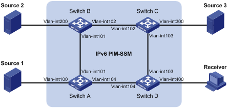

MLD SSM mapping configuration example
As shown in Figure 6:
·           OSPFv3 runs on the network.
·           The IPv6 PIM-SM domain uses the SSM model for IPv6 multicast delivery. The SSM group range is FF3E::/64.
·           MLDv2 runs on VLAN-interface 400 of Router D. The receiver host runs MLDv1, and does not support MLDv2. The receiver host cannot specify IPv6 multicast sources in its membership reports.
·           Source 1, Source 2, and Source 3 send IPv6 multicast packets to multicast groups in IPv6 SSM group range FF3E::/64.
Configure the MLD SSM mapping feature on Switch D so that the receiver host will receive IPv6 multicast data only from Source 1 and Source 3.
Figure 6 Network diagram
Table 1 Interface and IPv6 address assignment
Device
Interface
IPv6 address
Device
Interface
IPv6 address
Source 1
1001::1/64
Source 3
3001::1/64
Source 2
2001::1/64
Receiver
4001::1/64
Switch A
Vlan-int100
1001::2/64
Switch C
Vlan-int300
3001::2/64
Switch A
Vlan-int101
1002::1/64
Switch C
Vlan-int103
3002::1/64
Switch A
Vlan-int104
1003::1/64
Switch C
Vlan-int102
2002::2/64
Switch B
Vlan-int200
2001::2/64
Switch D
Vlan-int400
4001::2/64
Switch B
Vlan-int101
1002::2/64
Switch D
Vlan-int103
3002::2/64
Switch B
Vlan-int102
2002::1/64
Switch D
Vlan-int104
1003::2/64
1.      Assign an IPv6 address and prefix length to each interface, as shown in Table 1. (Details not shown.)
2.      Configure OSPFv3 on the switches in the IPv6 PIM-SM domain. (Details not shown.)
3.      Enable IPv6 multicast routing, and enable IPv6 PIM-SM and MLD:
# On Switch D, enable IPv6 multicast routing.
<SwitchD> system-view
[SwitchD] ipv6 multicast routing
[SwitchD-mrib6] quit
# Enable MLDv2 on the receiver-side interface (VLAN-interface 400).
[SwitchD] interface vlan-interface 400
[SwitchD-Vlan-interface400] mld enable
[SwitchD-Vlan-interface400] mld version 2
[SwitchD-Vlan-interface400] quit
# Enable IPv6 PIM-SM on the other interfaces.
[SwitchD] interface vlan-interface 103
[SwitchD-Vlan-interface103] ipv6 pim sm
[SwitchD-Vlan-interface103] quit
[SwitchD] interface vlan-interface 104
[SwitchD-Vlan-interface104] ipv6 pim sm
[SwitchD-Vlan-interface104] quit

4.      Configure the IPv6 SSM group range:
# On Switch D, specify FF3E::/64 as the IPv6 SSM group range.
[SwitchD] acl ipv6 basic 2000
[SwitchD-acl-ipv6-basic-2000] rule permit source ff3e:: 64
[SwitchD-acl-ipv6-basic-2000] quit
[SwitchD] pim ipv6
[SwitchD-pim6] ssm-policy 2000
[SwitchD-pim6] quit
# Configure Switch A, Switch B and Switch C in the same way Switch D is configured. (Details not shown.)
5.      Configure MLD SSM mappings on Switch D.
[SwitchD] mld
[SwitchD-mld] ssm-mapping 1001::1 2000
[SwitchD-mld] ssm-mapping 3001::1 2000
[SwitchD-mld] quit
# Display MLD SSM mappings for IPv6 multicast group FF3E::101 on Switch D.
[SwitchD] display mld ssm-mapping ff3e::101
 Group: FF3E::101
 Source list:
        1001::1
        3001::1
# On Switch D, display information about MLD multicast groups that hosts have dynamically joined.
[SwitchD] display mld group
MLD groups in total: 1
 Vlan-interface400(FE80::101):
   Group address: FF3E::101
    Last reporter: FE80::1
    Uptime: 00:02:04
    Expires: Off
# Display IPv6 PIM routing entries on Switch D.
[SwitchD] display ipv6 pim routing-table
 Total 0 (*, G) entry; 2 (S, G) entry
 (1001::1, FF3E::101)
     Protocol: pim-ssm, Flag:
     UpTime: 00:13:25
     Upstream interface: Vlan-interface104
         Upstream neighbor: FE80::1
         RPF prime neighbor: FE80::1
     Downstream interface(s) information:
     Total number of downstreams: 1
         1: Vlan-interface400
             Protocol: mld, UpTime: 00:13:25, Expires: -
 (3001::1, FF3E::101)
     UpTime: 00:13:25
     Upstream interface: Vlan-interface103
MLD proxying configuration example
As shown in Figure 7:
·           IPv6 PIM-DM runs on the core network.
·           Host A and Host C on the stub network receive VOD information destined to IPv6 multicast group FF3E::101.
Configure the MLD proxying feature on Switch B so that Switch B can maintain group memberships and forward IPv6 multicast traffic without running IPv6 PIM-DM.
Figure 7 Network diagram
1.      Assign an IPv6 address and prefix length to each interface, as shown in Figure 7. (Details not shown.)
2.      Enable IPv6 multicast routing, IPv6 PIM-DM, MLD, and MLD proxying:
[SwitchB] multicast ipv6 routing-enable
# Enable MLD proxying on VLAN-interface 100.
[SwitchB-Vlan-interface100] mld proxying enable
# Display IPv6 multicast group membership information maintained by the MLD proxy on Switch B.
[SwitchB] display mld proxy group
MLD proxy group records in total: 1
 Vlan-interface100(FE80::16:1):
    Member state: Delay
    Expires: 00:00:02
