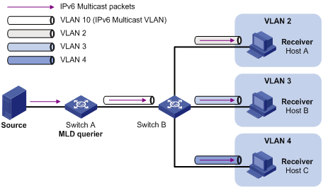

As shown in Figure 1, Host A, Host B, and Host C are in different VLANs and the same IPv6 multicast group. When Switch A (Layer 3 device) receives IPv6 multicast data for that group, it forwards three copies of the data to Switch B (Layer 2 device). This occupies a large amount of bandwidth and increases the burden on the Layer 3 device.
Figure 1 Multicast transmission without the IPv6 multicast VLAN feature
After an IPv6 multicast VLAN is configured on Switch B, Switch A sends one copy of the IPv6 multicast data to the IPv6 multicast VLAN on Switch B. This saves network bandwidth and lessens the burden on the Layer 3 device.

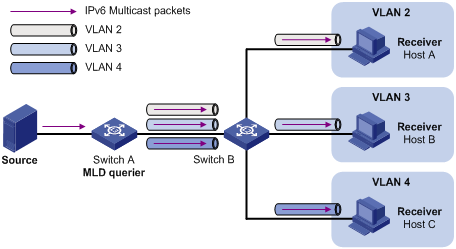

Sub-VLAN-based IPv6 multicast VLAN
As shown in Figure 2:
·           Host A, Host B, and Host C are in VLAN 2 through VLAN 4, respectively.
·           On Switch B, VLAN 10 is an IPv6 multicast VLAN. VLAN 2 through VLAN 4 are sub-VLANs of VLAN 10.
·           MLD snooping is enabled for the multicast VLAN and its sub-VLANs.
Figure 2 Sub-VLAN-based multicast VLAN
MLD snooping manages router ports in the IPv6 multicast VLAN and member ports in each sub-VLAN. When Switch A receives IPv6 multicast data from the IPv6 multicast source, it sends only one copy of the IPv6 multicast data to the IPv6 multicast VLAN on Switch B. Then, Switch B sends a separate copy to each sub-VLAN of the IPv6 multicast VLAN.

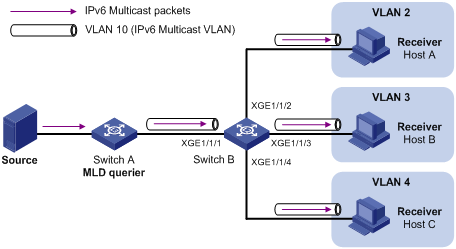

As shown in Figure 4:
·           Layer 3 device Switch A runs MLD and acts as the MLD querier. Layer 2 device Switch B runs MLDv1 snooping.
·           The IPv6 multicast source sends IPv6 multicast data to IPv6 multicast group FF1E::101. Receivers Host A, Host B, and Host C belong to VLAN 2, VLAN 3, and VLAN 4, respectively.
Configure a sub-VLAN-based IPv6 multicast VLAN on Switch B to meet the following requirements:
·           Switch A sends the IPv6 multicast data to Switch B through the IPv6 multicast VLAN.
·           Switch B forwards the IPv6 multicast data to the receivers in different user VLANs.
Figure 4 Network diagram

# Configure VLAN 10 as an IPv6 multicast VLAN, and assign VLAN 2 through VLAN 4 as sub-VLANs to multicast VLAN 10.
[SwitchB] ipv6 multicast-vlan 10
[SwitchB-ipv6-mvlan-10] subvlan 2 to 4
[SwitchB-ipv6-mvlan-10] quit
# Display information about all IPv6 multicast VLANs on Switch B.
[SwitchB] display ipv6 multicast-vlan
Total 1 IPv6 multicast VLANs.
IPv6 multicast VLAN 10:
  Sub-VLAN list(3 in total):
     2-4
  Port list(0 in total):
# Display information about IPv6 multicast groups in IPv6 multicast VLANs on Switch B.
[SwitchB] display ipv6 multicast-vlan group
Total 1 entries.
IPv6 multicast VLAN 10: Total 1 entries.
  (::, FF1E::101)
    Sub-VLANs (3 in total):
      VLAN 2
      VLAN 3
      VLAN 4
The output shows that IPv6 multicast group FF1E::101 belongs to IPv6 multicast VLAN 10. IPv6 multicast VLAN 10 contains sub-VLANs VLAN 2 through VLAN 4. Switch B will replicate the IPv6 multicast data of VLAN 10 to VLAN 2 through VLAN 4.
Port-based IPv6 multicast VLAN configuration example
Network requirements
As shown inFigure 5:
·           Layer 3 device Switch A runs MLDv1 and acts as the MLD querier. Layer 2 device Switch B runs MLDv1 snooping.
Configure a port-based IPv6 multicast VLAN on Switch B to meet the following requirements:
·           Switch A sends IPv6 multicast data to Switch B through the IPv6 multicast VLAN.
Figure 5 Network diagram

# Configure VLAN 10 as an IPv6 multicast VLAN.
# Assign Ten-GigabitEthernet 1/1/2 and Ten-GigabitEthernet 1/1/3 to VLAN 10.
[SwitchB-ipv6-mvlan-10] port ten-gigabitethernet 1/1/2 to ten-gigabitethernet 1/1/3
# Assign Ten-GigabitEthernet 1/1/4 to VLAN 10.
[SwitchB] interface ten-gigabitethernet 1/1/4
[SwitchB-Ten-GigabitEthernet1/1/4] ipv6 port multicast-vlan 10
[SwitchB-Ten-GigabitEthernet1/1/4] quit
# Display information about IPv6 multicast VLANs on Switch B.
  Sub-VLAN list(0 in total):
  Port list(3 in total):
    XGE1/1/2
    XGE1/1/3
    XGE1/1/4
# Display dynamic MLD snooping forwarding entries on Switch B.
[SwitchB] display mld-snooping group
Total 1 entries.
  (::, FF1E::101)
    Host slots (0 in total):
    Host ports (3 in total):
      XGE1/1/2         (00:03:23)
      XGE1/1/3         (00:04:07)
      XGE1/1/4         (00:04:16)
The output shows that MLD snooping maintains the user ports in the multicast VLAN (VLAN 10). Switch B will forward the IPv6 multicast data of VLAN 10 through these user ports.
