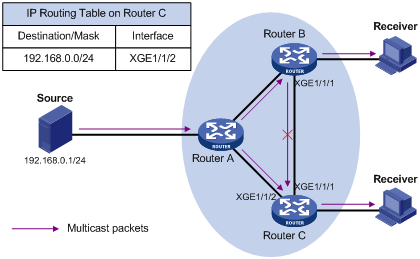

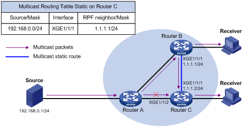

Changing an RPF route
Typically, the topology structure of a multicast network is the same as that of a unicast network, and multicast traffic follows the same transmission path as unicast traffic does. You can configure a static multicast route for a multicast source to change the RPF route. As a result, the router creates a transmission path for multicast traffic that is different from the transmission path for unicast traffic.
Figure 2 Changing an RPF route
As shown in Figure 2, when no static multicast route is configured, Device C's RPF neighbor on the path back to the source is Device A. The multicast data from the source travels through Device A to Device C. You can configure a static multicast route on Device C and specify Device B as Device C's RPF neighbor on the path back to the source. The multicast data from the source travels along the path: Device A to Device B and then to Device C.

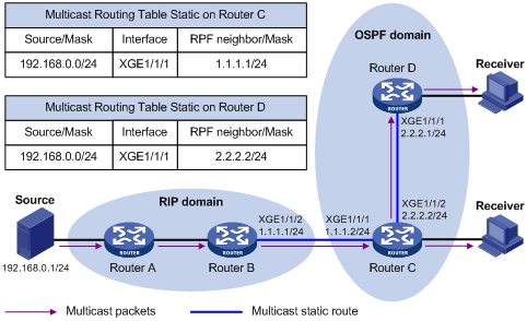

Creating an RPF route
When a unicast route is blocked, multicast forwarding might be stopped due to lack of an RPF route. You can configure a static multicast route to create an RPF route. In this way, a multicast routing entry is created to guide multicast forwarding.
Figure 3 Creating an RPF route
As shown in Figure 3, the RIP domain and the OSPF domain are unicast isolated from each other. For the receiver hosts in the OSPF domain to receive multicast packets from the multicast source in the RIP domain, you must configure Device C and Device D as follows:
·           On Device C, configure a static multicast route for the multicast source and specify Device B as the RPF neighbor.
·           On Device D, configure a static multicast route for the multicast source and specify Device C as the RPF neighbor.
A static multicast route is effective only on the multicast router on which it is configured, and will not be advertised throughout the network or redistributed to other routers.

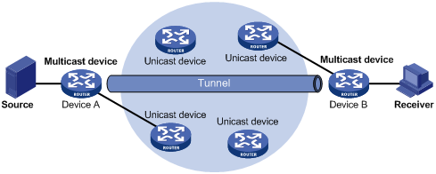

Figure 4 Multicast data transmission through a tunnel
As shown in Figure 4, a tunnel is established between the multicast routers Device A and Device B. Device A encapsulates the multicast data in unicast IP packets, and forwards them to Device B across the tunnel through unicast routers. Then, Device B strips off the unicast IP header and continues to forward the multicast data to the receiver.
To use this tunnel only for multicast traffic, configure the tunnel as the outgoing interface only for multicast routes.

Multicast routing and forwarding configuration examples

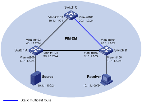

Network requirements
As shown in Figure 5:
·           PIM-DM runs on the network.
·           All switches on the network support multicast.
·           Switch A, Switch B and Switch C run OSPF.
·           Typically, the receiver host can receive the multicast data from Source through the path: Switch A to Switch B, which is the same as the unicast route.
Configure the switches so that the multicast data from Source travels to the receiver through the path: Switch A to Switch C to Switch B. This is different from the unicast route.
Figure 5 Network diagram
Configuration procedure
1.      Assign an IP address and subnet mask for each interface, as shown in Figure 5. (Details not shown.)
2.      Configure OSPF on the switches in the PIM-DM domain. (Details not shown.)
3.      Enable IP multicast routing, and enable IGMP and PIM-DM:
# On Switch B, enable IP multicast routing.
<SwitchB> system-view
[SwitchB] multicast routing
[SwitchB-mrib] quit
# Enable IGMP on the receiver-side interface VLAN-interface 100.
[SwitchB-Vlan-interface100] igmp enable
# Enable PIM-DM on other interfaces.
[SwitchB] interface vlan-interface 101
[SwitchB-Vlan-interface101] pim dm
[SwitchB-Vlan-interface101] quit
[SwitchB] interface vlan-interface 102
[SwitchB-Vlan-interface102] pim dm
[SwitchB-Vlan-interface102] quit
# On Switch A, enable IP multicast routing.
<SwitchA> system-view
[SwitchA] multicast routing
[SwitchA-mrib] quit
# Enable PIM-DM on each interface.
[SwitchA] interface vlan-interface 200
[SwitchA-Vlan-interface200] pim dm
[SwitchA-Vlan-interface200] quit
[SwitchA] interface vlan-interface 102
[SwitchA-Vlan-interface102] pim dm
[SwitchA-Vlan-interface102] quit
[SwitchA] interface vlan-interface 103
[SwitchA-Vlan-interface103] pim dm
[SwitchA-Vlan-interface103] quit
# Enable IP multicast routing and PIM-DM on Switch C in the same way Switch A is configured. (Details not shown.)
4.      Display RPF information for Source on Switch B.
[SwitchB] display multicast rpf-info 50.1.1.100
 RPF information about source 50.1.1.100:
     RPF interface: Vlan-interface102, RPF neighbor: 30.1.1.2
     Referenced route/mask: 50.1.1.0/24
     Referenced route type: igp
     Route selection rule: preference-preferred
     Load splitting rule: disable
     Source AS: 0
     C-multicast route target: 0x0000000000000000
The output shows that the current RPF route on Switch B is contributed by a unicast routing protocol and the RPF neighbor is Switch A.
5.      Configure a static multicast route on Switch B and specify Switch C as its RPF neighbor on the route to Source.
[SwitchB] ip rpf-route-static 50.1.1.0 24 20.1.1.2
# Display RPF information for Source on Switch B.
     RPF interface: Vlan-interface101, RPF neighbor: 20.1.1.2
     Referenced route type: multicast static
     Source AS: 0
The output shows the following information:
·           The RPF route on Switch B is the configured static multicast route.
·           The RPF neighbor of Switch B is Switch C.

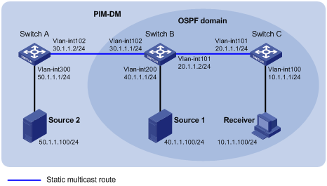

As shown in Figure 6:
·           All switches on the network support IP multicast.
·           Switch B and Switch C run OSPF, and have no unicast routes to Switch A.
·           Typically, the receiver host receives the multicast data from Source 1 in the OSPF domain.
Configure the switches so that the receiver host receives multicast data from Source 2, which is outside the OSPF domain.
Figure 6 Network diagram
1.      Assign an IP address and subnet mask for each interface, as shown in Figure 6. (Details not shown.)
2.      Configure OSPF on Switch B and Switch C. (Details not shown.)
# On Switch C, enable IP multicast routing.
<SwitchC> system-view
[SwitchC] multicast routing
[SwitchC-mrib] quit
[SwitchC] interface vlan-interface 100
[SwitchC-Vlan-interface100] igmp enable
[SwitchC-Vlan-interface100] quit
# Enable PIM-DM on VLAN-interface 101.
[SwitchC] interface vlan-interface 101
[SwitchC-Vlan-interface101] pim dm
[SwitchC-Vlan-interface101] quit
[SwitchA-mrib] quit
[SwitchA] interface vlan-interface 300
[SwitchA-Vlan-interface300] pim dm
[SwitchA-Vlan-interface300] quit
# Enable IP multicast routing and PIM-DM on Switch B in the same way Switch A is configured. (Details not shown.)
4.      Display RPF information for Source 2 on Switch B and Switch C.
[SwitchC] display multicast rpf-info 50.1.1.100
No output is displayed because no RPF routes to Source 2 exist on Switch B or Switch C.
5.      Configure a static multicast route:
# Configure a static multicast route on Switch B and specify Switch A as its RPF neighbor on the route to Source 2.
[SwitchB] ip rpf-route-static 50.1.1.0 24 30.1.1.2
# Configure a static multicast route on Switch C and specify Switch B as its RPF neighbor on the route to Source 2.
[SwitchC] ip rpf-route-static 10.1.1.0 24 20.1.1.2
# Display RPF information for Source 2 on Switch B.
     Source AS: 0
# Display RPF information for Source 2 on Switch C.
     Source AS: 0
The output shows that the RPF routes to Source 2 exist on Switch B and Switch C. The routes are the configured static routes.

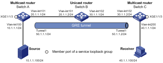

As shown in Figure 7:
·           Multicast routing and PIM-DM are enabled on Switch A and Switch C.
·           Switch B does not support multicast.
·           Switch A, Switch B, and Switch C run OSPF.
Configure the switches so that the receiver host can receive the multicast data from Source.
Figure 7 Network diagram
1.      Assign an IP address and subnet mask for each interface, as shown in Figure 7. (Details not shown.)
2.      Configure OSPF on all the switches. (Details not shown.)
3.      Configure a GRE tunnel:
# On Switch A, create service loopback group 1, and specify the unicast tunnel service for the group.
[SwitchA] service-loopback group 1 type tunnel
# Add Ten-GigabitEthernet1/1/3 to service loopback group 1. (Ten-GigabitEthernet1/1/3 does not belong to VLAN 100 or VLAN 101.)
[SwitchA] interface ten-gigabitethernet 1/1/3
[SwitchA-Ten-GigabitEthernet1/1/3] port service-loopback group 1
[SwitchA-Ten-GigabitEthernet1/1/3] quit
# Create a GRE tunnel interface Tunnel 1, and specify the tunnel mode as GRE/IPv4.
[SwitchA] interface tunnel 1 mode gre
# Assign an IP address to interface Tunnel 1, and specify its source and destination addresses.
[SwitchA-Tunnel1] ip address 50.1.1.1 24
[SwitchA-Tunnel1] source 20.1.1.1
[SwitchA-Tunnel1] destination 30.1.1.2
[SwitchA-Tunnel1] quit
# On Switch C, create service loopback group 1, and specify the unicast tunnel service for the group.
[SwitchC] service-loopback group 1 type tunnel
# Add Ten-GigabitEthernet1/1/3 to service loopback group 1. Ten-GigabitEthernet1/1/3 does not belong to VLAN 200 or VLAN 102.
[SwitchC] interface ten-gigabitethernet 1/1/3
[SwitchC-Ten-GigabitEthernet1/1/3] port service-loopback group 1
[SwitchC-Ten-GigabitEthernet1/1/3] quit
[SwitchC] interface tunnel 1 mode gre
# Assign an IP address for interface Tunnel 1, and specify its source and destination addresses.
[SwitchC-Tunnel1] ip address 50.1.1.2 24
[SwitchC-Tunnel1] source 30.1.1.2
[SwitchC-Tunnel1] destination 20.1.1.1
[SwitchC-Tunnel1] quit
4.      Enable IP multicast routing, PIM-DM, and IGMP:
# On Switch A, enable multicast routing.
[SwitchA-mrib] quit
[SwitchA-Vlan-interface100] pim dm
[SwitchA] interface vlan-interface 101
[SwitchA-Vlan-interface101] pim dm
[SwitchA-Vlan-interface101] quit
[SwitchA-Tunnel1] pim dm
# On Switch C, enable multicast routing.
[SwitchC-mrib] quit
# Enable IGMP on the receiver-side interface VLAN-interface 200.
[SwitchC] interface vlan-interface 200
[SwitchC-Vlan-interface200] igmp enable
[SwitchC-Vlan-interface200] quit
# Enable PIM-DM on VLAN-interface 102.
[SwitchC] interface vlan-interface 102
[SwitchC-Vlan-interface102] pim dm
[SwitchC-Vlan-interface102] quit
# Enable PIM-DM on Tunnel 1.
[SwitchC-Tunnel1] pim dm
5.      On Switch C, configure a static multicast route to Source and specify Switch A as the RPF neighbor.
[SwitchC] ip rpf-route-static 50.1.1.0 24 50.1.1.1
# Send an IGMP report from Receiver to join multicast group 225.1.1.1. (Details not shown.)
# Send multicast data from Source to multicast group 225.1.1.1. (Details not shown.)
# Display PIM routing entries on Switch C.
[SwitchC] display pim routing-table
 Total 1 (*, G) entry; 1 (S, G) entry
 (*, 225.1.1.1)
     Protocol: pim-dm, Flag: WC
     UpTime: 00:04:25
     Upstream interface: NULL
         Upstream neighbor: NULL
         RPF prime neighbor: NULL
     Downstream interface(s) information:
     Total number of downstreams: 1
         1: Vlan-interface200
             Protocol: igmp, UpTime: 00:04:25, Expires: -
 (10.1.1.100, 225.1.1.1)
     Protocol: pim-dm, Flag: ACT
     UpTime: 00:06:14
     Upstream interface: Tunnel1
         Upstream neighbor: 50.1.1.1
         RPF prime neighbor: 50.1.1.1
             Protocol: pim-dm, UpTime: 00:04:25, Expires: -
The output shows that Switch A is the RPF neighbor of Switch C and the multicast data from Switch A is delivered over the GRE tunnel to Switch C.
Troubleshooting multicast routing and forwarding
