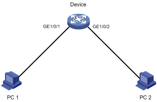

Network requirements
As shown in Figure 1, two interfaces of the device are connected to users.
To save energy, configure the device to perform the following operations:
·          Enable the interfaces at 8:00 a.m. every Monday through Friday.
·          Disable the interfaces at 18:00 every Monday through Friday.
Figure 1 Network diagram
Scheduling procedure
# Enter system view.
<Sysname> system-view
# Configure a job for disabling interface GigabitEthernet 1/0/1.
[Sysname] scheduler job shutdown-GigabitEthernet1/0/1
[Sysname-job-shutdown-GigabitEthernet1/0/1] command 1 system-view
[Sysname-job-shutdown-GigabitEthernet1/0/1] command 2 interface gigabitethernet 1/0/1
[Sysname-job-shutdown-GigabitEthernet1/0/1] command 3 shutdown
[Sysname-job-shutdown-GigabitEthernet1/0/1] quit
# Configure a job for enabling interface GigabitEthernet 1/0/1.
[Sysname] scheduler job start-GigabitEthernet1/0/1
[Sysname-job-start-GigabitEthernet1/0/1] command 1 system-view
[Sysname-job-start-GigabitEthernet1/0/1] command 2 interface gigabitethernet 1/0/1
[Sysname-job-start-GigabitEthernet1/0/1] command 3 undo shutdown
[Sysname-job-start-GigabitEthernet1/0/1] quit
# Configure a job for disabling interface GigabitEthernet 1/0/2.
[Sysname] scheduler job shutdown-GigabitEthernet1/0/2
[Sysname-job-shutdown-GigabitEthernet1/0/2] command 1 system-view
[Sysname-job-shutdown-GigabitEthernet1/0/2] command 2 interface gigabitethernet 1/0/2
[Sysname-job-shutdown-GigabitEthernet1/0/2] command 3 shutdown
[Sysname-job-shutdown-GigabitEthernet1/0/2] quit
# Configure a job for enabling interface GigabitEthernet 1/0/2.
[Sysname] scheduler job start-GigabitEthernet1/0/2
[Sysname-job-start-GigabitEthernet1/0/2] command 1 system-view
[Sysname-job-start-GigabitEthernet1/0/2] command 2 interface gigabitethernet 1/0/2
[Sysname-job-start-GigabitEthernet1/0/2] command 3 undo shutdown
[Sysname-job-start-GigabitEthernet1/0/2] quit
# Configure a periodic schedule for enabling the interfaces at 8:00 a.m. every Monday through Friday.
[Sysname] scheduler schedule START-pc1/pc2
[Sysname-schedule-START-pc1/pc2] job start-GigabitEthernet1/0/1
[Sysname-schedule-START-pc1/pc2] job start-GigabitEthernet1/0/2
[Sysname-schedule-START-pc1/pc2] time repeating at 8:00 week-day mon tue wed thu fri
[Sysname-schedule-START-pc1/pc2] quit
# Configure a periodic schedule for disabling the interfaces at 18:00 every Monday through Friday.
[Sysname] scheduler schedule STOP-pc1/pc2
[Sysname-schedule-STOP-pc1/pc2] job shutdown-GigabitEthernet1/0/1
[Sysname-schedule-STOP-pc1/pc2] job shutdown-GigabitEthernet1/0/2
[Sysname-schedule-STOP-pc1/pc2] time repeating at 18:00 week-day mon tue wed thu fri
[Sysname-schedule-STOP-pc1/pc2] quit

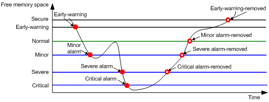

Setting memory alarm thresholds
To ensure correct operation and improve memory efficiency, the system monitors the amount of free memory space in real time. If the amount of free memory space reaches the minor alarm, severe alarm, or critical alarm threshold, the system generates an alarm and sends it to affected service modules or processes.
The early warning feature warns you of an approaching insufficient-memory condition.
As shown in Table 2 and Figure 2, the system supports the following free-memory thresholds:
·          Sufficient-memory threshold.
·          Early-warning threshold.
·          Normal state threshold.
·          Minor alarm threshold.
·          Severe alarm threshold.
·          Critical alarm threshold.
Table 2 Memory alarm notifications and memory alarm-removed notifications
Notification
Triggering condition
Remarks
Early-warning notification
The amount of free memory space decreases to or below the early-warning threshold for the first time.
After generating and sending an early-warning notification, the system does not generate and send any additional early-warning notifications until the first early warning is removed.
Minor alarm notification
The amount of free memory space decreases to or below the minor alarm threshold for the first time.
After generating and sending a minor alarm notification, the system does not generate and send any additional minor alarm notifications until the first minor alarm is removed.
Severe alarm notification
The amount of free memory space decreases to or below the severe alarm threshold for the first time.
After generating and sending a severe alarm notification, the system does not generate and send any additional severe alarm notifications until the first severe alarm is removed.
Critical alarm notification
The amount of free memory space decreases to or below the critical alarm threshold for the first time.
After generating and sending a critical alarm notification, the system does not generate and send any additional critical alarm notifications until the first critical alarm is removed.
Critical alarm-removed notification
The amount of free memory space increases to or above the severe alarm threshold.
N/A
Severe alarm-removed notification
The amount of free memory space increases to or above the minor alarm threshold.
N/A
Minor alarm-removed notification
The amount of free memory space increases to or above the normal state threshold.
N/A
Early-warning-removed notification
The amount of free memory space increases to or above the sufficient-memory threshold.
N/A
Figure 2 Memory alarm notification and alarm-removed notification
