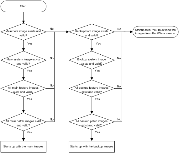

Comware image redundancy and loading procedure
You can specify two lists of Comware software images: one main and one backup.
The system always attempts to start up with the main images. If any main image does not exist or is invalid, the system tries the backup images. Figure 1 shows the entire Comware image loading procedure.
In this procedure, both the main and backup image lists have feature and patch images. If an image list does not have feature or patch images, the system starts up with the boot and system images after they pass verification.
If both the main and backup boot images are nonexistent or invalid, access the BootWare menu during the system startup to upgrade software.
Figure 1 Comware image loading procedure

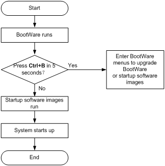

System startup process
Upon power-on, the BootWare image runs to initialize hardware, and then the startup software images run to start up the entire system, as shown in Figure 2.
Figure 2 System startup process
