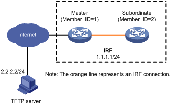

As shown in Figure 1, the IRF fabric has two members.
Upgrade the Feature1 feature from T0001015 to T0001016. The two versions are compatible.
Figure 1 Network diagram
Upgrade procedure

Feature upgrade to an incompatible version
Upgrade requirements
As shown in Figure 2, the IRF fabric has two members.
Upgrade the Feature1 feature from T0001015 to T0001016. The two versions are incompatible.
Figure 2 Network diagram
Upgrade procedure
# Download the image file that contains the T0001016 Feature1 feature from the TFTP server.
<Sysname> tftp 2.2.2.2 get feature1-t0001016.bin

# Upgrade the feature on the subordinate member.
<Sysname> issu load file feature flash:/feature1-t0001016.bin slot 2
This operation will delete the rollback point information for the previous upgrade and maybe get unsaved configuration lost. Continue? [Y/N]:y
Verifying the file flash:/feature1-t0001016.bin on slot 1...Done.
Copying file flash:/feature1-t0001016.bin to slot2#flash:/feature1-t0001016.bin......Done.
Verifying the file flash:/feature1-t0001016.bin on slot 2...Done.
Identifying the upgrade methods...Done.
Upgrade summary according to following table:
  Running Version             New Version
  Test 0001015                Test 0001016
  Slot                        Upgrade Way
  2                           Reboot
Upgrading software images to incompatible versions. Continue? [Y/N]: y
This operation might take several minutes, please wait...Done.
# Upgrade the feature on the original master.
<Sysname> issu run switchover
  Slot                        Upgrade Way
  1                           Reboot

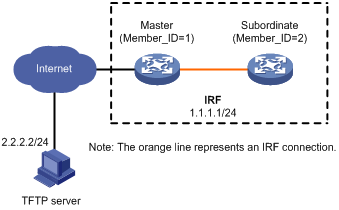

Feature rollback example
Rollback requirement
As shown in Figure 3, the IRF fabric has two members.
Roll back the Feature1 feature from T0001016 to T0001015 after upgrading it from T0001015 to T0001016. The two versions are compatible.
Figure 3 Network diagram
Rollback procedure
  Slot                        Upgrade Way
  2                           Reboot
Upgrading software images to compatible versions. Continue? [Y/N]: y
# Perform a main/backup feature process switchover.
  Slot                        Switchover Way
  1                           Active standby process switchover
# Display active software images.
<Sysname> display install active
Active packages on slot 1:
  flash:/boot-t0001015.bin
  flash:/system-t0001015.bin
  flash:/feature1-t0001015.bin
Active packages on slot 2:
# Roll back the feature to T0001015.
<Sysname> issu rollback
This command will quit the ISSU process and roll back to the previous version. Continue? [Y/N]:Y
# Verify that both members are running the old feature image.

<Sysname> install activate feature flash:/feature1-t0001016.bin slot 2
flash:/feature1-t0001016.bin already exists on slot 2.
Overwrite it?[Y/N]:y
  Slot                        Upgrade Way
  2                           Reboot
<Sysname> install activate feature flash:/feature1-t0001016.bin slot 1
  Slot                        Upgrade Way
  1                           Reboot
# Commit the software changes.
<Sysname> install commit
This operation will take several minutes, please wait...........................Done.
As shown in Figure 4, the IRF fabric has two members. The Feature1 feature has been upgraded from T0001015 to T0001016. However, the software change has not been committed.
Roll back the Feature1 feature from T0001016 to T0001015.
Rollback procedure
# Display available rollback points.
<Sysname> display install rollback
  Install rollback information 1 on slot 1:
    Updating from flash:/feature1-t0001015.bin
             to flash:/feature1-t0001016.bin.
  Install rollback information 2 on slot 2:
<Sysname> install rollback to original
# Verify that the IRF members are running the old feature image.
