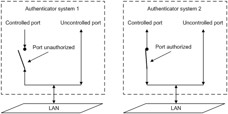

Controlled/uncontrolled port and port authorization status
802.1X defines two logical ports for the network access port: controlled port and uncontrolled port. Any packet arriving at the network access port is visible to both logical ports.
·          Uncontrolled port—Is always open to receive and transmit authentication packets.
·          Controlled port—Filters packets depending on the port state.
?  Authorized state—The controlled port is in authorized state when the client has passed authentication. The port allows traffic to pass through.
?  Unauthorized state—The port is in unauthorized state when the client has failed authentication. The port controls traffic by using one of the following methods:
-      Performs bidirectional traffic control to deny traffic to and from the client.
-      Performs unidirectional traffic control to deny traffic from the client. The device supports only unidirectional traffic control.

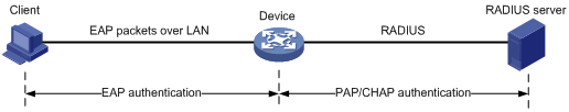

EAP termination
As shown in Figure 4, the access device performs the following operations in EAP termination mode:
1.        Terminates the EAP packets received from the client.
2.        Encapsulates the client authentication information in standard RADIUS packets.
3.        Uses PAP or CHAP to authenticate to the RADIUS server.
Figure 4 EAP termination
