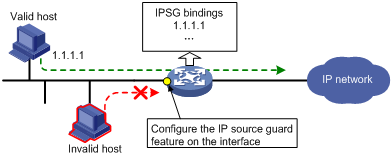

IPSG operating mechanism
The IPSG binding table contains bindings that bind IP address, MAC address, VLAN, or any combinations. IPSG uses the bindings to match an incoming packet. If a match is found, the packet is forwarded. If no match is found, the packet is discarded.
IPSG is a per-interface packet filter. Configuring this feature on one interface does not affect packet forwarding on another interface.
IPSG bindings can be static or dynamic.
As shown in Figure 1, IPSG forwards only the packets that match an IPSG binding.

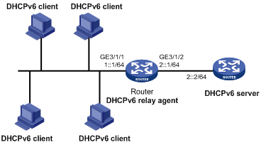

Example: Configuring dynamic IPv4SG using DHCP snooping
As shown in Figure 3, the host (the DHCP client) obtains an IP address from the DHCP server. Perform the following tasks:
·          Enable DHCP snooping on the device to make sure the DHCP client obtains an IP address from the authorized DHCP server. To generate a DHCP snooping entry for the DHCP client, enable recording of client information in DHCP snooping entries.
·          Enable dynamic IPv4SG on GigabitEthernet 3/1/1 to filter incoming packets by using the IPv4SG bindings generated based on DHCP snooping entries. Only packets from the DHCP client are allowed to pass.
Figure 3 Network diagram

Example: Configuring dynamic IPv6SG using DHCPv6 relay agent
As shown in Figure 7, DHCPv6 relay agent is enabled on the router. The clients obtain IPv6 addresses from the DHCPv6 server through the DHCPv6 relay agent.
Enable dynamic IPv6SG on GigabitEthernet 3/1/1 to filter incoming packets by using the IPv6SG bindings generated based on DHCPv6 relay entries.
Figure 7 Network diagram
1.        Configure the DHCPv6 relay agent:
# Specify IP addresses for the interfaces. (Details not shown.)
# Enable the DHCPv6 relay agent on GigabitEthernet 3/1/1.
[Router] interface gigabitethernet 3/1/1
[Router-GigabitEthernet3/1/1] ipv6 dhcp select relay
# Enable recording of DHCPv6 relay entries on the interface.
[Router-GigabitEthernet3/1/1] ipv6 dhcp relay client-information record
# Specify the DHCPv6 server address 2::2 on the relay agent.
[Router-GigabitEthernet3/1/1] ipv6 dhcp relay server-address 2::2
[Router-GigabitEthernet3/1/1] quit
2.        Enable IPv6SG on GigabitEthernet 3/1/1 and verify the source IP address and MAC address for dynamic IPv6SG.
[Router-GigabitEthernet3/1/1] ipv6 verify source ip-address mac-address
# Display dynamic IPv6SG bindings generated based on DHCPv6 relay entries.
[Router] display ipv6 source binding dhcpv6-relay
Total entries found: 1
IP Address      MAC Address    Interface                VLAN Type
1::2            0001-0203-0406 GE3/1/1                  N/A  DHCPv6 relay
The output shows that GigabitEthernet 3/1/1 will filter packets based on the IPv6SG binding.
