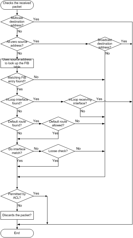

uRPF operation
Figure 2 shows how uRPF works.
Figure 2 uRPF work flow
1.        uRPF checks address validity:
¡  uRPF permits a packet with a multicast destination address.
¡  For a packet with an all-zero source address, uRPF permits the packet if it has a broadcast destination address. (A packet with source address 0.0.0.0 and destination address 255.255.255.255 might be a DHCP or BOOTP packet and cannot be discarded.) uRPF proceeds to step 7 if the packet has a non-broadcast destination address.
¡  uRPF proceeds to step 2 for other packets.
2.        uRPF checks whether the source address matches a unicast route:
¡  If yes, uRPF proceeds to step 3.
¡  If no, uRPF proceeds to step 7. A non-unicast source address matches a non-unicast route.
3.        uRPF checks whether the matching route is to the host itself:
¡  If yes, the output interface of the matching route is an InLoop interface. uRPF checks whether the receiving interface of the packet is an InLoop interface. If yes, it does not check the packet. If no, it proceeds to step 7.
¡  If no, uRPF proceeds to step 4.
4.        uRPF checks whether the matching route is a default route:
¡  If yes, uRPF checks whether the allow-default-route keyword is configured to allow using the default route. If yes, it proceeds to step 5. If no, it proceeds to step 7.
¡  If no, uRPF proceeds to step 5.
5.        uRPF checks whether the receiving interface matches the output interface of the matching FIB entry:
¡  If yes, uRPF proceeds to step 6.
¡  If no, uRPF checks whether the check mode is loose. If yes, it proceeds to step 7. If no, it proceeds to step 6.
6.        uRPF checks whether the packet is permitted by the ACL:
¡  If yes, the packet is forwarded (such a packet is displayed in the uRPF information as a "suppressed drop").
¡  If no, the packet is discarded.

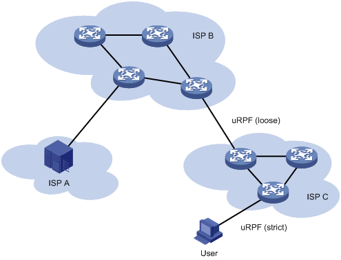

Network application
As shown in Figure 3, strict uRPF check is configured between an ISP network and a customer network. Loose uRPF check is configured between ISPs.
For special packets or users, you can configure ACLs.
Figure 3 Network diagram

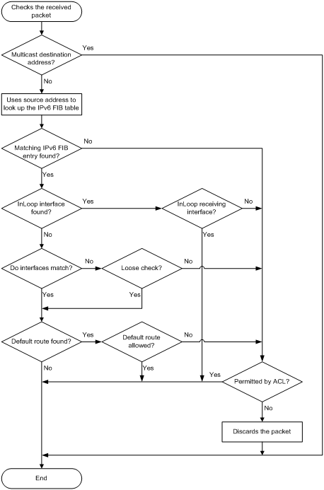

IPv6 uRPF operation
Figure 6 shows how IPv6 uRPF works.
Figure 6 IPv6 uRPF work flow
1.        IPv6 uRPF checks whether the received packet carries a multicast destination address:
¡  If yes, IPv6 uRPF permits the packet.
¡  If no, IPv6 uRPF proceeds to step 2.
2.        IPv6 uRPF checks whether the source address matches a unicast route:
¡  If yes, IPv6 uRPF proceeds to step 3.
¡  If no, IPv6 uRPF proceeds to step 6. A non-unicast source address matches a non-unicast route.
3.        IPv6 uRPF checks whether the matching route is to the host itself:
¡  If yes, the output interface of the matching route is an InLoop interface. IPv6 uRPF checks whether the receiving interface of the packet is an InLoop interface. If yes, IPv6 uRPF permits the packet. If no, IPv6 uRPF proceeds to step 6. If the source address is a link-local address and is the receiving interface address, also proceeds to step 6.
¡  If no, IPv6 uRPF proceeds to step 4.
4.        IPv6 uRPF checks whether the receiving interface matches the output interface of the matching FIB entry:
¡  If yes, IPv6 uRPF proceeds to step 5.
¡  If no, IPv6 uRPF checks whether the check mode is loose. If yes, it proceeds to step 5. If no, it proceeds to step 6.
5.        IPv6 uRPF checks whether the matching route is a default route:
¡  If yes, IPv6 uRPF checks whether the allow-default-route keyword is configured to allow using the default route. If yes, the packet is forwarded. If no, IPv6 uRPF proceeds to step 6.
¡  If no, the packet is forwarded.
6.        IPv6 uRPF checks whether the packet is permitted by the IPv6 ACL:
