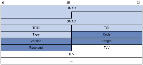

Loop detection frame format
As shown in Figure 1, a loop detection frame contains the Ethernet header, loop detection header, and loop detection TLVs.
Figure 1 Loop detection frame format
The Ethernet frame header of a loop detection frame contains the following fields:
·          DMAC—Destination MAC address of the frame, which is the multicast MAC address 010f-e200-0007. When a loop detection-enabled device receives a frame with this destination MAC address, it performs the following operations:
?  Sends the frame to the CPU.
?  Floods the frame in the VLAN from which the frame was originally received.
·          SMAC—Source MAC address of the frame, which is the bridge MAC address of the sending device.
·          TPID—Type of the VLAN tag, with the default value of 0x8100.
·          TCI—Tag control information, including the priority and VLAN ID.
·          Type—Protocol type, with the value of 0x8918.
The loop detection header of a loop detection frame contains the following fields:
·          Code—Protocol sub-type, which is 0x0001, indicating the loop detection type.
·          Version—Protocol version, which is reserved. This field is fixed at 0x0000.
·          Length—Length of the frame. The value includes the loop detection header, but excludes the Ethernet header.
·          Reserved—This field is reserved.
Payload of a loop detection frame is encapsulated as TLV triplets.

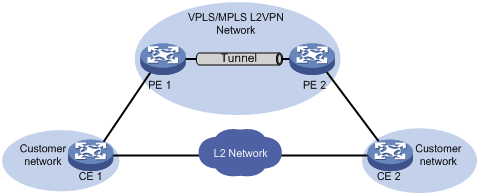

As shown in Figure 2, two PEs provide data transmission services for the CEs attached to the customer network sites. Because the CEs have Layer 2 connectivity, broadcast storms can spread across the customer network sites.
To remove loops from the VPLS or MPLS L2VPN network, configure loop detection on the PE interfaces that are attached to CEs. When a PE detects a loop on a CE-facing interface, it blocks the interface to remove the loop.
Figure 2 Remote site loop detection

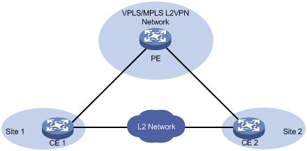

As shown in Figure 3, a PE is attached to two CEs at the local sites, and the CEs have Layer 2 connectivity. To remove loops from the local sites, configure loop detection on the PE interfaces that are attached to CEs. When a PE detects a loop on a CE-facing interface, it blocks the interface to remove the loop.
Figure 3 Intra-site loop detection

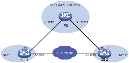

As shown in Figure 4, the PE provides user traffic transmission service for the CEs of the local sites, and the CEs have Layer 2 connectivity in VLAN 10. Configure loop detection on the CE-facing interfaces of the PE so that the PE can block the interfaces if loops exist.
Figure 4 Network diagram
1.        Configure CE 1:
# Configure GigabitEthernet 3/1/2 as a trunk port, and assign it to VLAN 10.
<CE1> system-view
[CE1] interface gigabitethernet 3/1/2
[CE1-GigabitEthernet3/1/2] port link-type trunk
[CE1-GigabitEthernet3/1/2] port trunk permit vlan 10
[CE1-GigabitEthernet3/1/2] quit
2.        Configure CE 2:
<CE2> system-view
[CE2] interface gigabitethernet 3/1/2
[CE2-GigabitEthernet3/1/2] port link-type trunk
[CE2-GigabitEthernet3/1/2] port trunk permit vlan 10
[CE2-GigabitEthernet3/1/2] quit
3.        Configure the PE:
# Enable L2VPN.
<PE> system-view
[PE] l2vpn enable
# Create a cross-connect group named vpn1, create a cross-connect named vpn1 in the group, and bind GigabitEthernet 3/1/1.1 and GigabitEthernet 3/1/2.1 to the cross-connect.
[PE] xconnect-group vpn1
[PE-xcg-vpn1] connection vpn1
[PE-xcg-vpn1-vpn1] ac interface gigabitethernet 3/1/1.1
[PE-xcg-vpn1-vpn1] ac interface gigabitethernet 3/1/2.1
[PE-xcg-vpn1-vpn1] quit
# Configure GigabitEthernet 3/1/1.1 to terminate VLAN 10, and enable single-tagged loop detection on it.
[PE] interface gigabitethernet 3/1/1.1
[PE-GigabitEthernet3/1/1.1] vlan-type dot1q vid 10
[PE-GigabitEthernet3/1/1.1] loopback-detection enable vlan 10
# Set the priority value in the loop detection priority to 2, and set the loop protection action to block.
[PE-GigabitEthernet3/1/1.1] loopback-detection priority 2
[PE-GigabitEthernet3/1/1.1] loopback-detection action block
[PE-GigabitEthernet3/1/1.1] quit
# Configure GigabitEthernet 3/1/2.1 to terminate VLAN 10, and enable single-tagged loop detection on it.
[PE] interface gigabitethernet 3/1/2.1
[PE-GigabitEthernet3/1/2.1] vlan-type dot1q vid 10
[PE-GigabitEthernet3/1/2.1] loopback-detection enable vlan 10
# Set the priority value in the loop detection priority to 3, and set the loop protection action to block.
[PE-GigabitEthernet3/1/2.1] loopback-detection priority 3
[PE-GigabitEthernet3/1/2.1] loopback-detection action block
[PE-GigabitEthernet3/1/2.1] quit
# Set the loop detection interval to 40 seconds.
[PE] loopback-detection interval-time 40
# Verify that the PE has detected a loop.
[PE]
%Oct 27 22:52:11:722 2020 H3C LPDT/4/LPDT_LOOPED: -MDC=1; A loop was detected on
GigabitEthernet3/1/2.1.
%Oct 27 22:52:11:723 2020 H3C LPDT/4/LPDT_VLAN_LOOPED: -MDC=1; A loop was detect
ed on GigabitEthernet3/1/2.1 in VLAN 10.
# Verify that the PE has blocked GigabitEthernet 3/1/2.1 to remove the loop.
[PE] display loopback-detection
Loop detection is enabled.
Loop detection interval is 40 second(s).
Loop is detected on following interfaces:
 Interface                    Action mode
 GigabitEthernet3/1/2.1       Block
