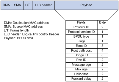

Figure 1 Configuration BPDU format
The payload of a configuration BPDU includes the following fields:
·          Protocol ID—Fixed at 0x0000, which represents IEEE 802.1d.
·          Protocol version ID—Spanning tree protocol version ID. The protocol version ID for STP is 0x00.
·          BPDU type—Type of the BPDU. The value is 0x00 for a configuration BPDU.
·          Flags—An 8-bit field indicates the purpose of the BPDU. The lowest bit is the Topology Change (TC) flag. The highest bit is the Topology Change Acknowledge (TCA) flag. All other bits are reserved.
·          Root ID—Root bridge ID formed by the priority and MAC address of the root bridge.
·          Root path cost—Cost of the path to the root bridge.
·          Bridge ID—Designated bridge ID formed by the priority and MAC address of the designated bridge.
·          Port ID—Designated port ID formed by the priority and global port number of the designated port.
·          Message age—Age of the configuration BPDU while it propagates in the network.
·          Max age—Maximum age of the configuration BPDU stored on the switch.
·          Hello time—Configuration BPDU transmission interval.
·          Forward delay—Delay for STP bridges to transit port state.
Devices use the root bridge ID, root path cost, designated bridge ID, designated port ID, message age, max age, hello time, and forward delay for spanning tree calculation.

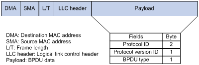

Devices use TCN BPDUs to announce changes in the network topology. Figure 2 shows the TCN BPDU format.
Figure 2 TCN BPDU format
The payload of a TCN BPDU includes the following fields:
·          BPDU type—Type of the BPDU. The value is 0x80 for a TCN BPDU.
A non-root bridge sends TCN BPDUs when one of the following events occurs on the bridge:
·          A port transits to the forwarding state, and the bridge has a minimum of one designated port.
·          A port transits from the forwarding or learning state to the blocking state.
The non-root bridge uses TCN BPDUs to notify the root bridge once the network topology changes. The root bridge then sets the TC flag in its configuration BPDU and propagates it to other bridges.

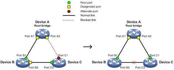

As shown in Figure 3, Device B and Device C are directly connected to a LAN.
If Device A forwards BPDUs to Device B through port A1, the designated bridge and designated port are as follows:
·          The designated bridge for Device B is Device A.
·          The designated port for Device B is port A1 on Device A.
If Device B forwards BPDUs to the LAN, the designated bridge and designated port are as follows:
·          The designated bridge for the LAN is Device B.
·          The designated port for the LAN is port B2 on Device B.

After the comparison processes described in Table 4, a spanning tree with Device A as the root bridge is established, as shown in Figure 5.
Figure 5 The final calculated spanning tree

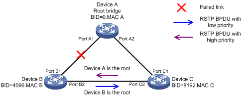

As shown in Figure 6, Device A is the root bridge. The priority of Device B is higher than the priority of Device C. Port C2 on Device C is blocked.
When the link between Device A and Device B fails, the following events occur:
1.        Device B sends an RSTP BPDU with itself as the root bridge to Device C.
2.        Device C compares the RSTP BPDU with its own BPDU.
3.        Because the RSTP BPDU from Device B has a lower priority, Device C sends its own BPDU to Device B.
4.        Device B considers that Port B2 is the root port and stops sending RSTP BPDUs to Device C.
Figure 6 BPDU processing in RSTP

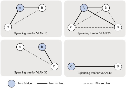

In an STP- or RSTP-enabled LAN, all bridges share one spanning tree. Traffic from all VLANs is forwarded along the spanning tree, and ports cannot be blocked on a per-VLAN basis to prune loops.
PVST allows every VLAN to have its own spanning tree, which increases usage of links and bandwidth. Because each VLAN runs RSTP independently, a spanning tree only serves its VLAN.

PVST implements per-VLAN spanning tree calculation by mapping each VLAN to an MSTI. In PVST, each VLAN runs RSTP independently to maintain its own spanning tree without affecting the spanning trees of other VLANs. In this way, loops in each VLAN are eliminated and traffic of different VLANs is load shared over links. PVST uses RSTP BPDUs in the default VLAN and PVST BPDUs in other VLANs for spanning tree calculation.
PVST uses the same port roles and port states as RSTP for rapid transition. For more information, see "Basic concepts in RSTP."

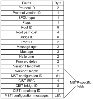

MSTP protocol frames
Figure 8 shows the format of an MSTP BPDU.
Figure 8 MSTP BPDU format
The first 13 fields of an MSTP BPDU are the same as an RSTP BPDU. The other six fields are unique to MSTP.
·          Protocol version IDThe value is 0x03 for MSTP.
·          BPDU typeThe value is 0x02 for RSTP/MSTP BPDUs.
·          Root IDID of the common root bridge.
·          Root path costCIST external path cost.
·          Bridge IDID of the regional root for the IST or an MSTI.
·          Port IDID of the designated port in the CIST.
·          Version3 lengthLength of the MSTP-specific fields. Devices use this field for verification upon receiving an MSTP BPDU.
·          MST configuration IDIncludes the format selector, configuration name, revision level, and configuration digest. The value for format selector is fixed at 0x00. The other parameters are used to identify the MST region for the originating bridge.
·          CIST IRPCInternal root path cost (IRPC) from the originating bridge to the root of the MST region.
·          CIST bridge IDID of the bridge that sends the MSTP BPDU.
·          CIST remaining IDRemaining hop count. This field limits the scale of the MST region. The regional root sends a BPDU with the remaining hop count set to the maximum value. Each device that receives the BPDU decrements the hop count by one. When the hop count reaches zero, the BPDU is discarded. Devices beyond the maximum hops of the MST region cannot participate in spanning tree calculation. The default remaining hop count is 20.
·          MSTI configuration messagesContains MSTI configuration messages. Each MSTI configuration message is 16 bytes. This field can contain 0 to 64 MSTI configuration messages. The number of the MSTI configuration messages is determined by the number of MSTIs in the MST region.

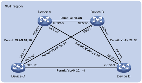

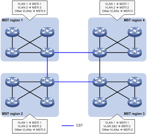

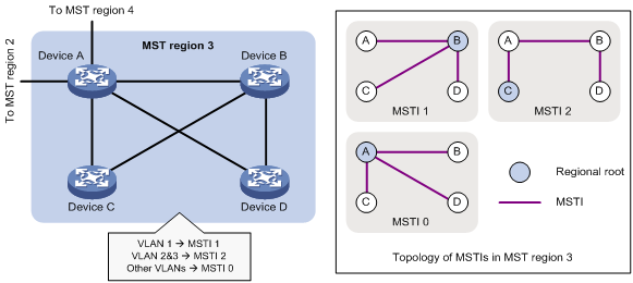

Figure 9 shows a switched network that contains four MST regions, each MST region containing four MSTP devices. Figure 10 shows the networking topology of MST region 3.
Figure 9 Basic concepts in MSTP
Figure 10 Network diagram and topology of MST region 3
MST region
A multiple spanning tree region (MST region) consists of multiple devices in a switched network and the network segments among them. All these devices have the following characteristics:
·          A spanning tree protocol enabled
·          Same region name
·          Same VLAN-to-instance mapping configuration
·          Same MSTP revision level
·          Physically linked together
Multiple MST regions can exist in a switched network. You can assign multiple devices to the same MST region, as shown in Figure 9.
·          The switched network contains four MST regions, MST region 1 through MST region 4.
·          All devices in each MST region have the same MST region configuration.
MSTI
MSTP can generate multiple independent spanning trees in an MST region, and each spanning tree is mapped to the specific VLANs. Each spanning tree is referred to as a multiple spanning tree instance (MSTI).
In Figure 10, MST region 3 contains three MSTIs, MSTI 1, MSTI 2, and MSTI 0.
VLAN-to-instance mapping table
As an attribute of an MST region, the VLAN-to-instance mapping table describes the mapping relationships between VLANs and MSTIs.
In Figure 10, the VLAN-to-instance mapping table of MST region 3 is as follows:
·          VLAN 1 to MSTI 1.
·          VLAN 2 and VLAN 3 to MSTI 2.
·          Other VLANs to MSTI 0.
MSTP achieves load balancing by means of the VLAN-to-instance mapping table.
CST
The common spanning tree (CST) is a single spanning tree that connects all MST regions in a switched network. If you regard each MST region as a device, the CST is a spanning tree calculated by these devices through STP or RSTP.
The blue lines in Figure 9 represent the CST.
IST
An internal spanning tree (IST) is a spanning tree that runs in an MST region. It is also called MSTI 0, a special MSTI to which all VLANs are mapped by default.
In Figure 9, MSTI 0 is the IST in MST region 3.
CIST
The common and internal spanning tree (CIST) is a single spanning tree that connects all devices in a switched network. It consists of the ISTs in all MST regions and the CST.
In Figure 9, the ISTs (MSTI 0) in all MST regions plus the inter-region CST constitute the CIST of the entire network.
Regional root
The root bridge of the IST or an MSTI within an MST region is the regional root of the IST or MSTI. Based on the topology, different spanning trees in an MST region might have different regional roots, as shown in MST region 3 in Figure 10.
·          The regional root of MSTI 1 is Device B.
·          The regional root of MSTI 2 is Device C.
·          The regional root of MSTI 0 (also known as the IST) is Device A.

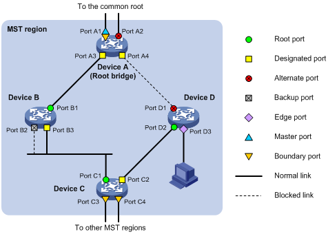

Port roles
A port can play different roles in different MSTIs. As shown in Figure 11, an MST region contains Device A, Device B, Device C, and Device D. Port A1 and port A2 of Device A connect to the common root bridge. Port B2 and Port B3 of Device B form a loop. Port C3 and Port C4 of Device C connect to other MST regions. Port D3 of Device D directly connects to a host.
Figure 11 Port roles
MSTP calculation involves the following port roles:
·          Root port—Forwards data for a non-root bridge to the root bridge. The root bridge does not have any root port.
·          Designated port—Forwards data to the downstream network segment or device.
·          Alternate port—Acts as the backup port for a root port or master port. When the root port or master port is blocked, the alternate port takes over.
·          Backup port—Acts as the backup port of a designated port. When the designated port is invalid, the backup port becomes the new designated port. A loop occurs when two ports of the same spanning tree device are connected, so the device blocks one of the ports. The blocked port acts as the backup.
·          Edge port—Directly connects to a user host rather than a network device or network segment.
·          Master port—Acts as a port on the shortest path from the local MST region to the common root bridge. The master port is not always located on the regional root. It is a root port on the IST or CIST and still a master port on the other MSTIs.
·          Boundary port—Connects an MST region to another MST region or to an STP/RSTP-running device. In MSTP calculation, a boundary port's role on an MSTI is consistent with its role on the CIST. However, that is not true with master ports. A master port on MSTIs is a root port on the CIST.

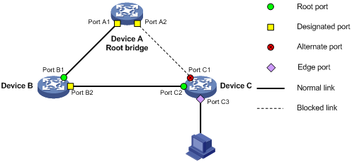

Edge port rapid transition
As shown in Figure 12, Port C3 is an edge port connected to a host. When a network topology change occurs, the port can immediately transit from the blocking state to the forwarding state because no loop will be caused.
Because a device cannot determine whether a port is directly connected to a terminal, you must manually configure the port as an edge port.
Figure 12 Edge port rapid transition

When a root port is blocked, the bridge will elect the alternate port with the highest priority as the new root port. If the new root port's peer is in the forwarding state, the new root port immediately transits to the forwarding state.
As shown in Figure 13, Port C2 on Device C is a root port and Port C1 is an alternate port. When Port C2 transits to the blocking state, Port C1 is elected as the root port and immediately transits to the forwarding state.
Figure 13 Root port rapid transition

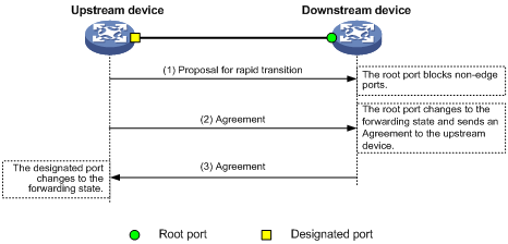

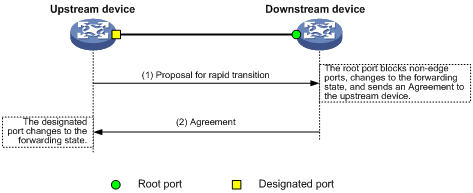

P/A transition
The P/A transition enables a designated port to rapidly transit to the forwarding state after a handshake with its peer. The P/A transition applies only to point-to-point links.
P/A transition for RSTP and PVST.
In RSTP or PVST, the ports on a new link or recovered link are designated ports in blocking state. When one of the designated ports transits to the discarding or learning state, it sets the proposal flag in its BPDU. Its peer bridge receives the BPDU and determines whether the receiving port is the root port. If it is the root port, the bridge blocks the other ports except edge ports. The bridge then replies an agreement BPDU to the designated port. The designated port immediately transits to the forwarding state upon receiving the agreement BPDU. If the designated port does not receive the agreement BPDU, it waits for twice the forward delay to transit to the forwarding state.

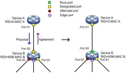

As shown in Figure 14, the P/A transition operates as follows:
1.        Device A sends a proposal BPDU to Device B through Port A1.
2.        Device B receives the proposal BPDU on Port B2. Port B2 is elected as the root port.
3.        Device B blocks its designated port Port B1 and alternate port Port B3 to eliminate loops.
4.        The root port Port B2 transits to the forwarding state and sends an agreement BPDU to Device A.
5.        The designated port Port A1 on Device A immediately transits to the forwarding state after receiving the agreement BPDU.
Figure 14 P/A transition for RSTP and PVST

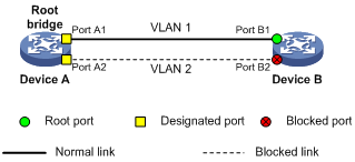

Ignoring the specified VLANs
About VLAN Ignore
Traffic of a VLAN on a complex network might be blocked by the spanning tree, as shown in Figure 16.
·          Port A1 on Device A allows the traffic of VLAN 1 to pass through.
·          Port A2 on Device A allows the traffic of VLAN 2 to pass through.
·          Port B1 on Device B allows the traffic of VLAN 1 to pass through.
·          Port B2 on Device B allows the traffic of VLAN 2 to pass through.
·          Device A and Device B run a spanning tree protocol. Device A is the root bridge, and Port A1 and Port A2 are designated ports. On Device B, Port B1 is the root port, and Port B2 is the blocked port. Traffic of VLAN 2 is blocked.
Figure 16 VLAN connectivity blocked by MSTP
Ignoring a VLAN can make ports of the VLAN forward frames correctly rather than comply with the spanning tree calculation result.

In RSTP and MSTP, the following types of messages are used for rapid state transition on designated ports:
·          Proposal—Sent by designated ports to request rapid transition
·          Agreement—Used to acknowledge rapid transition requests
Both RSTP and MSTP devices can perform rapid transition on a designated port only when the port receives an agreement packet from the downstream device. RSTP and MSTP devices have the following differences:
·          For MSTP, the root port of the downstream device sends an agreement packet only after it receives an agreement packet from the upstream device.
·          For RSTP, the downstream device sends an agreement packet whether or not an agreement packet from the upstream device is received.
Figure 17 Rapid state transition of an MSTP designated port
Figure 18 Rapid state transition of an RSTP designated port
If the upstream device is a third-party device, the rapid state transition implementation might be limited as follows:
·          The upstream device uses a rapid transition mechanism similar to that of RSTP.
·          The downstream device runs MSTP and does not operate in RSTP mode.
In this case, the following occurs:
1.        The root port on the downstream device receives no agreement from the upstream device.
2.        It sends no agreement to the upstream device.
As a result, the designated port of the upstream device can transit to the forwarding state only after a period twice the forward delay.
To enable the designated port of the upstream device to transit its state rapidly, enable No Agreement Check on the downstream device's port.

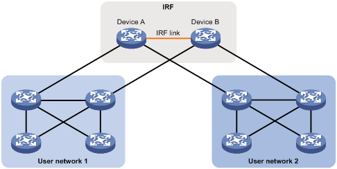

Configuring TC Snooping
About TC Snooping
As shown in Figure 19, an IRF fabric connects to two user networks through double links.
·          Device A and Device B form the IRF fabric.
·          The spanning tree feature is disabled on Device A and Device B and enabled on all devices in user network 1 and user network 2.
·          The IRF fabric transparently transmits BPDUs for both user networks and is not involved in the calculation of spanning trees.
When the network topology changes, it takes time for the IRF fabric to update its MAC address table and ARP table. During this period, traffic in the network might be interrupted.
Figure 19 TC Snooping application scenario
image14.emf
To avoid traffic interruption, you can enable TC Snooping on the IRF fabric. After receiving a TC-BPDU through a port, the IRF fabric updates MAC address table and ARP table entries associated with the port's VLAN. In this way, TC Snooping prevents topology change from interrupting traffic forwarding in the network. For more information about the MAC address table and the ARP table, see "Configuring the MAC address table" and Layer 3—IP Services Configuration Guide.
·          TC Snooping and the spanning tree feature are mutually exclusive. You must globally disable the spanning tree feature before enabling TC Snooping.

The bridge ID change of a device in the user access network might cause a change to the spanning tree topology in the core network. To avoid this problem, you can enable port role restriction on a port. With this feature enabled, when the port receives a superior BPDU, it becomes an alternate port rather than a root port.
Use this feature with caution, because enabling port role restriction on a port might affect the connectivity of the spanning tree topology.

As shown in Figure 20, all devices on the network are in the same MST region. Device A and Device B work at the distribution layer. Device C and Device D work at the access layer.
Configure MSTP so that frames of different VLANs are forwarded along different spanning trees.
·          VLAN 10 frames are forwarded along MSTI 1.
·          VLAN 30 frames are forwarded along MSTI 3.
·          VLAN 40 frames are forwarded along MSTI 4.
·          VLAN 20 frames are forwarded along MSTI 0.
VLAN 10 and VLAN 30 are terminated on the distribution layer devices, and VLAN 40 is terminated on the access layer devices. The root bridges of MSTI 1 and MSTI 3 are Device A and Device B, respectively, and the root bridge of MSTI 4 is Device C.
Figure 20 Network diagram
1.        Configure VLANs and VLAN member ports. (Details not shown.)
¡  Create VLAN 10, VLAN 20, and VLAN 30 on both Device A and Device B.
¡  Create VLAN 10, VLAN 20, and VLAN 40 on Device C.
¡  Create VLAN 20, VLAN 30, and VLAN 40 on Device D.
¡  Configure the ports on these devices as trunk ports and assign them to related VLANs.

In this example, Device B has the lowest root bridge ID. As a result, Device B is elected as the root bridge in MSTI 0.
When the network is stable, you can use the display stp brief command to display brief spanning tree information on each device.

Based on the output, you can draw each MSTI mapped to each VLAN, as shown in Figure 21.
Figure 21 MSTIs mapped to different VLANs

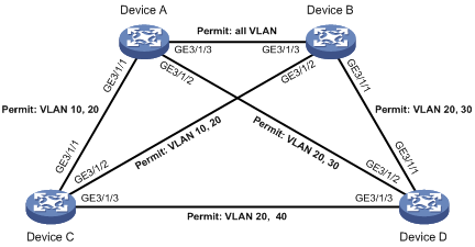

Example: Configuring PVST
As shown in Figure 22, Device A and Device B work at the distribution layer, and Device C and Device D work at the access layer.
Configure PVST to meet the following requirements:
·          Frames of a VLAN are forwarded along the spanning trees of the VLAN.
·          VLAN 10, VLAN 20, and VLAN 30 are terminated on the distribution layer devices, and VLAN 40 is terminated on the access layer devices.
·          The root bridge of VLAN 10 and VLAN 20 is Device A.
·          The root bridge of VLAN 30 is Device B.
·          The root bridge of VLAN 40 is Device C.
Figure 22 Network diagram
2.        Configure Device A:
# Set the spanning tree mode to PVST.
<DeviceA> system-view
[DeviceA] stp mode pvst
# Configure the device as the root bridge of VLAN 10 and VLAN 20.
[DeviceA] stp vlan 10 20 root primary
# Enable the spanning tree feature globally and in VLAN 10, VLAN 20, and VLAN 30.
[DeviceA] stp global enable
[DeviceA] stp vlan 10 20 30 enable
3.        Configure Device B:
<DeviceB> system-view
[DeviceB] stp mode pvst
# Configure the device as the root bridge of VLAN 30.
[DeviceB] stp vlan 30 root primary
[DeviceB] stp global enable
[DeviceB] stp vlan 10 20 30 enable
4.        Configure Device C:
<DeviceC> system-view
[DeviceC] stp mode pvst
# Configure the device as the root bridge of VLAN 40.
[DeviceC] stp vlan 40 root primary
# Enable the spanning tree feature globally and in VLAN 10, VLAN 20, and VLAN 40.
[DeviceC] stp global enable
[DeviceC] stp vlan 10 20 40 enable
5.        Configure Device D:
<DeviceD> system-view
[DeviceD] stp mode pvst
# Enable the spanning tree feature globally and in VLAN 20, VLAN 30, and VLAN 40.
[DeviceD] stp global enable
[DeviceD] stp vlan 20 30 40 enable
# Display brief spanning tree information on Device A.
[DeviceA] display stp brief
 VLAN ID     Port                         Role  STP State     Protection
 10          GigabitEthernet3/1/1         DESI  FORWARDING    NONE
 10          GigabitEthernet3/1/3         DESI  FORWARDING    NONE
 20          GigabitEthernet3/1/1         DESI  FORWARDING    NONE
 20          GigabitEthernet3/1/2         DESI  FORWARDING    NONE
 20          GigabitEthernet3/1/3         DESI  FORWARDING    NONE
 30          GigabitEthernet3/1/2         DESI  FORWARDING    NONE
 30          GigabitEthernet3/1/3         ROOT  FORWARDING    NONE
# Display brief spanning tree information on Device B.
[DeviceB] display stp brief
 10          GigabitEthernet3/1/2         DESI  FORWARDING    NONE
 10          GigabitEthernet3/1/3         ROOT  FORWARDING    NONE
 20          GigabitEthernet3/1/3         ROOT  FORWARDING    NONE
 30          GigabitEthernet3/1/1         DESI  FORWARDING    NONE
 30          GigabitEthernet3/1/3         DESI  FORWARDING    NONE
# Display brief spanning tree information on Device C.
[DeviceC] display stp brief
 10          GigabitEthernet3/1/1         ROOT  FORWARDING    NONE
 10          GigabitEthernet3/1/2         ALTE  DISCARDING    NONE
 20          GigabitEthernet3/1/1         ROOT  FORWARDING    NONE
 20          GigabitEthernet3/1/2         ALTE  DISCARDING    NONE
 40          GigabitEthernet3/1/3         DESI  FORWARDING    NONE
# Display brief spanning tree information on Device D.
[DeviceD] display stp brief
 20          GigabitEthernet3/1/1         ALTE  DISCARDING    NONE
 20          GigabitEthernet3/1/2         ROOT  FORWARDING    NONE
 20          GigabitEthernet3/1/3         ALTE  DISCARDING    NONE
 30          GigabitEthernet3/1/1         ROOT  FORWARDING    NONE
 30          GigabitEthernet3/1/2         ALTE  DISCARDING    NONE
 40          GigabitEthernet3/1/3         ROOT  FORWARDING    NONE
Based on the output, you can draw a topology for each VLAN spanning tree, as shown in Figure 23.
Figure 23 VLAN spanning tree topologies
