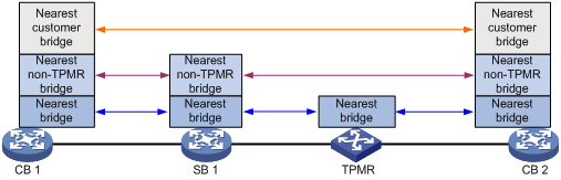

LLDP agents and bridge modes
An LLDP agent is a mapping of a protocol entity that implements LLDP. Multiple LLDP agents can run on the same interface.
LLDP agents are classified into the following types:
·          Nearest bridge agent.
·          Nearest customer bridge agent.
·          Nearest non-TPMR bridge agent.
A Two-port MAC Relay (TPMR) is a type of bridge that has only two externally-accessible bridge ports. It supports a subset of the features of a MAC bridge. A TPMR is transparent to all frame-based media-independent protocols except for the following protocols:
¡  Protocols destined for the TPMR.
¡  Protocols destined for reserved MAC addresses that the relay feature of the TPMR is configured not to forward.
LLDP exchanges packets between neighbor agents and creates and maintains neighbor information for them. Figure 1 shows the neighbor relationships for these LLDP agents.
Figure 1 LLDP neighbor relationships
The types of supported LLDP agents vary with the bridge mode in which LLDP operates. LLDP supports the following bridge modes: customer bridge (CB) and service bridge (SB).
·          Customer bridge mode—LLDP supports nearest bridge agent, nearest non-TPMR bridge agent, and nearest customer bridge agent. LLDP processes the LLDP frames with destination MAC addresses for these agents and transparently transmits the LLDP frames with other destination MAC addresses in VLANs.
·          Service bridge mode—LLDP supports nearest bridge agent and nearest non-TPMR bridge agent. LLDP processes the LLDP frames with destination MAC addresses for these agents and transparently transmits the LLDP frames with other destination MAC addresses in VLANs.

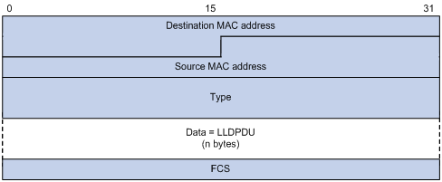

LLDP sends device information in LLDP frames. LLDP frames are encapsulated in Ethernet II or Subnetwork Access Protocol (SNAP) format.
LLDP frame encapsulated in Ethernet II
Figure 2 Ethernet II-encapsulated LLDP frame
Table 1 Fields in an Ethernet II-encapsulated LLDP frame
Field
Description
Destination MAC address
MAC address to which the LLDP frame is advertised. LLDP specifies different multicast MAC addresses as destination MAC addresses for LLDP frames destined for agents of different types. This helps distinguish between LLDP frames sent and received by different agent types on the same interface. The destination MAC address is fixed to one of the following multicast MAC addresses:
·         0x0180-c200-000E for LLDP frames destined for nearest bridge agents.
·         0x0180-c200-0000 for LLDP frames destined for nearest customer bridge agents.
·         0x0180-c200-0003 for LLDP frames destined for nearest non-TPMR bridge agents.
Source MAC address
MAC address of the sending port.
Type
Ethernet type for the upper-layer protocol. This field is 0x88CC for LLDP.
Data
LLDPDU.
FCS
Frame check sequence, a 32-bit CRC value used to determine the validity of the received Ethernet frame.

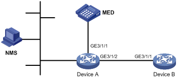

Example: Configuring basic LLDP functions
As shown in Figure 5, enable LLDP globally on Device A and  Device B to perform the following tasks:
·          Monitor the link between  Device A and  Device B on the NMS.
·          Monitor the link between  Device A and the MED device on the NMS.
Figure 5 Network diagram
1.        Configure  Device A:
# Enable LLDP globally.
<DeviceA> system-view
[DeviceA] lldp global enable
# Enable LLDP on GigabitEthernet 3/1/1. By default, LLDP is enabled on ports.
[DeviceA] interface gigabitethernet 3/1/1
[DeviceA-GigabitEthernet3/1/1] lldp enable
# Set the LLDP operating mode to Rx on GigabitEthernet 3/1/1.
[DeviceA-GigabitEthernet3/1/1] lldp admin-status rx
[DeviceA-GigabitEthernet3/1/1] quit
# Enable LLDP on GigabitEthernet 3/1/2. By default, LLDP is enabled on ports.
[DeviceA] interface gigabitethernet3/1/2
[DeviceA-GigabitEthernet3/1/2] lldp enable
# Set the LLDP operating mode to Rx on GigabitEthernet 3/1/2.
[DeviceA-GigabitEthernet3/1/2] lldp admin-status rx
[DeviceA-GigabitEthernet3/1/2] quit
2.        Configure Device B:
<DeviceB> system-view
[DeviceB] lldp global enable
[DeviceB] interface gigabitethernet 3/1/1
[DeviceB-GigabitEthernet3/1/1] lldp enable
# Set the LLDP operating mode to Tx on GigabitEthernet 3/1/1.
[DeviceB-GigabitEthernet3/1/1] lldp admin-status tx
[DeviceB-GigabitEthernet3/1/1] quit
# Verify the following items:
·          GigabitEthernet 3/1/1 of Device A connects to a MED device.
·          GigabitEthernet 3/1/2 of Device A connects to a non-MED device.
·          Both ports operate in Rx mode, and they can receive LLDP frames but cannot send LLDP frames.
