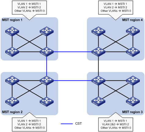

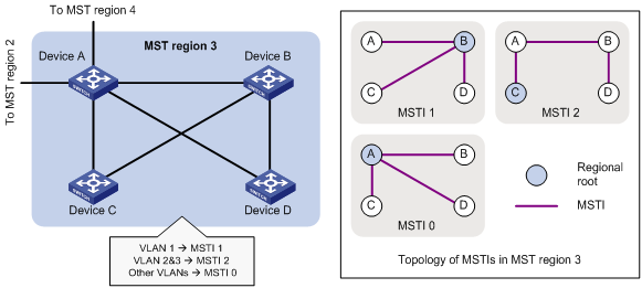

Figure 4 shows a switched network that comprises four MST regions, each MST region comprising four MSTP devices. Figure 5 shows the networking topology of MST region 3.
Figure 4 Basic concepts in MSTP

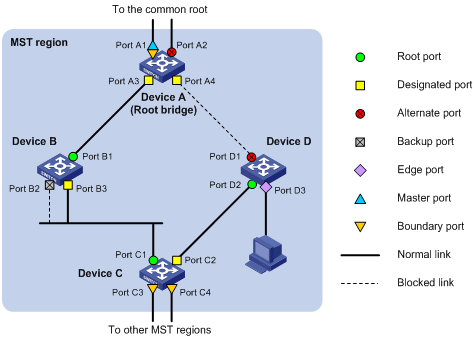

Figure 5 Network diagram and topology of MST region 3

Multiple MST regions can exist in a switched network. You can assign multiple devices to the same MST region as shown in Figure 4.
·           The switched network comprises four MST regions, MST region 1 through MST region 4.
·           All devices in each MST region have the same MST region configuration.
MSTI
MSTP can generate multiple independent spanning trees in an MST region, and each spanning tree is mapped to the specific VLANs. Each spanning tree is referred to as a multiple spanning tree instance (MSTI).
In Figure 5, MST region 3 comprises three MSTIs, MSTI 1, MSTI 2, and MSTI 0.
VLAN-to-instance mapping table
As an attribute of an MST region, the VLAN-to-instance mapping table describes the mapping relationships between VLANs and MSTIs.
In Figure 5, the VLAN-to-instance mapping table of MST region 3 is as follows:
·           VLAN 1 to MSTI 1.
·           VLAN 2 and VLAN 3 to MSTI 2.
·           Other VLANs to MSTI 0.
MSTP achieves load balancing by means of the VLAN-to-instance mapping table.
CST
The common spanning tree (CST) is a single spanning tree that connects all MST regions in a switched network. If you regard each MST region as a device, the CST is a spanning tree calculated by these devices through STP or RSTP.
The blue lines in Figure 4 represent the CST.
IST
An internal spanning tree (IST) is a spanning tree that runs in an MST region. It is also called MSTI 0, a special MSTI to which all VLANs are mapped by default.
In Figure 4, MSTI 0 is the IST in MST region 3.
CIST
The common and internal spanning tree (CIST) is a single spanning tree that connects all devices in a switched network. It consists of the ISTs in all MST regions and the CST.
In Figure 4, the ISTs (MSTI 0) in all MST regions plus the inter-region CST constitute the CIST of the entire network.
Regional root
The root bridge of the IST or an MSTI within an MST region is the regional root of the IST or MSTI. Based on the topology, different spanning trees in an MST region might have different regional roots, as shown in MST region 3 in Figure 5:
·           The regional root of MSTI 1 is Device B.
·           The regional root of MSTI 2 is Device C.
·           The regional root of MSTI 0 (also known as the IST) is Device A.

Port roles
A port can play different roles in different MSTIs. As shown in Figure 6, an MST region comprises Device A, Device B, Device C, and Device D. Port A1 and port A2 of Device A connect to the common root bridge. Port B2 and Port B3 of Device B form a loop. Port C3 and Port C4 of Device C connect to other MST regions. Port D3 of Device D directly connects to a host.
Figure 6 Port roles
MSTP calculation involves the following port roles:
·           Root port—Forwards data for a non-root bridge to the root bridge. The root bridge does not have any root port.
·           Designated port—Forwards data to the downstream network segment or device.
·           Alternate portActs as the backup port for a root port or master port. When the root port or master port is blocked, the alternate port takes over.
·           Backup portActs as the backup port of a designated port. When the designated port is invalid, the backup port becomes the new designated port. A loop occurs when two ports of the same spanning tree device are connected, so the device blocks one of the ports. The blocked port acts as the backup.
·           Edge port—Does not connect to any network device or network segment, but directly connects to a user host.
·           Master portActs as a port on the shortest path from the local MST region to the common root bridge. The master port is not always located on the regional root. It is a root port on the IST or CIST and still a master port on the other MSTIs.
·           Boundary port—Connects an MST region to another MST region or to an STP/RSTP-running device. In MSTP calculation, a boundary port's role on an MSTI is consistent with its role on the CIST. However, that is not true with master ports. A master port on MSTIs is a root port on the CIST.

Configuring an MST region
Spanning tree devices belong to the same MST region if they are both connected through a physical link and configured with the following details:
·           Format selector (0 by default, not configurable).
·           MST region name.
·           MST region revision level.
·           VLAN-to-instance mapping entries in the MST region.
The configuration of MST region-related parameters (especially the VLAN-to-instance mapping table) might cause MSTP to begin a new spanning tree calculation. To reduce the possibility of topology instability, the MST region configuration takes effect only after you activate it by doing one of the following:
·           Use the active region-configuration command.
·           Enable a spanning tree protocol by using the stp global enable command if the spanning tree protocol is disabled.
In STP, RSTP, or PVST mode, MST region configurations do not take effect.

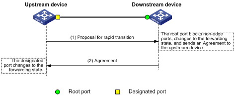

In RSTP and MSTP, the following types of messages are used for rapid state transition on designated ports:
·           Proposal—Sent by designated ports to request rapid transition
·           Agreement—Used to acknowledge rapid transition requests

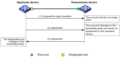

Both RSTP and MSTP devices can perform rapid transition on a designated port only when the port receives an agreement packet from the downstream device. RSTP and MSTP devices have the following differences:
·           For MSTP, the root port of the downstream device sends an agreement packet only after it receives an agreement packet from the upstream device.
·           For RSTP, the downstream device sends an agreement packet regardless of whether an agreement packet from the upstream device is received.
Figure 8 Rapid state transition of an MSTP designated port
Figure 9 Rapid state transition of an RSTP designated port

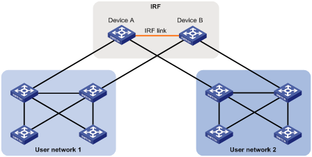

As shown in Figure 11, an IRF fabric connects to two user networks through double links.
·           Device A and Device B form an IRF fabric.
·           The spanning tree feature is disabled on Device A and Device B and enabled on all devices in user network 1 and user network 2.
·           The IRF fabric transparently transmits BPDUs for both user networks and is not involved in the calculation of spanning trees.
When the network topology changes, it takes time for the IRF fabric to update its MAC address table and ARP table. During this period, traffic in the network might be interrupted.
Figure 11 TC Snooping application scenario
image18.emf
To avoid traffic interruption, you can enable TC Snooping on the IRF fabric. After receiving a TC-BPDU through a port, the IRF fabric updates MAC address table and ARP table entries associated with the port's VLAN. In this way, TC Snooping prevents topology change from interrupting traffic forwarding in the network. For more information about the MAC address table and the ARP table, see "Configuring the MAC address table" and Layer 3—IP Services Configuration Guide.

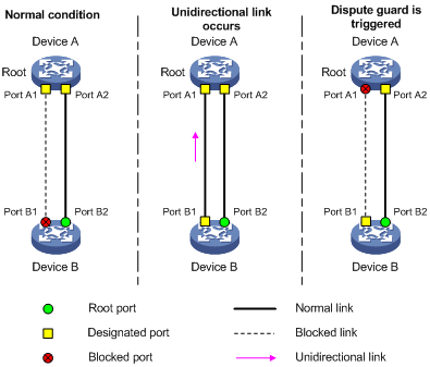

About dispute guard
Dispute guard is enabled by default. You do not need to manually configure this feature.

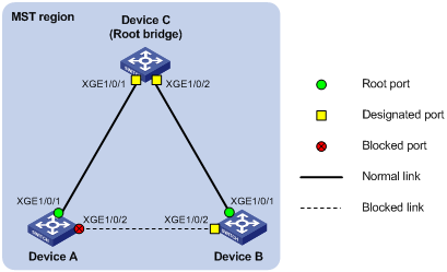

Dispute guard can be triggered by unidirectional link failures. If an upstream port receives inferior BPDUs from a downstream designated port in forwarding or learning state because of a unidirectional link failure, a loop appears. Dispute guard blocks the upstream designated port to prevent the loop.
As shown in Figure 12, in normal conditions, the spanning tree calculation result is as follows:
·           Device A is the root bridge, and Port A1 is a designated port.
·           Port B1 is blocked.
When the link between Port A1 and Port B1 fails in the direction of Port A1 to Port B1 and becomes unidirectional, the following events occur:
1.      Port A1 can only receive BPDUs and cannot send BPDUs to Port B1.
2.      Port B1 does not receive BPDUs from Port A1 for a certain period of time.
3.      Device B determines itself as the root bridge.
4.      Port B1 sends its BPDUs to Port A1.
5.      Port A1 determines the received BPDUs are inferior to its own BPDUs. A dispute is detected.
6.      Dispute guard is triggered and blocks Port A1 to prevent a loop.
Figure 12 Dispute guard triggering scenario

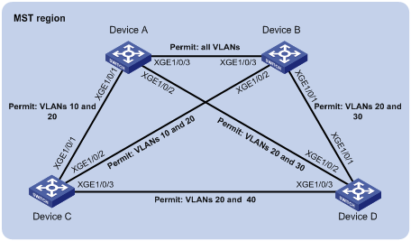

MSTP configuration example
Network requirements
As shown in Figure 13, all devices on the network are in the same MST region. Device A and Device B work at the distribution layer. Device C and Device D work at the access layer.
Configure MSTP so that packets of different VLANs are forwarded along different spanning trees.
·           VLAN 10 packets are forwarded along MSTI 1.
·           VLAN 30 packets are forwarded along MSTI 3.
·           VLAN 40 packets are forwarded along MSTI 4.
·           VLAN 20 packets are forwarded along MSTI 0.
VLAN 10 and VLAN 30 are terminated on the distribution layer devices, and VLAN 40 is terminated on the access layer devices. The root bridges of MSTI 1 and MSTI 3 are Device A and Device B, respectively, and the root bridge of MSTI 4 is Device C.
Figure 13 Network diagram

Based on the output, you can draw each MSTI mapped to each VLAN, as shown in Figure 14.
Figure 14 MSTIs mapped to different VLANs

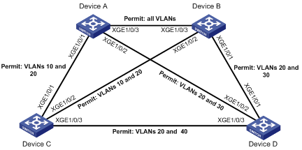

PVST configuration example
As shown in Figure 15, Device A and Device B work at the distribution layer, and Device C and Device D work at the access layer.
Configure PVST to meet the following requirements:
·           Packets of a VLAN are forwarded along the spanning trees of the VLAN.
·           VLAN 10, VLAN 20, and VLAN 30 are terminated on the distribution layer devices, and VLAN 40 is terminated on the access layer devices.
·           The root bridge of VLAN 10 and VLAN 20 is Device A.
·           The root bridge of VLAN 30 is Device B.
·           The root bridge of VLAN 40 is Device C.
Figure 15 Network diagram

# Set the spanning tree mode to PVST.
<DeviceB> system-view
[DeviceB] stp mode pvst
# Configure the device as the root bridge of VLAN 30.
[DeviceB] stp vlan 30 root primary
# Enable the spanning tree feature globally and in VLAN 10, VLAN 20, and VLAN 30.
[DeviceB] stp global enable
[DeviceB] stp vlan 10 20 30 enable
4.      Configure Device C:
<DeviceC> system-view
[DeviceC] stp mode pvst
# Configure the device as the root bridge of VLAN 40.
[DeviceC] stp vlan 40 root primary
# Enable the spanning tree feature globally and in VLAN 10, VLAN 20, and VLAN 40.
[DeviceC] stp global enable
[DeviceC] stp vlan 10 20 40 enable
5.      Configure Device D:
<DeviceD> system-view
[DeviceD] stp mode pvst
# Enable the spanning tree feature globally and in VLAN 20, VLAN 30, and VLAN 40.
[DeviceD] stp global enable
[DeviceD] stp vlan 20 30 40 enable
When the network is stable, use the display stp brief command to display brief spanning tree information on each device.
