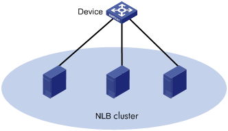

Adding or modifying a multiport unicast MAC address entry
You can configure a multiport unicast MAC address entry to associate a unicast destination MAC address with multiple ports. The frame with a destination MAC address matching the entry is sent out of multiple ports.
For example, in NLB unicast mode:
·           All servers within the cluster uses the cluster's MAC address as their own address.
·           Frames destined for the cluster are forwarded to every server in the group.
In this case, you can configure a multiport unicast MAC address entry on the device connected to the server group. Then, the device forwards the frame destined for the server group through all ports connected to the servers within the cluster.
Figure 1 NLB cluster
Do not configure an interface as the output interface of a multiport unicast MAC address entry if the interface receives frames destined for the multiport unicast MAC address. Otherwise, the frames are flooded on the VLAN to which they belong.

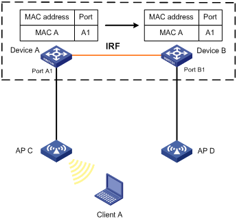

As shown in Figure 2,
·           Device A and Device B form an IRF fabric enabled with MAC address synchronization.
·           Device A and Device B connect to AP C and AP D, respectively.
When Client A associates with AP C, Device A learns a MAC address entry for Client A and advertises it to Device B.
Figure 2 MAC address tables of devices when Client A accesses AP C

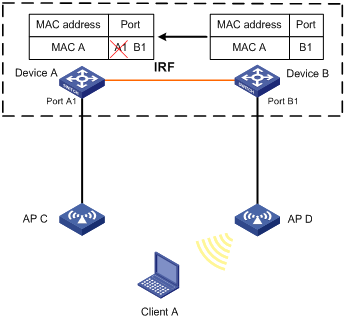

When Client A roams to AP D, Device B learns a MAC address entry for Client A. Device B advertises it to Device A to ensure service continuity for Client A, as shown in Figure 3.
Figure 3 MAC address tables of devices when Client A roams to AP D

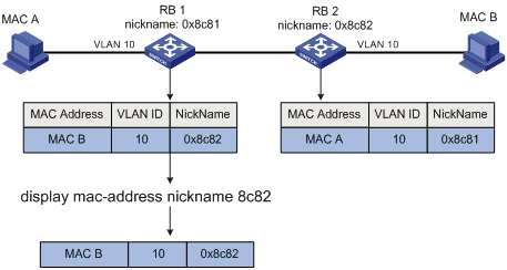

Display the MAC address information of the egress RB specified by its nickname (see Figure 5).
display mac-address nickname nickname

Figure 5 An example for the display mac-address nickname command

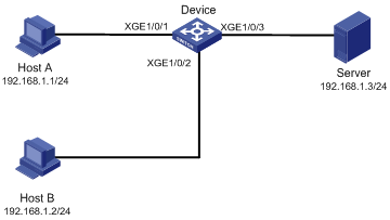

Network requirements
Host A at MAC address 000f-e235-dc71 is connected to interface Ten-GigabitEthernet 1/0/1 of Device and belongs to VLAN 1.
Host B at MAC address 000f-e235-abcd, which behaved suspiciously on the network, also belongs to VLAN 1.
Configure the MAC address as follows:
·           To prevent MAC address spoofing, add a static entry for Host A in the MAC address table of Device.
·           To drop all frames destined for Host B, add a blackhole MAC address entry for the host.
·           Set the aging timer to 500 seconds for dynamic MAC address entries.
Configuration procedure
# Add a static MAC address entry for MAC address 000f-e235-dc71 on Ten-GigabitEthernet 1/0/1 that belongs to VLAN 1.
<Device> system-view
[Device] mac-address static 000f-e235-dc71 interface ten-gigabitethernet 1/0/1 vlan 1
# Add a blackhole MAC address entry for MAC address 000f-e235-abcd that belongs to VLAN 1.
[Device] mac-address blackhole 000f-e235-abcd vlan 1
# Set the aging timer to 500 seconds for dynamic MAC address entries.
[Device] mac-address timer aging 500
# Display the static MAC address entries for interface Ten-GigabitEthernet 1/0/1.
[Device] display mac-address static interface ten-gigabitethernet 1/0/1
MAC Address      VLAN ID    State            Port/NickName            Aging
000f-e235-dc71   1          Static           XGE1/0/1                 N
# Display the blackhole MAC address entries.
[Device] display mac-address blackhole
000f-e235-abcd   1          Blackhole        N/A                      N
Enable MAC Information on interface Ten-GigabitEthernet 1/0/1 on Device in Figure 6 to send MAC address changes in syslog messages to the log host, Host B, through interface Ten-GigabitEthernet 1/0/2.
Figure 6 Network diagram
When you edit the file /etc/syslog.conf, follow these restrictions and guidelines:
·           Comments must be on a separate line and must begin with a pound sign (#).
·           No redundant spaces are allowed after the file name.
·           The logging facility name and the severity level specified in the /etc/syslog.conf file must be the same as those configured on the device. Otherwise, the log information might not be output correctly to the log host. The logging facility name and the severity level are configured by using the info-center loghost and info-center source commands, respectively.
1.      Configure Device to send syslog messages to Host B:
# Enable the information center.
[Device] info-center enable
# Specify the log host 192.168.1.2/24 and specify local4 as the logging facility.
[Device] info-center loghost 192.168.1.2 facility local4
# Disable log output to the log host.
[Device] info-center source default loghost deny
To avoid output of unnecessary information, disable all modules from outputting logs to the specified destination (loghost, in this example) before you configure an output rule.
# Configure an output rule to output to the log host MAC address logs that have a severity level of at least informational.
[Device] info-center source mac loghost level informational
2.      Configure the log host, Host B:
Configure Solaris as follows. Configure other UNIX operating systems in the same way Solaris is configured.
a.    Log in to the log host as a root user.
b.    Create a subdirectory named Device in directory /var/log/.
# mkdir /var/log/Device
c.    Create file info.log in the Device directory to save logs from Device.
# touch /var/log/Device/info.log
d.    Edit the file syslog.conf in directory /etc/ and add the following contents:
# Device configuration messages
local4.info /var/log/Device/info.log
In this configuration, local4 is the name of the logging facility that the log host uses to receive logs, and info is the informational level. The UNIX system records the log information that has a severity level of at least informational to the file /var/log/Device/info.log.
e.    Display the process ID of syslogd, end the syslogd process, and then restart syslogd using the –r option to make the new configuration take effect.
# ps -ae | grep syslogd
147
# kill -HUP 147
# syslogd -r &
The device can output MAC address logs to the log host, which stores the logs to the specified file.
3.      Enable MAC Information on Device:
# Enable MAC Information globally.
[Device] mac-address information enable
# Configure the MAC Information mode as syslog.
[Device] mac-address information mode syslog
# Enable MAC Information on interface Ten-GigabitEthernet 1/0/1 to enable Ten-GigabitEthernet 1/0/1 to record MAC address change information when the interface performs either of the following operations:
¡  Learns a new MAC address.
¡  Deletes an existing MAC address.
[Device] interface ten-gigabitethernet 1/0/1
[Device-Ten-GigabitEthernet1/0/1] mac-address information enable added
[Device-Ten-GigabitEthernet1/0/1] mac-address information enable deleted
[Device-Ten-GigabitEthernet1/0/1] quit
# Set the MAC Information queue length to 100.
[Device] mac-address information queue-length 100
# Set the MAC change notification interval to 20 seconds.
[Device] mac-address information interval 20
