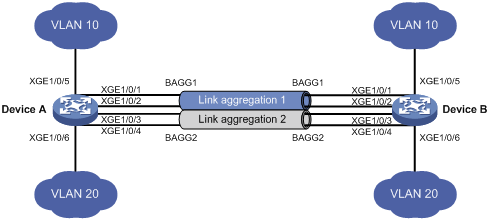

Ethernet link aggregation application scenario
As shown in 0, Device A and Device B are connected by three physical Ethernet links. These physical Ethernet links are combined into an aggregate link called link aggregation 1. The bandwidth of this aggregate link can reach up to the total bandwidth of the three physical Ethernet links. At the same time, the three Ethernet links back up one another. When a physical Ethernet link fails, the traffic previously carried on the failed link is switched to the other two links.
Ethernet link aggregation diagram

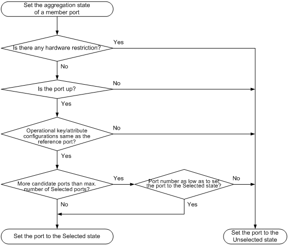

Setting the aggregation state of each member port
After a static aggregation group reaches the limit on Selected ports, ports attempting to join the group are put in Unselected state. This prevents traffic interruption on the existing Selected ports.
Setting the aggregation state of a member port in a static aggregation group
For more information about configuring the maximum number of Selected ports in a static aggregation group, see "Setting the minimum and maximum numbers of Selected ports for an aggregation group."

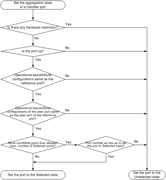

After the reference port is chosen, the system with the smaller system ID sets the state of each member port on its side.
Setting the state of a member port in a dynamic aggregation group
Meanwhile, the system with the higher system ID is aware of the aggregation state changes on the remote system. The system sets the aggregation state of local member ports the same as their peer ports.

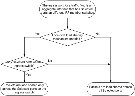

Load sharing modes for link aggregation groups
In a link aggregation group, traffic can be load shared across the Selected ports based on any of the following modes:
·           Per-flow load sharing—Load shares traffic on a per-flow basis. The load sharing mode classifies packets into flows and forwards packets of the same flow on the same link. This mode can be one or any combination of the following criteria that classify traffic:

·          Enabling local-first load sharing for link aggregation

Configuring a static aggregation group
To guarantee a successful static aggregation, make sure that the ports at both ends of each link are in the same aggregation state.
Avoid assigning ports to a static aggregation group that has reached the limit on Selected ports. These ports will be placed in the Unselected state to avoid traffic interruption on the current Selected ports. However, a device reboot can cause the aggregation state of member ports to change.

Configuring a dynamic aggregation group
To guarantee a successful dynamic aggregation, make sure that the peer ports of the ports aggregated at one end are also aggregated. The two ends can automatically negotiate the aggregation state of each member port.

·           When the number of member ports eligible to be Selected ports is smaller than the minimum threshold:
¡  All member ports are placed in the Unselected state.
¡  The link of the aggregate interface goes down.
·           When the minimum threshold is reached, the eligible member ports are placed in the Selected state, and the link of the aggregate interface goes up.
The maximum number of Selected ports allowed in an aggregation group is limited by either the configured maximum number or hardware capability, whichever value is smaller.
Use local-first load sharing in a multidevice link aggregation scenario to distribute traffic preferentially across member ports on the ingress card or device.
When you aggregate ports on different member devices in an IRF fabric, you can use local-first load sharing to reduce traffic on IRF links, as shown in 0. For more information about IRF, see IRF Configuration Guide.
Load sharing for multiswitch link aggregation in an IRF fabric
To enable local-first load sharing for link aggregation:
Step
Remarks
1.      Enter system view.
N/A
2.      Enable local-first load sharing for link aggregation.
link-aggregation load-sharing mode local-first
By default, local-first load sharing for link aggregation is enabled.

Layer 2 aggregation load sharing configuration example
Network requirements
On the network shown in 0, perform the following tasks:
·           Configure two Layer 2 static aggregation groups 1 and 2 on Device A and Device B, respectively.
·           Enable VLAN 10 at one end of the aggregate link to communicate with VLAN 10 at the other end.
·           Enable VLAN 20 at one end of the aggregate link to communicate with VLAN 20 at the other end.
·           Configure link aggregation groups 1 and 2 to load share traffic across aggregation group member ports.
¡  Configure link aggregation group 1 to load share packets based on source MAC addresses.
¡  Configure link aggregation group 2 to load share packets based on destination MAC addresses.
Network diagram
Configuration procedure
1.      Configure Device A:
# Create VLAN 10, and assign the port Ten-GigabitEthernet 1/0/5 to VLAN 10.
<DeviceA> system-view
[DeviceA] vlan 10
[DeviceA-vlan10] port ten-gigabitethernet 1/0/5
[DeviceA-vlan10] quit
# Create VLAN 20, and assign the port Ten-GigabitEthernet 1/0/6 to VLAN 20.
[DeviceA] vlan 20
[DeviceA-vlan20] port ten-gigabitethernet 1/0/6
[DeviceA-vlan20] quit
# Create Layer 2 aggregate interface Bridge-Aggregation 1.
[DeviceA] interface bridge-aggregation 1
# Configure Layer 2 aggregation group 1 to load share packets based on source MAC addresses.
[DeviceA-Bridge-Aggregation1] link-aggregation load-sharing mode source-mac
[DeviceA-Bridge-Aggregation1] quit
# Assign ports Ten-GigabitEthernet 1/0/1 and Ten-GigabitEthernet 1/0/2 to link aggregation group 1.
[DeviceA] interface ten-gigabitethernet 1/0/1
[DeviceA-Ten-GigabitEthernet1/0/1] port link-aggregation group 1

Layer 2 edge aggregate interface configuration example
As shown in 0, a Layer 2 dynamic aggregation group is configured on the device. The server is not configured with dynamic link aggregation.
Configure an edge aggregate interface so that both Ten-GigabitEthernet 1/0/1 and Ten-GigabitEthernet 1/0/2 can forward traffic to improve link reliability.
Network diagram
# Create Layer 2 aggregate interface Bridge-Aggregation 1, and set the link aggregation mode to dynamic.
<Device> system-view
[Device] interface bridge-aggregation 1
[Device-Bridge-Aggregation1] link-aggregation mode dynamic
# Configure Layer 2 aggregate interface Bridge-Aggregation 1 as an edge aggregate interface.
[Device-Bridge-Aggregation1] lacp edge-port
[Device-Bridge-Aggregation1] quit
[Device] interface ten-gigabitethernet 1/0/1
[Device-Ten-GigabitEthernet1/0/1] port link-aggregation group 1
[Device-Ten-GigabitEthernet1/0/1] quit
[Device] interface ten-gigabitethernet 1/0/2
[Device-Ten-GigabitEthernet1/0/2] port link-aggregation group 1
[Device-Ten-GigabitEthernet1/0/2] quit
# Display detailed information about all aggregation groups on the device when the server is not configured with dynamic link aggregation.
[Device] display link-aggregation verbose
Loadsharing Type: Shar -- Loadsharing, NonS -- Non-Loadsharing
Port Status: S -- Selected, U -- Unselected
             I -- Individual, * -- Management port
Flags:  A -- LACP_Activity, B -- LACP_Timeout, C -- Aggregation,
        G -- Defaulted, H -- Expired
Aggregate Interface: Bridge-Aggregation1
Aggregation Mode: Dynamic
Loadsharing Type: NonS
Management VLAN : None
System ID: 0x8000, 000f-e267-6c6a
Local:
  Port             Status  Priority Oper-Key  Flag
  XGE1/0/1          I       32768    1         {AG}
  XGE1/0/2          I       32768    1         {AG}
Remote:
  Actor            Partner Priority Oper-Key  SystemID               Flag
  XGE1/0/1          0       32768    0         0x8000, 0000-0000-0000 {DEF}
  XGE1/0/2          0       32768    0         0x8000, 0000-0000-0000 {DEF}
The output shows that Ten-GigabitEthernet 1/0/1 and Ten-GigabitEthernet 1/0/2 are in Individual state when they do not receive LACPDUs from the server. Both Ten-GigabitEthernet 1/0/1 and Ten-GigabitEthernet 1/0/2 can forward traffic. When one port fails, its traffic is automatically switched to the other port.
