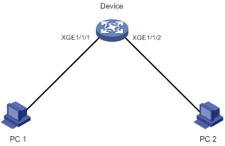

Schedule configuration example
Network requirements
As shown in Figure 1, two interfaces of the device are connected to users.
To save energy, configure the device to perform the following operations:
·           Enable the interfaces at 8:00 a.m. every Monday through Friday.
·           Disable the interfaces at 18:00 every Monday through Friday.
Figure 1 Network diagram
Scheduling procedure

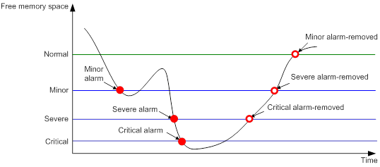

Setting memory alarm thresholds
To monitor memory usage, the device performs the following operations:
·           Samples memory usage at an interval of 1 minute, and compares the sample with the memory usage threshold. If the sample is greater, the device sends a trap.
·           Monitors the amount of free memory space in real time. If a free-memory threshold is exceeded, the system generates an alarm notification or an alarm-removed notification and sends it to affected service modules or processes.
As shown in Table 2 and Figure 3, the system supports the following free-memory thresholds:
·           Normal state threshold.
·           Minor alarm threshold.
·           Severe alarm threshold.
·           Critical alarm threshold.
Table 2 Memory alarm notifications and memory alarm-removed notifications
Notification
Triggering condition
Remarks
Minor alarm notification
The amount of free memory space decreases to or below the minor alarm threshold for the first time.
After generating and sending a minor alarm notification, the system does not generate and send any additional minor alarm notifications until the first minor alarm is removed.
Severe alarm notification
The amount of free memory space decreases to or below the severe alarm threshold for the first time.
After generating and sending a severe alarm notification, the system does not generate and send any additional severe alarm notifications until the first severe alarm is removed.
Critical alarm notification
The amount of free memory space decreases to or below the critical alarm threshold for the first time.
After generating and sending a critical alarm notification, the system does not generate and send any additional critical alarm notifications until the first critical alarm is removed.
Critical alarm-removed notification
The amount of free memory space increases to or above the severe alarm threshold.
N/A
Severe alarm-removed notification
The amount of free memory space increases to or above the minor alarm threshold.
N/A
Minor alarm-removed notification
The amount of free memory space increases to or above the normal state threshold.
N/A
Figure 3 Memory alarm notification and alarm-removed notification

·           Severe alarm threshold—64 MB.
·           Critical alarm threshold—48 MB.
·           Normal state threshold—128 MB.
